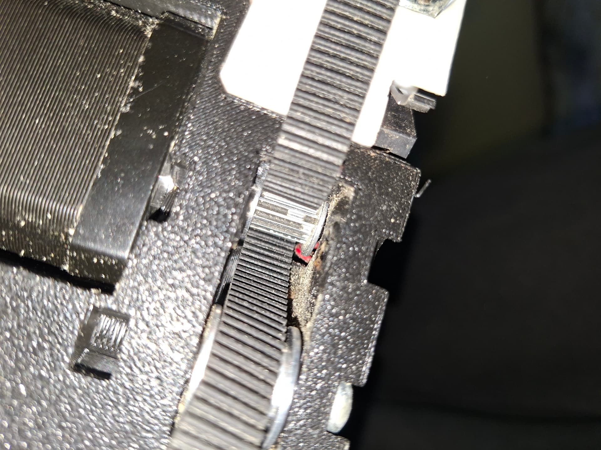

Turns out clogged pulley teeth was the issue,I assume it was the excessive grinding of belts that caused it, cleaned them out and now running smoothly
You might want to look at replacing that belt. Shouldn’t have chunks coming off of it like that.
Yeah, I’m gonna do just that for real
Frequent cause of tooth loss is excessive tension.
I thought it was sugar and not brushing your teeth… :sweat_smile:
