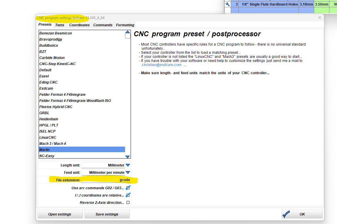

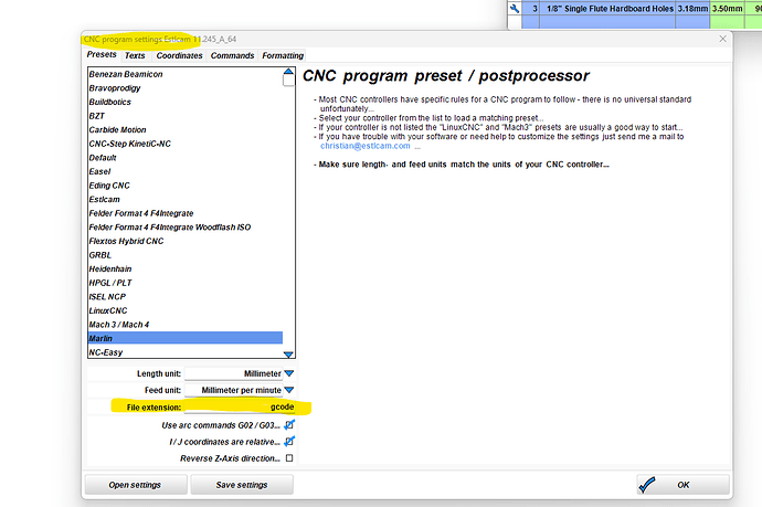

That is because you have the File Extension at the default setting of “nc”. Change this in Setup - CNC Program to “gcode” instead. (Same in both v11 and v12 - not a bug)
@Bartman
It is not the file extension, when I talk about a bug. :rofl: :rofl:
I know where to change the extension.
The code in the file is wrong and it doesn’t matter having a “.nc-file” or a “.gcode-file”.
So creating the milling code in special situations, I have to edit the code and to change some stuff within the code manually. Otherwise the cnc crashes into the endpoints! This is the bug in Version 11.x
And based on the parts I create and my restrictions in the bed-dimensions I always run into these situations to change the milling code manually. But I got used to it and so it is an effort of 1-2 minutes.
