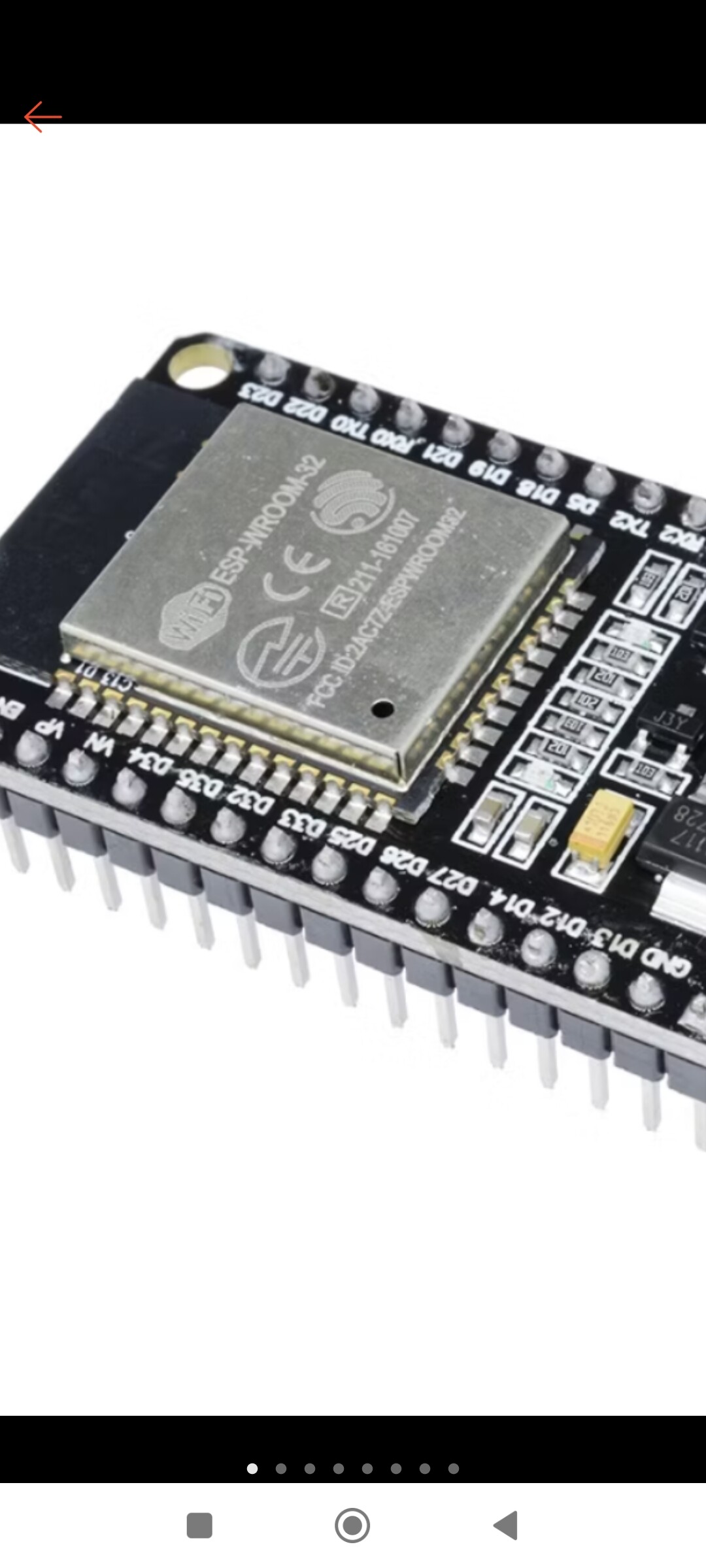

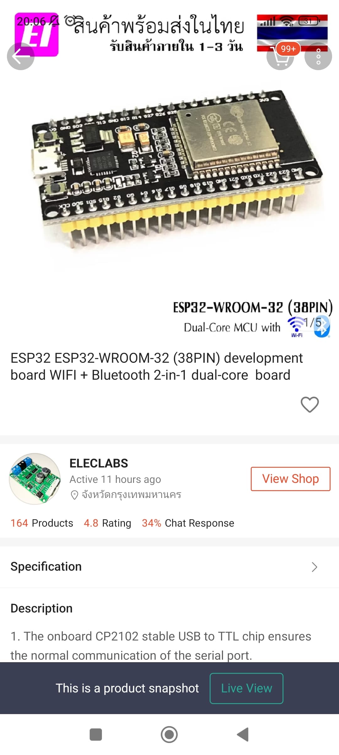

So I bought an ESP board after searching the forum and many topics, looking specifically for one that had ESP-WROOM-32 written on it as that was the takeaway - it needs to be WROOM.

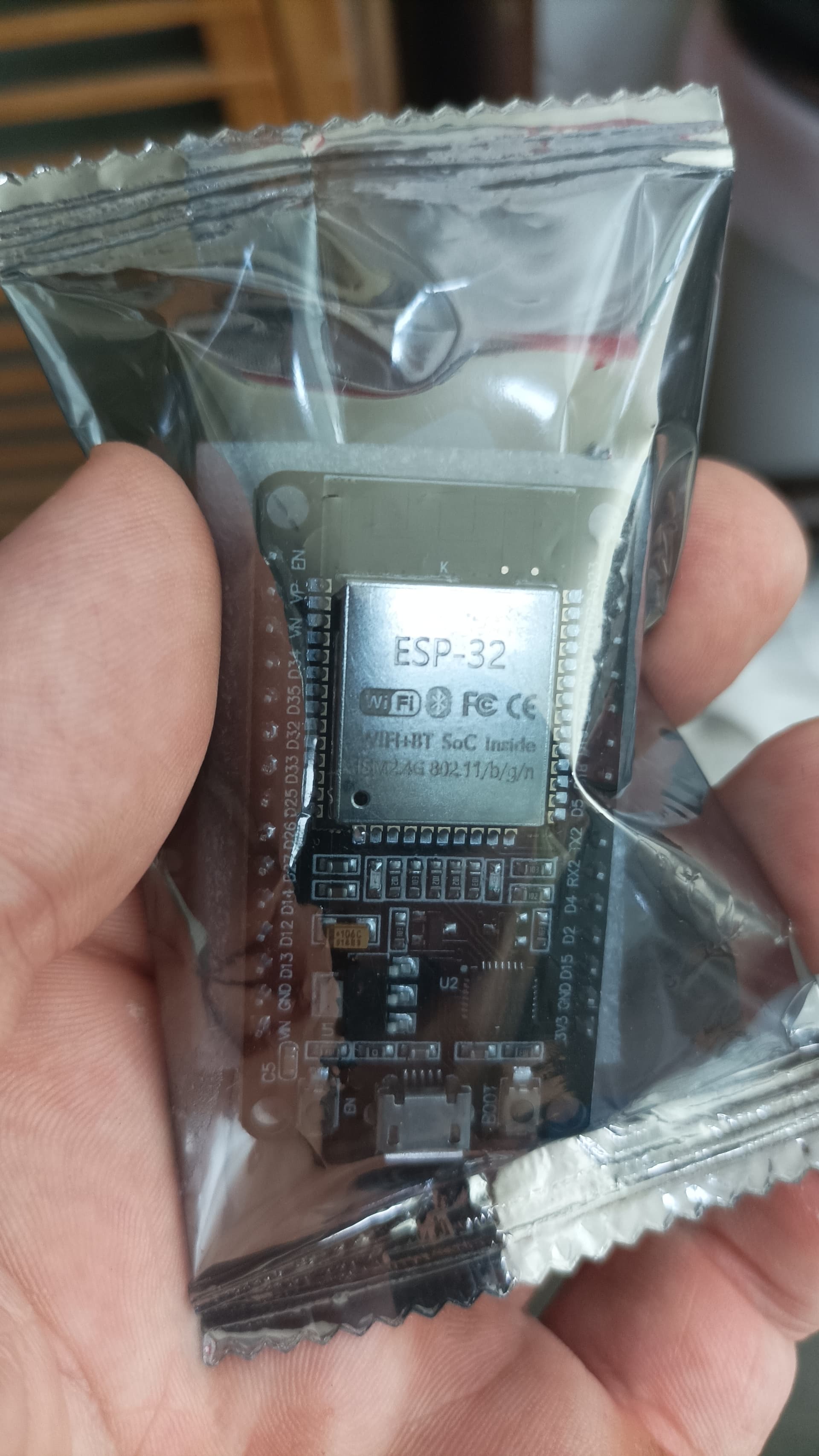

Found a listing that looked correct, ordered, waited two weeks, received one with just ESP-32 on it. :grinning_face_with_smiling_eyes:
Wondering if I set up the firmware on the jackpot board I’ll be able to tell if it’s a working one?

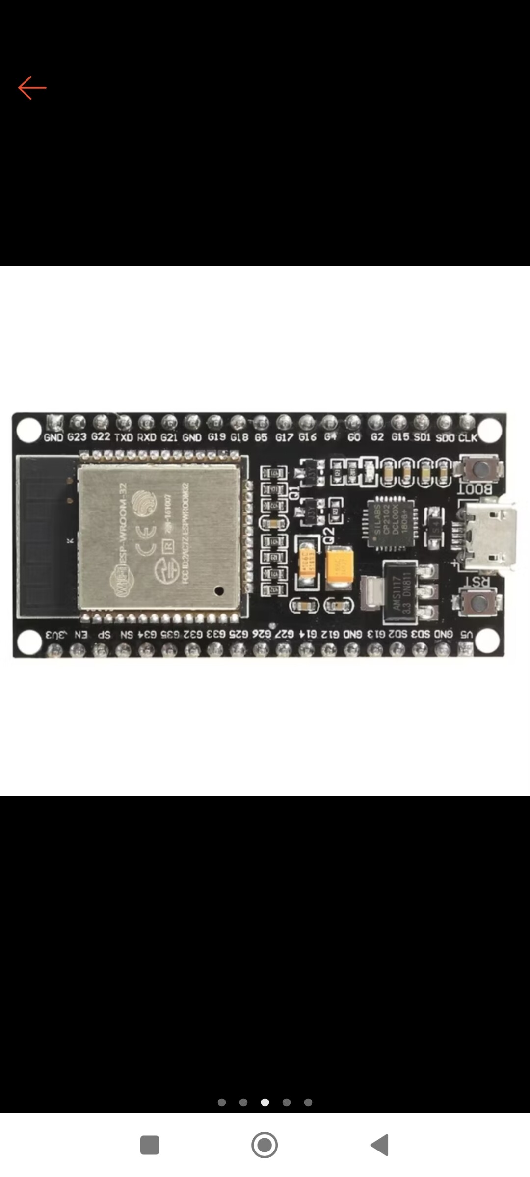

That definitely won’t work. It only has 30 pins. The correct version has 38 pins.
Arrrghgh, thanks, off to order another then

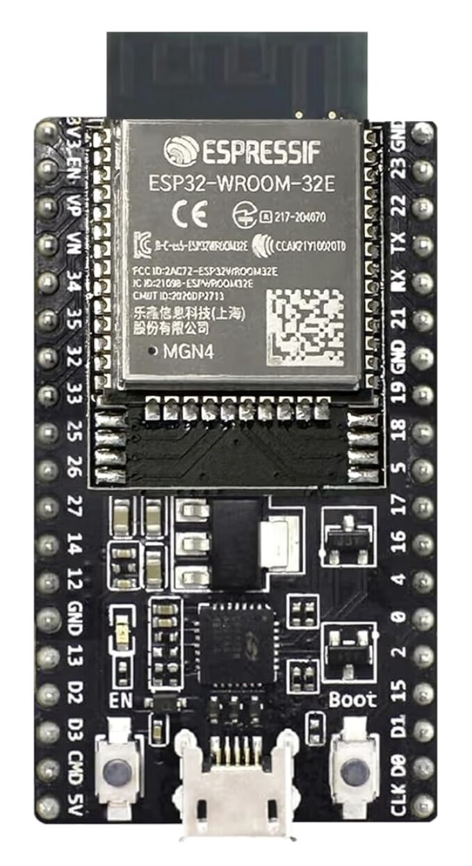

It should have Espressif on the chip at least. This is a picture of the official Espressif one.

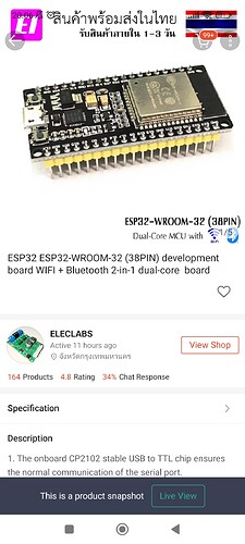

Thanks, I couldn’t find an Expressif one, but maybe this is ok?
Maybe? But I don’t have much confidence in it.
No worries, I’ll try it, they all seem to look pretty similar tbh. Aside from the Expressif logo, if there’s no other markings or specs I should be looking for other than ESP32-WROOM / 38PIN / CP2102 I guess it’s pot luck
