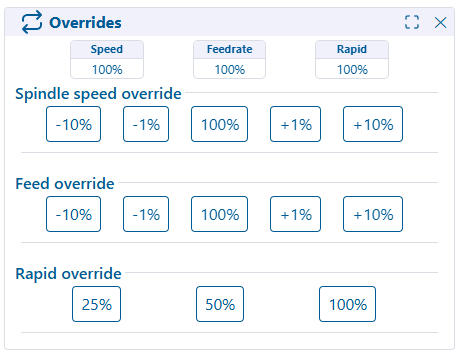

Hey everyone,
Just installed my new Jackpotv2 and it came with updated firmware that has a significantly different interface. Im not finding the option to adjust the speed on the fly, which was something I did quite frequently on my Jackpotv1. Am I missing something, or is this not available in the version of firmware that came with the Jackpot v2? Not at my CNC right now, but I will edit this post with the actual firmware version when I get that information, but for now I wanted to throw this out there and see if anyone knew.
I’m guessing it came with WebUI v3. You may have to change the settings to get the Override panel to display.
Then it will show this on the Dashboard.
You are the freaking man. Thanks Jason. Exactly what I needed
