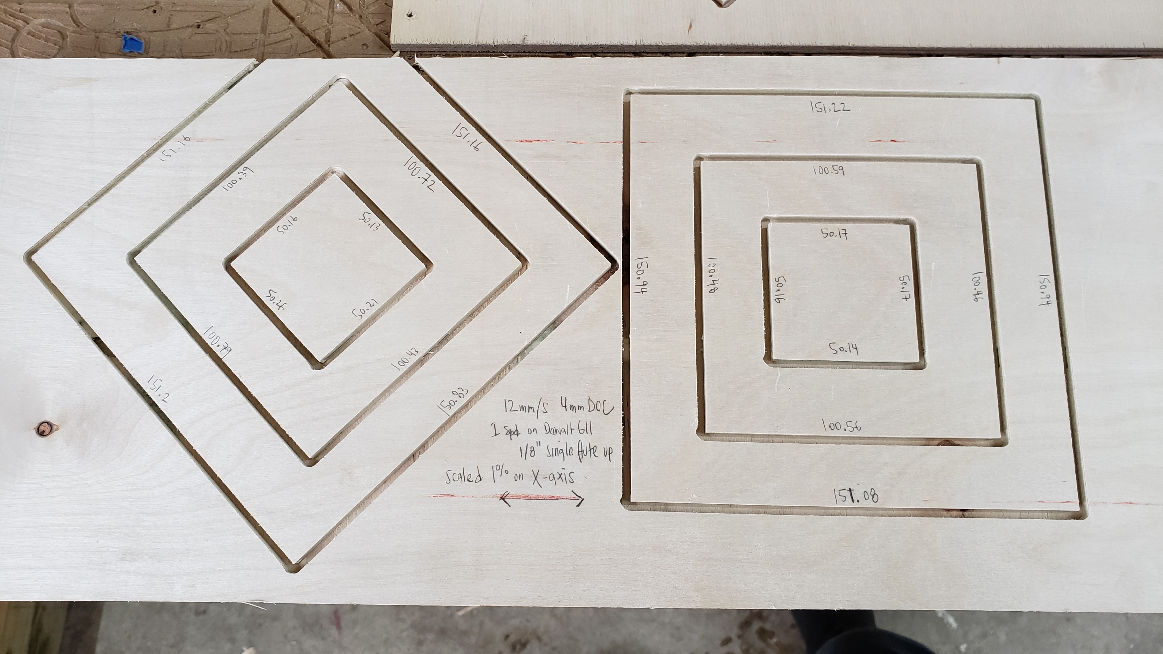

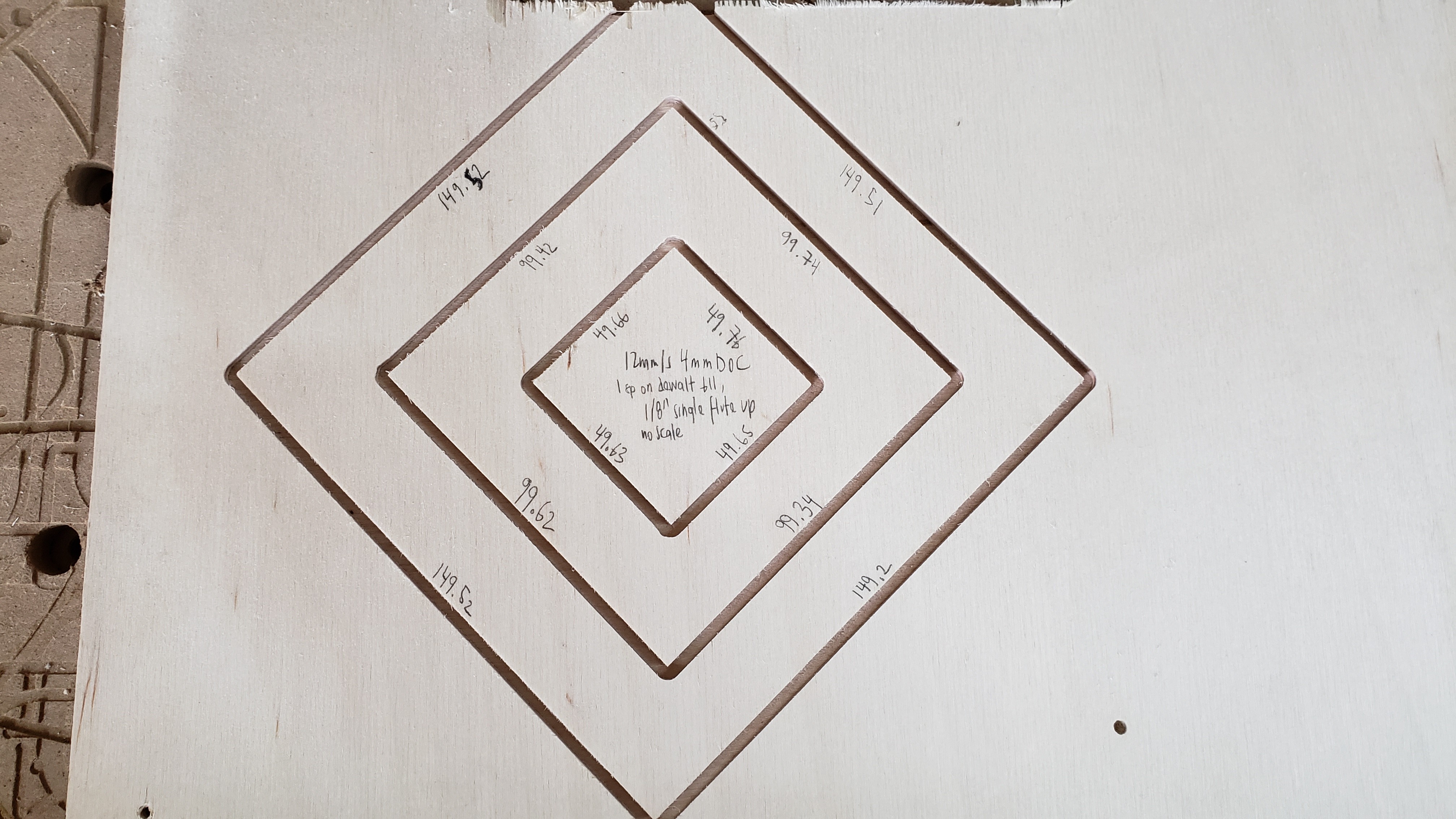

I’ve done some feedrate testing as have others and I’m working at improving <0.5mm variance in most instances with all those trials feedrates.
Here are the last of those:
Thank you for posting those. My goal is to get to .1mm .5mm is almost 0.020" Which for wood is not bad for sure. I am also looking to work with acrylic, bakelite and others. When I move to using a laser, I need to get down significantly towards 0.1mm or 5 thou. For me with wood max feed rate is less important I with a fully used 4x8 sheet, fully nested, time isn’t as critical as accuracy and not having tool wander due to tolerances in the motion mechanics. I am impressed with the LR design. I am just looking for it to be repeatable pass after pass, hour after hour.
