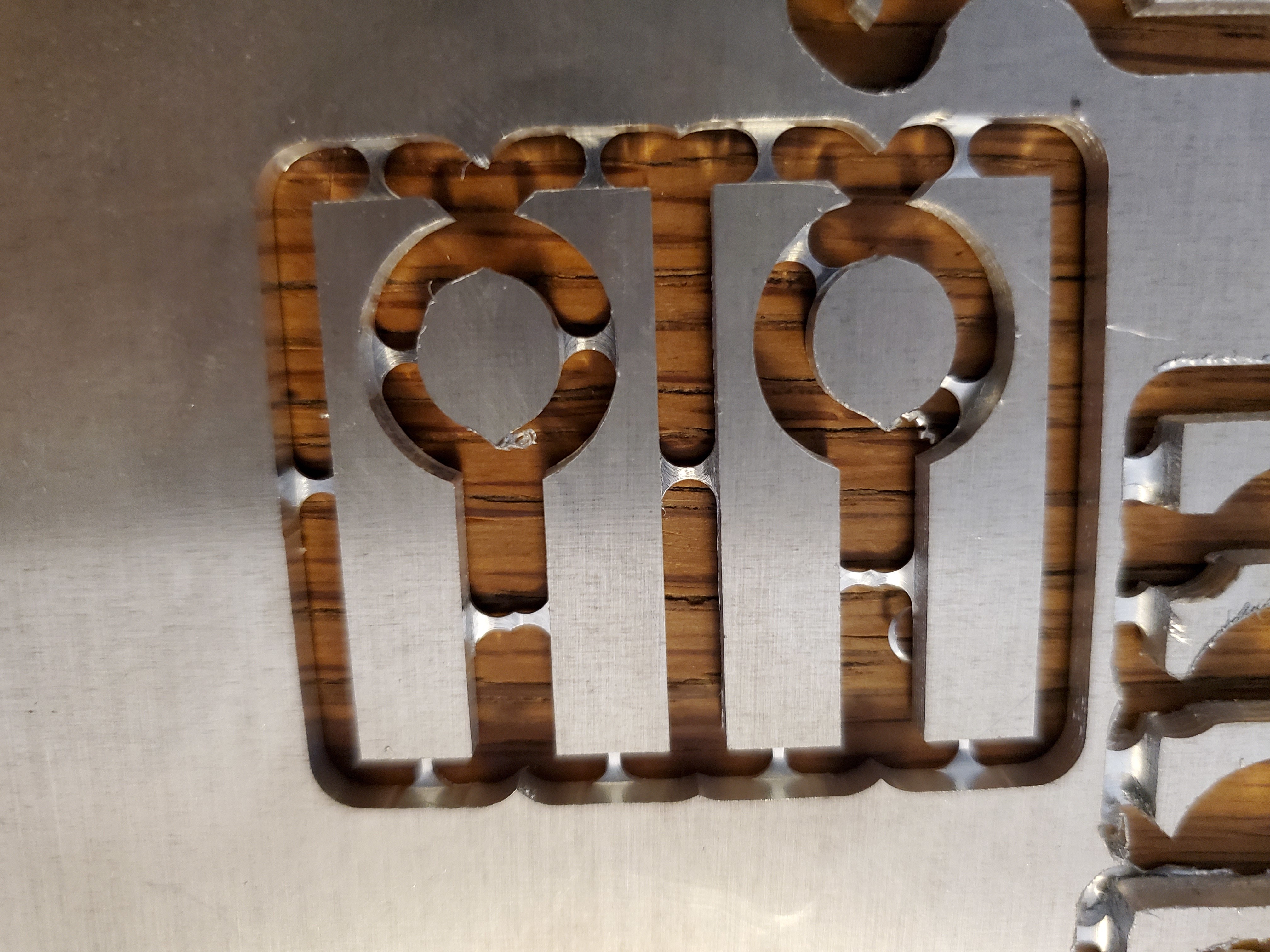

How is this for repeatability and accuracy?
There was lots of trial and error but they all fit snug like this guy now
Nice! But what the heck are you making?
Wrong answers only!
These are clearly resuable flossers.
Bottlecap chuckers!
