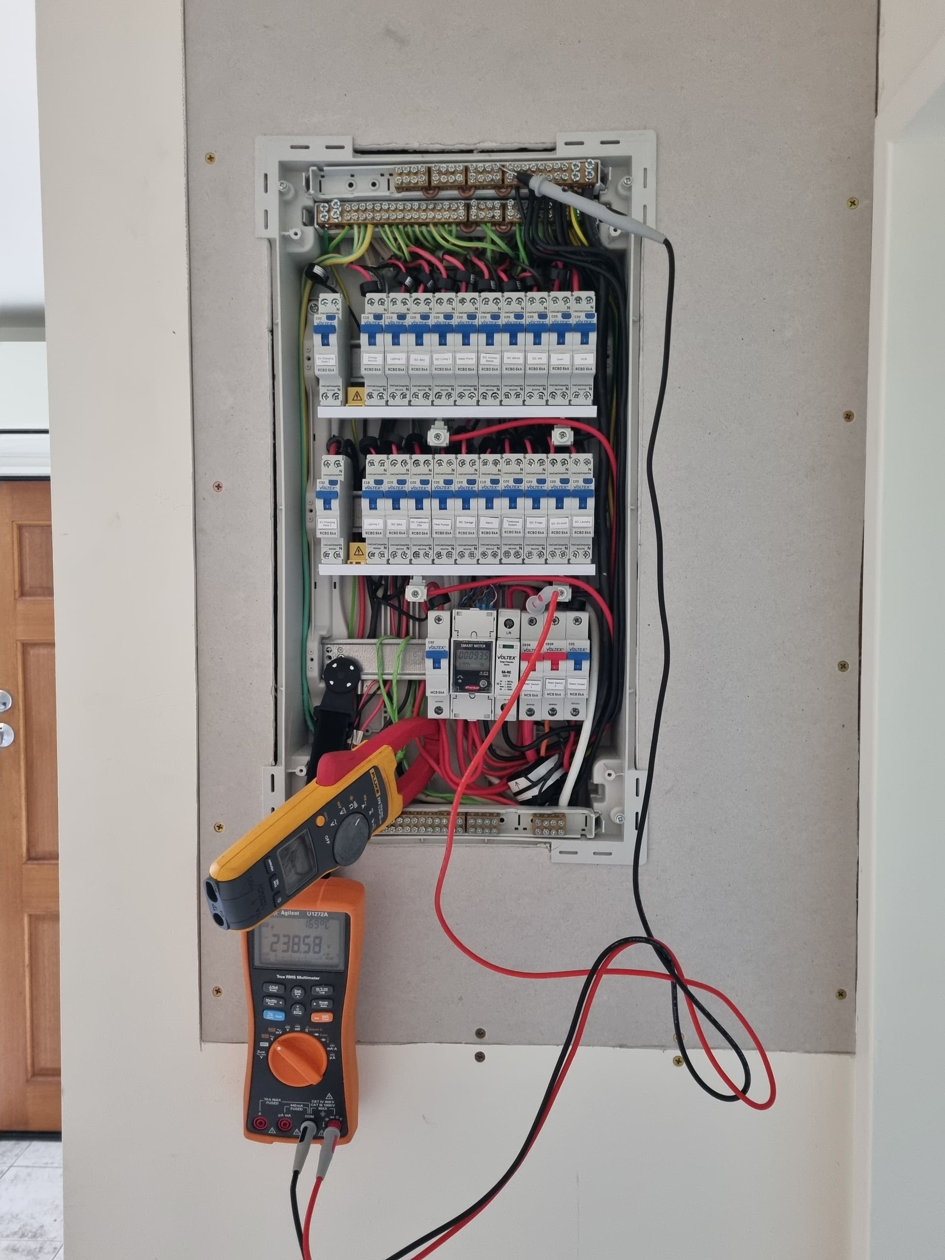

Oh, of course. You always need another multimeter. I’d say an AC/DC clamp meter is a good 2nd meter to buy and it’s always worth having two. I’m literally using my clamp meter on my solar inverter circuit right now while monitoring the voltage with my normal multimeter.

That’s how I’m using mine right now! Simultaneous current and voltage measurement to verify the power measurement from my solar inverter. There’s a discrepancy between my whole-house energy monitoring and the inverter measurement that I’m chasing down.
