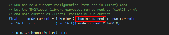

I’m wondering if homing current is just a FluidNC thing? Like it’s just using that config value for the run current while homing?
Also, I don’t really know what I’m talking about here beyond what settings exist in my Jackpot config.
It is. they switch the run current out if the movement is a homing operation.

That graphic refers to Hold current (not homing). Marlin also seems to have Hold current (also expressed as a fraction of Run current), but was unused by V1E.
no, it’s the homing_current…
That line means, if we are currently homing, use the _homing_current, else use the _run_current

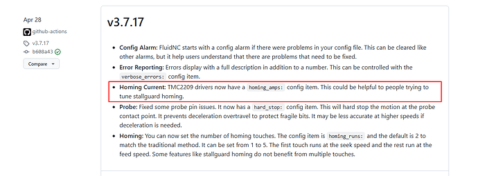

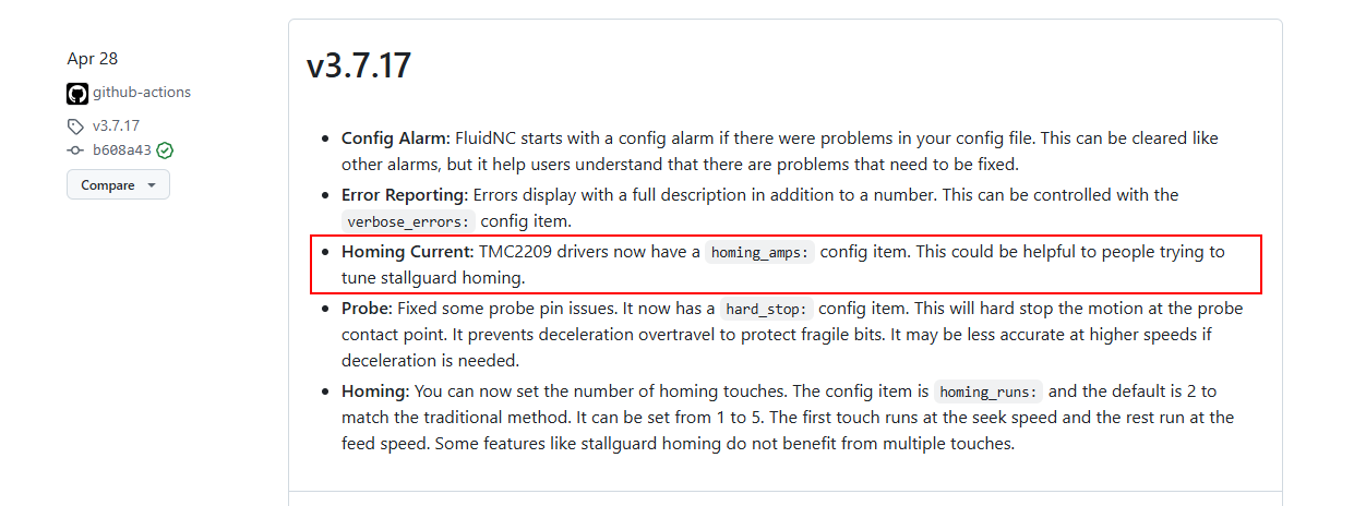

Just for reference, this was only recently added in 3.7.17
That is a feature of the TMC2209, not Marlin specifically.
It’s in Section 9 of the DataSheet as Jono linked above.
Hold Current is passed as a percentage of run current per the spec, but FluidNC lets you define it as an absolute current for convenience, then it is scaled as necessary. If you don’t set hold_current, it will use run_current
Marlin also has a homing current if you use sensorless homing, I suspect that is why fluid has it as well.
*edit, yup, thanks mike.

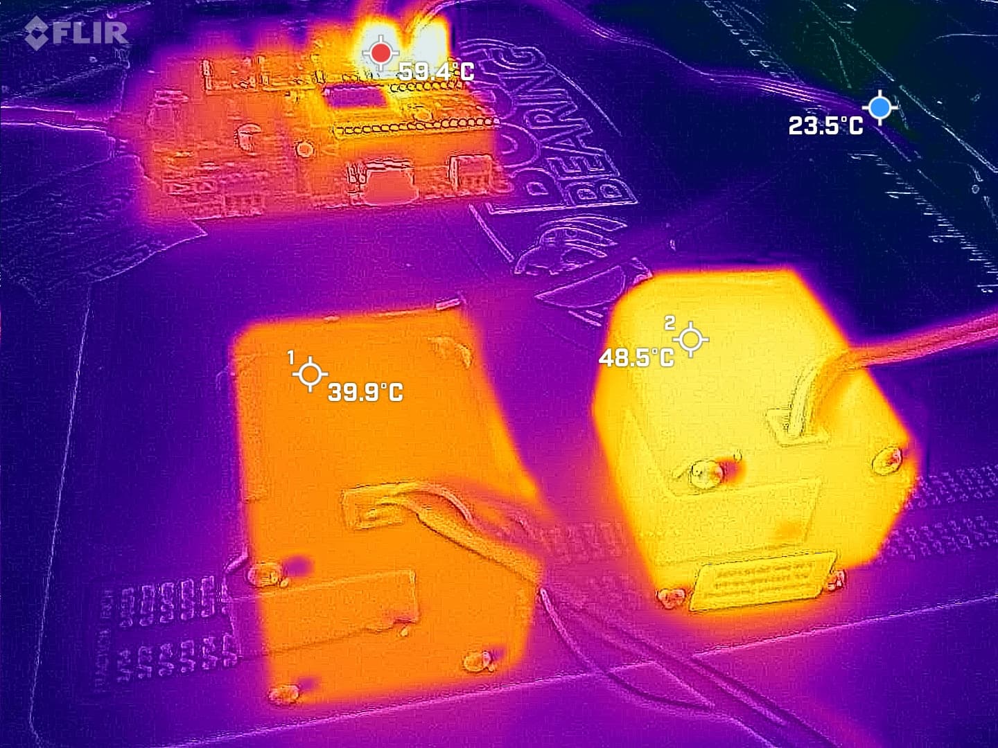

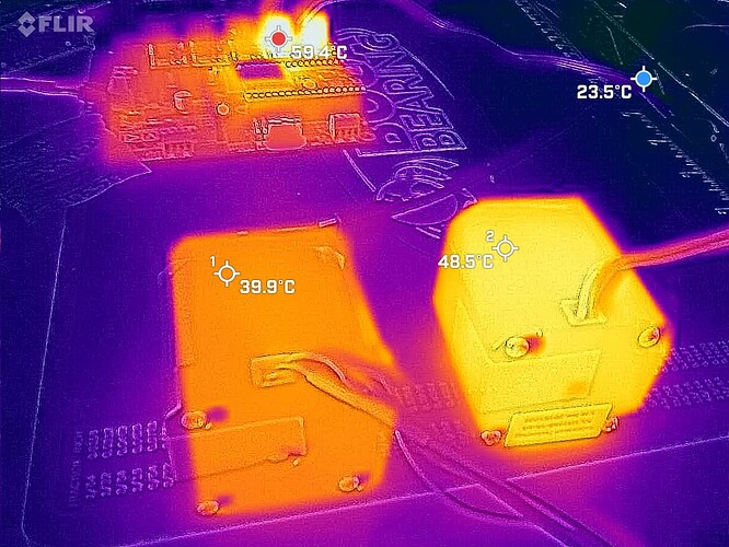

These are the two main steppers I have sold, the cooler one is the current (last year or so model. The right is the automation tech ones I used to sell.
They should be comparable torque at this setting. I know when had pit them against each other with a belt loop at some pint and they are tied.
The new steppers have more room to go up…but again, should absolutely not be needed. If you are skipping steps your CAM is most likely the issue, or a dull endmill.
Our Material removal rate is capped by system rigidity and always has been. We have always had larger steppers, drivers, and power supplies than we need. That is why I make new machine not just throw nema 56’s at the LR3.
Sorry, I was reading the green lines above
Is this also not for sensorless homing? (“helpful for people trying to tune stallguard homing”)
Agreed, but it has been implemented in Marlin (as well as in Fluid), which was what I was wondering

I just never trust the non-contact, never sure what it is reading.
In that picture I put up I have a strip of tape on both steppers. I was surprised to see it made difference.
Outside of this stuff I have no use for it. I would no buy on for personal use. Taking a picture and marking as many points as I want is very informative though. Room/surface temp, is always nice to include.
