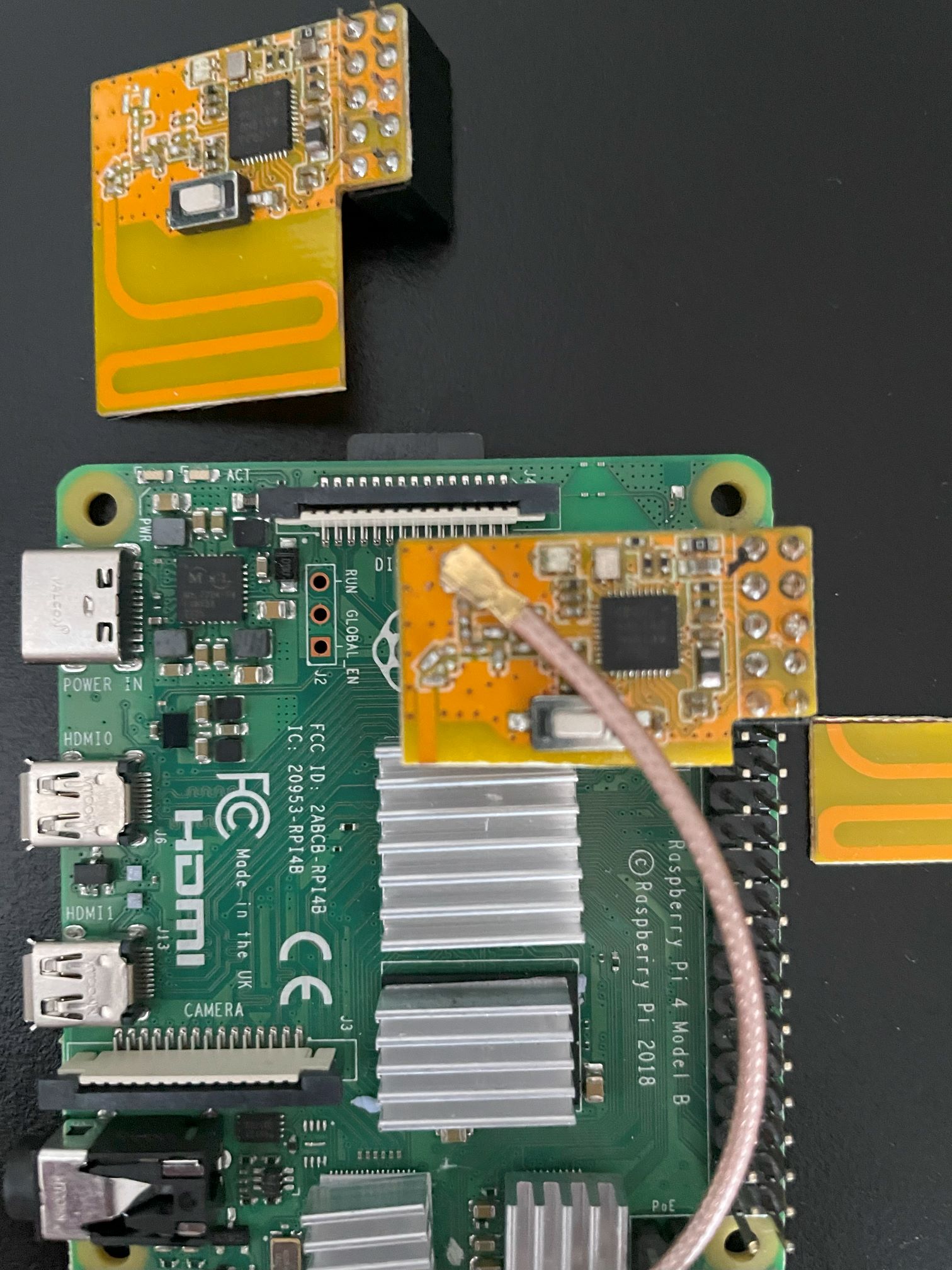

So… I have another Jackpot board for a LR3 I’m building for my son in-law. Went to set it up and it did not go well. Long story short the new board has to be with eight feet of the router access point to boot up on wifi. After its up and running the board can be moved and stay connected. After googling around about the ESP32’s there is a common thread about poor wifi on the boards. One problem is the antenna not being great. The other is a voltage drop on the board during wifi startup causing problems.
The boards are cheap enough, I’m going to try one with an external antenna. Also for using at my house I have four hardwired wifi access points in 1900 sq". So it will work fine at home.

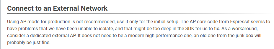

Fluid is recommending you only use STA mode on a router by itself.
Are you sure about that? In the wiki it says to use STA mode as it is more efficient. They only mention a router by itself as a means of use in case you don’t have an available wifi network already set up.
The way I read it, they just meant, even if all you have is an old slow router to connect it to, that’s still better than AP mode.

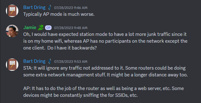

If you look a t the discord anytime we mention the issue they say STA is best on its own router otherwise AP. Jamie jumped through a lot of hoops with that.
I assure you AP mode is going to be your best bet.
I am sure technically STA is best, but only if you have it on its own private network.

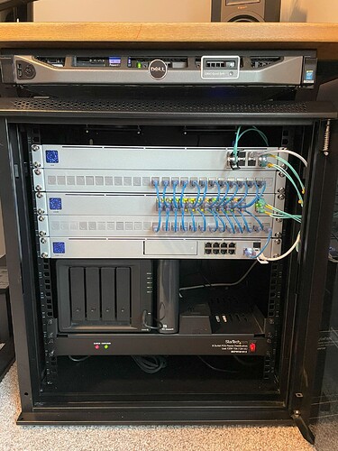

How are those APs configured? The ESP32 on my jackpot really didn’t like getting handed back and forth between APs, amongst the other things it didn’t like (busy network with lots of broadcast traffic in particular pissed it off badly)
Get a good pigtail and use a decent antenna (meaning a real one with an SMA connector). The little crap flex antenna that comes with lots of cheap ESP32 external setups is even worse than the built in ones because of reliability issues with the connector staying secured to the ESP32 and the antenna itself being garbage.

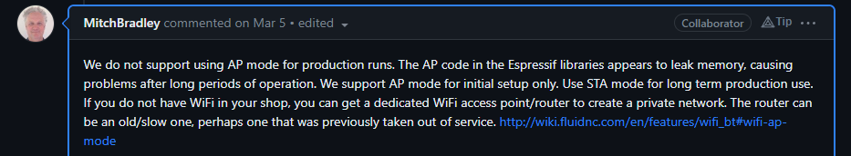

Those messages are before any of Jamie’s fixes got implemented, I think. I swear a little further down, one of them said something along the lines of “we only support them on their own router”. So I stopped pushing. I am also under the impression us not using a genuine espresiff esp is also not well received. So if you ask them directly, I am sure they will tell you to get a genuine chip for any testing.

If I didn’t have a strong wifi signal nearby I definitely would get a dedicated router and place it near, but I just spent the last 10 minutes searching through all messages in their help forum and github that contain “AP Mode” and have found many messages that are similar to
I am aware of the fixes Jamie put in and have them set in the config. I’d have to find the thread again, but I believe I sent you one where I was having low memory issues that I’m pretty sure might have been post 3.7.8. I think the 3.7.8 made the memory a little better, but still gave warnings. I switched to STA and they cleared up, so I haven’t looked back.

hmmm… I might have gotten carried away with my network.
Right now the boards are on my IoT VLAN. I could make another VLAN Just for the LR3 and 3d printer. That sounds like a good idea.
