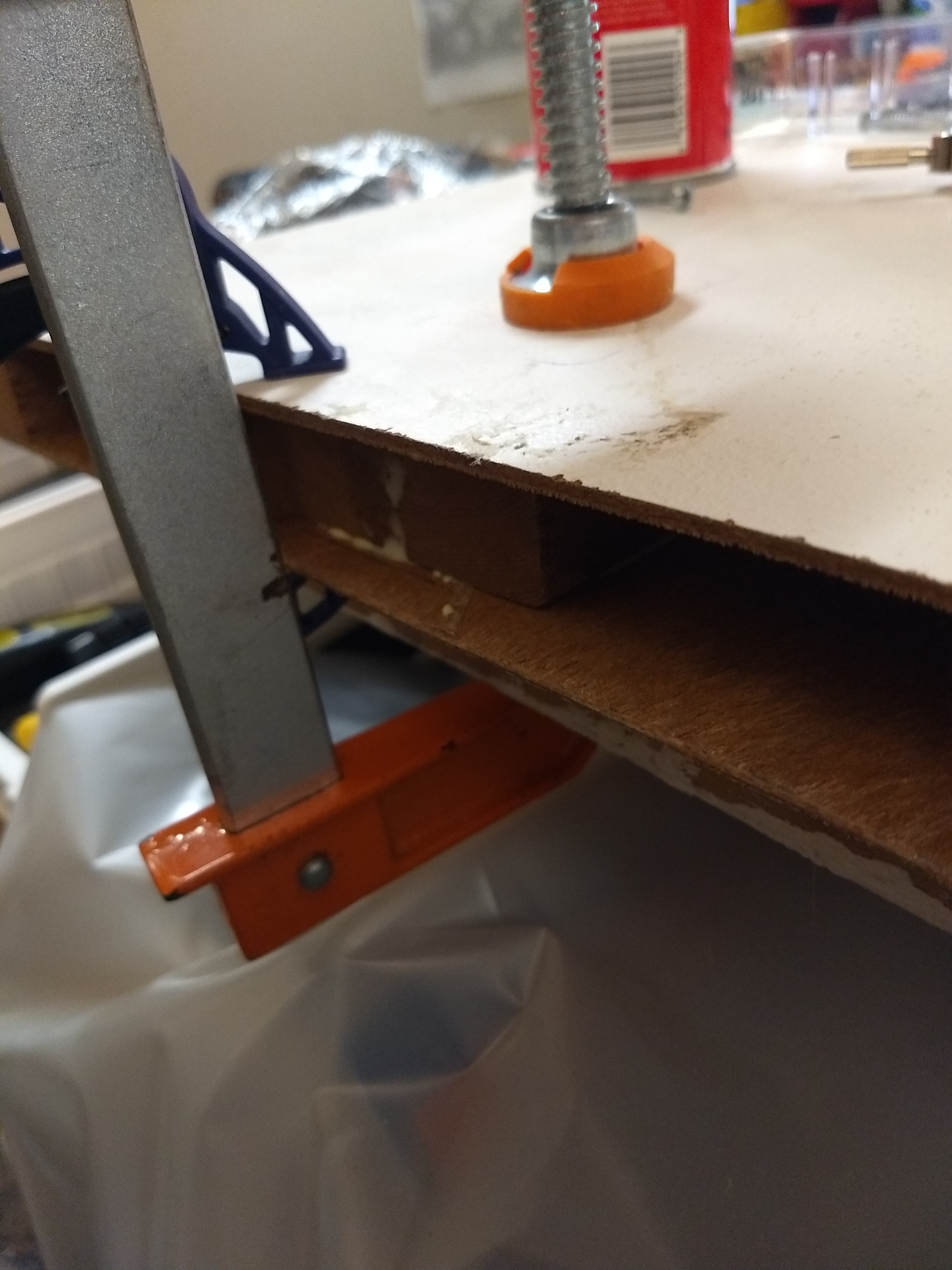

I had already cut the rails to fit the 24x24 composite panel, and I had already cut the door into thirds so it could be stored more easily hence the sizing mismatch.
The solid board on the bottom of the door was large enough to hold all the foot screws, but the upper two legs needed extra support. I glued in two blocks of wood under where the legs would go so they would have something to bite into.

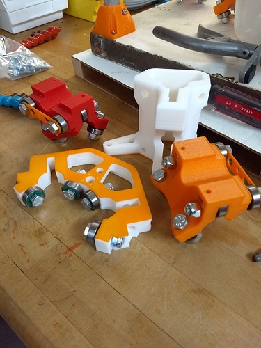

The full color scheme:
The color choices were pretty much a “happy accident” rather than anything planned. I started printing in orange and when that was almost gone I switched to white. White ended up having bed adhesion issues so I printed several"two-tone" parts where I started with orange and filament swapped to white.
I either ran out of or got sick of the white and then switched to red for the final parts.
Looks a bit like an Orange Dreamscicle.

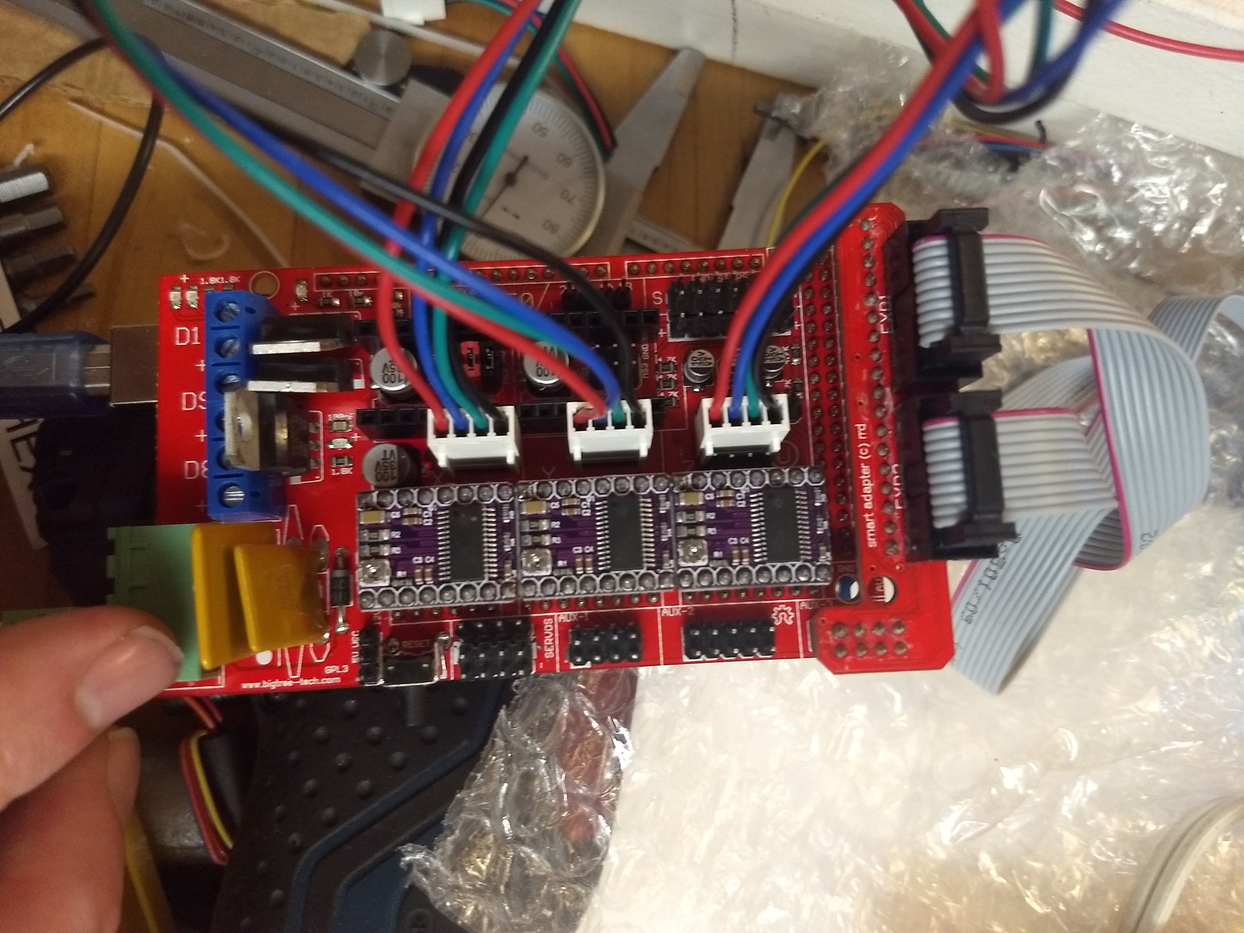

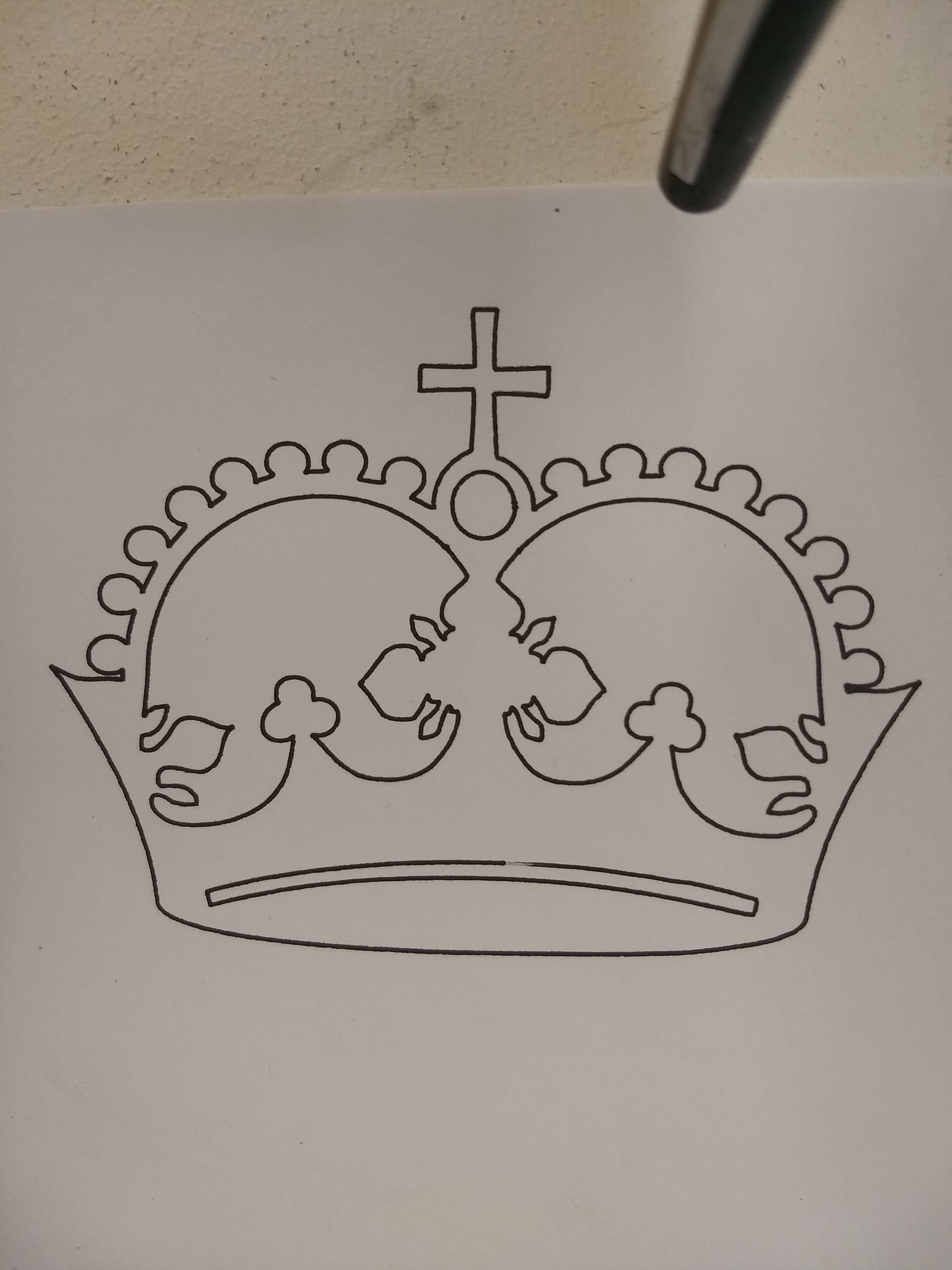

Progress report: printer assembled, wired, and connected to the RAMPS.
I’m trying to print the crown gcode but the Mega/RAMPS keeps resetting shortly after I start the job.
Any ideas?
I’m still having the intermittent freezes, but managed to complete one crown:
Can you share some pics of the controller?
I would be suspect of the mega and the power supply first, then a short circuit somewhere, but the short would probably make some smoke come out.
I tried powering it from a 12V/6A brick as well as from my bench supply. The 5V supply to the Mega is via the USB cable only because the 5V regulator on the board is toast. The pi there has octoprint on it, but control from there doesn’t improve things. I’m downloading the CNC.js image as we speak to give that a go.
It would be the 5V supply that would be suspect. It is worth a test to just power it from a good 5V USB supply without the pi involved. You can print the crown from the screen.
I remember some setting, for older pi versions at least, for increasing the current capacity of the USB outputs. But the pi might be taking enough off the top to make the pi power supply not strong enough to power the mega properly.
Thanks for the photos. I don’t see anything goofy, although I can’t see the power port coming in.
Thanks for the suggestion. I’ll swap the 5V supply for the Pi with a “known good” one from my 3dPrinter.
If you can do a quick test, I would try it without the pi too, maybe first.
I really admire your sensibility!! Can I suggest an addition to the thread title? “A history of falling down the rabbit hole”
I reflashed the Mega and reverted my #define EXTRUDERS 0 change. Bench test with no drivers completed without incident.
Reinstalled drivers, reattached steppers, added 12V power, and the crown just completed successfully!!

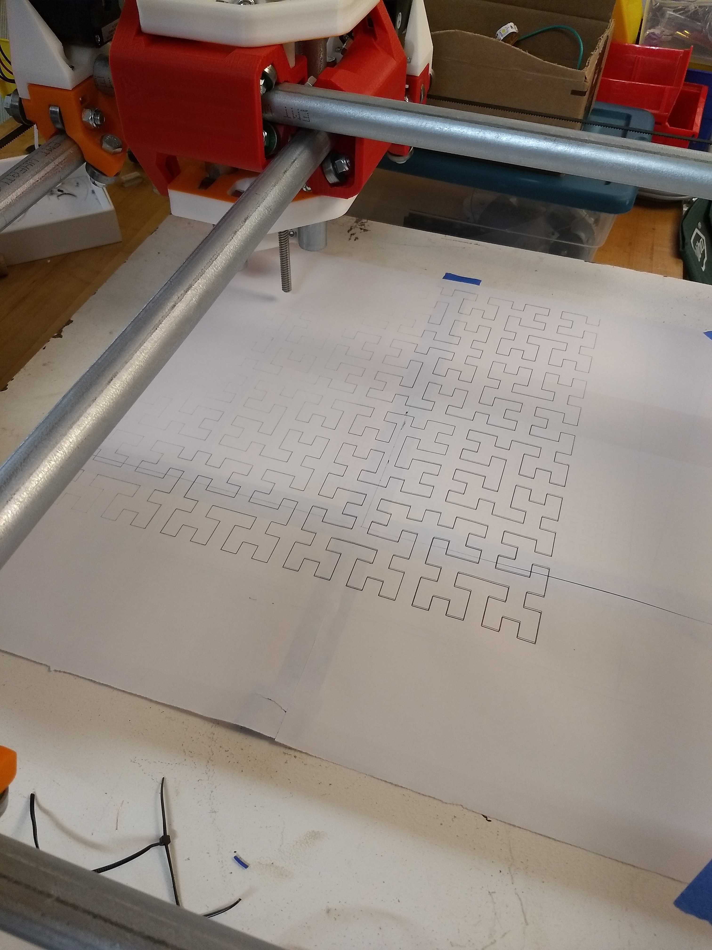

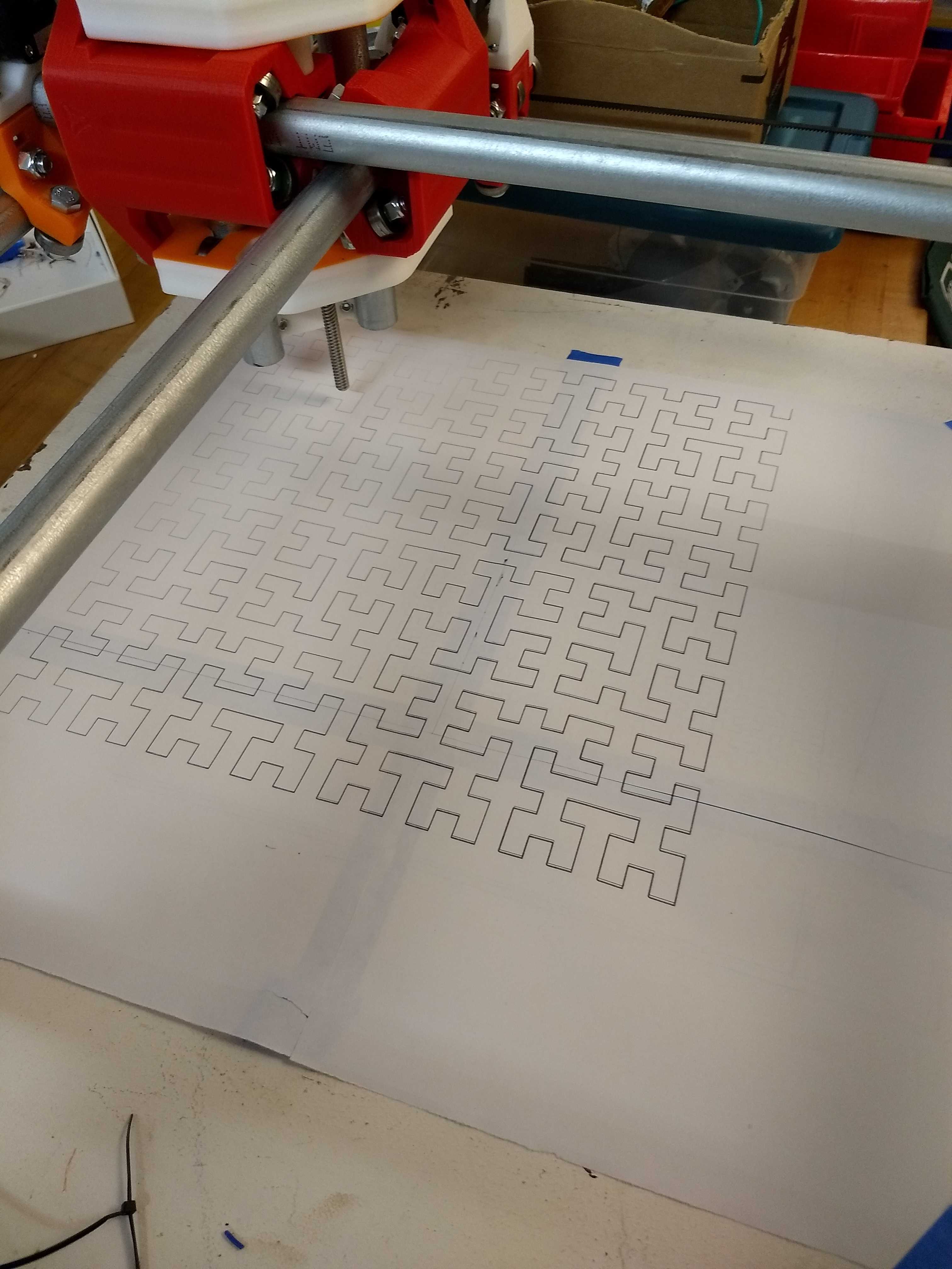

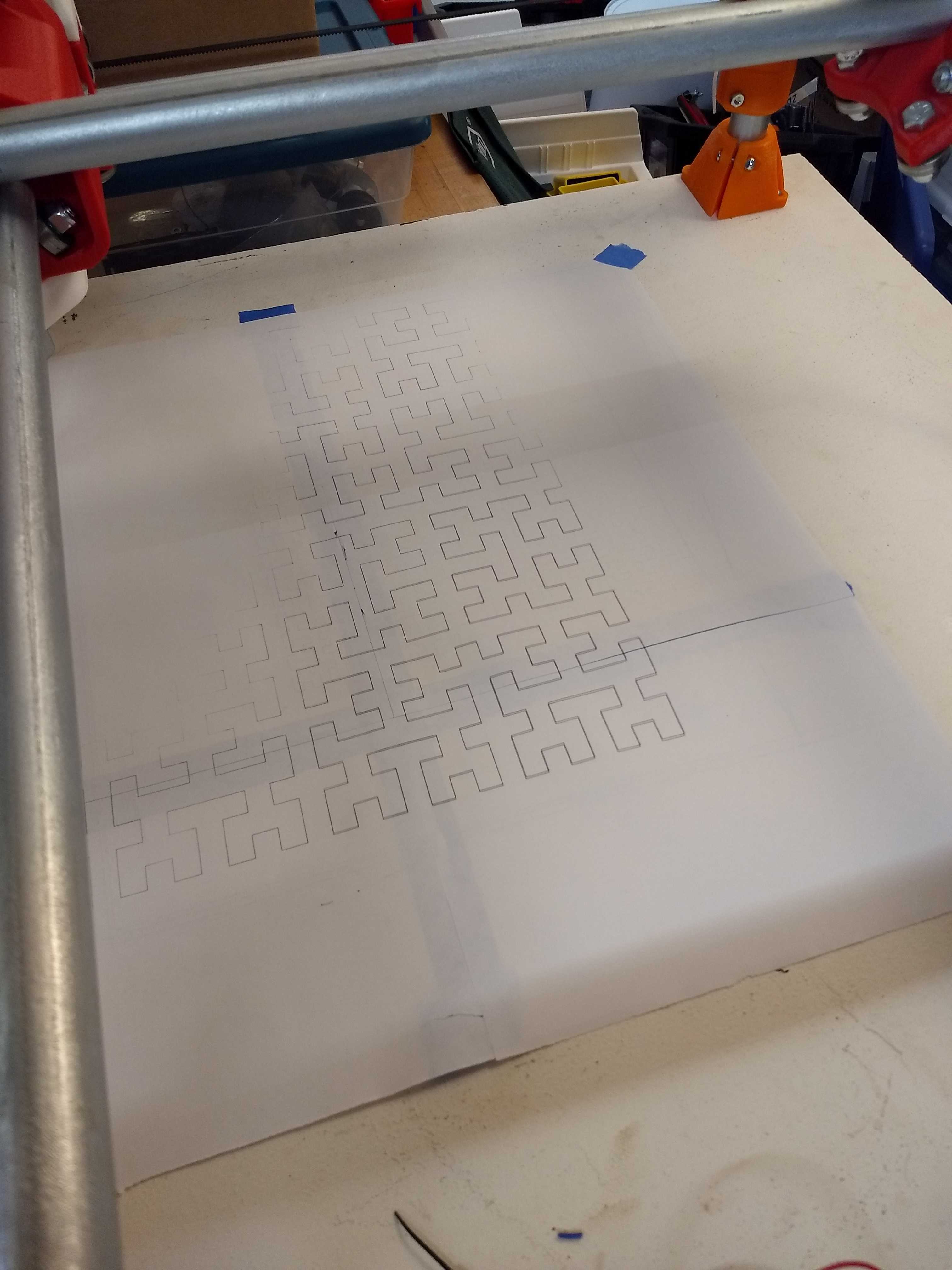

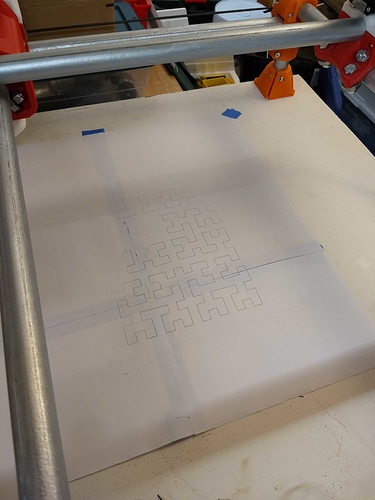

Checking the state of the ‘bed’. Each iteration of the pattern is .2mm lower than the previous run.
So the bed has a definite diagonal ‘slope’ to it, but less than 1mm corner to corner. I’ll play around a bit more with the leg lengths, but even if I don’t get much improvement I’m still pretty happy with what I have.
I love that idea. Did you use sandify to make that pattern? There are a lot of neat patterns it can generate to do this. Excellent idea.
No. I grabbed the script from here: https://hackaday.io/project/169033-gcode-playground , edited out the import turtle dependency and upped the size so it was 300mm square.
