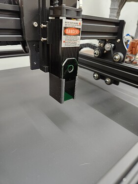

Speaking of safety. Trying to be a little safety conscious, I made this shroud for the laser. I plan on setting it so the focal point is 1/8 in from the bottom of it. That way I can adjust the height easily and still keep the gap around the bottom pretty small. I used #2 screws to attach it the laser. I found it easiest to focus it before attaching as the opening is pretty small once on.
https://www.printables.com/model/292493-cenoz-laser-shroud
what is the green lens you used?
I was going to ask a similar question - Does anyone know the wavelength of the stock laser? I didn’t see it in any of the paperwork, but I may have overlooked it. I was looking at purchasing safety glasses (Not sure I trust the provided glasses + handheld monocle.
I just cut up that round “monocle” thing they sent with it.
Because it is a blue laser, it should be between 400 and 450nm. It appears orange or red are the most common for that light range but green can also cover that range.

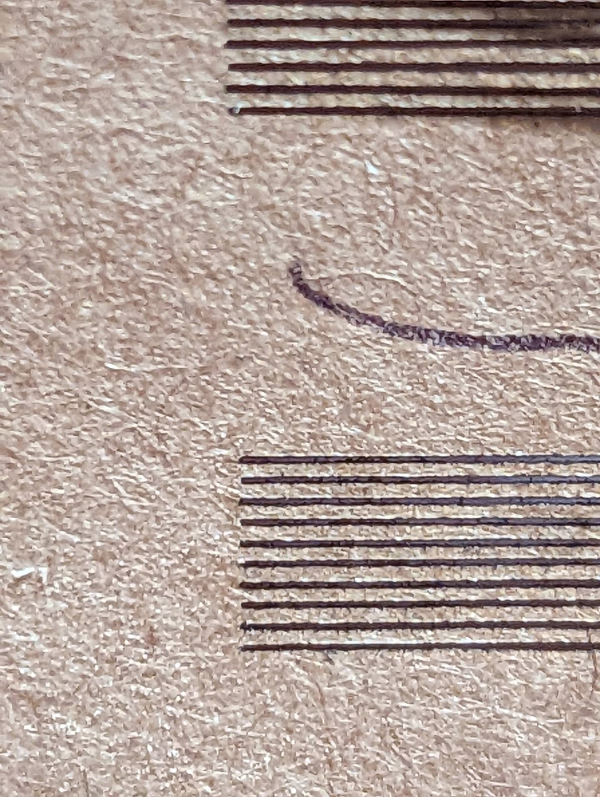

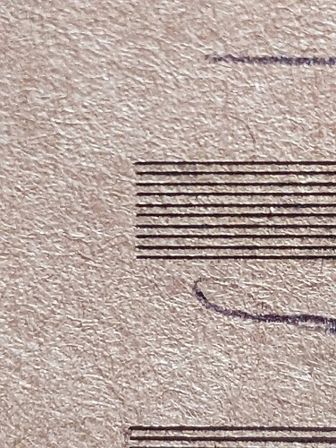

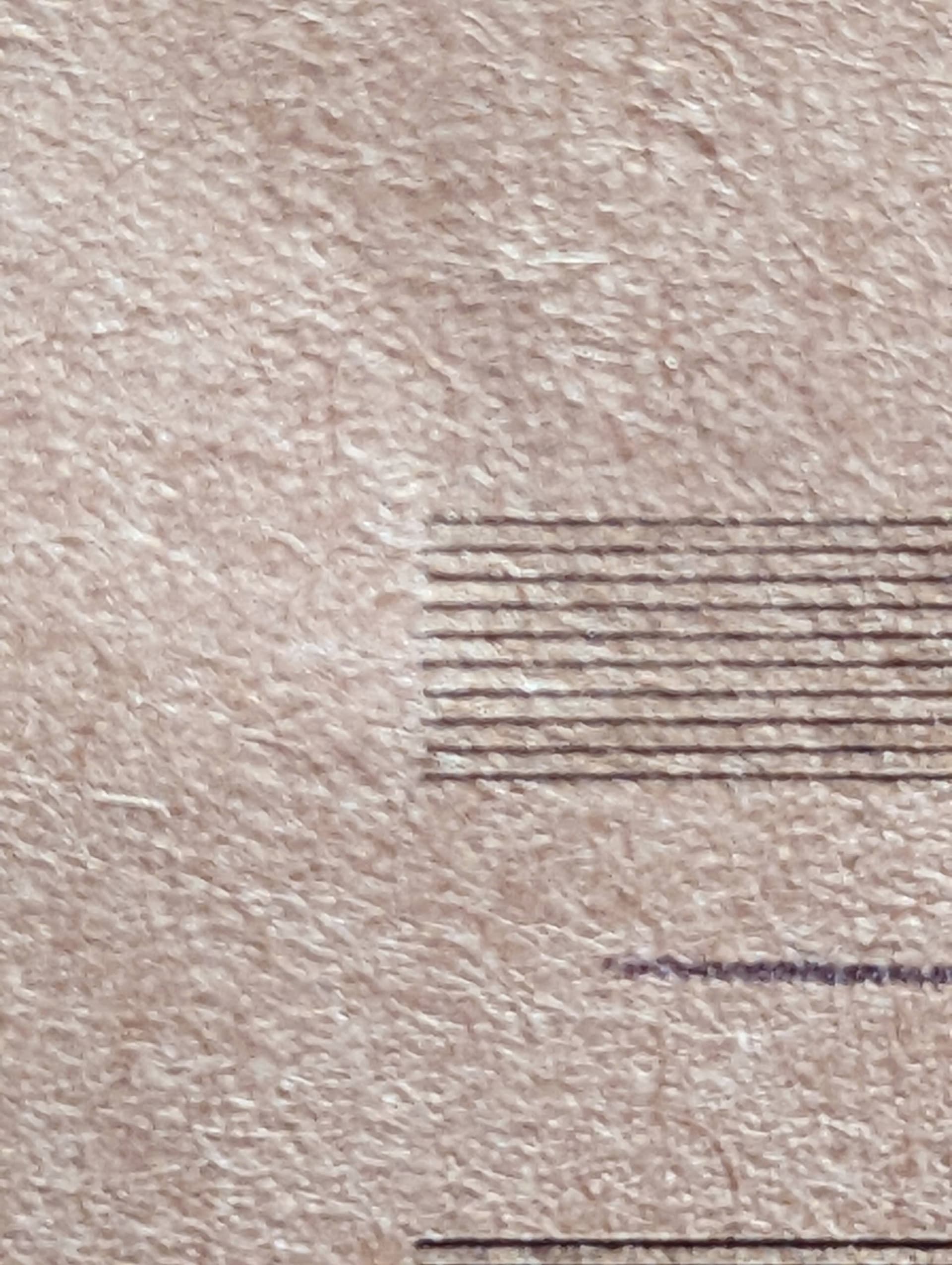

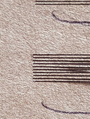

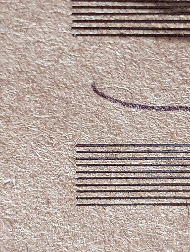

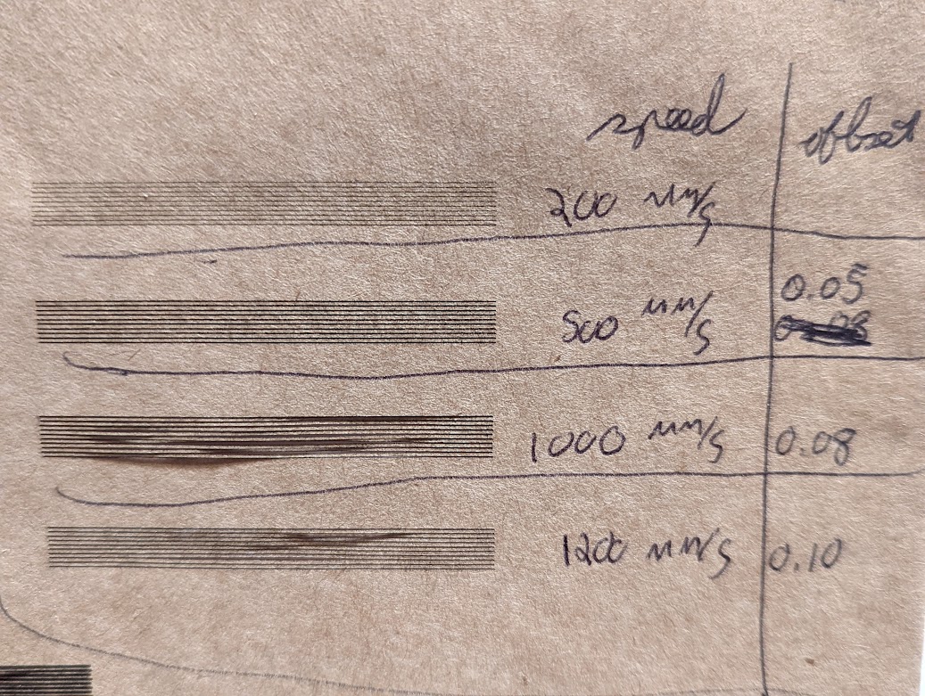

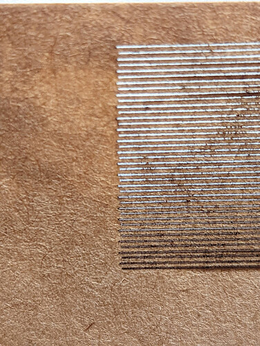

(All speed values are mm/min - not mm/s as I have handwritten)
No Offsets 1200 mm/min 50mm x 20 mm box
Played around a bit to get it close. I think I can still see a bit of room for tweaking but its pretty close to correct. 50mm x 5mm boxes

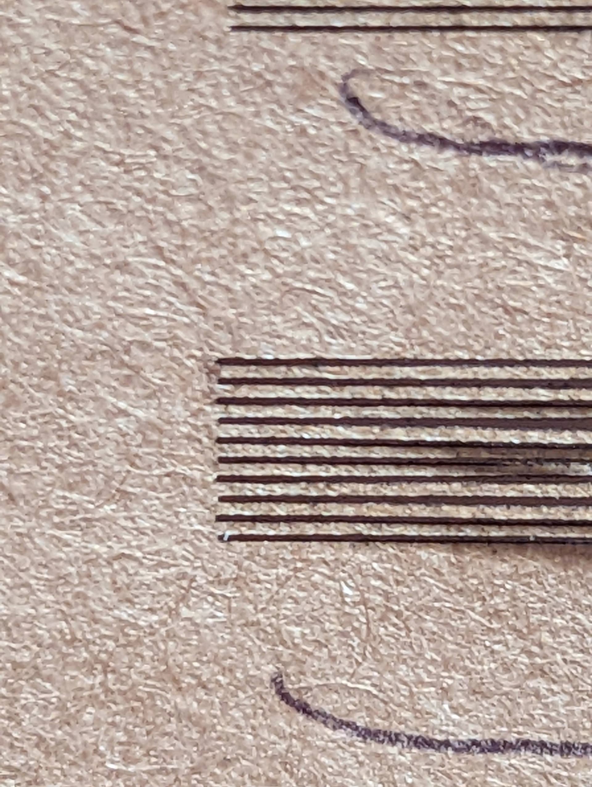

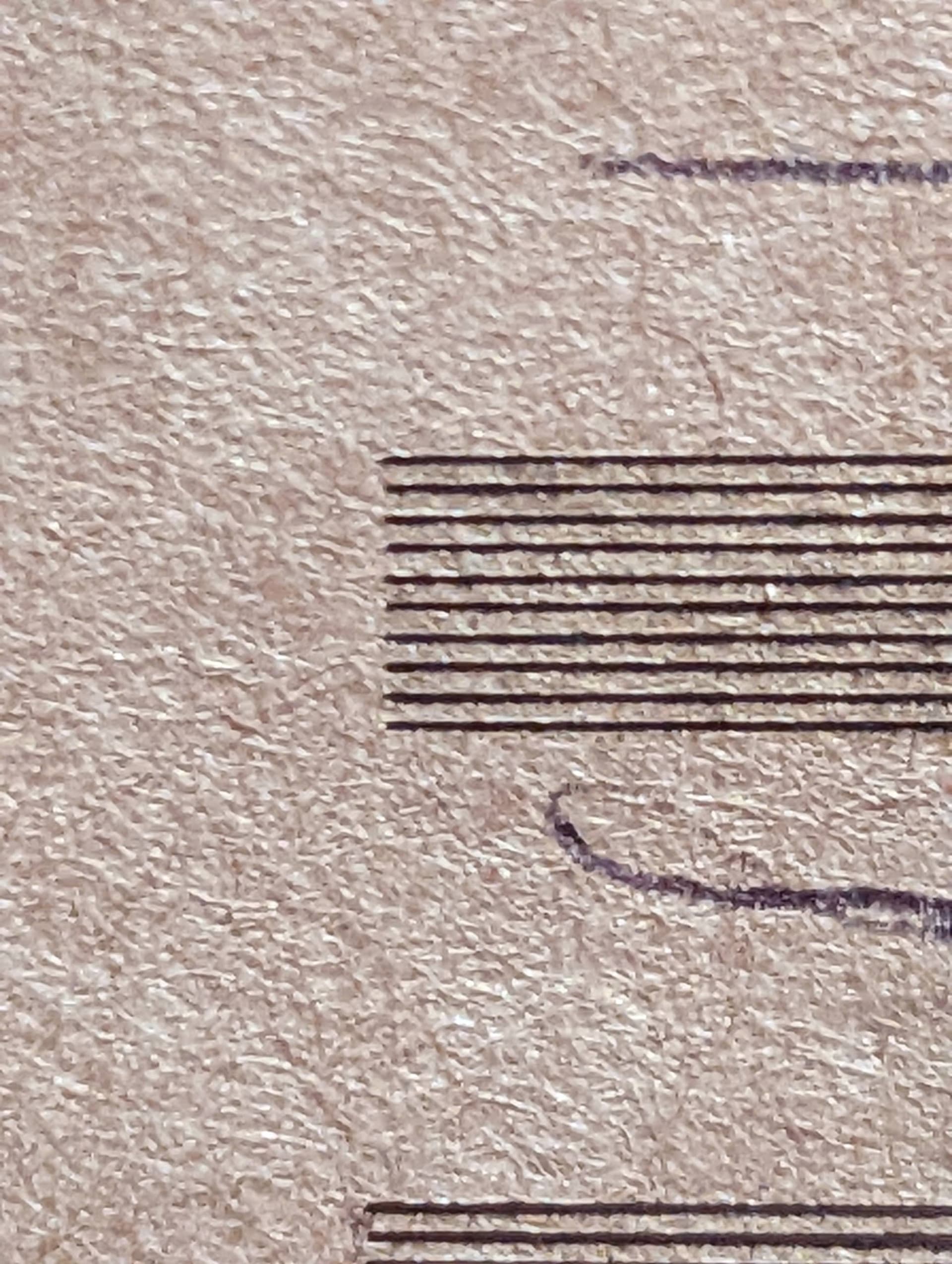

Close ups
1200mm/min 0.1 mm offset
1000mm/s 0.08 mm
500mm/min 0.05 mm
200 mm/min Lightburn autoscaled offset
I assume your values are mm/min, not mm/s. In your first picture, and the one labeled as 1000mm/s, I clearly see offsets. I do my engraving at 1920mm/min (32mm/s). Assuming these values are mm/min, not mm/s, your results are similar to what I had at 1200mm/min (20mm/s). Correcting what appeared to me to be minor offsets made a huge difference in the quality of my results…no more double lines.
You are correct, mm/min. I edited my post to say that as well.
