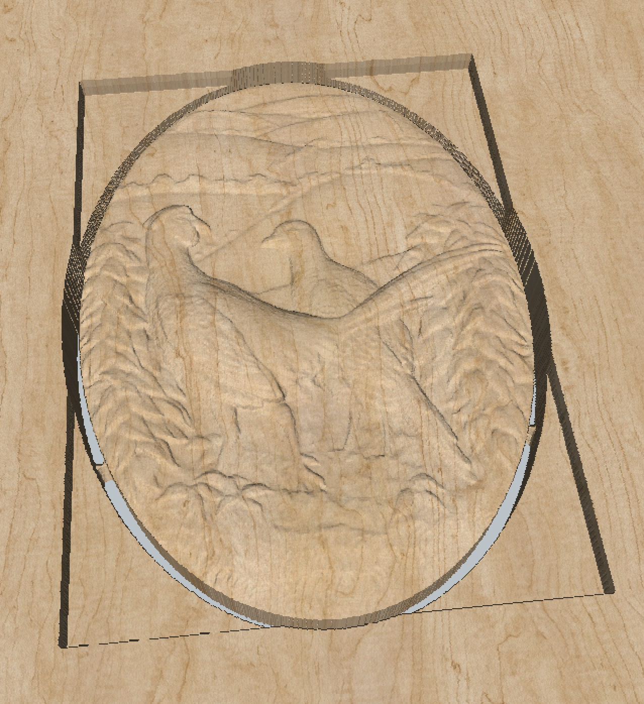

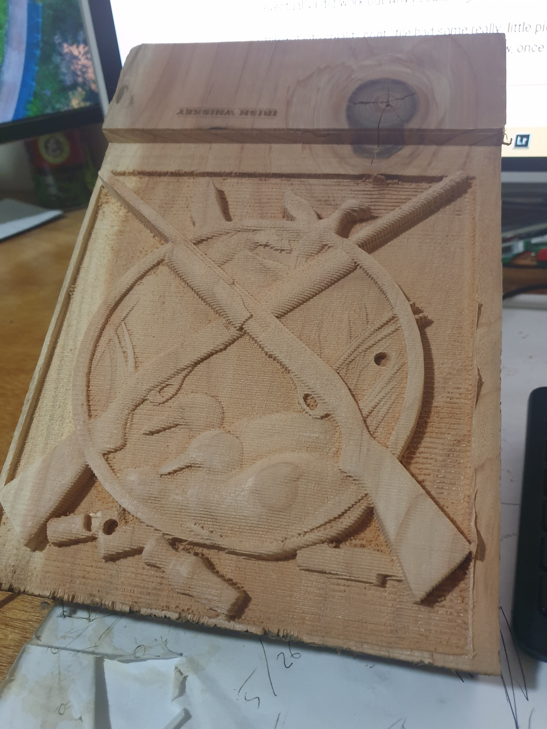

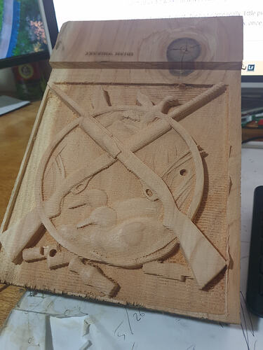

eventually i did work out why i couldn’t get my trial file to look right
threw it into creality print , file had some really little pieces sticking out the back and also poped up saying needed repair, once i deleted them repaired file and reloaded it into MM it previewed right
i did stuff up my radius in tool which stuffed up what my step over was, hence all the lines but hey 1st trial, old saying practice makes perfect ,
def some cool awesome software you have all developed :
That looks really good for a first try Terry. Where did you find the STL? I’d like something similar with Pheasants on it.

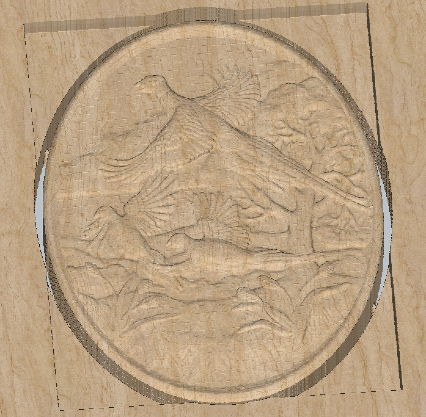

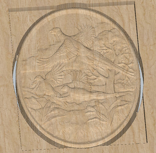

I found a couple of files with pheasants. I imported them into OrcaSlicer and repaired them. Then I imported them into MillMage and set up the relief carves. They look good in the MillMage preview. It’s too hot (103ºF+) to work in the garage now, so I’m not sure when I’ll get a change to run them on the LR4.
Is it possible to keep the dish but make the pheasants come out (higher z)?
You would have to modify either the stl or the depthmap to do that. I’m not sure how to do that.
