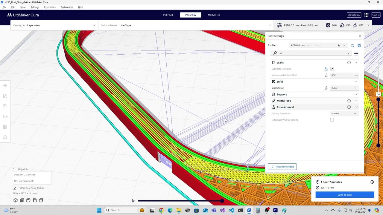

Roughly a third of the parts on the two LR4 builds I did were printed on my Ender 3 Max, largely without issue. Printer was tuned using Teaching Tech’s website, and then Calilantern recently. Majority of parts were printed on my V1E MP3DP v4 running almost twice as fast. All parts were sliced using Cura, something I’ve been using for a few years now. I plan to switch to OrcaSlicer, but, squirrel…
Some things to look for when slicing…
Shared profiles that worked for me, hopefully some of the settings in there help. Please do NOT blindly copy, paste and use. I am no 3D printing pro, and would be more than happy to see someone respond with better profiles for folks to benefit from.
Good luck!
Thank you for the great explanation on how to look through the slicer. I have unfortunately in the past blindly trusted the slicer and maybe I should look into things a bit more!
This is also where I think some of my problem lies. I have used one of the profiles I got from a youtube video that was great for speed, for some time. So many options to play with in the cura slicer, I am sure I have clicked on the wrong setting many a time!
I also should look into the 6mm nozzles. I am rocking 4mm nozzles at the moment!
