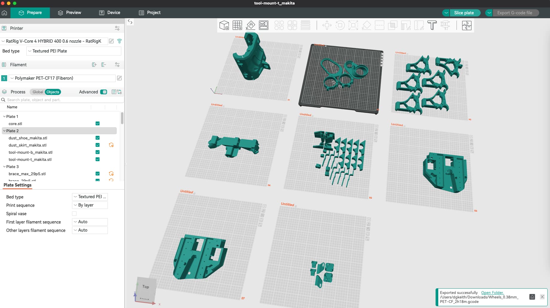

There are so many things. Some little, some big. Too many to even think of all of them or list them. Multiple print beds in a single file, easy for laying out sets that take several parts on several plates. Love how when you save, it by default saves a .3mf project file with the name of the first model part dropped on the bed, in the same file folder location where the model is located. I like how it is laid out. I like how well it supports Klipper and remote transmission of files. I like how all the arrays of printers, arrays of print profiles / nozzles / default layer thicknesses, etc, etc are. I like the “tree” organizer thing for all the project’s print beds, parts on those print beds, etc, and how easy it is to select multiple parts for moving, grouping, changes to infill or whatever. I could go on and on.
I need to learn how to use more of that. I just liked the fact that it didn’t do weird bridging and made that calibration super easy
I love this feature. For those that haven’t used OrcaSlicer, here’s my layout of the LR4 part. Each part can be selected and assigned override parameters. So for instance, the infill on the wheel parts override the global setting of 30%. Similar with the core. But if I decide I want to change the global print or bed temp, it affects the whole project (even if I don’t want to change it in the filament profile.)
Just select “slice plate” to get the gcode for each batch.
This is an awesome feature, likely old news for the Bambu users.
I like bambu studio at the moment.
Bambu and Orca are very similar.
I used to use cura and I still do sometimes for my older printers, however, bambu studio has a nice feel to it.
That really seems like a neat feature. And how huge is your build plate?
I got a 400 x 400mm bed so I can have room to use a second extruder (IDEX) for mirror or copy operations. A bit of a splurge but loving it so far. I can load up so many Gridfinity bins!
