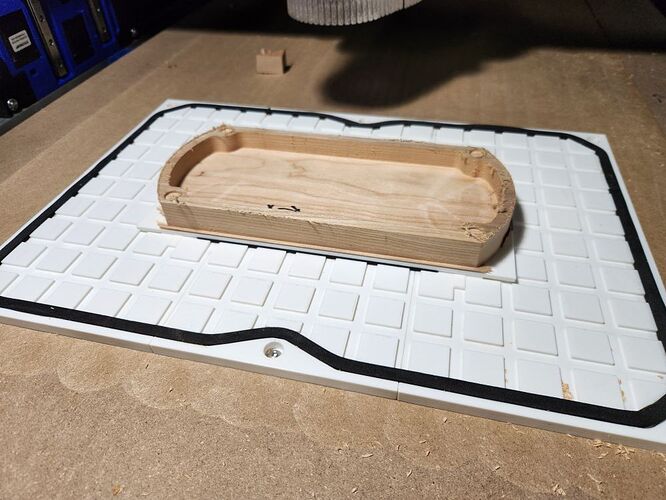

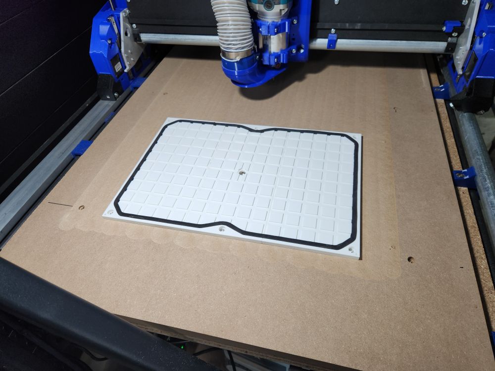

I used this simple vacuum holding pad to great success on my LR3. When it came time to build the LR4, I also wanted to upgrade my vacuum setup.
I drew heavy inspiration from the Air Weights vacuum holding system. I was very close to pulling the trigger but I just couldnt shake the thought of crashing a bit into one of those really expensive tables, so I decided to try a few ideas around building my own improved setup and the rabbit hole began.

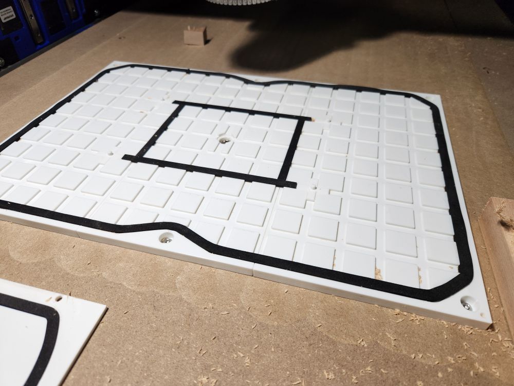

The table is assembled from a selection of modular tiles, allowing you to build it to any size (within reason). 1/4" x 1/8" cloased cell foam strip is used for gasket material. It can be permanently installed around the edge of the finished table, but can also be press fit into the grid to create temporary smaller vacuum areas.

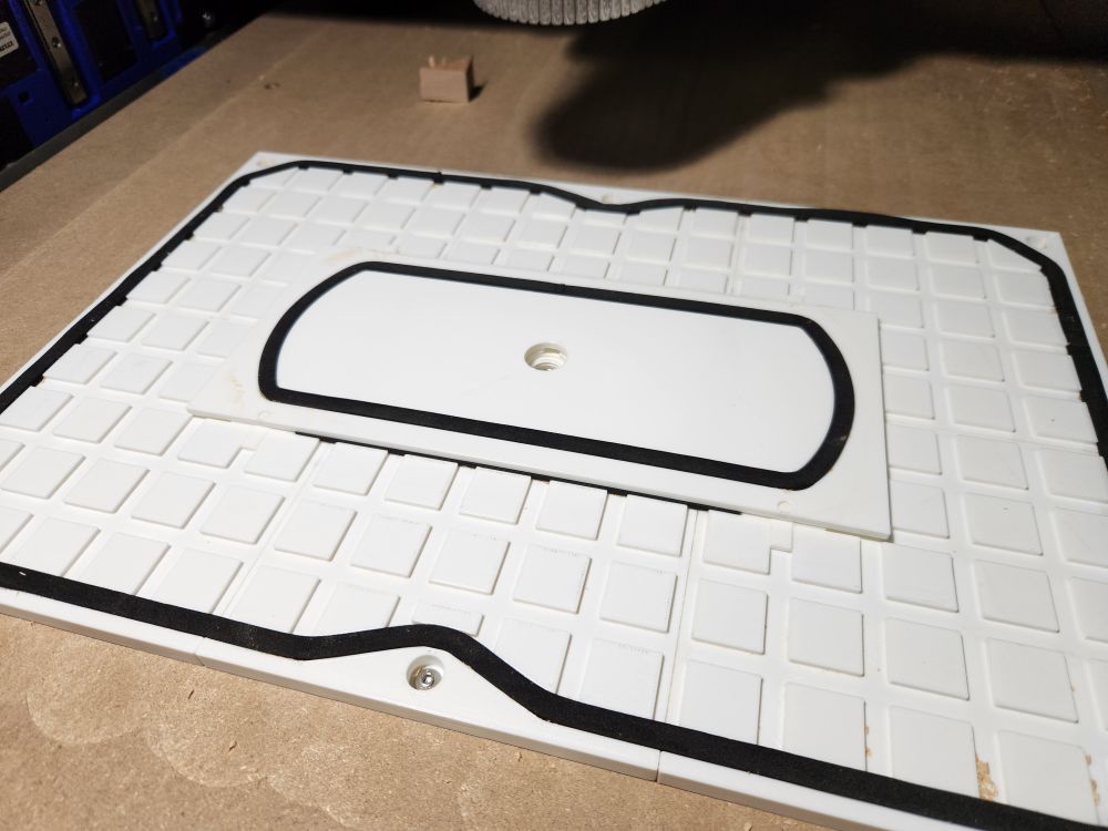

I also wanted to build in some features to make repeated jobs as simple as possible. Most of my work involves making runs of the same jobs over and over, so any time I can save swapping out stock is useful. The table has slots for 3mm dowels on the corners for mounting fixture plates. I also designed some 3d printed fixture plate alignment pins which can be slotted anywhere into the table grid. This allows you to build a custom fixture plate which can be positioned in the exact same place everytime on the table.
You can see an example of a 3d printed fixture plate I made for a small box here.

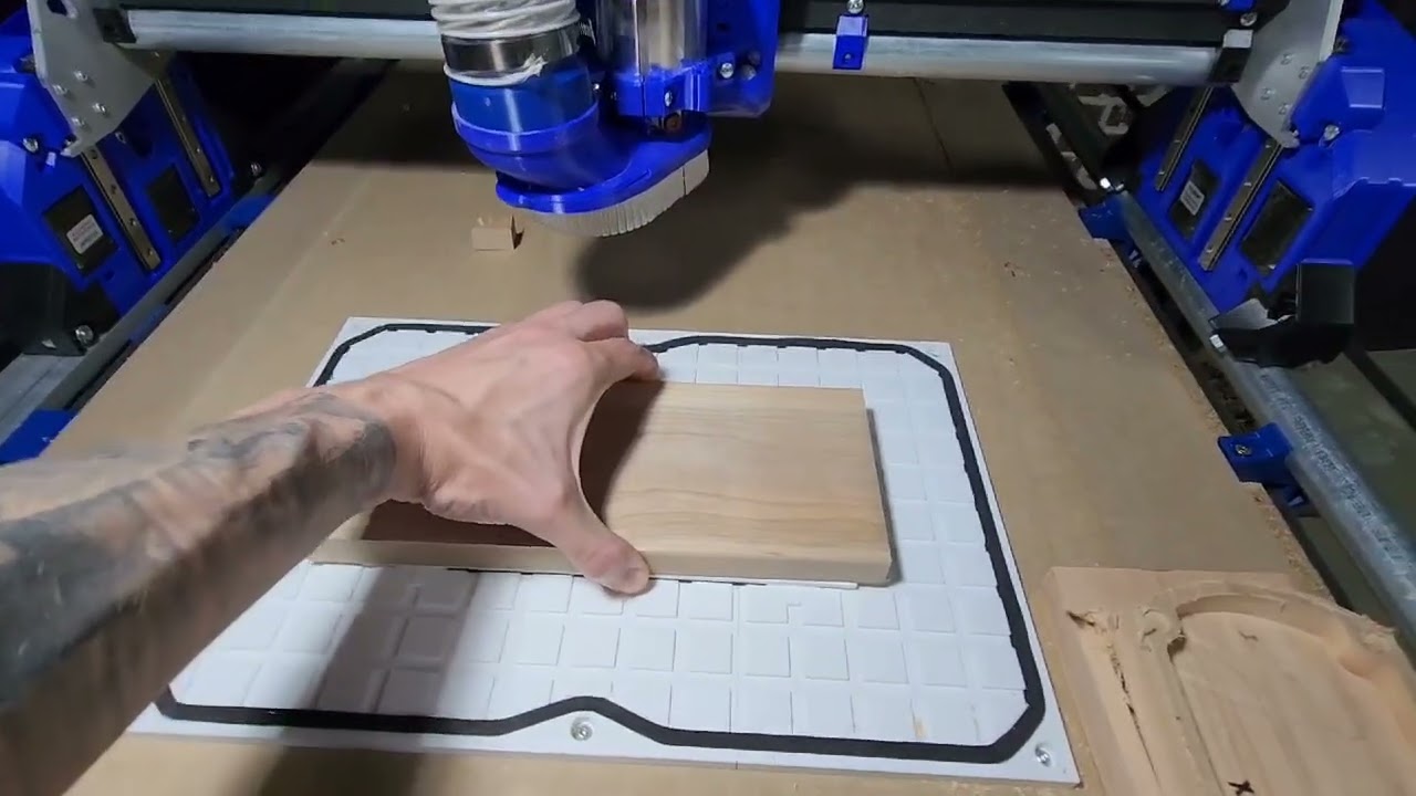

The vacuum table is attached via m4 screws in threaded inserts in my spoilboard. Because I had the CNC cut the hole for the air tube and the threaded inserts, I know the exact center of the table. This means that if I set the origin of a job to start centered on my stock, I know the XY start position for my tool automatically for any job I am running on the table. Its nice to have a quick macro to center on the vacuum table and not worry about jogging to a start position with every new job type.

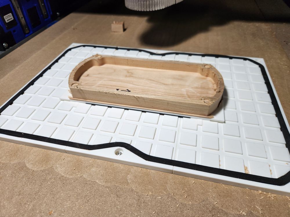

By offsettin the gasket on the fixture plate slightly inward, I can cut all the way through the outside of the part without breaking the vacuum. This eliminates the need for any gasket style spoilboard, so long as you dont need holes in the middle of your part.

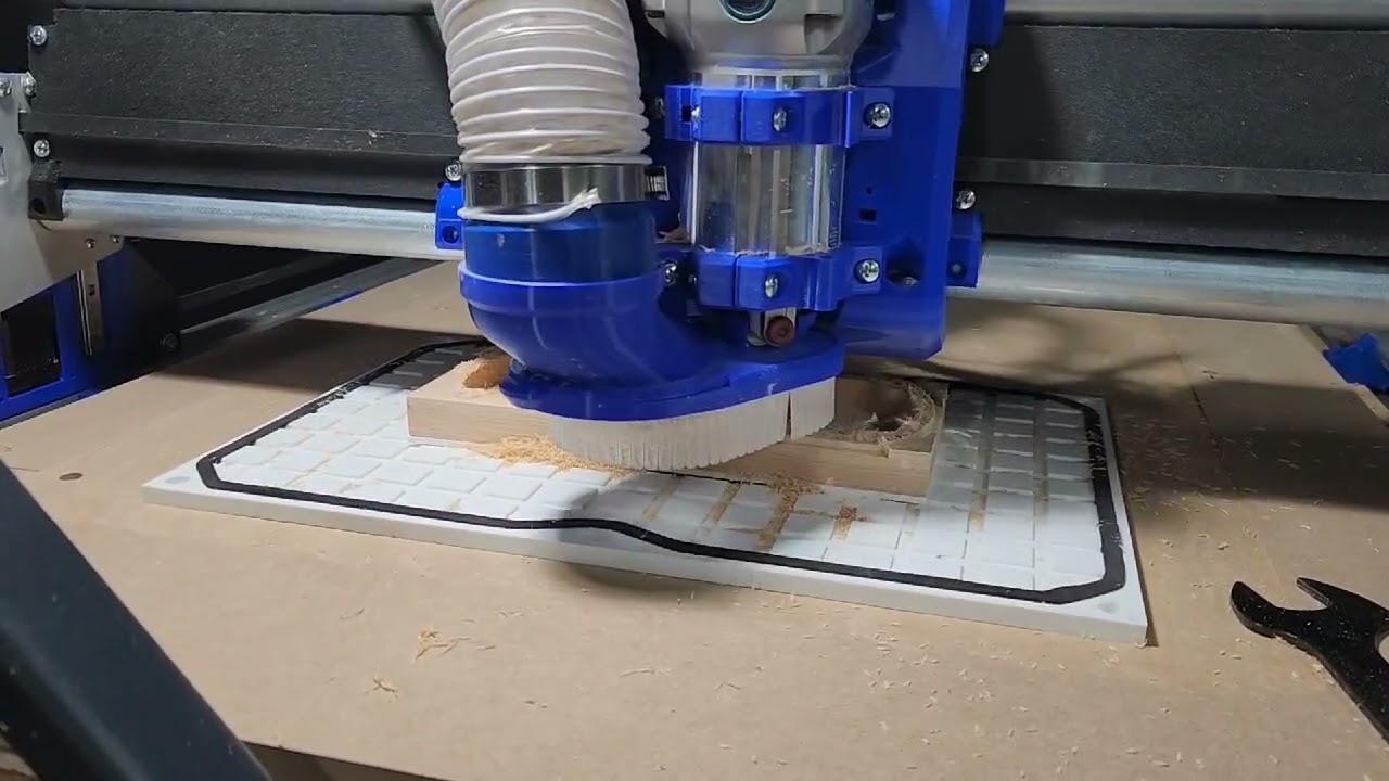

The hold has proven pretty strong, even on my cheap amazon vacuum pump. My table starts moving well before the part does.

Don’t you lose the vacuum when you cut through the part? I’m trying to reason how that would work
Yeah absolutely. In this case I am using a fixture plate where the gasket is offset about 1/4" inward on the part. I’m cutting out what is essentially a tray here so the only through cut is the contour operation to cut out the final shape. This final cut stays outside of my gasket, so the vacuum area remains intact.
There are techniques for through cutting which I have used pretty succesfully in the past. You esentially punch a bunch of holes into some kind of foam material and glue that to a 1/4" sheet of MDF. It creates a series of individual suction areas which let you actually through cut. This is an example from Air Weights but I have made my own version of this with some leftover tool drawer liner that worked well for quite some time.

I’m printing parts for this now. I was curious how the custom fixture plate is designed. I see how you have the pins and holes for exact positioning. I can’t quite figure out what the underneath side looks like. I’m guessing it’s just flat and sealed by the gasket in the main base plate?
I’m just experimenting with adding a small vacuum section of my table so I can cut out small parts without having to deal with tabs. (I realize there are other ways like painter’s tape and CA glue but this seems like more fun.) Ideally, I’d like to have a custom fixture that is slightly smaller than the finished piece so I can cut the outside all the way through without cutting into the spoilboard or the vacuum fixture.
