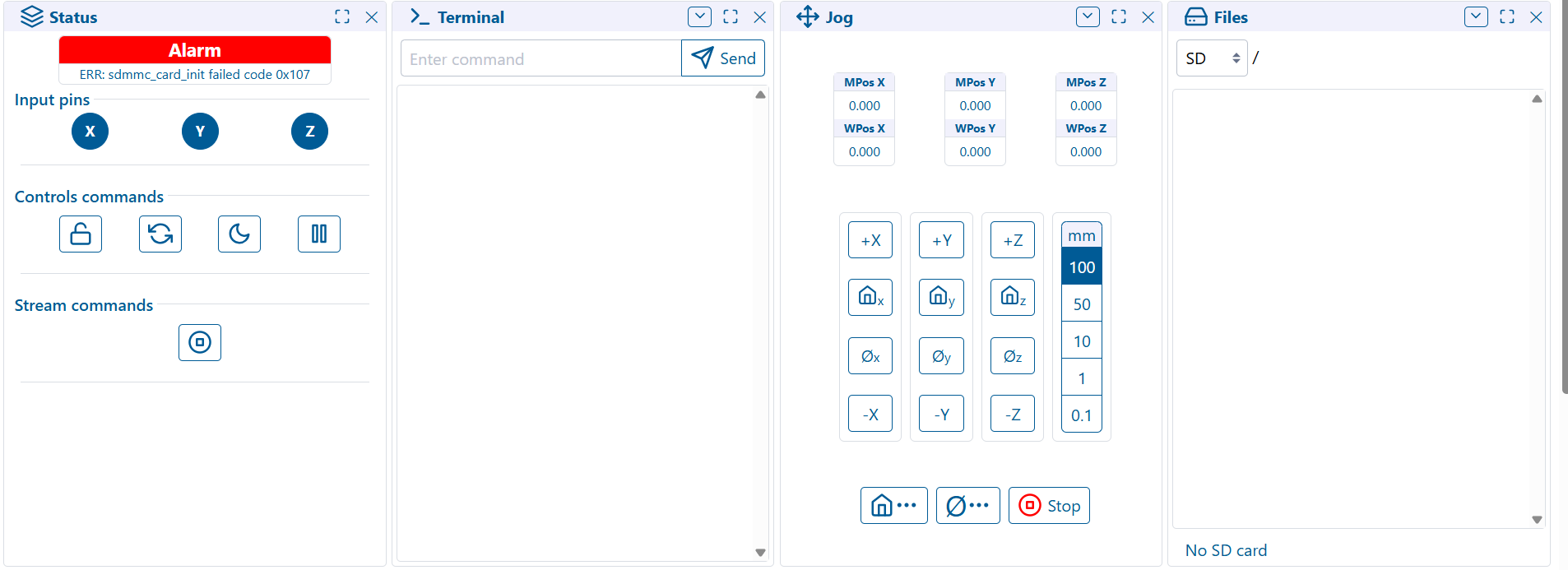

3 different controllers and 6 different ESPs showing [MSG:ERR: sdmmc_card_init failed code 0x107]

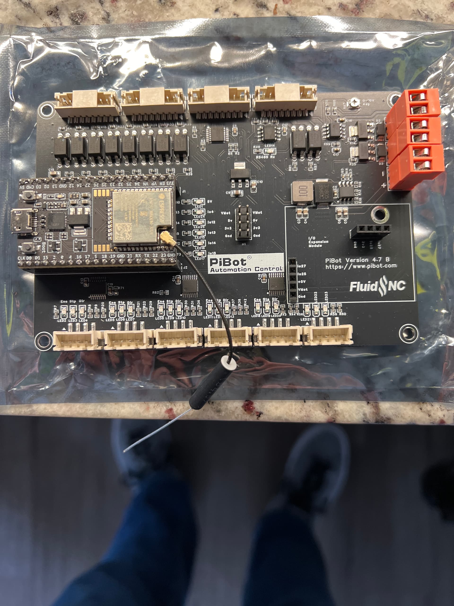

Assuming I broke the board when I repositioned the capacitor, I decided to try on a couple of pibot 4.7B boards I got when the first board died. These are stamped with “modified from 6X CNC controller external stepper drivers V1.2”.
I have tried using:
two different ESPRESSIF branded ESP32 modules (wroom 32E and Wroom 32 UE), and two generics from amazon. I loaded them with fluidnc 3.9.8 from the webinstaller, uploaded my last working config.yaml backup, set up wifi, then installed them on the controller board and booted.
I get the 107 error with higher hz settings(20,000,000 or no hz setting in config), or 108 if I set the hz very low, like 1,000,000 or lower, but no initialization either way.
I tried all 4 ESP modules on two different pibot 4.7Bs.

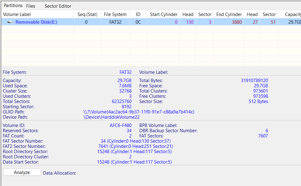

I have tried with the same sd that was in the original working setup, another identical card (PNY Elite 32Gb U1 A1 V10), A gigastone 32GB camera plus A1, A no-name 512MB card I got with a 3D printer from china, and a patriot 16GB U1 C10 card. I have tried formatting each of them with windows to FAT32, then GUI formatter.
I’ve tried all these SDs in both pibot boards with all 4 ESP32s, all with no luck over the past two weeks. I’m at my wit’s end. Any help would be appreciated. I’ve scoured the forums, but it looks like most of these issues faded away in ‘24 and most were related to bad ESPs, which seems unlikely for all 4.

I am now using the SD card you linked above. Sandisk, class 4, 32GB, FAT32 format. It also failed to initiate.
Below is the disk info from disk genius, a ss of the error, and the contents of config.yaml. I also tried the .yaml on this card without the SD frequency as well with the same result.

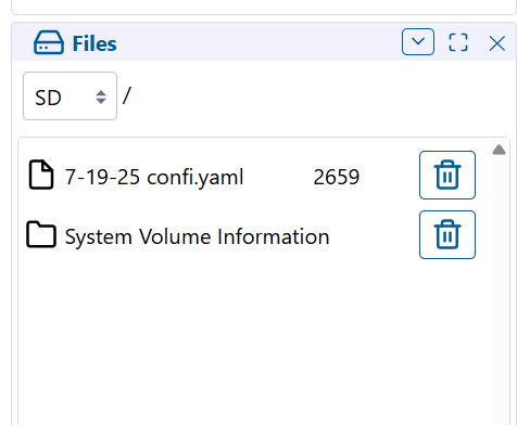

config.yaml goes on flash, never on SD card.
Understood. Thank you.
I meant that I used the same .yaml, then when it didn’t work, tried again without the line for SD frequency. The config has been on the flash in every case.
I did also copy the .yaml file to the SD card on a couple of tries, just to see if I could see a text file in the web installer file browser.

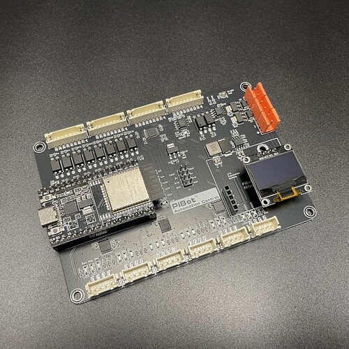

The 4.7B uses a plug-in dev module. I included a photo of it in one of the earlier posts today. I’ve mostly started focusing on getting one of these going wince I think I screwed up the 4.9 when I dismounted the small cap next to the sd slot.. Are these small rectangular caps polar? maybe I reversed it getting it re-mounted.
This is the 4.9B
