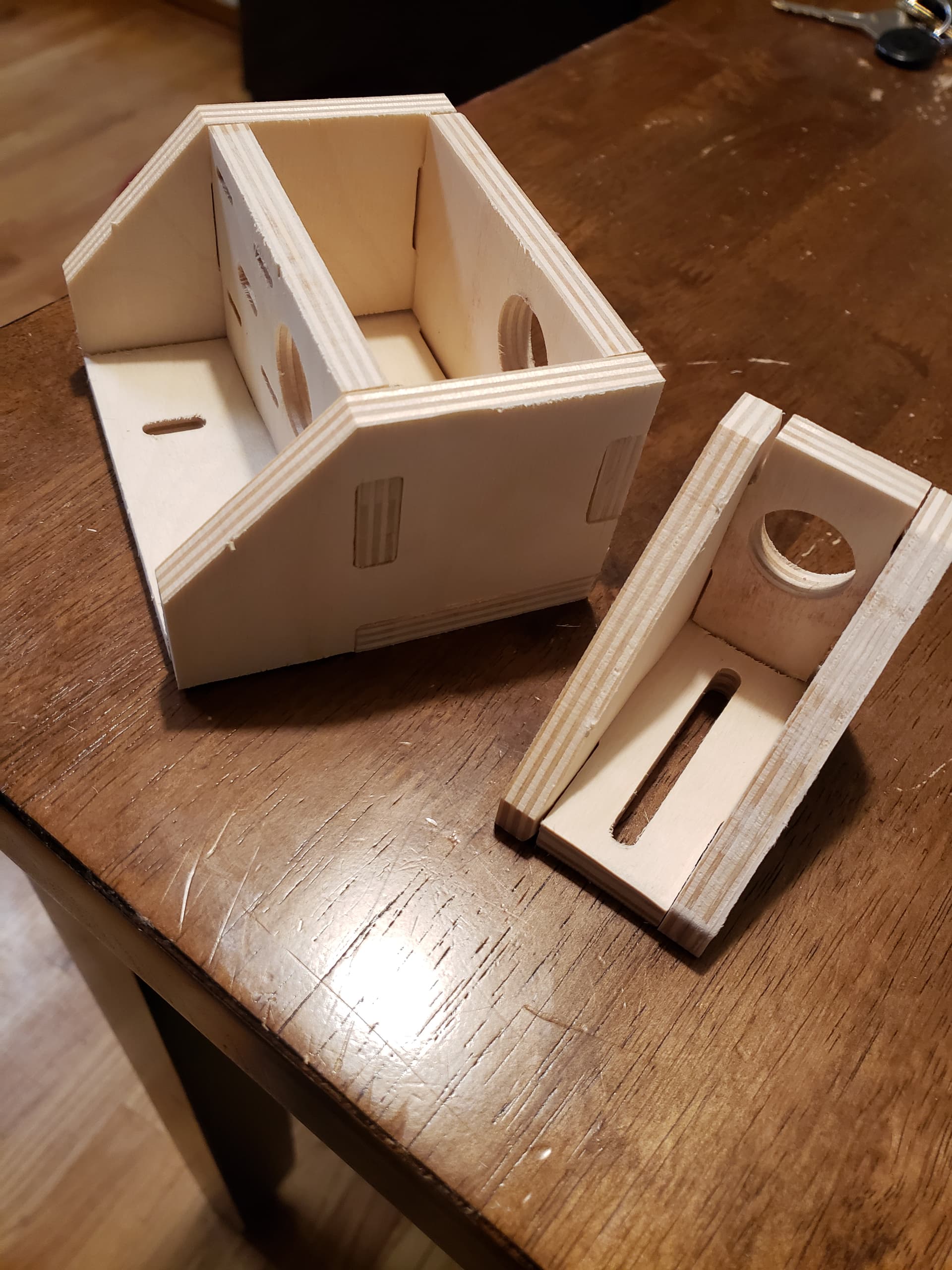

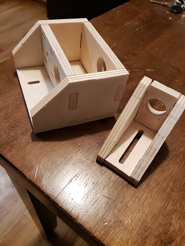

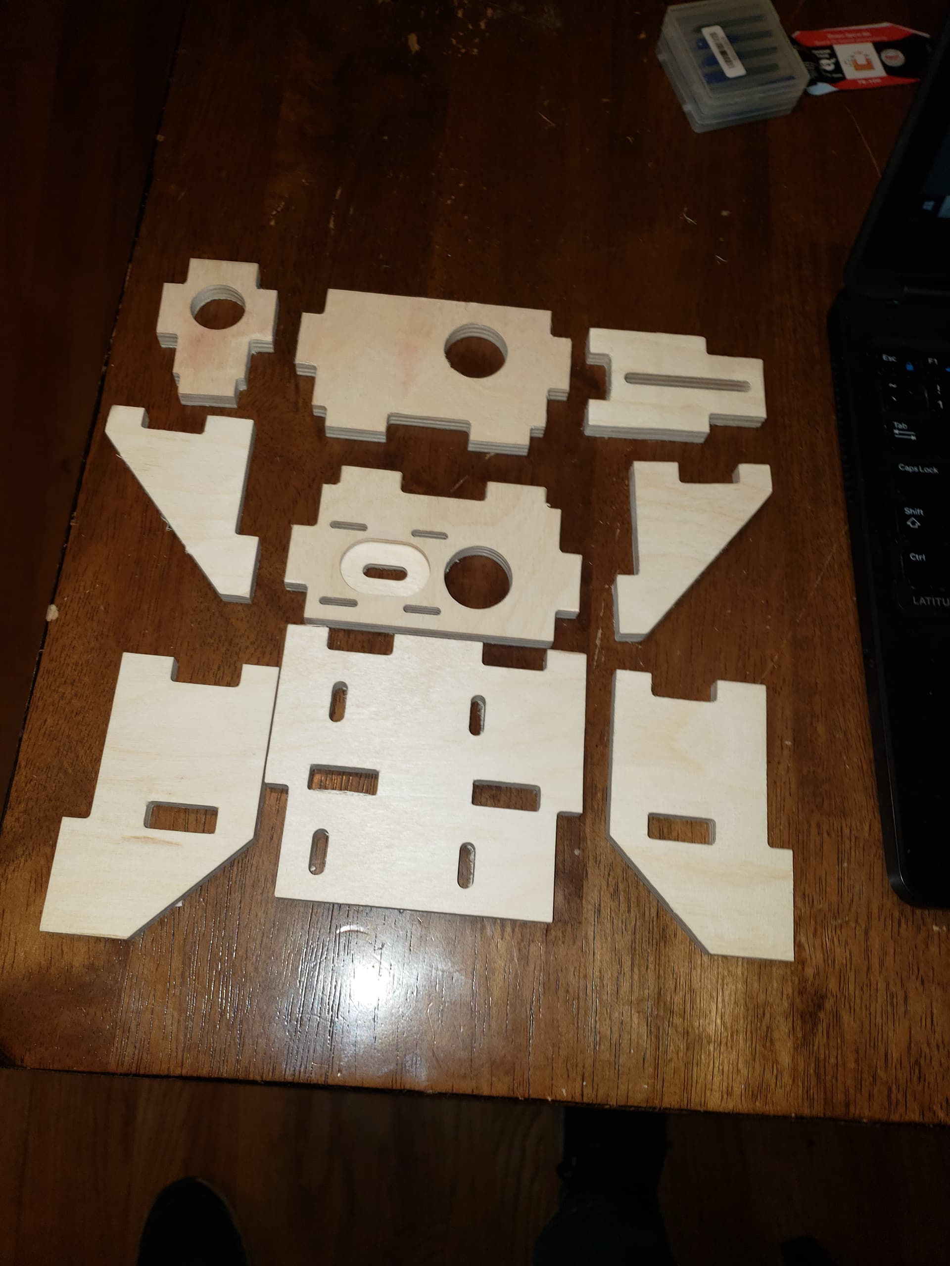

Thanks again Robert. I open 360 when I got home from work and it was back to normal. I was able to get the stl converted to dxf and toolpaths made. Will start cutting today and hope it all fits.
Thanks again to you and everyone
Well i got them cut out and i an really pleased. Nice tight fit. All i am waiting on is the gears to be printed.
Thanks everyone for the help.
Most appreciated,
Brad
