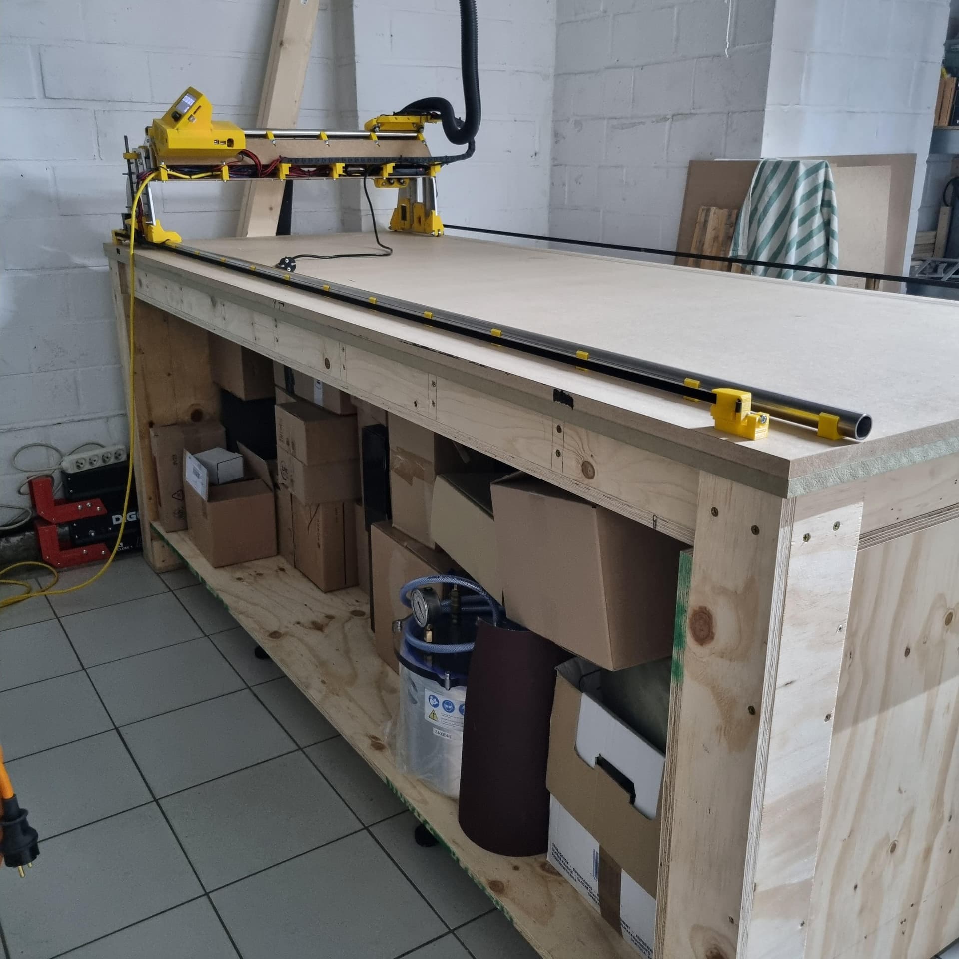

1mm equals 2mm on Z
Ok, found a new problem today :slight_smile:
I was doing some test cuts so I don’t f* an important bigger job. And I have set my Z depth to 1mm. But after cutting that 1mm looks deep. Measures come in on 1,5~1,8mm.
For most jobs I wouldn’t care but in this case I need to get it right. Anyone an idea how to start troubleshooting?
I’ve checked my gcode and it shouldn’t go deeper than 1mm. In the past I did have some issues in x/y because differences in tooth for the pulleys, but that shouldn’t matter on Z I think?

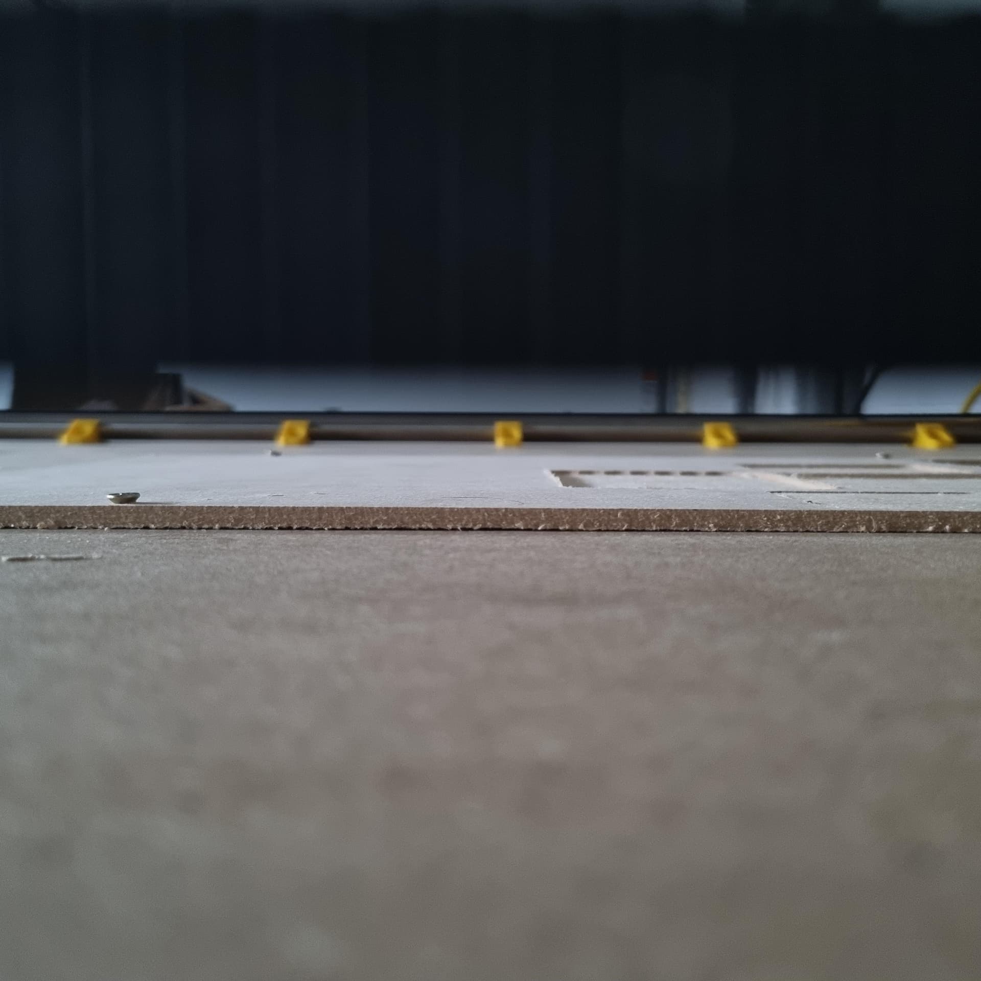

My stock is just a thin piece of mdf 4mm to test things. There seems to be a small gap between stock and the table. I would think a bad fixture would result in uneven heights but that is not the case. Measuring multiple sides give the same height.

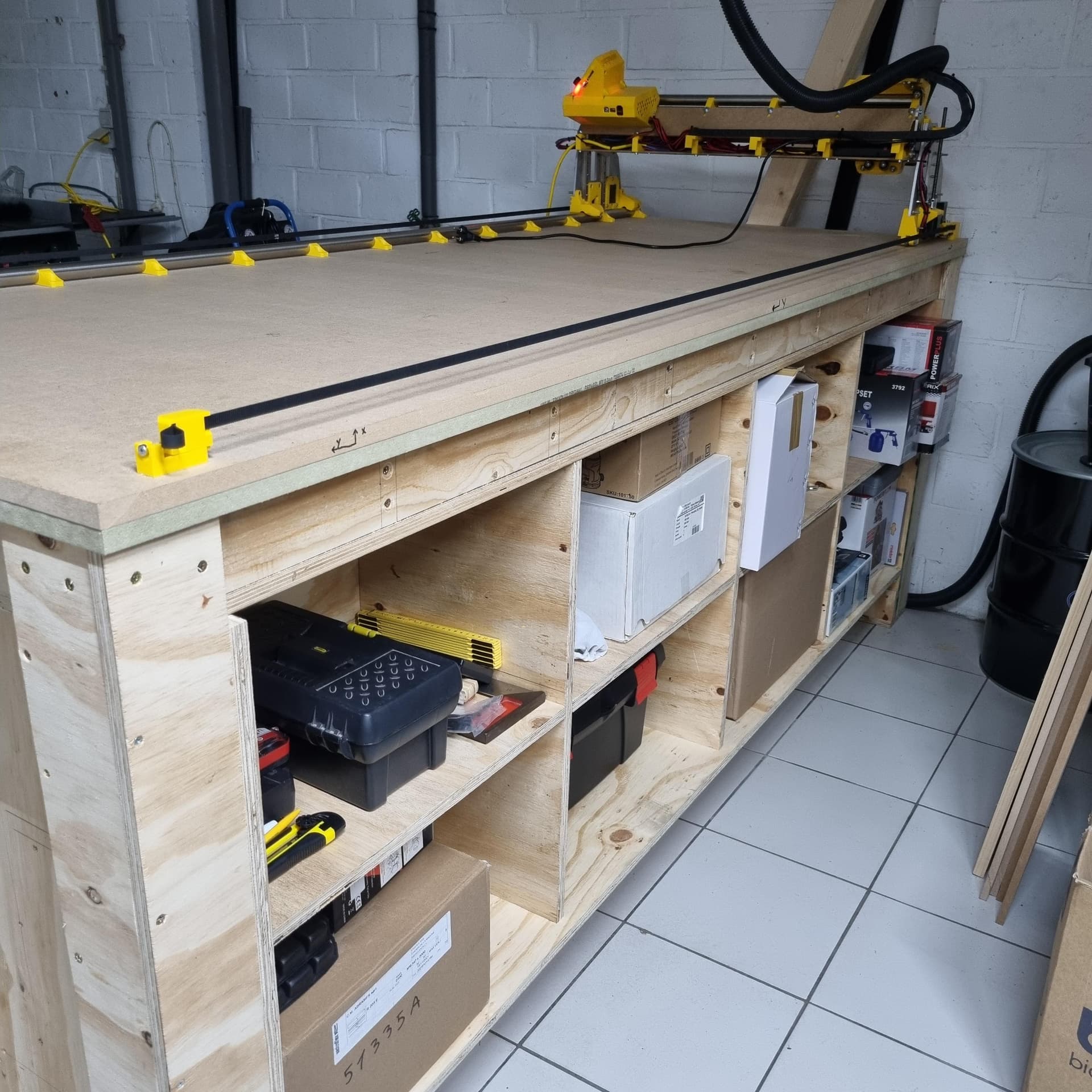

The bed is very flat. I build this table on a large flat construction space where they build industrial wood skeleton houses. The torsion outer walls are made with industrial laminated wood 100mm thick. I´ve measured <1mm between X0 and X640mm. Surfacing is on the to do list, but first have to drill many holes for the nuts to hold clamps.

I have a small piece of 4mm MDF I am using, like 300x300mm. Screwed it down in 4 corners.

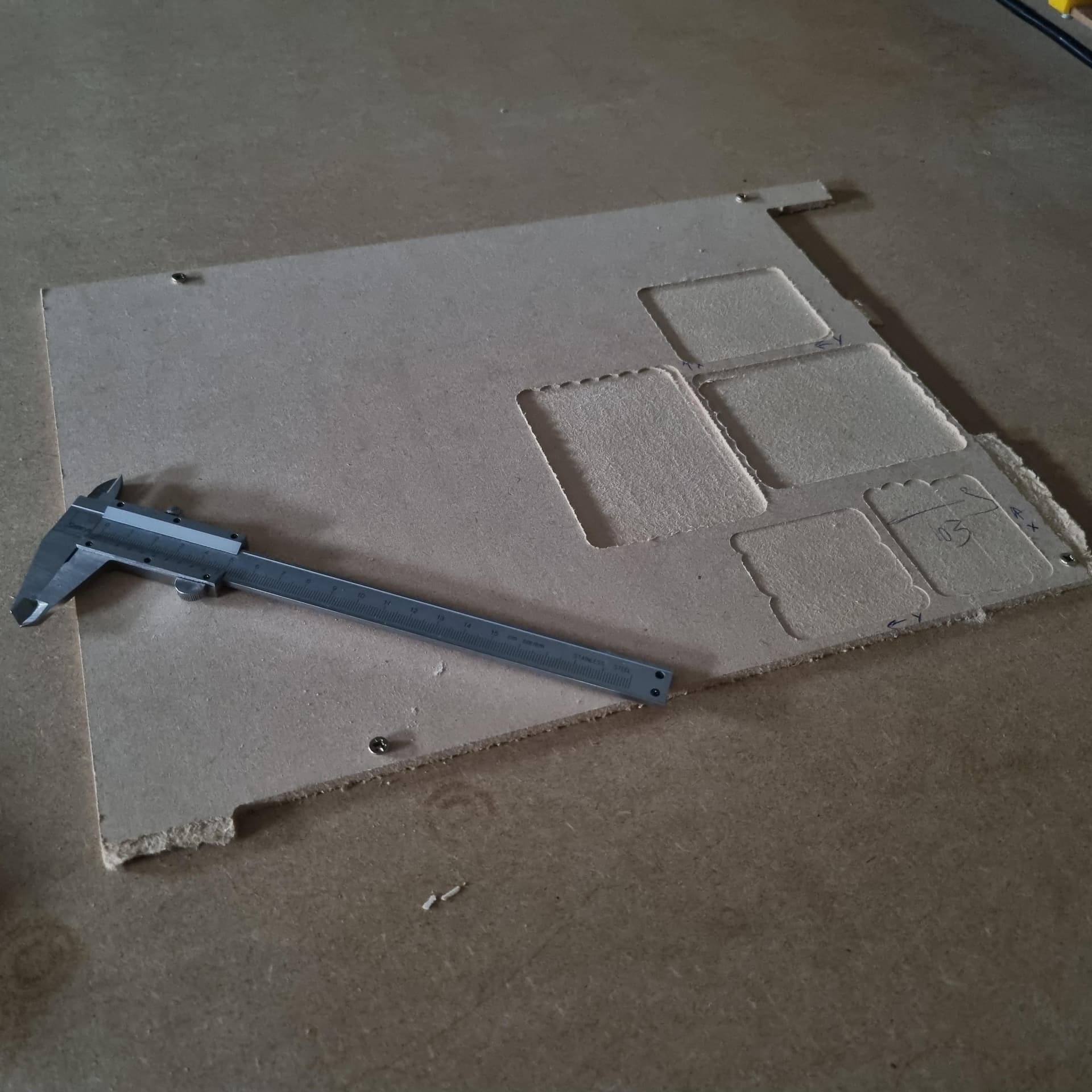

The touchplate specs mentioned it was 14mm precise. My analog caliper says ~13.6-ish…
This is my scrap piece mounted to the table. Screws in 4 corners.

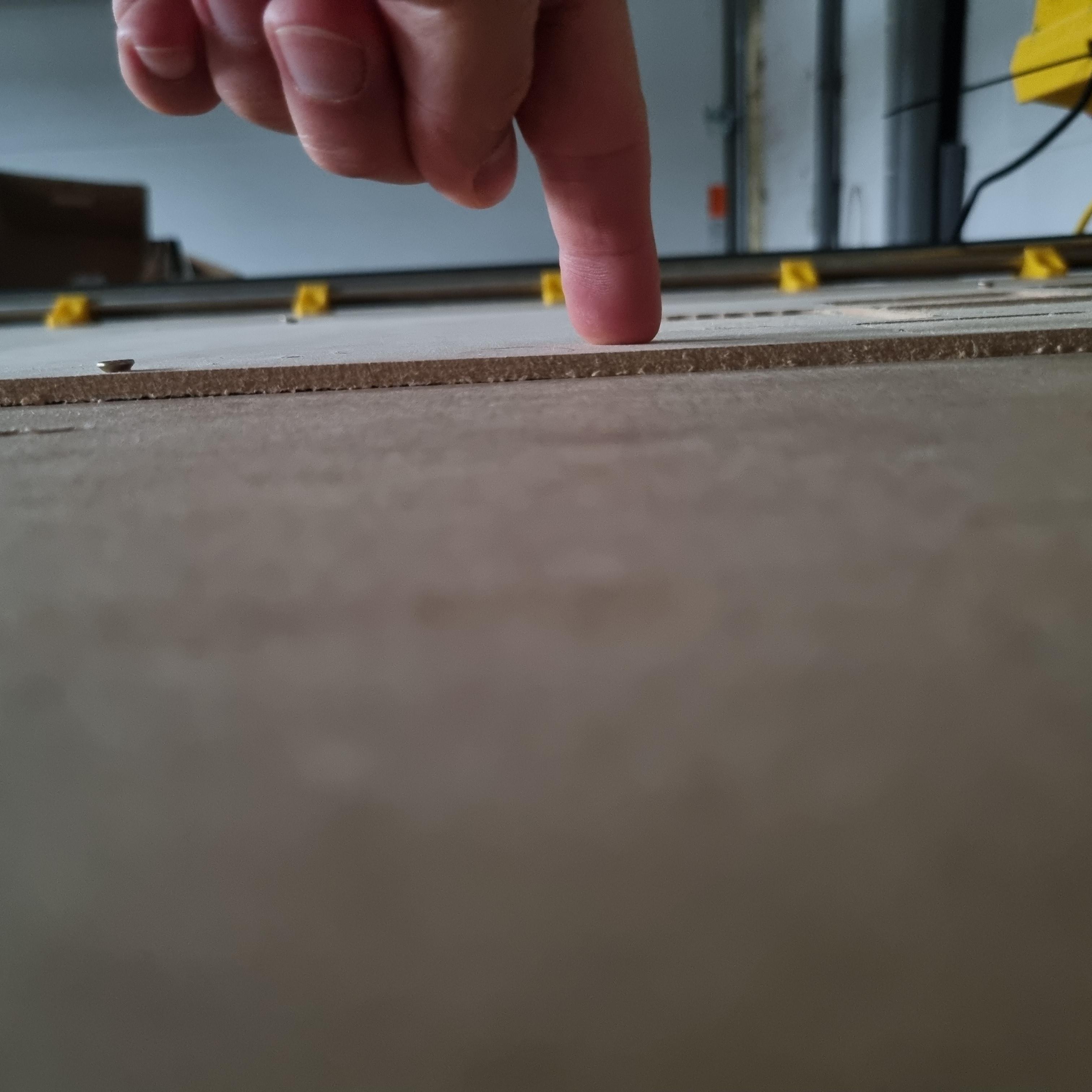

looking from the side you´ll see the minor gap.
pushing it a bit removes that:

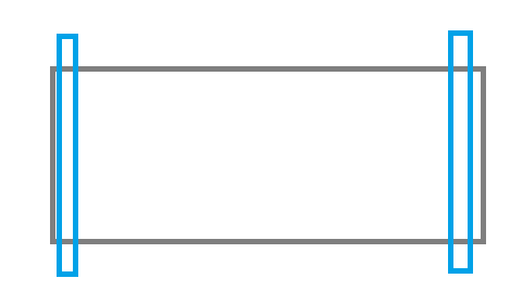

and this is just to show the lead-in (right corner), so first measuring point would be left, or right and few mm to the back.
I think the conclusion is that, the combination of the small tolerance on the touchplate, combined with the small gap below the workpiece, might cause an error of ± 1mm in total.
Does that make sense?
Will do a test cut with an additional screw, and modified touchplate height. Will report back afterwards
