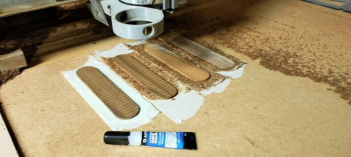

Also, painter tape and superglue… great for those thin material that need to be held flat… and for surfacing too
Costs nothing, holds great…
Just add a clamp or screw somewhere though, because it can still move a bit under high loads
