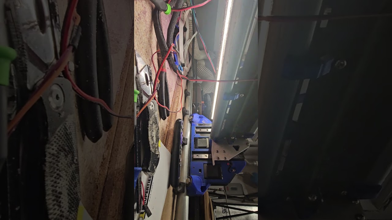

I ran the most recent failure/file design today and just stood there, like a zombie, watching it with my hand hovering over the kill switch. Everything was going fine until the 3rd or 4th z move. My rail side z1, didn’t lower. I’m doing very very gentle cuts today because my sanity can only take so much failure, so it wasn’t super obvious. I let it run that layer and when it went to the next I left my hand on the screw, 0 movement. Stopped the cut, and my belt side Z, holding firm, my rail side 0 hold whatsoever. It’s dead.
Powered down and on again Z homes, doing 10mm up and down, works just fine, 4 or 5 times. Then it’s dead. Power down/up, same thing. I pull all of my wiring out of the sleeves because I have an extension on there. All looks good, retest, same result. By touch, 4 of the driver heatsinks are warm, Z1, about room temperature.
I pulled the Z1 driver and swapped it with Y1. Retest, problem does NOT follow the driver, unfortunately. That would have been awesome really.
I need to find a instructional to test a stepper, I’m not sure which pairs of wire to be testing at a time. But since the problem clears as soon as I power cycle, and only with a power cycle I’m thinking it’s unlikely to be the stepper. And I’m thinking the initial hot Y might have been from dragging an off vertical bit, basically that was the symptom of the actual Z issue.
I didn’t count the moves on each test, but on the video I get exactly 6 moves before it quits working. Probably a coincidence.

And MM, tested both sides of the Z and compared it to the Y stepper. I’m getting about 9ohms on every coil.
I pulled and reseated the stepper plug, no change. A few moves and then nothing. I pulled the board to check the solder joints on the plug. Maybe a have a cold joint that’s opening up when juice flows.
EDIT**
It’s definitely board side. I reflowed the wire socket pins, no change. Then swapped stepper motors and the problem recurred, so it’s not following the stepper. I’m going to take a look at the driver pins, and last shot just see about reloading the firmware. I don’t think that would be an issue either, but it’s the last thing I can think of before shopping for a new controller. This is the original jackpot so it’s been around a while.

Nevermind here, I found it going through the installer and was able to edit the config to switch sockets. It worked, and now it’s getting weird :laugh: If I leave everything powered up and just disable the motors momentarily after it stops working, it works again for a little while.

I don’t have any spares steppers, but I’ve been mixing the ones on the machine around to see if the problem follows one of them. Any stepper I have as my z1 does the same thing. When I switch sockets, it did it on the new socket as well.

Also, I saw that your driver heatsinks are rotated from square a bit in one of your videos. I don’t think they’re rotated enough to be shorting a pin, but make sure that none of your heatsinks are touching or are close to any of the driver module pins.
