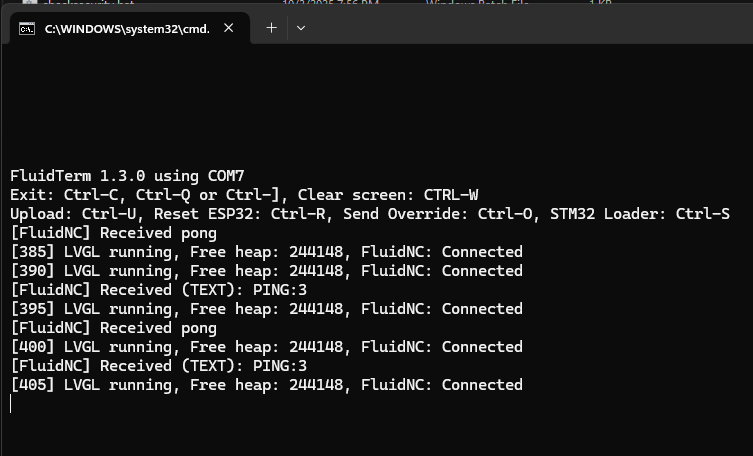

The only output I have from the terminal was posted 3 days ago. And as I keep saying, I’m trying to find how to use fluidterm.
Using FluidTerm | Wiki.js
Just download the latest release zip. It doesn’t matter if it’s the same version as you are using since FluidTerm is independent. I downloaded fluidnc-v3.9.9-win64.zip since I’m on Windows.
Release v3.9.9 · bdring/FluidNC

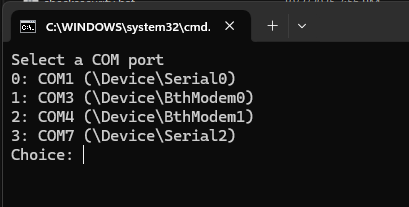

Connect the Jackpot to a computer via USB and run fluidterm.bat from the release (if you’re using Windows anyway).
It will prompt for a COM port:
Mine is on COM7 so I enter 3.
This happens to be from my pendant I’m working on but the idea is that it captures all the serial output. The WebUI may not have it all, especially if the controller is crashing.
