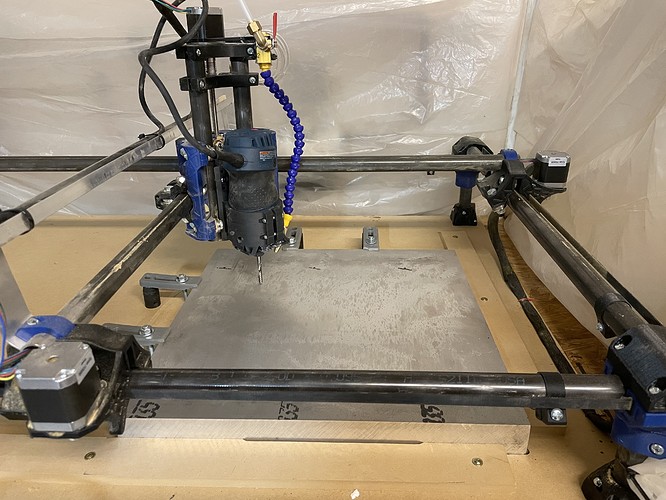

1.5in thick 6061 aluminum plate
It seems really aggressive to me, but it’s hard to give an opinion without seeing the actual toolpaths and the other panels. If you want to share it with me, I’ll have a deeper look. Either export as .f3d and send it to tony.richmond.ii@outlook.com or go file>share>public link and post it here or pm me.

The adaptive paths dont start at zero and i cant figure out how to force them to.
Throwing in a false contour pass, .1 stepdown, allows it to start from zero and gives a nice tracer to show the outline before continuing in the correct spot for the adaptive…
My stock isnt flat or my machine flexes under the weight, not entirely sure… but i found that you can machine down about 2mm… 2.12 is too much though… i ended up being shifted 1.5mm when it started the second pass.
I did attempt to ensure everything was level, i set the machine to 0,0,0 and then manually moved the carriage across the plate and it never touched… however this isnt the first cut that set high in that corner so im not complete surprised.

If i touch the router on a pass its beautiful, smooth, and noticeable quieter… even a faint touch
I can say for sure that it is sag, but only when running… not clue why yet.
I should have put that mid brace in… whomp whomp
I occasionally lean on the 0,0,0 leg… I’m so fat i cause a cnc to sag…
At least i figured it out, time to grab a chair
You’re using an upcut mill, so it’s possible that just the cutting force is pulling the spindle down a tad.
Mid-braces are definitely an easy mod, cheap too. For your long axis, I definitely think they’re worthwhile. I hope you didn’t get a different impression from me when we were talking about the long gantry tube.

Usually, if the toolpath doesn’t start from what we think is 0,0,0 then either we haven’t correctly set the origin correctly in fusion or there is a weird G92 in the gcode (from the post processor) REsetting the origin before the program starts, so check both of those if you haven’t gotten to the bottom of it yet.
If you haven’t gotten any lost steps and you haven’t smoked your endmill after your first pass, you’re probably doing pretty well! It’s been my experience that if an aluminum toolpath is going to fail, it goes badly within the first couple minutes.
The first attempt lost steps… i reset everything and its good.
