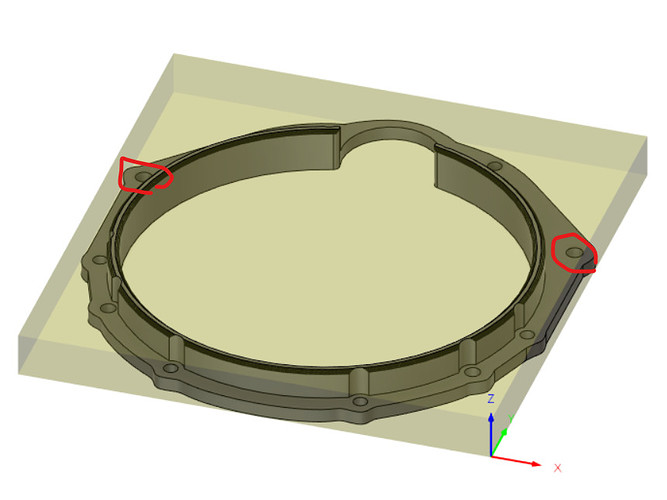

I have a primo? I think. ~3” of z, and i want to mill out a trans adapter for my race engine. I have successfully milled it out of mdf already and everything went smooth, none of my aluminum tests have panned out though. Chip clogging and breakage and all. But that was sheet metal and my calculator gave me some really crazy speeds, i have a new one.
Anywho, to the point. I dont care about finish as long as its dimensionally accurate inside, think flywheel clearance, and in the bolt holes. I am setup for 1/4 endmills but im exploring 1/8, i just cant find any that will cut that depth.

Single flute(DLC coating if you can get it), high rpms ok, air blast is critical, feed rate in the 0.001"-0.002" chip per tooth (after accounting for chip thinning), 0.020"-0.030" step down should be safe. Use Adaptive/trochoidal paths if possible.
The siren song of HEM always calls, with large DOC and light stepovers, but that requires higher feed rates that i just don’t think work out well for us (well, for me anyway).
As for rigidity, turn all the motors on (EXCEPT for the router, lol) and see if you can flex or wiggle anything by pushing and pulling on the endmill. If you can’t notice any obvious movement, it’s probably good enough. The cutting forces on a sharp endmill really aren’t too high. More rigidity than that helps surface finish, though. Less could lead to deflection, which yields higher loads on subsequent passes.
1hp is plenty for 1/4 in endmills, and they have larger flutes for chip evacuation. If you decide to go with 1/8 endmills, get a few of the short Kyocera mills that Ryan sells. I’ve had AWESOME results with those, and all the other 1/8 I’ve tried were somewhere between mediocre and disastrous. Of course, they may not teach where you want them to. It’s it just the stock that is 1.5" or is that also the deepest cut to make?
3inches of Z should be fine but 40 inches of travel is long. You can get the most rigidity at a corner so make sure you’re not loading the stock at the middle. I think it should be ok at the corner, but WORST case, you can move the legs over for that job and leave the tubes hanging out the side and the extra belt hanging down.

you are right about the gantry, the wires do run thru it, but the stepper are on the main rails. so if i move the main rails in I have to lengthen the wire or pull everything apart to accommodate. the additional cross beams wont help with gantry flexing but it would stiffen the frame which wont hurt. again everything is 1’ chromoly steel so I can literally stand on my frame without damaging it. But as constructive interference builds, the vibrations along the frame tubes may become an issue at the 17x17 point. which is why i’m looking at the braces. I do align parts at 0,0 of the 4th quadrant… so my x always runs negative and my y runs positive. There is a column in my garage that blocks me from using x positive. See pic
You make a good point about stiffness in the corner… i may adjust the orientation so that the critical alignment holes are along the frame, I hadnt thought of that. the circled bolt holes are for the alignment dowels on the engine and the left one is pretty frame out in no mans land.
just so everyone has a better understanding, that mounting flange is 12mm thick. that ring section is 10mm and the full height is 38.5 or whatever 1.5’’ is in normal units. That gap in the upper portion is the starter which is engine mounted. The entire design is actually 2 pieces, I have another plate of 12mm that will be cut and welded to the ring and the transmission itself, but after this that should be an easy task. The chamfered edge on the ring is to help with penetration on the future welds.
I do a 3d adaptive for the main flange area, 2d wont cut around the opening for whatever reason, but 3d doesnt care.
I bore the bolt holes
the chamfers are contour passes as well as the inner ring and outer flange cuts to free the part.
ETA: all the tool paths are straight, no cute little circles like I would expect to see from videos and what not.

So then this piece is 10mm+12mm= almost an inch? If that’s right, the 1/8 i mentioned earlier will reach everywhere, although I’d still prefer a 1/4 for this much cutting.
On the contour cuts to free the part, if you can adaptive all the way down to 1/16 or so above the bottom and then contour from there you’ll spend a bit more time cutting, but save a lot of headaches.
If that isn’t appealing to you, check the roughing passes (4th tab in fusion) and make sure to check that box. It will start the contour too far away and run a second lap after that. That will make the slot wider, which helps chip evacuation. Two ways to do this
1+ rough, 1 finish on each depth
2+rough (on each depth) and finish only at final depth (there is a check box for that one).

My fault, the ring is 10mm thick… not tall… the ring is like 28mm tall
my paths on adaptive and contour, visually, appear identical. the outside of the flange is all junk, if i widen the cut to allow for an adaptive path thats not an issue. I only contour to save machine time. The inner cut on the ring is another story, that material is reserved for another project. so I cant widen it much. but i’m willing to give it a go.
Surface finish is not a concern, so I dont know if the finish pass is needed if i drop stock to leave to 0, no? I just have to make sure those alignment pin holes are really close to dimensionally accurate and the inside ring is pretty close, I think there is 5mm gap on the radius between the ring gear and part. i’m more concerned about deflection at depth.

The finish pass is great for dimension. Definitely include it on the pin bores. When contouring, the only real differences between rough and finish are stepover and feed rate. You can absolutely skip thug finish if dimension and surface aren’t important, but it’s the same as just having a fast finish with a biggee stepover. 6 of one, half dozen of the other.

I had to modify a bunch of things to get fusion happy with the boundaries i need machined… but thats finally done, all the deep cuts are adaptive, I left the chamfer as a contour, and I left the bore.
Fusions default feeds and speeds, any good? its custom because I modified the spindle speed.
