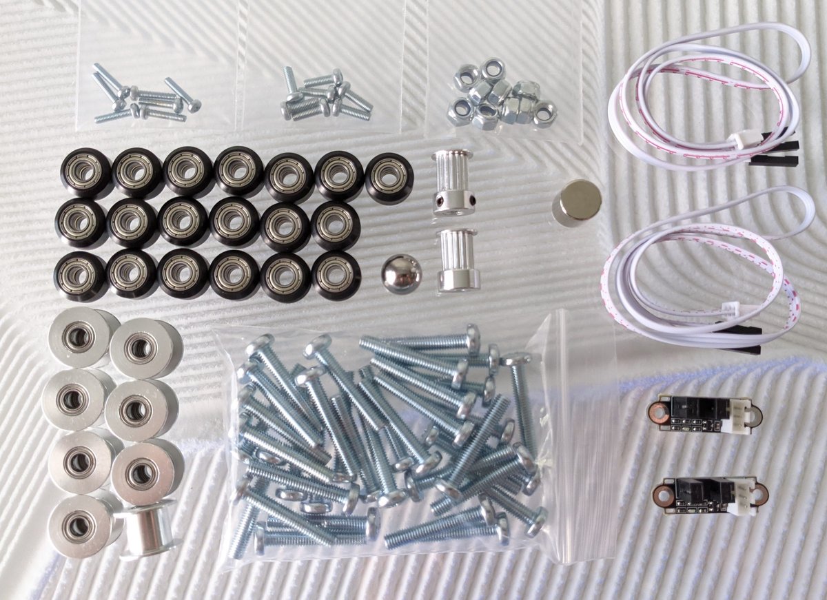

There is a kit for the mechanical parts and the optical limit switches in the V1 shop. Link below. You will also need to buy the required amount of belt from the V1 shop. I do not believe the printed parts are sold in a kit however. Is this where the problem arises for you?
Additionally, you will need to get a control board of your choice and two 76 oz-in stepper motors.
Matt, thank you for your quick reply. I can 3d print the parts, so that isn’t the issue. After hours and hours of reading different types of setups for this project I got myself a bit confused. I was thinking I needed to order rails from here too. I now remember that this uses conduit for its rails. That being said I am somehow missing what size conduit to use. Do you know what size condiut I need for the ZenXY V2?

You need 2 sizes. 3/4" for Y and 1/2" for X.
