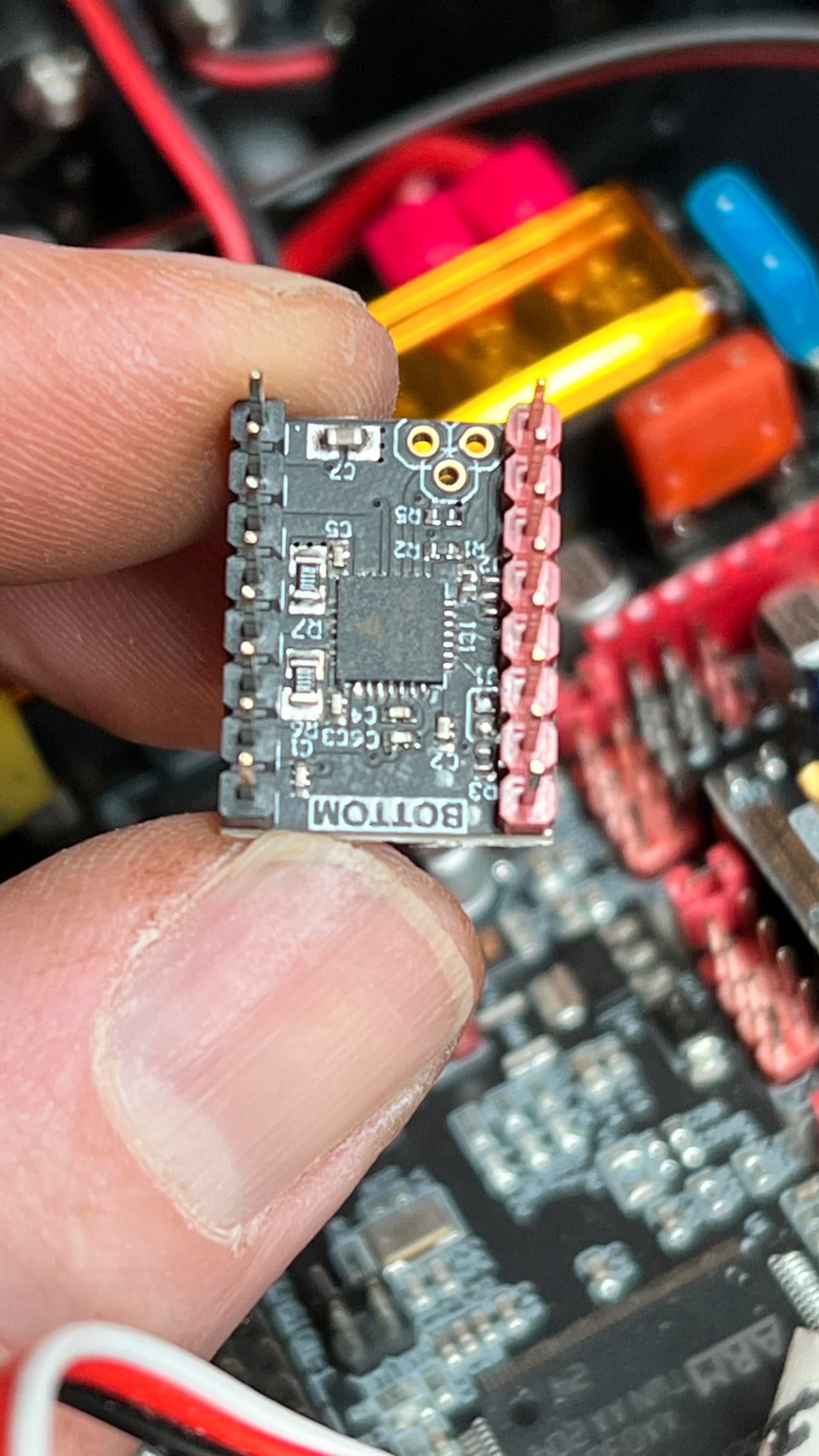

The TMC2209s don’t appear to be responding correctly as shown above. I wouldn’t trust that they are actually configured per the firmware defaults. Your drivers may be using the pot setting or stored currents as a default and this may be why they are over-currenting and overheating.
You will need to figure out what is wrong with the driver communications.

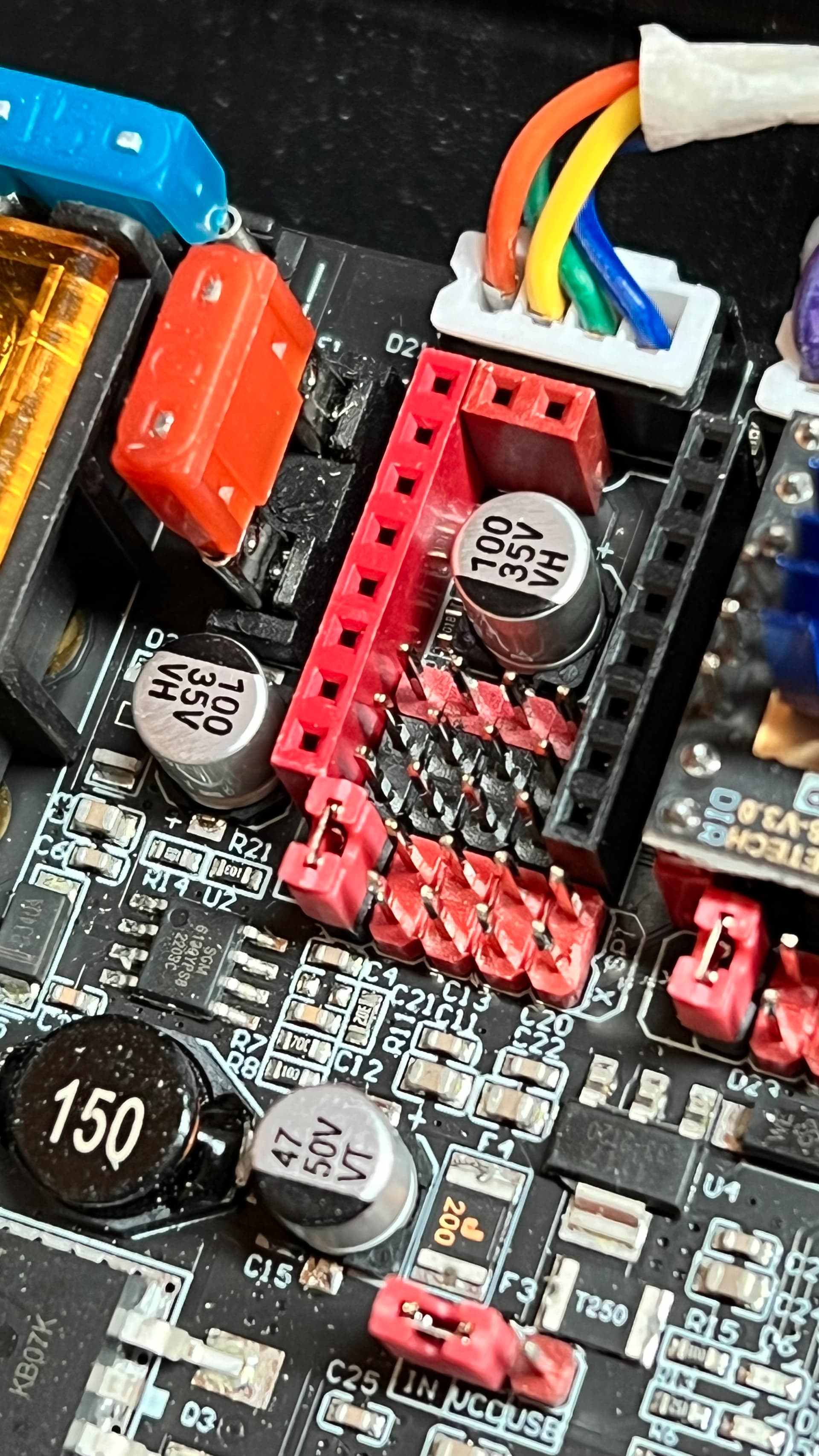

On the SKR 1.2 check your jumpers. The SKR Pro comes with the jumpers set for selecting microsteps and current set on the little pots.
Look at the red jumpers in this pic:
Hopefully you also disabled the sensorless homing pin as well
The links are in the correct positions, and as you can see, the drivers came without the sensorless homing pins.

those TMC2209 drivers aren’t just missing the sensorless homing pin, they are also missing the UART pin. I believe that without the pin from that 2 pin header closer to the side, the drivers cannot be set up by software, and you will get those errors. That isn’t the way the drivers come from the V1 store, I don’t know where you got them, but that isn’t going to work properly. The drivers cannot be set for current control via the firmware in that state.
I would solder in a pin header to that one and see if that gets rid of the errors, and you will almost certainly get better performance out of the machine that way.
Those aren’t TMC2209s AT ALL.
They are TMC2208s
Thanks Dan,
Living in the UK, it’s difficult to order from US. $100 shipping, along with the time for delivery. So ordered off eBay and came from China :man_shrugging:. Between Amazon and eBay I had everything within 10 days. Obviously paid the price :face_with_raised_eyebrow:
I’ll solder in the pin and give it a try.
You’re right Jim. I hadn’t noticed. Fortunately, Amazon should be delivering me some TMC2209 V3’s this evening :wink:
Thank you guys. The issue seems to be solved. As usual it was operator error. They (the Chinese) had sent me the wrong drivers, and I hadn’t checked. I’d only looked at the V3.
