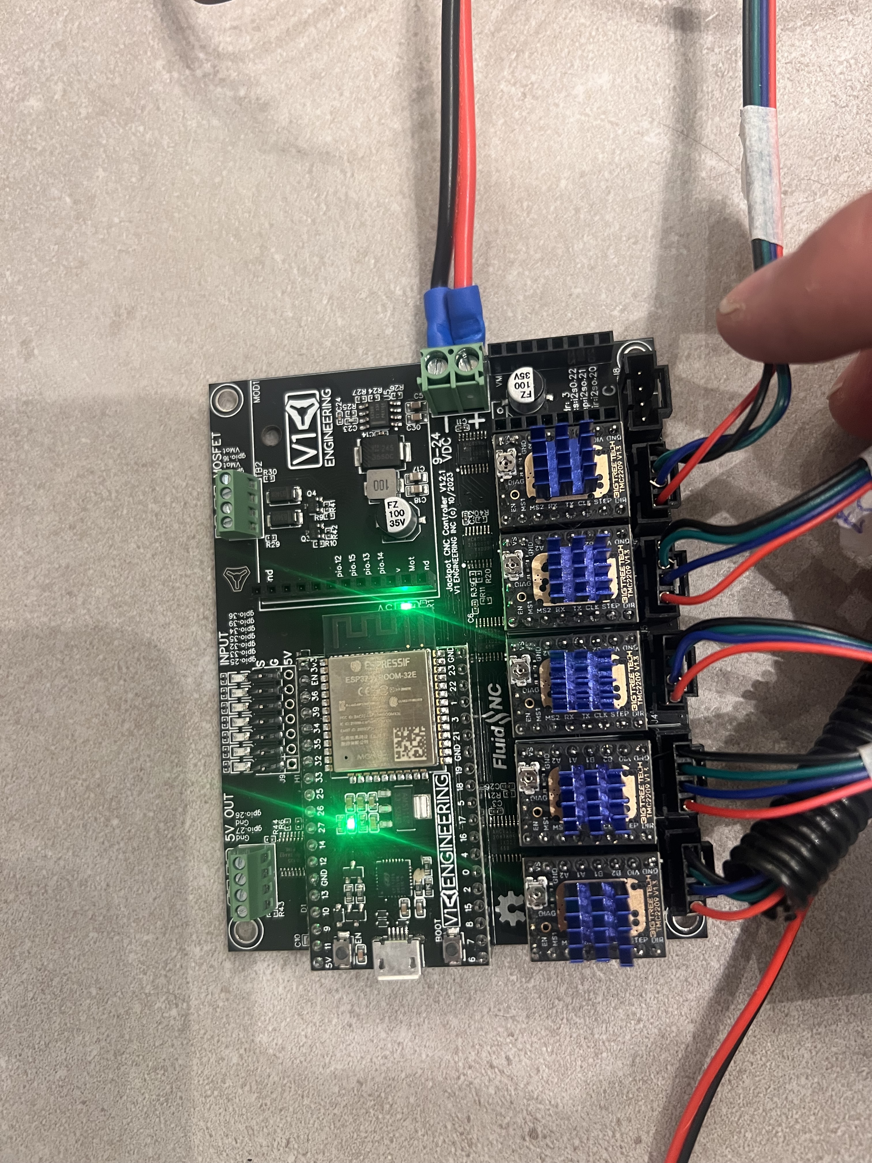

Z1 always goes down
Last week I received my jackpot controller, today I had some time to connect it.
X moves perfect
Y moves perfect
Z2 moves perfect
Z1 is always going down, even when I turn the wiring.
What can i do, or check?
Can I use the C connector? And how?
Thx!

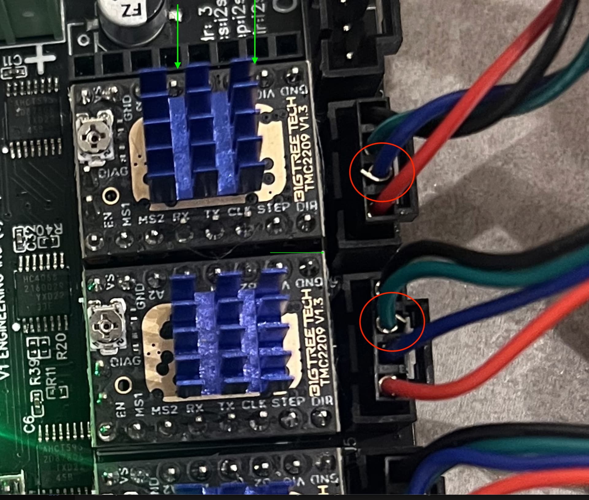

First off, what’s the history of the stepper motor wiring harness? There’s some really knarly looking crimp work on some of these connectors (See annotation of your photo below)
I’d like to get another picture, except I want to see details of the two steppers from the top of my annotation, except looking in the opposite direction (note the green arrows in my mark up of your photo. That is the direction that I want to see)

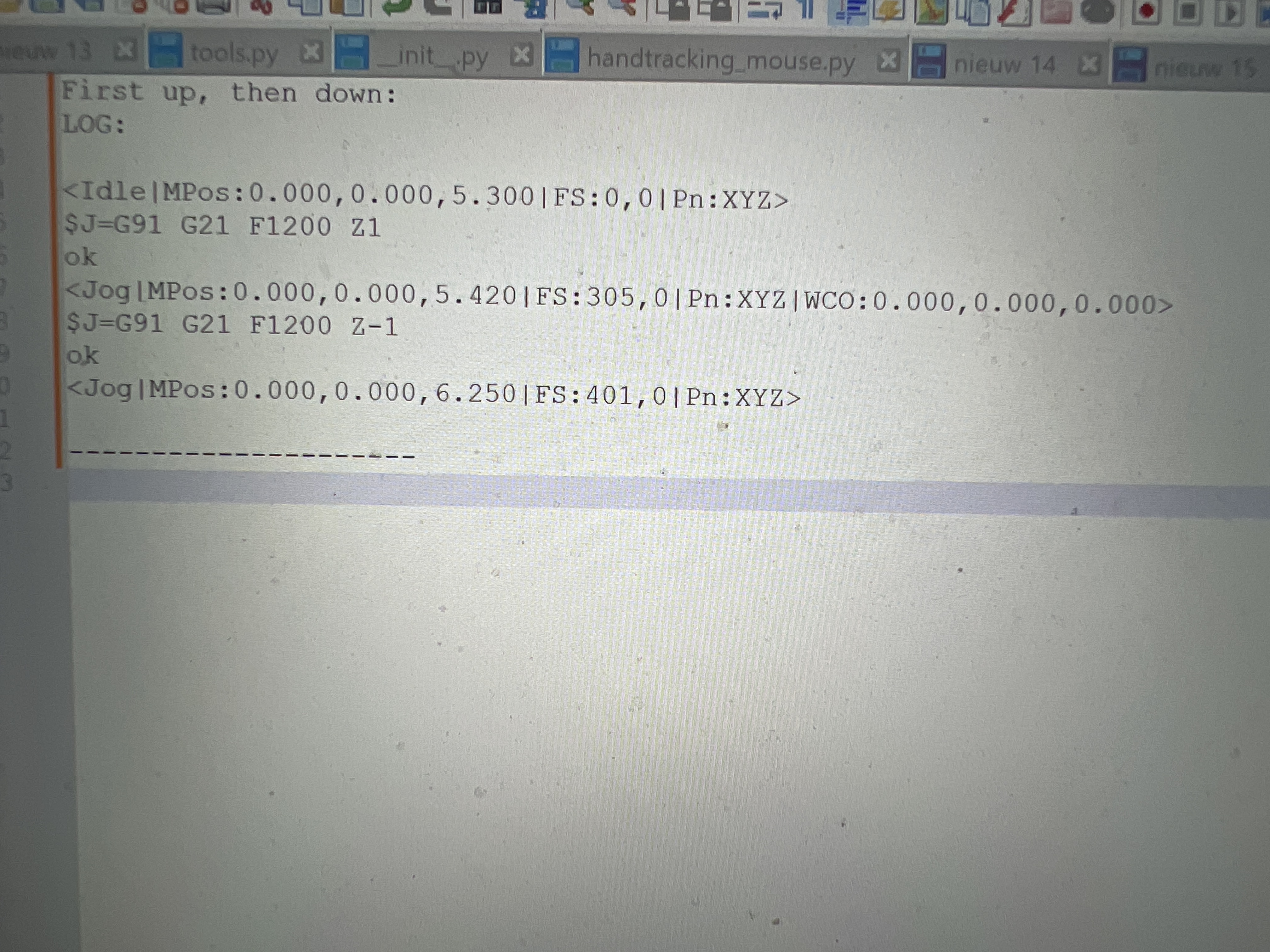

While you’re at it, tell us what you get from FluidNC when you send the following command in the FluidNC terminal:
$SS
Ok it is solved…
It wasnt the temporary connectors, it aint the board…
It’s my color blindness…
Sorry to waste your time, dont laugh to much :smile:
