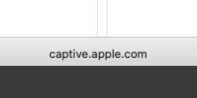

Don’t use the captive portal, open the UI in a proper browser.

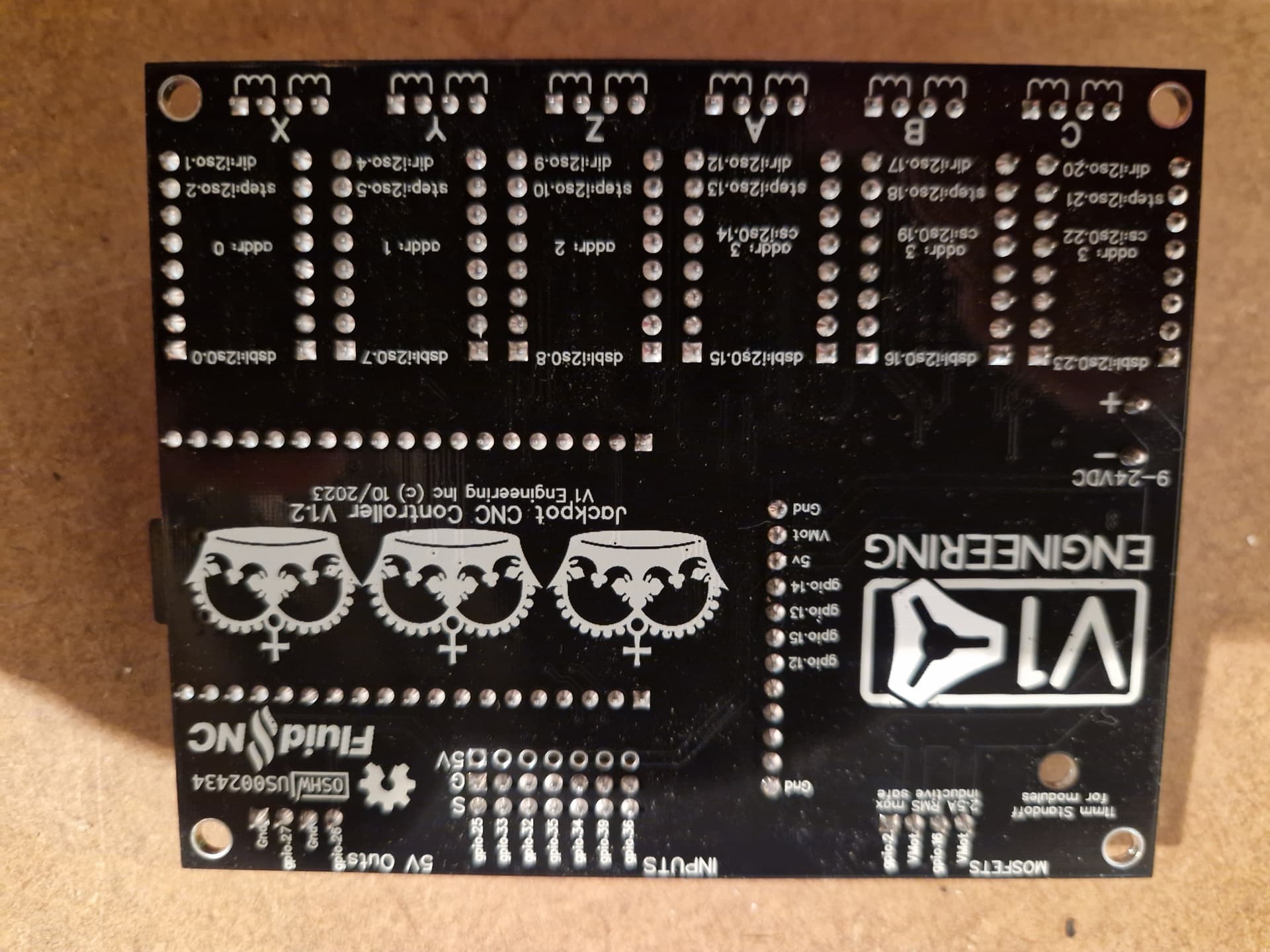

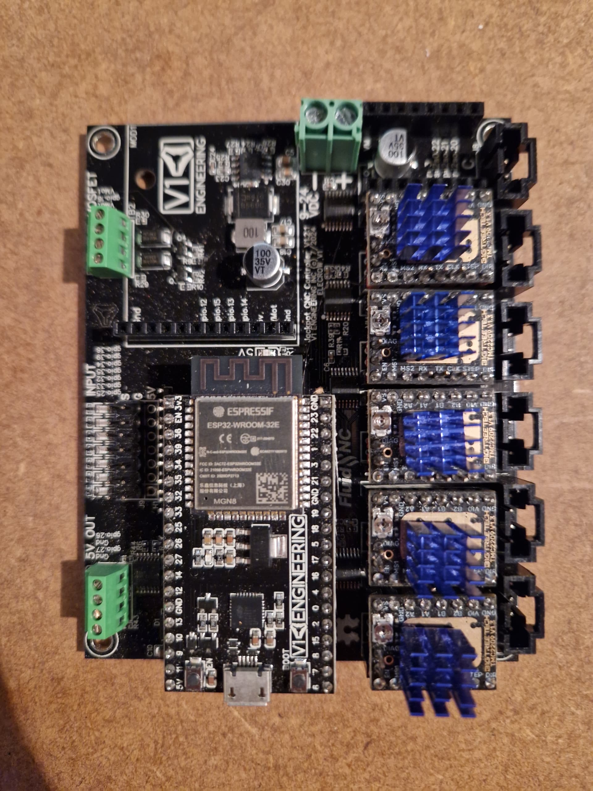

If you look at the underside of the jackpot where the z0 driver plugs in can you see any visible defects? Do all the header pin pads have clean solder on them?
Or if you prefer to, take some clear photos of your board, both sides. Upload them and we can take a look for anyt;hing out of place.
If it’s never worked from new it could be a manufacturing defect I suppose…
There is a spare driver slot, it’s possible to use that as z0 but you should be able to return it to elecrow for a replacement.
I don’t see any apparent defects on the board. I’m attaching some photos.
