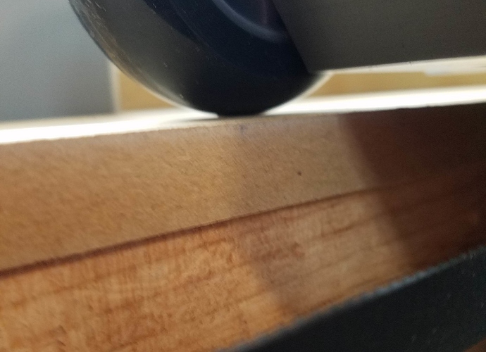

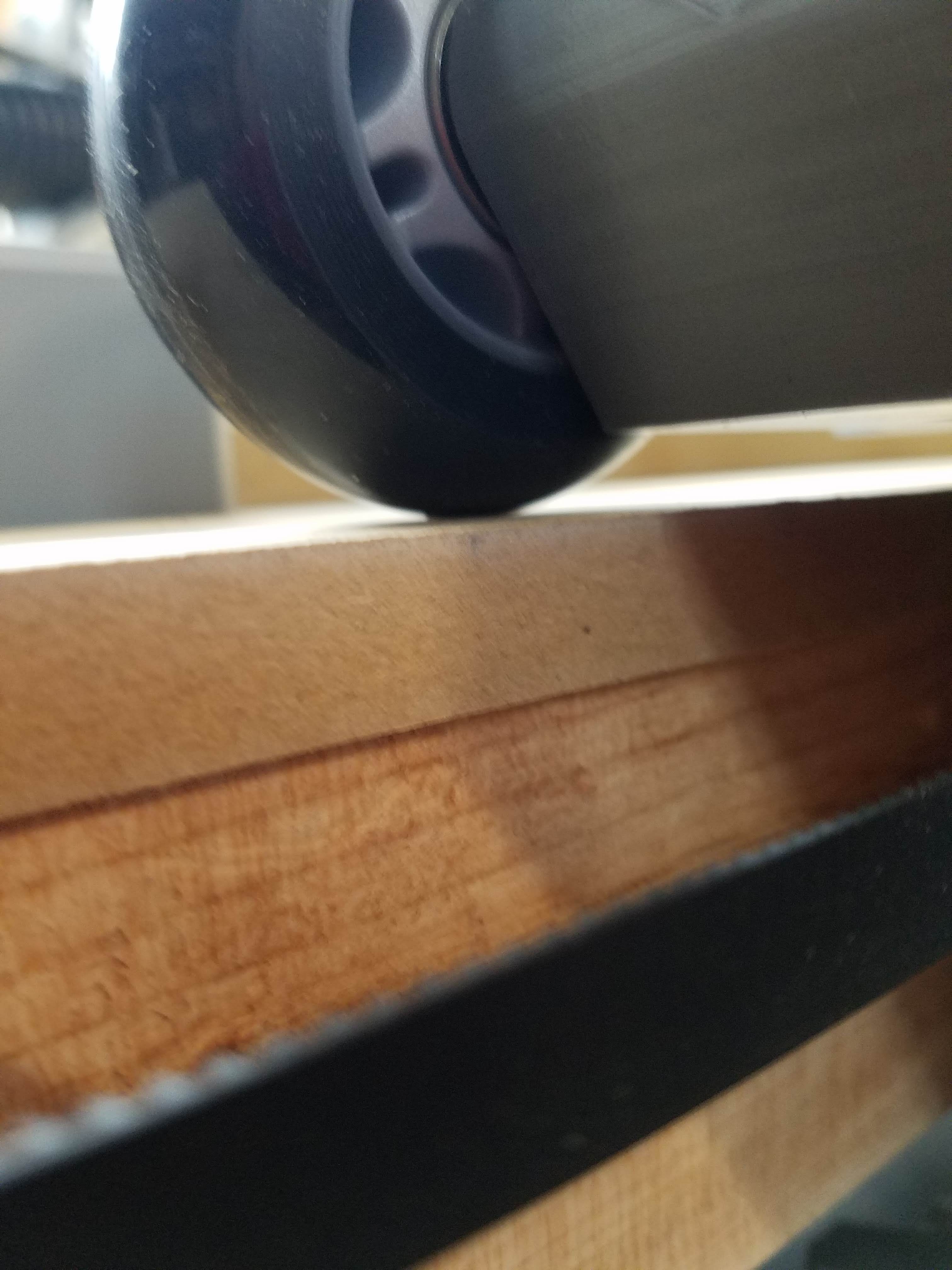

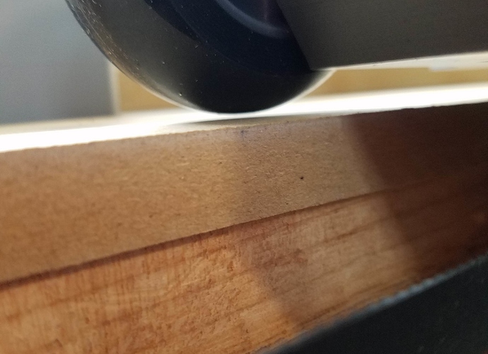

I would like to know what people do to level Z across X.

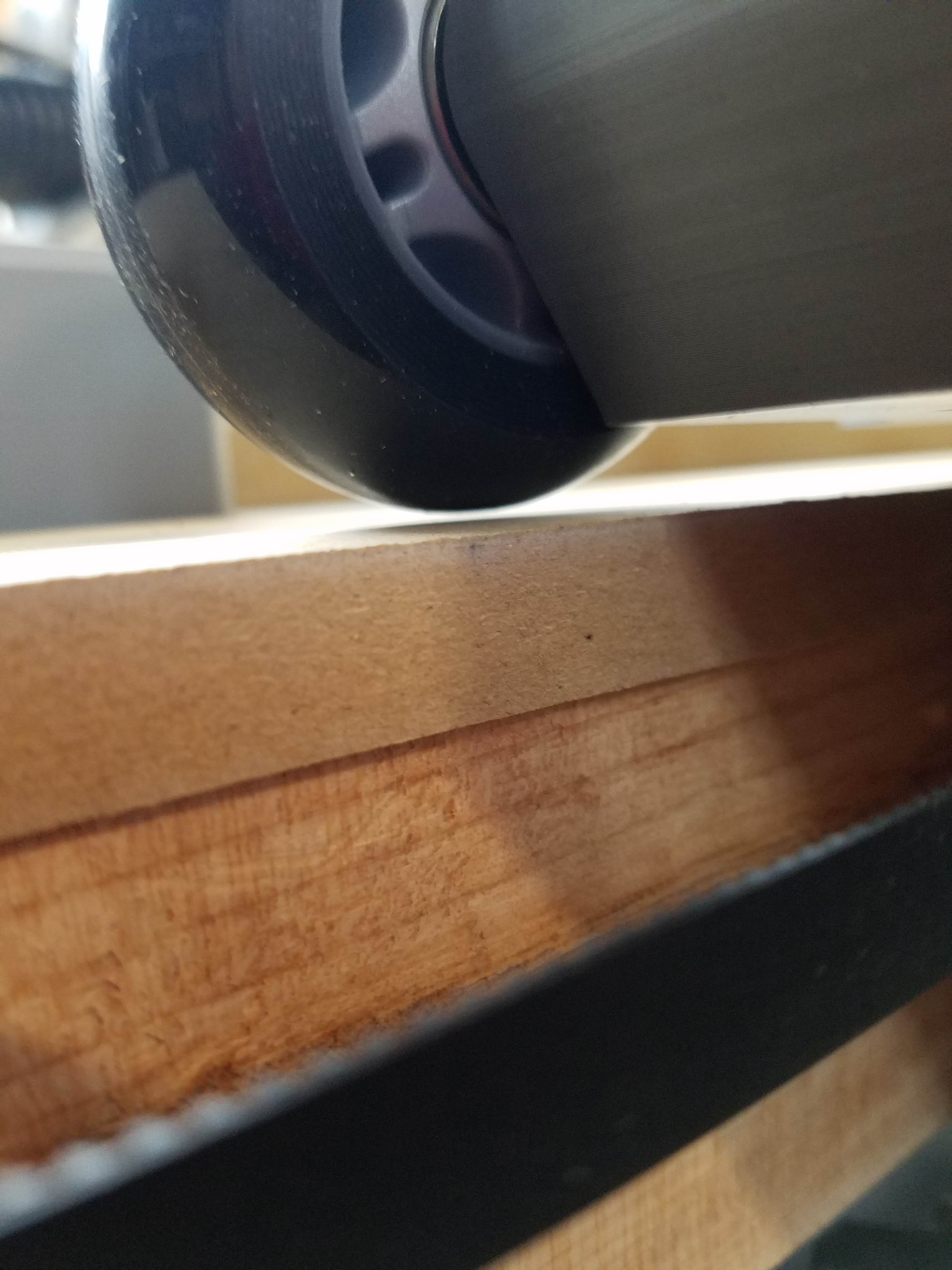

I have found that I can be off several mm across the 4’ of my x axis.
I always park my lowrider on some cradles between jobs and then try to pre-tension the z lead screws on both sides before powering on but it is really hit and miss.
I have started dialing in level by turning the z lead screw on both sides and lifting the wheels off the table and then turning them back till the wheels just touch. Then I power on the machine.
Is there a better way to do this?
I’m wondering if it is worth rewiring my z motors so I can get separate control and then learning how to dial them in through the controller individually which is another can of worms.

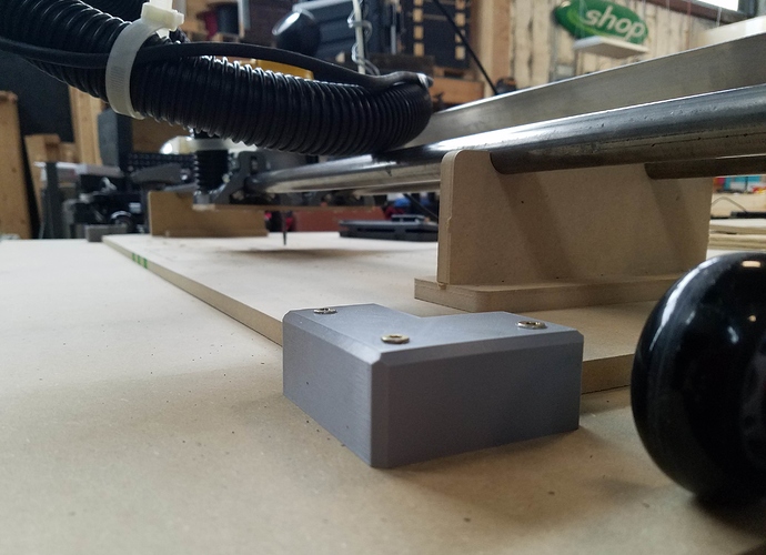

Actually, you said you could turn the screws to lift the wheels. Does the 611 plate touch the spoil board when it’s all the way down? Maybe that’s the issue. Mine has enough clearance to still be floating and the gantry comes all the way down on both sides. If that’s the problem, then there are two simple solutions. First, you can move your rails up, if that’s possible. Second, there is a user created part to add a cradle for the gantry just above the spoil board. Just something to park each side on. I don’t know where the files are, but I know they were shared, I would just have to find them.
My lead screws are touching and the couplers are solid. I am using the cradle you are referring to (you can see it in the picture from my first post). I believe my z pipes are resting against the top notches as they should on all four points.
Mine drops all the way down without binding, it has just proved inconsistent to preload the z screws moving the gantry up when it comes to z level across x.
Since I changed to rotating the lead screws the opposite way to lift the wheel momentarily of the bed (gantry resting on cradel), the two sides have been much closer. I will probably just keep doing it this way for now.
