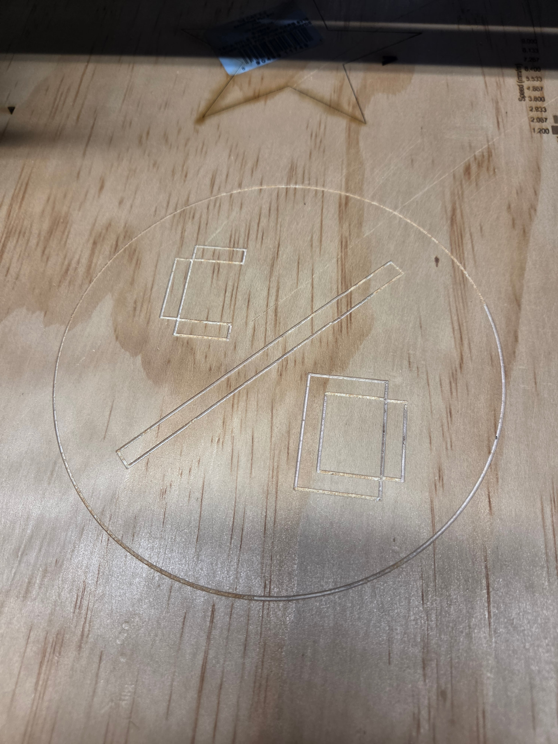

It appears that the P0.5 at the end of G38.2 Z-110 F200 P0.5 is what was causing the probe to actually fail. Removing that caused the probe to succeed.
I also needed the G92 Z0.5 to properly zero it. Without out that, it was cutting in mid-air :grin:
So this is the start code that worked for me in case anyone else runs into a similar issue:
