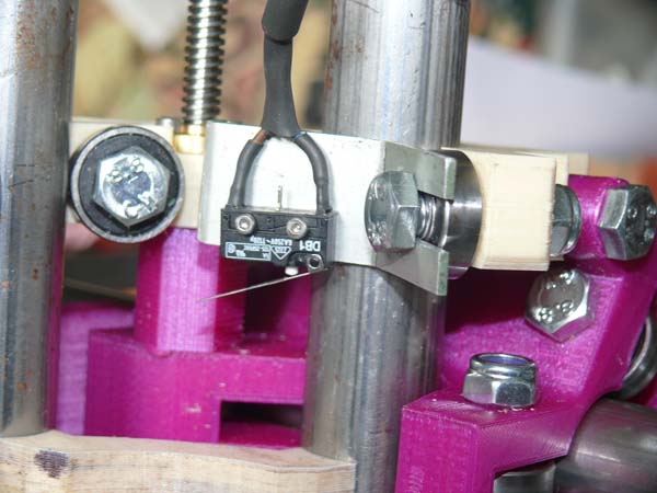

Thanks all.
Yes I have a s/w at the top of the Z, the Z goes up when I send G28.
Jog the Z down to touch on a piece of paper (0.1mm), send G92 Z, a fag paper (0.02mm) was one of the favorites in the milling shop.
It can be used basically like a “proper CNC” with some limitations.
Maybe it is horses for courses, I find it easier, it’s a machine, make it do your bidding.
Bill.

Do you have Dual endstop firmware running?
I do not. I only have a single endstop on each axis at the moment. I have the switches to do dual, but haven’t set that up yet.
G28 Z
That will move your Z axis, if you have the metal in place and the clip on your endmill that will Zero the Z axis to the top of your metal plate.
