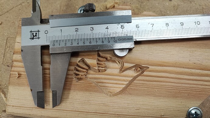

Z losing steps on carves only (Solution: Stepper Pulse Pause to 1!)
See, that’s interesting and good to know because now my delay is 0. Pulse length has also never been touched by me, the tooltip says below 5 or above 20. Yours seems to be 4. Really great to know. I am hoping to eliminate the mistake with this. Thanks for confirming!
Well a quick look through the 2209 spec I see a minimum of 0.1us, so the 1us seems conservative but I think that 0 setting you have there is hopefully the issue.
Odd that none of the other eslt firmware users have never mentioned an issue, wonder how many we lost to thinking it was the machine’s fault.
Thank you for digging deeper!!!
I guess none because if you don’t do inlays or tiny carves where every 0.1mm counts, you won’t notice at all. Will try in a few hours when the wife is asleep. :sweat_smile: Also, I have the TB6600 you don’t like. :yum:
You should check the data sheet for timing specs.
Ladies and Gentlemen, we have a winner. It is me! I felt naughty and set all my inertia values down to 90%, upped the speed of Z to 1000mm/min again and changed the Stepper Pulse Pause to 1. And lo and behold, it works!! I forgot my mobile in the house, so no pictures, but no dropping at all. This has been plaguing me for ages (I had it from the very beginning, I had a post about it when trying to cut @Jonathjon plague with the gun thingy), and now it seems to be gone (hopefully). It was an eight minutes carve that had failed five times before, so I am feeling pretty optimistic. Time will tell if this was justified. :smiley:
