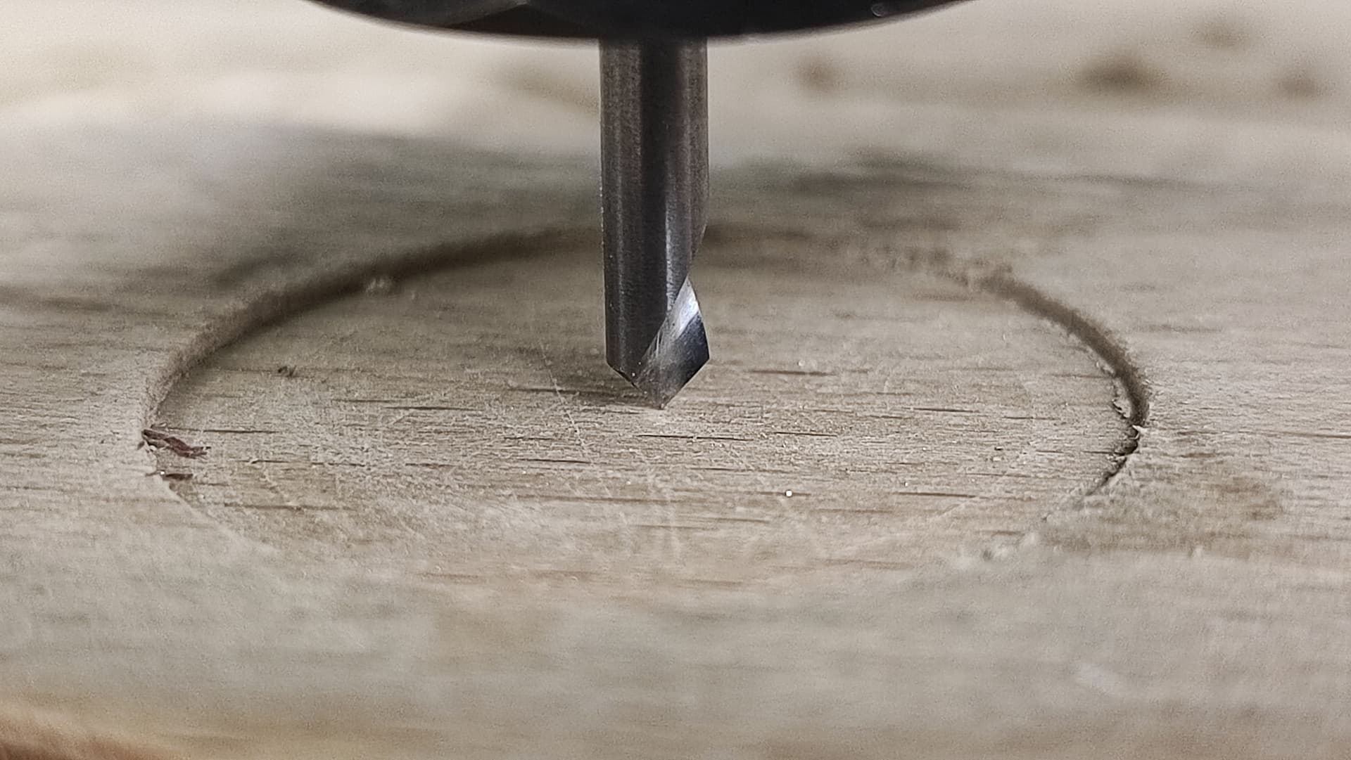

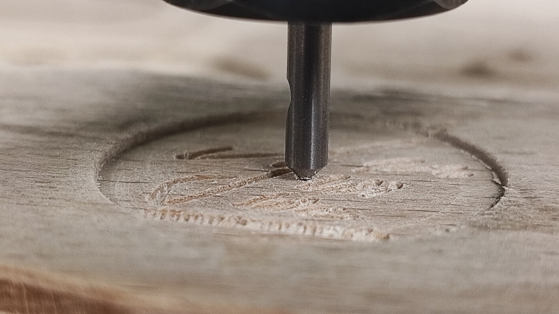

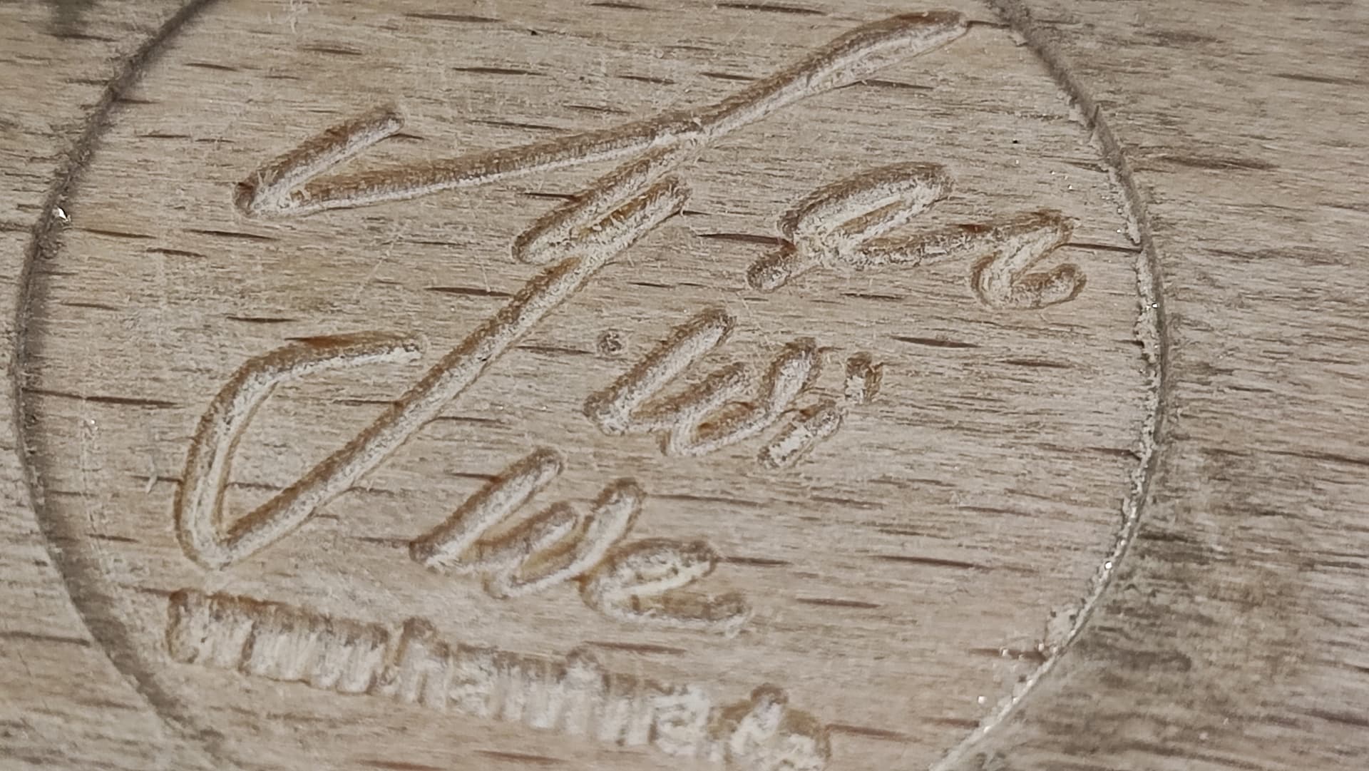

Sorry, I can’t let it go. You can see that Z is still losing steps when doing carves (but it seems, as we tested, only during carves.
Starting position:
After an 8-minute carve at 0.1mm depth:
The whole it leaves (so the amount it dropped):
How is that happening? Can someone please do the same carve and tell me it happens for them as well? :smiley:

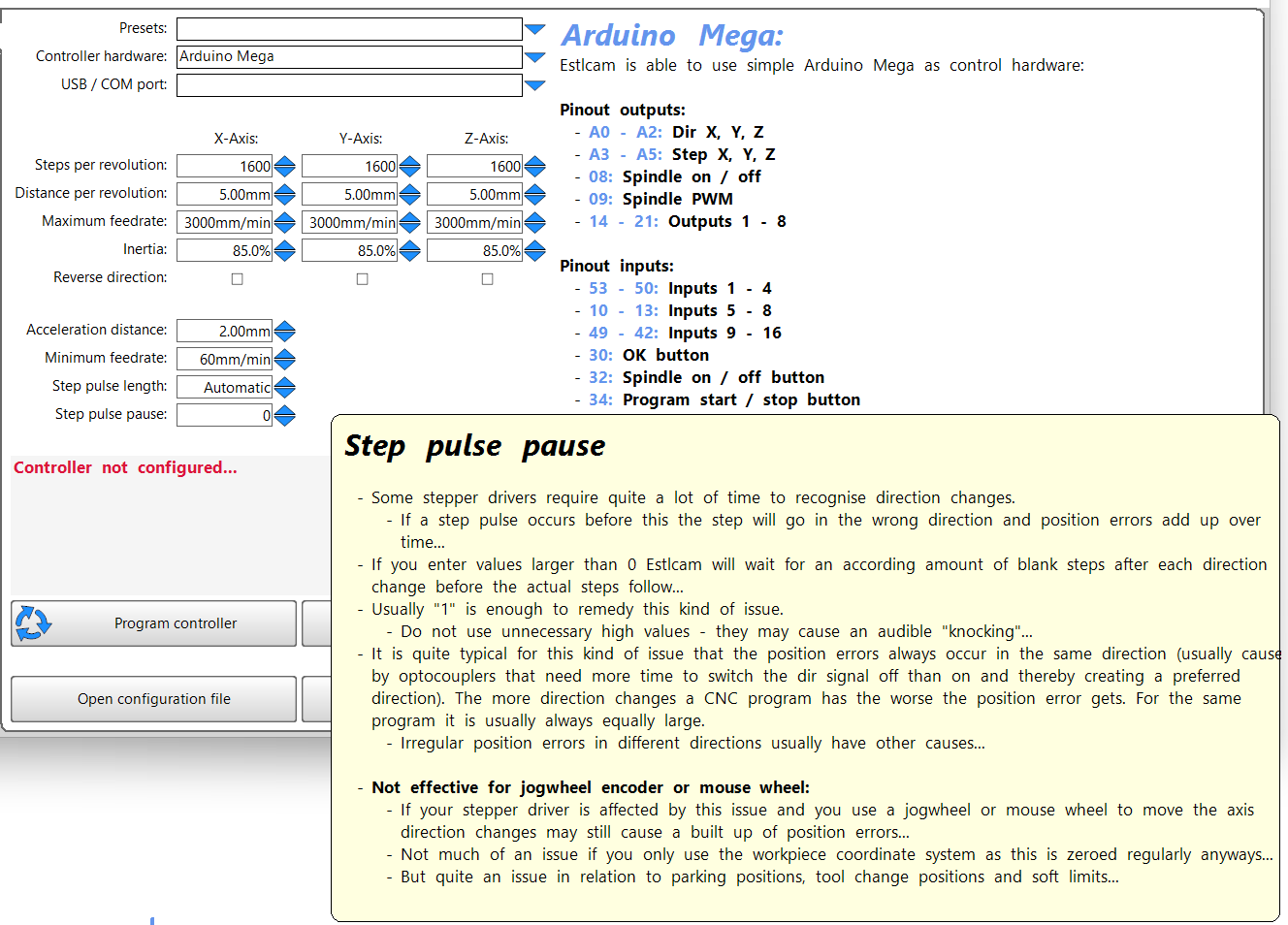

Maybe this is the solution (ignore the rest of the settings, not the CNC computer)?
Hmmmm, I see something similar in our FluidNC yaml, https://github.com/V1EngineeringInc/FluidNC_Configs/blob/main/MPCNC/config.yaml
stepping:
  engine: I2S_STATIC
  idle_ms: 255
  pulse_us: 4
  dir_delay_us: 1
  disable_delay_us: 0
I have never tried to adjust these Pulse and Delay. Looks like our delay is 1, you can check the pulse length as well. see what automatic gives.
The fluid wiki has good info, Axes | Wiki.js
So the smaller the better, but it still needs to be enough. I wonder the best way to test this…It might even be a driver spec.
