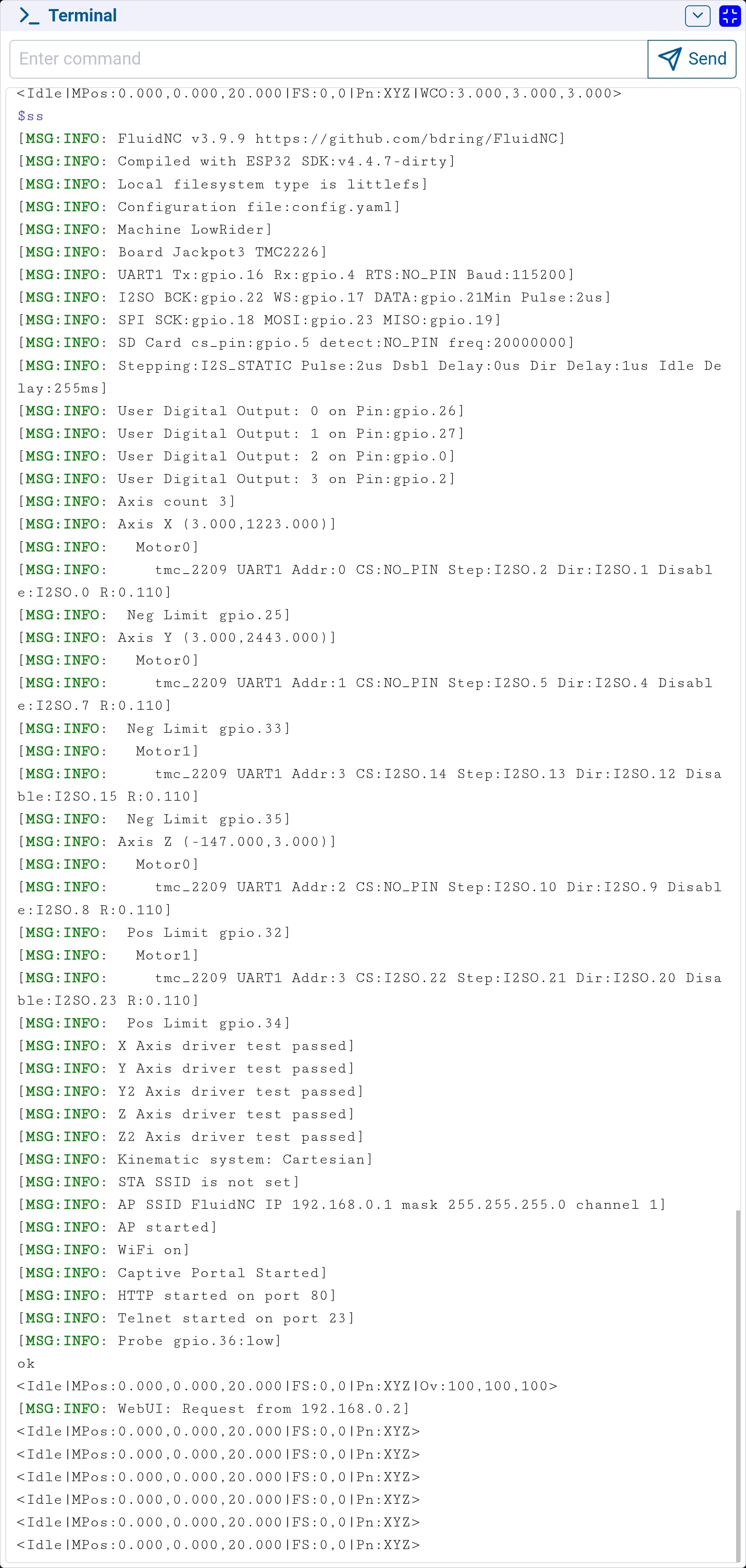

$SS showed nothing out of the ordinary.
What firmware version? If it is not 3.9.9 you should update.
From what port? Or are you saying both parts are having the same issue?

From port C, only steppers having issues are on port B/C.
Interesting. B and C are on the same chip, but issues would normally show up in $ss if there were issues.

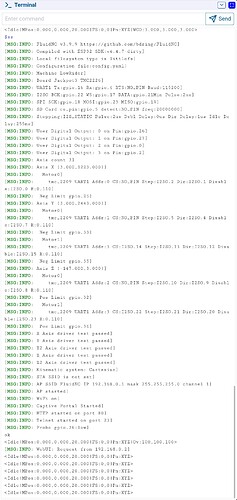

Ya, showed nothing. As soon as I touched the board Z2 shut down. Tried again couldnât replicate.
Here is the $SS after Z2 disconnected on Connector C. No limits are connected just fyi when $SS ran. I am going to meter out the C connector and see what voltages are showing during operation & holding.
Dir to gnd, showing ~12.65v every port. During jog Z & C are 60-70mV while others are 30-45mV When Z dies, C has no voltage. all others stay at 12.65v
Step to gnd close to ~10.5. During jog all goes to 0V then to 12.7 jog again goes to 0v, then to 10.5. Repeats. Although my equipment is not sensitive enough for this. Canât measure pulses
En to gnd All @ ~23V.
Okay we need to swap it out. If you give me your order number I can email you a postage paid return label, USPS.
