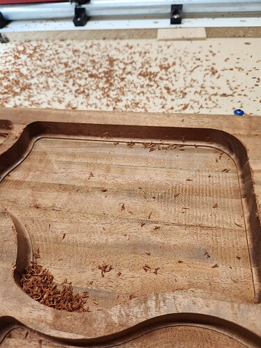

Any tricks to matching z height on tool changes. The is a particularly bad example. This is a 1/4 end mill to clear the pocket and then a 1/4 ball nose to round the bottom. There is a 3mm overlap of the ball nose. The depths are off by about 0.5mm and I ran the ball nose twice to make sure I did not miss probe after the tool change. I am using the probe plate from the v1 store.

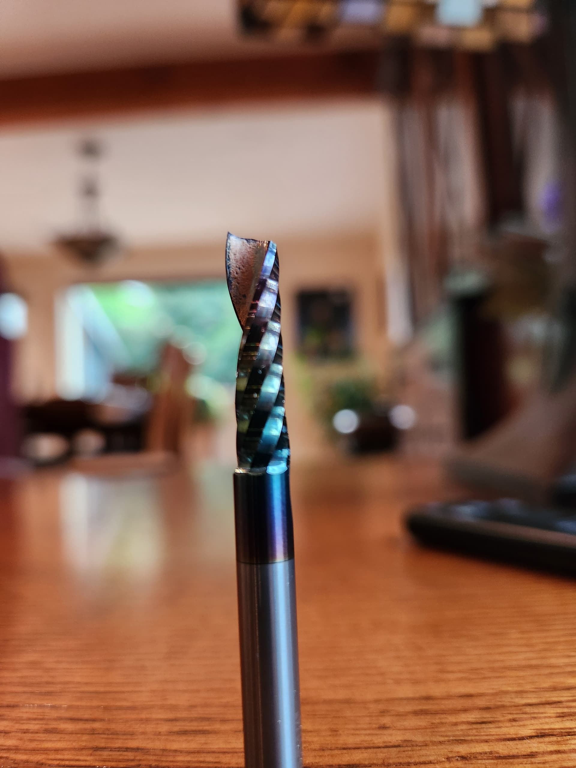

I think I figured this one out, but I am still interested in other peoples methods of getting the same height between tools. The tiny touchplate seems a little inconsistent for me and usually requires sanding. I am sure there is a technique to it that I have not mastered. In this case, I just switched to this single flute O bit and I probed on the corner of the material. I did not realize the tip of the bit was sloped, so I think I didn’t probe on the lowest point, so the clearing bit went deeper by 1.2mm.

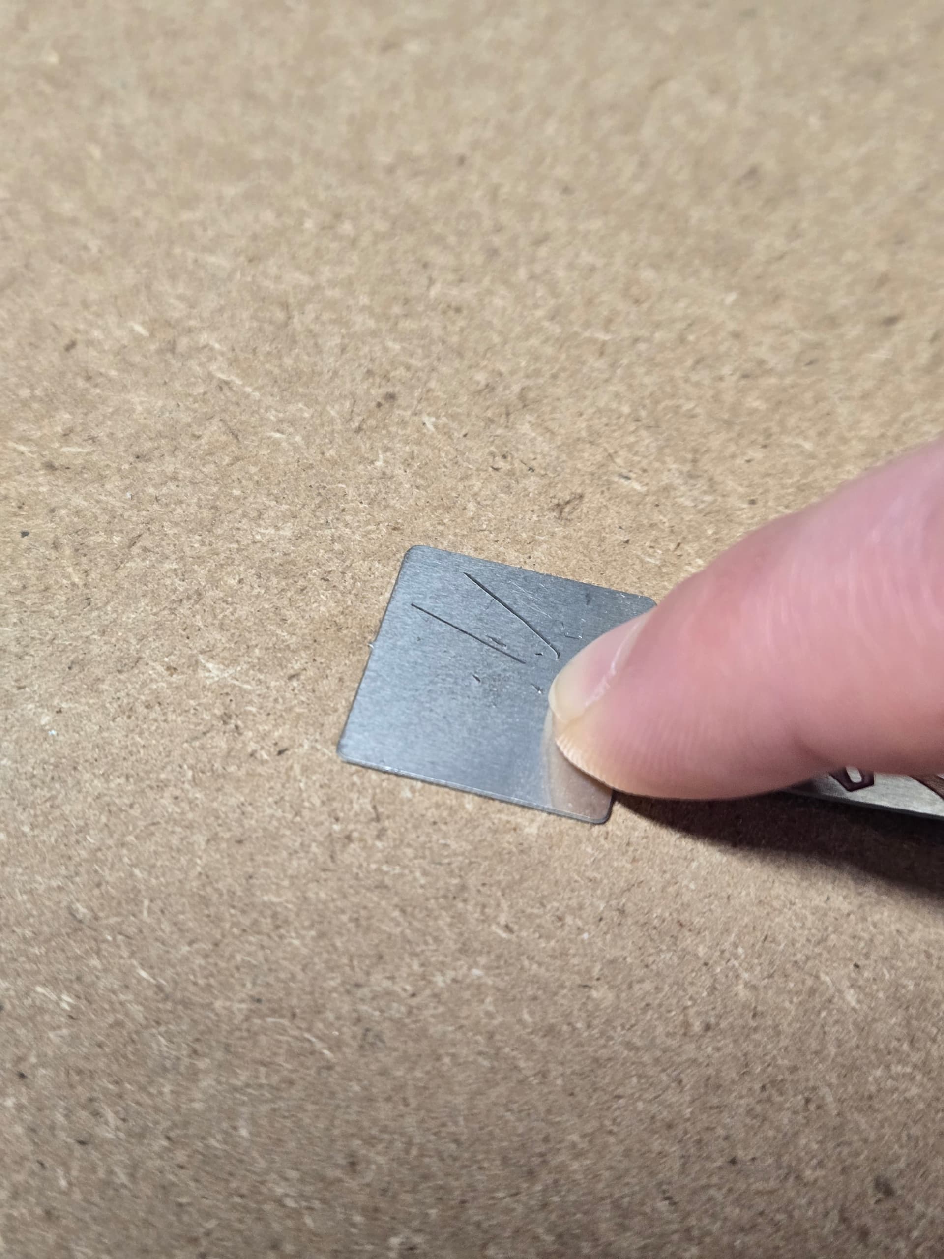

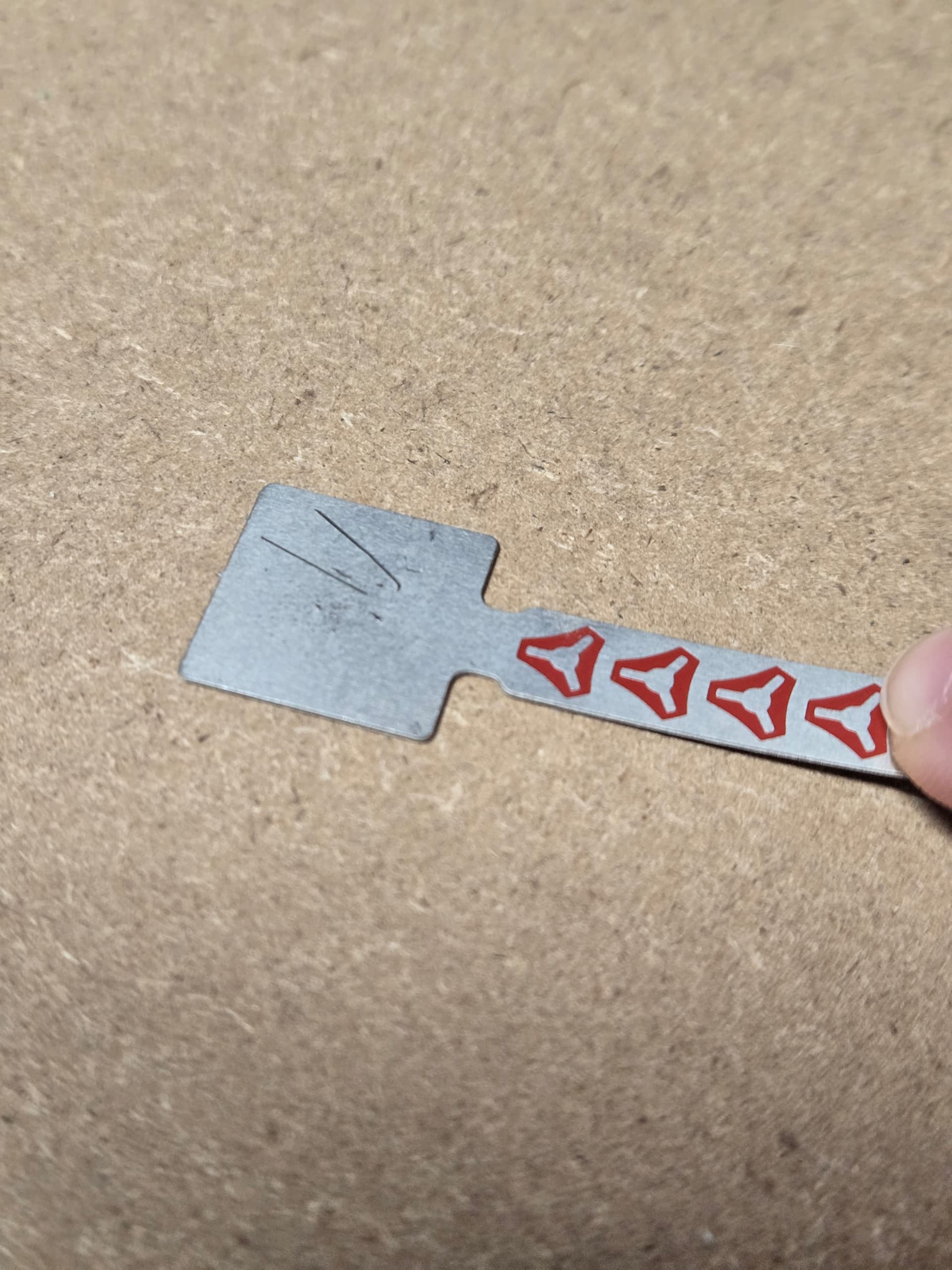

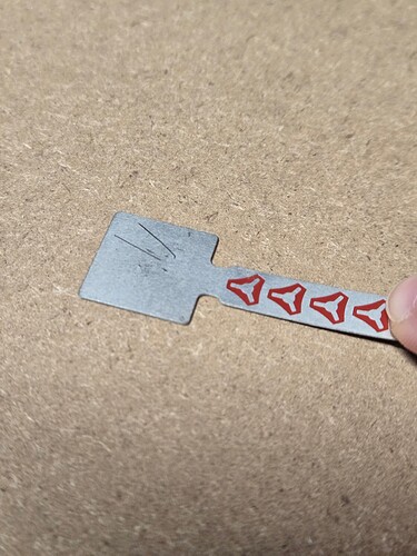

Second, how are you using the tiny touchplate? Are you using the clip to attach to the bit directly? Are you using the magnet to attach to the bit? collet nut? Since the bit has the tiniest tip that actually makes contact, I think it matters. That 1/4 inch ball nose has a bigger surface contacting the touchplate so I would expect it to be more forgiving. I usually clip directly to the bit because I feel that makes the best connection. Sometimes I’ll put the magnet on the bit but I don’t trust the magnet to the collet nut for this type of bit. I don’t know if that is based on fact or just feeling.
Also, in terms of actually using the touchplate, I think most will hold the touchplate on the skinnier part and bend it flat to the surface. If you aren’t getting the full square flat to the surface, it may not be accurate.
What I do, to make sure it’s flat against the work surface is actually push down on the square part. If the workpiece isn’t fully secure to the spoilboard, this would make a difference as well. I went into a bit of a probing accuracy deep dive when working on some Z leveling gcode. That probes a location 3 times and averages them together. I can pretty easily get sub 0.1 mm repeatability when doing this and clipping directly to the bit.
