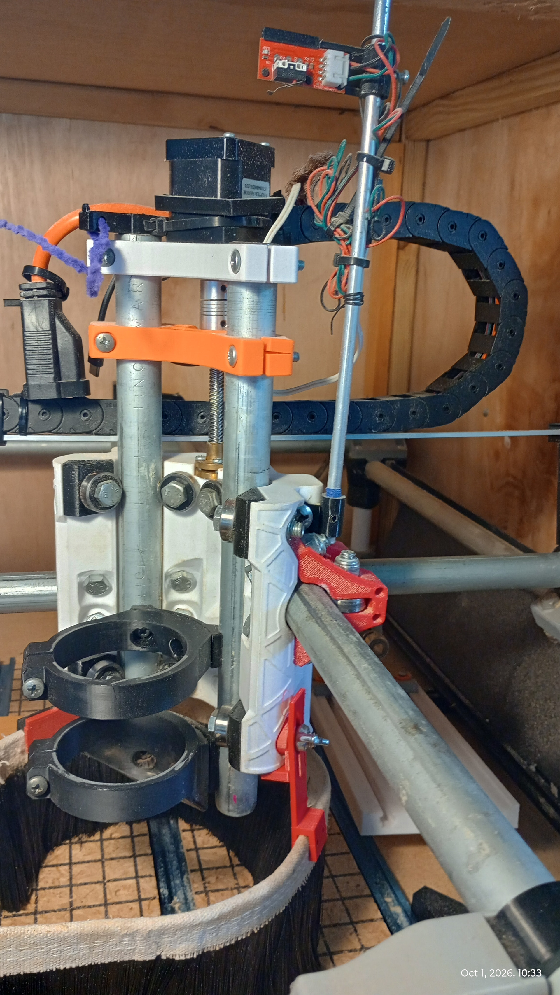

Z end stops on primo
It appears that primo doesn’t have a z end stop and relies on the probe to set the z height. I’m building a primo at the moment and have ordered a jackpot 3. I’m used to the concept of a machine having machine coordinates and work coordinates. I don’t see how you can have a machine coordinate system without a z end stop. Am I missing something? Am I correct in thinking that the Jackpot 3 board and a suitable yaml file supports a z end stop?

There isn’t a Z+ entstop in the MPCNC design, so homing up to top of machine travel isn’t possible on the MPCNC.
I’m using Jackpot 1 controller, on my Primo, and I’ve added a z-enstop.
I have a switch mounted on an aluminum rod which is attached to the core.
Here is an image of my primo core showing z-end stop, used for homing only.

Thanks for the welcome. I’m using Fluidnc on the Jackpot 1 board. The changes I recall setting are:
Homing cycle : in the z axis: set to 1 (my x and y are 2 and 3 respectively).
Homing Machine Posistion MM : set to 0
Positive Direction: set to true
Homing Seek and Feed mm-per-min: set them to your liking (300,800 for me)
Soft Limits : Set to true for z as well as the other 2 axes.
Pull off distance for Z . I set mine to 2
