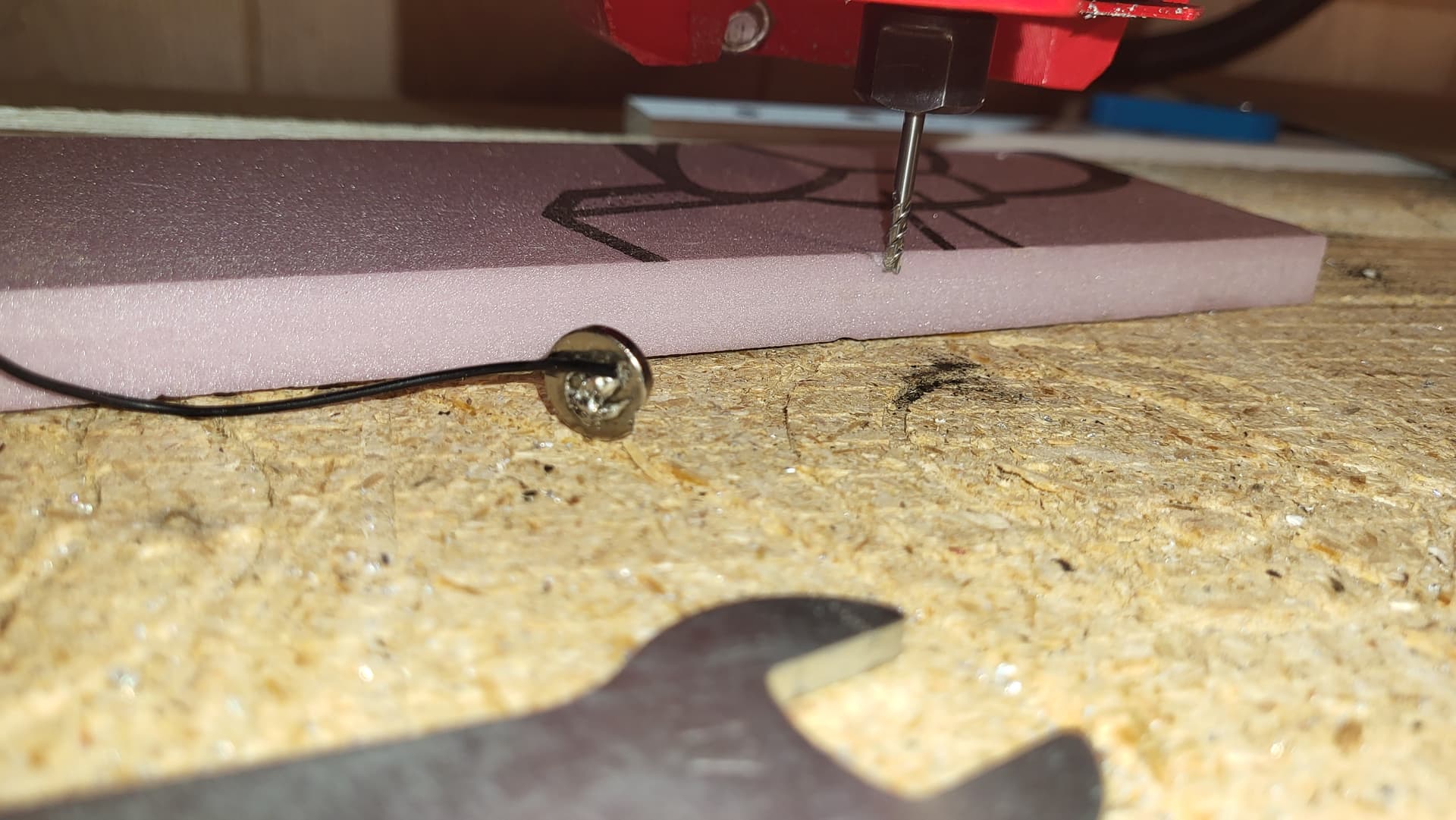

When I run this file, I lose a bunch of steps. I looked at the gcode and the z never goes more than -1mm, but as you can see, the step loss is well over that. Pictured are the 0 before, and after running about 1/2 of the file doing a air cut.
Looking at previous posts:
I attempted to edit the stepping pulse to 1, but received ‘[MSG:WARN:: Increasing stepping/pulse_us to the IS2 minimum value 4]’ in return. This has seemed to be the best answer previously, but it appears the option to lower the stepper pulse below 4 is locked.
RF noise shouldn’t be an issue as the z cable runs with the router cord, but the router is unplugged for air cuts.
The axis is not binding, the rods and nuts are new (alternate edition with adjusted steps and speeds because I forget and crash my bits when I turn it off all of the time).
The z moves up and down without a problem I can not turn the rods when powered. Everything is lubed and sounds like a sleeping baby.
TLDR- If you are experiencing these same issues, try cutting Z acceleration and max rate a time or two and see it that clears it up.

Looking at your g-code, I spot one potential problem. It would be a problem with Marlin, but I’m unclear of how rapids work with other control boards. It looks like your rapid movement up (G0 g-code commands) are occurring at the same speed as your cutting movements (i.e. F500). Depending on your setup, this can be too fast for the steppers to lift the router. The faster the router movement, the less torque the steppers have. The first place I see this issue is line 116, but there is more than 100 instances of fast Z movement in this script.

@soup, you mentioned “alternate edition”, the default stock Lowrider 3 build uses 4 start lead screws, are you using these, or something else? If you’re using something like 2 start lead screw then rapid and feed rate speeds need to be halved.

I’m using V-carve for this particular project and have not figured out where that setting is yet. Last night I edited the gcode to make the G0 feedrate 25 on Z moves, same as the G1. I’m going to run it today and see what the outcome is.
And yes, the feeds are cut in half in Fluid as directed. I might drop them more if the test does not work, but this exact issue was happening with the 4 start rods as well. That was one of the other reasons I wanted to change them out. They were also not looking true, so upgrade all around for me.
I got back to this today after the weekend. I opted to redo the DXF a bit so I could cut in ESTLCam. Once it gave me gcode, I replaced all G00 Z moves with G001 and set the feed to 25. I ran an airtest at twice the speed so it wouldn’t take as forever, so the effective feed rate for z moves was 50. Results were not good. Still a sizeable drop in Z height after the cut.
I went back and cut my Z max rate and acceleration in half again in Fluid (300 & 40, respectively) and the last aircut came back to the original Z0. I’ll run the file tomorrow with foam or wood but this looks promising so far.
I did a couple of things. I ran another aircut with code from v-carve instead of ESTLcam to see if it would return to 0 properly, and it did. This appears to have needed a firmware tweek, not a software tweek. I then ran that code in foam and it is a brilliant success.
