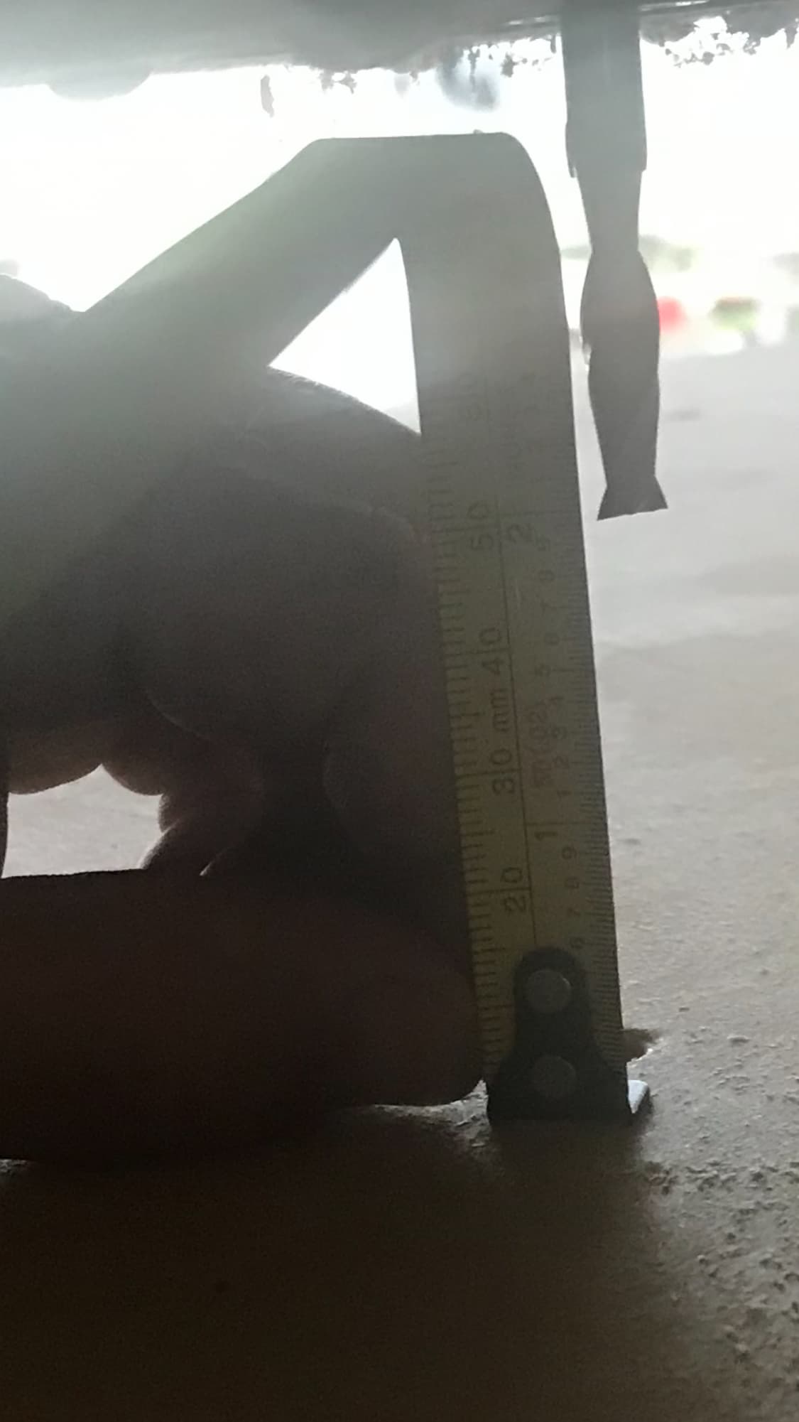

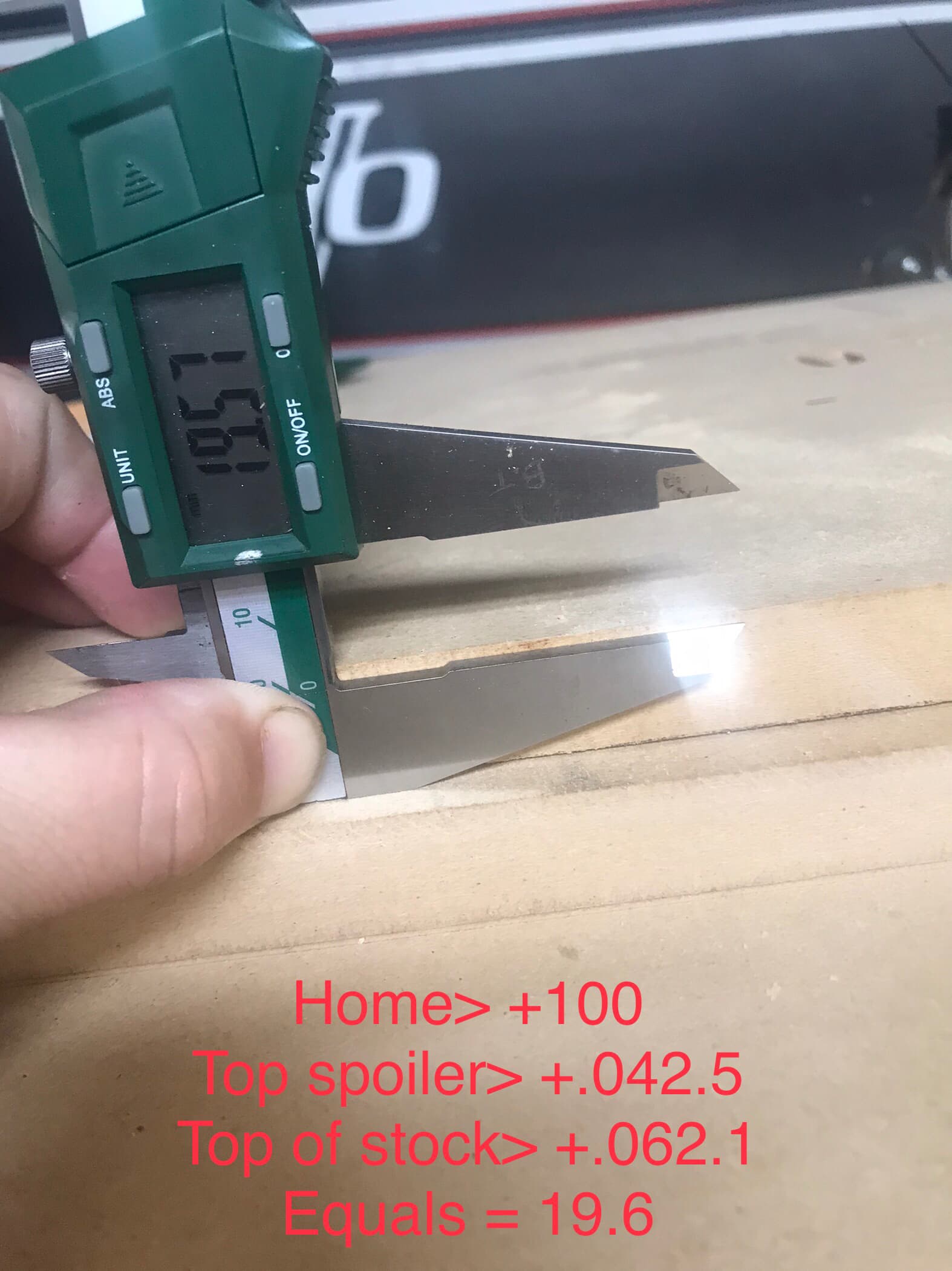

Touched off zero, however I was concerned with the z being off but I measured form left to right with calipers didn’t seem that different.

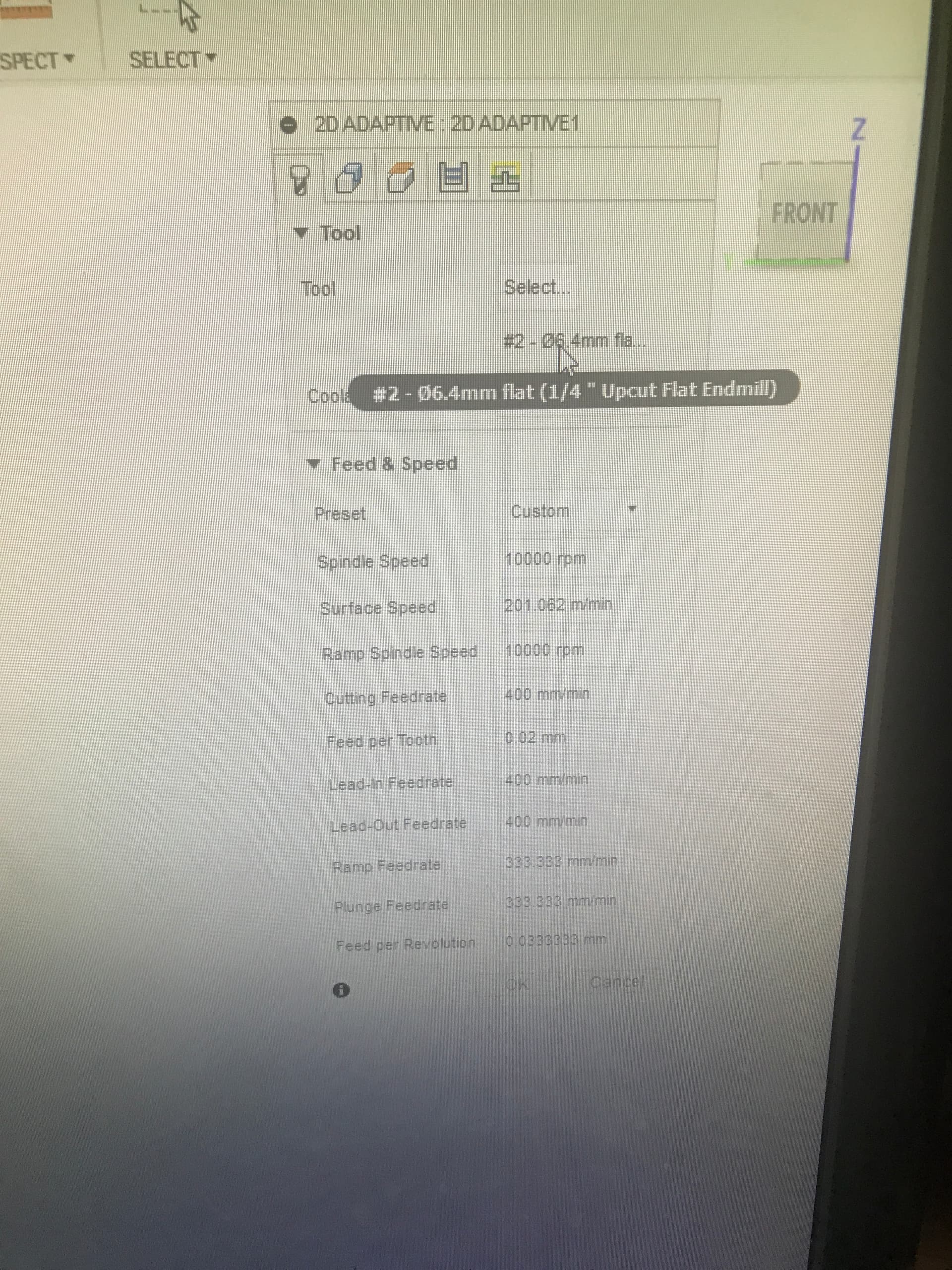

Seems to home fine to the naked eye, however had the spindle speed factored at about 13000 on the dealt router.

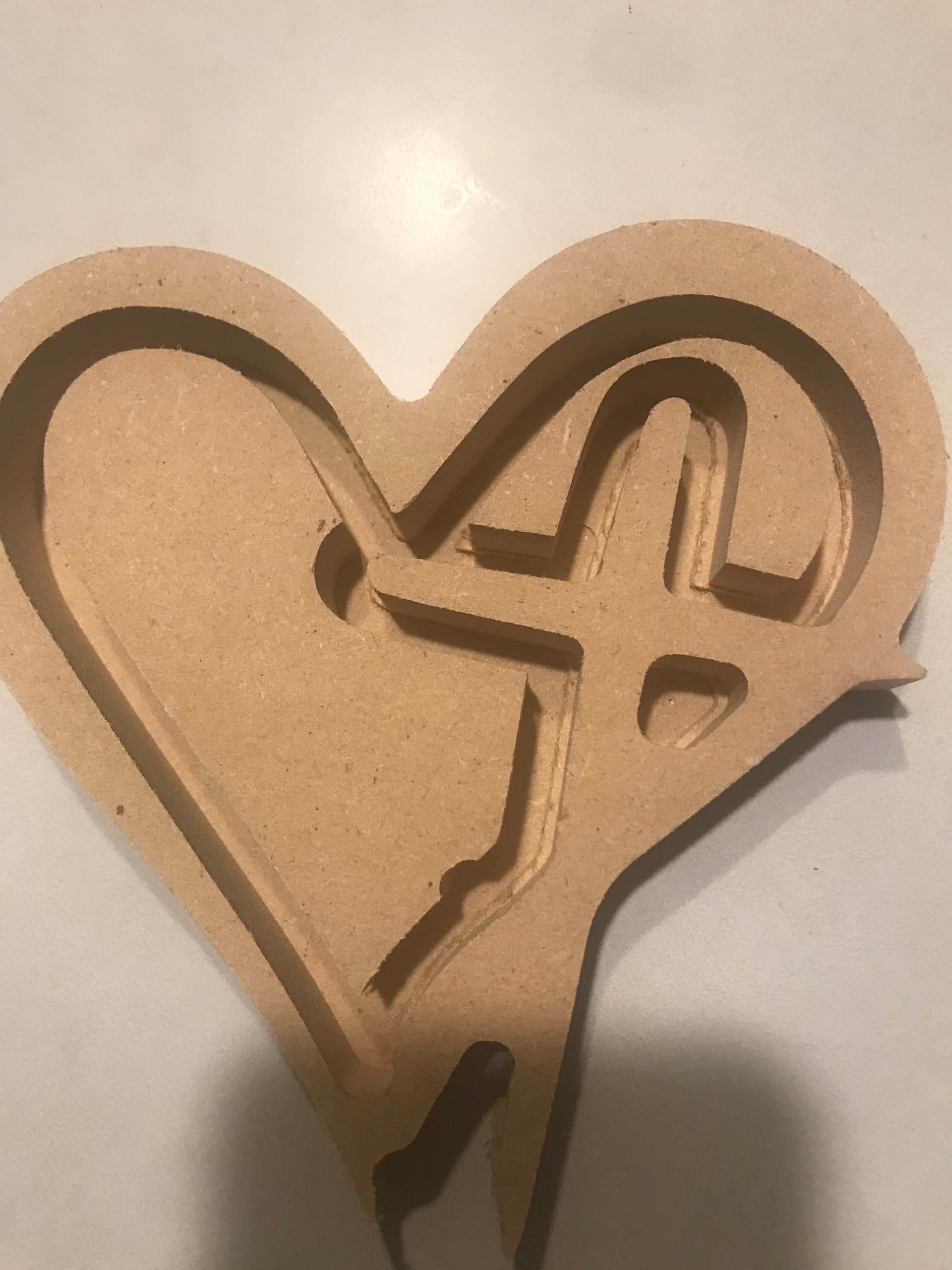

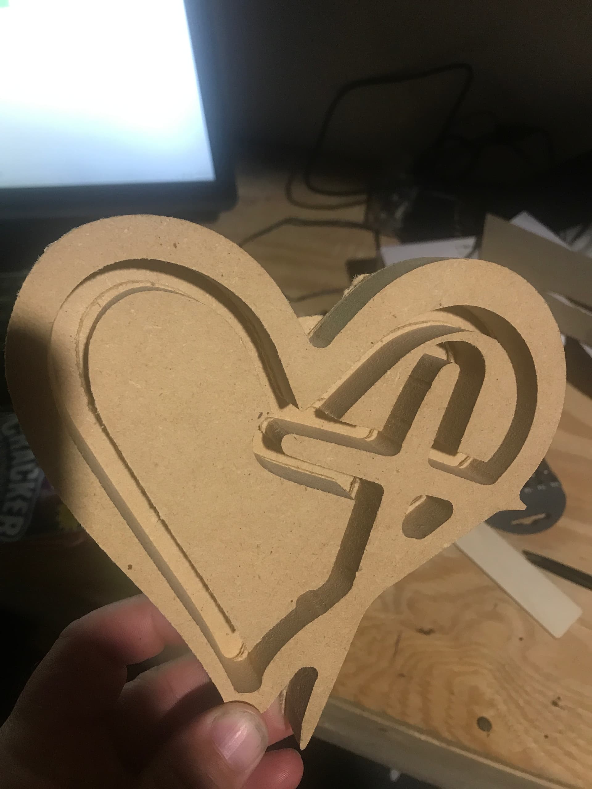

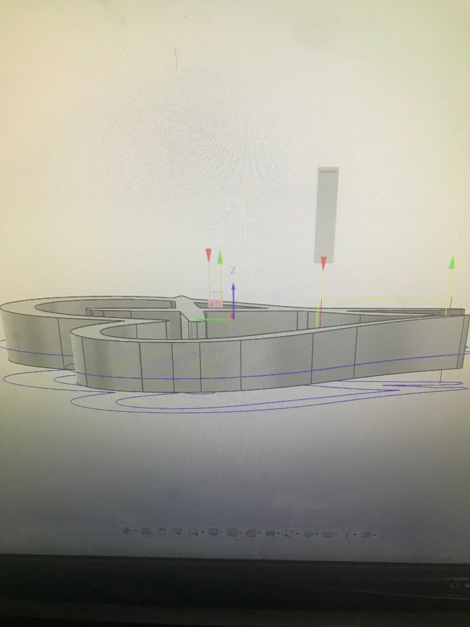

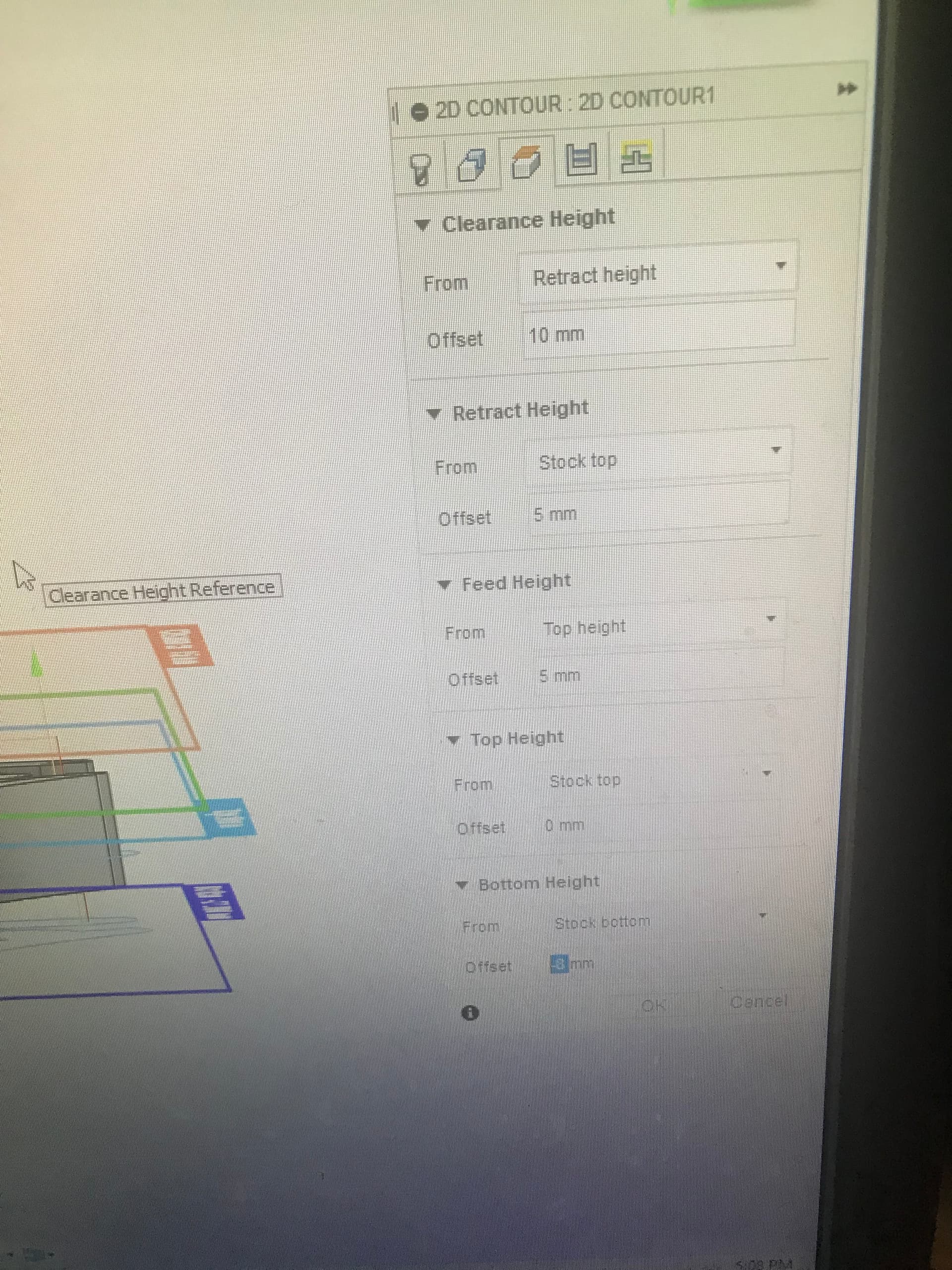

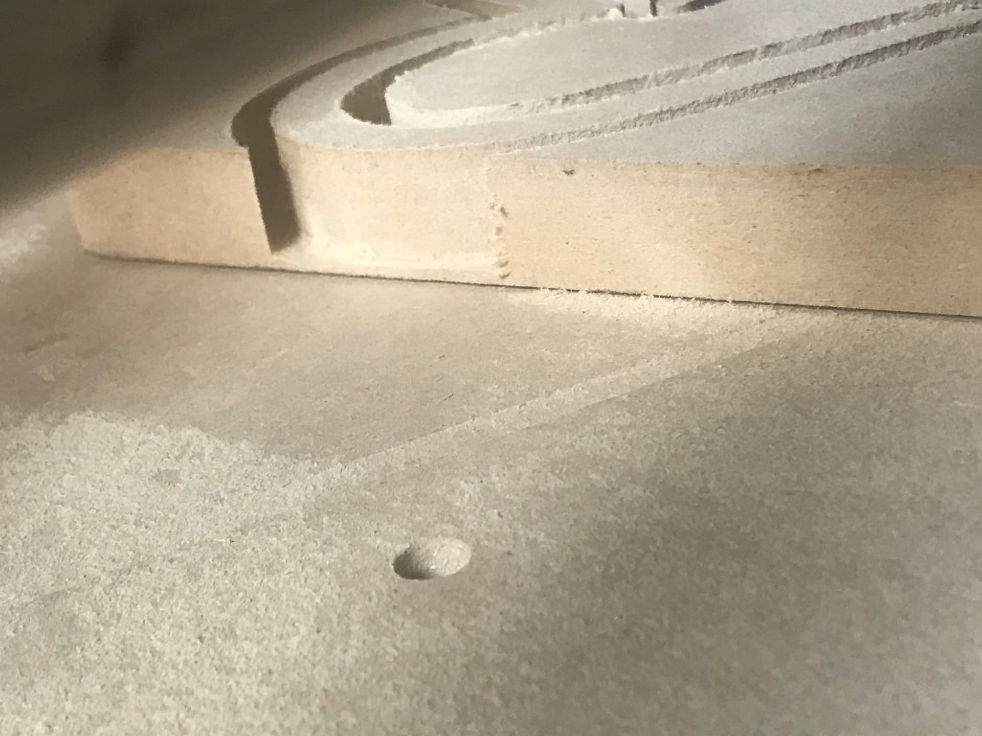

Problems: i modeled the depth of cut to go to model bottom, even offset it negative by 8 plus mm and still never broke through. There’s about a .020 or better ledge all the way around the bottom of part.
Inside the contour there is some serious deflection/z values that are obvious. With that though work holding for that part was no more than double sided tape (didn’t have a good way to clamp with inside countour and outter) therefore maybe some vibrations of the Mdf would leave that ??? :man_shrugging:t2: The endmill was a uncut 1/4 for it choked up as much as can in the router.
I do believe may be some belt issues on the y axis closest to the controls.
Open to any suggestions to try and clear this up.

Before I forget after looking at the part almost looks like there’s maybe a cutter comp setting I don’t have set right. It is set to climb milling.

I always have my bottom Height set to 0 mm

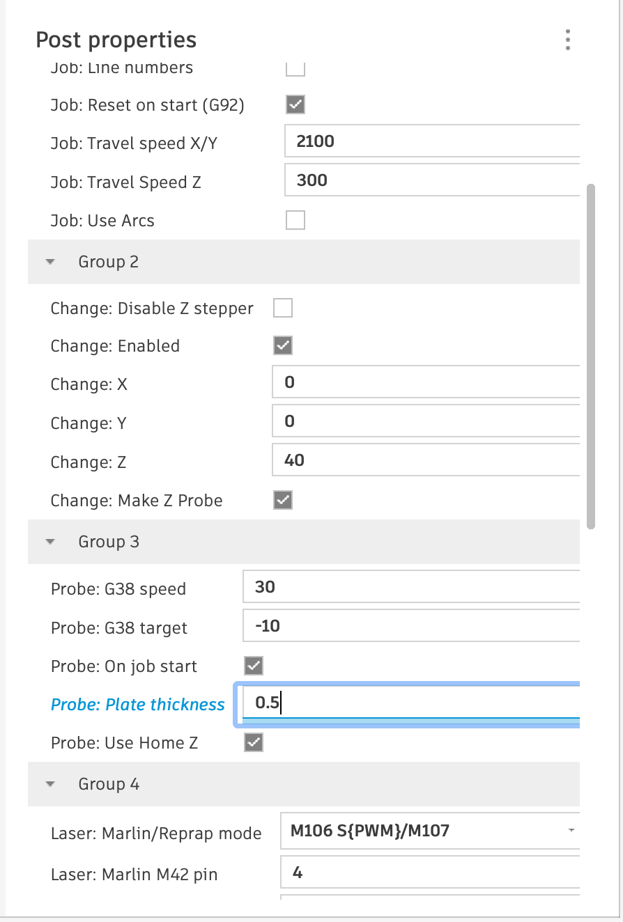

On the post-processing side.

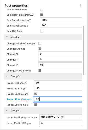

What does your probe: plate thickness show?
Blue rectangular in the picture.

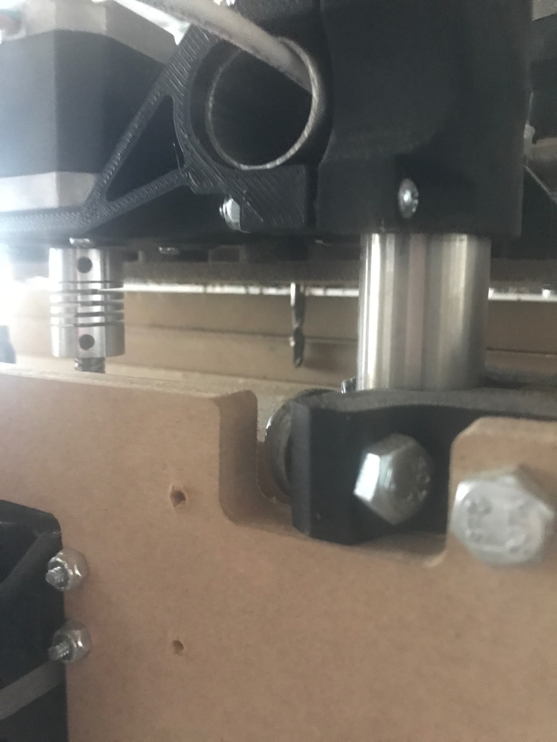

  • Mark your bit in the collet so you can see if it moves during cutting.
Just looking at the Z issue, my first two thoughts were 1) you don’t have the steps per mm set correctly, or 2) the bit was not tight in the collet and slipped up in the router.
That’s what I’m afraid off all those things, collet wouldn’t be an issue to fix but others… not so easy.

The collet and endmill was still tight!

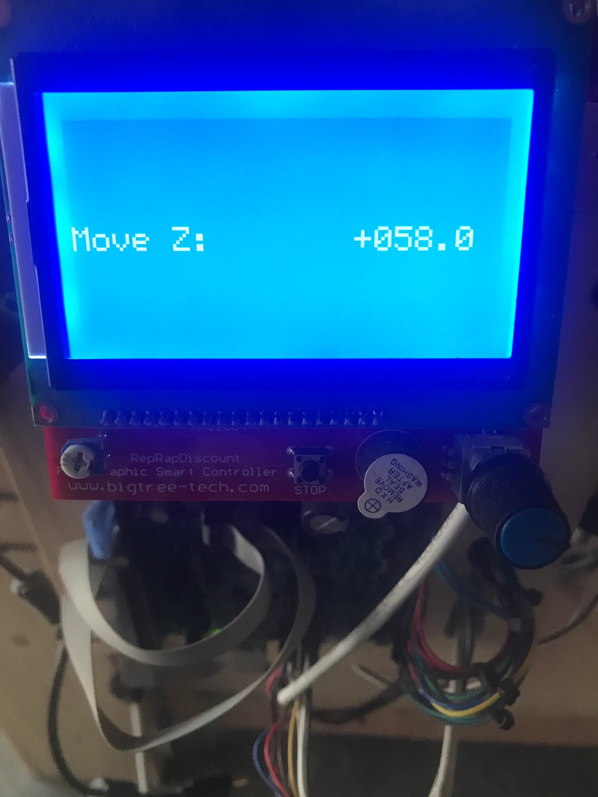

@robertbu well according to the screen from zeroing the z on the wasteboard and setting that Z0 > moved up as close to the homing switches and it appears it’s off. As I would assume numbers should match.
^ actual with tape from zero
Here is the screen display from the same zero

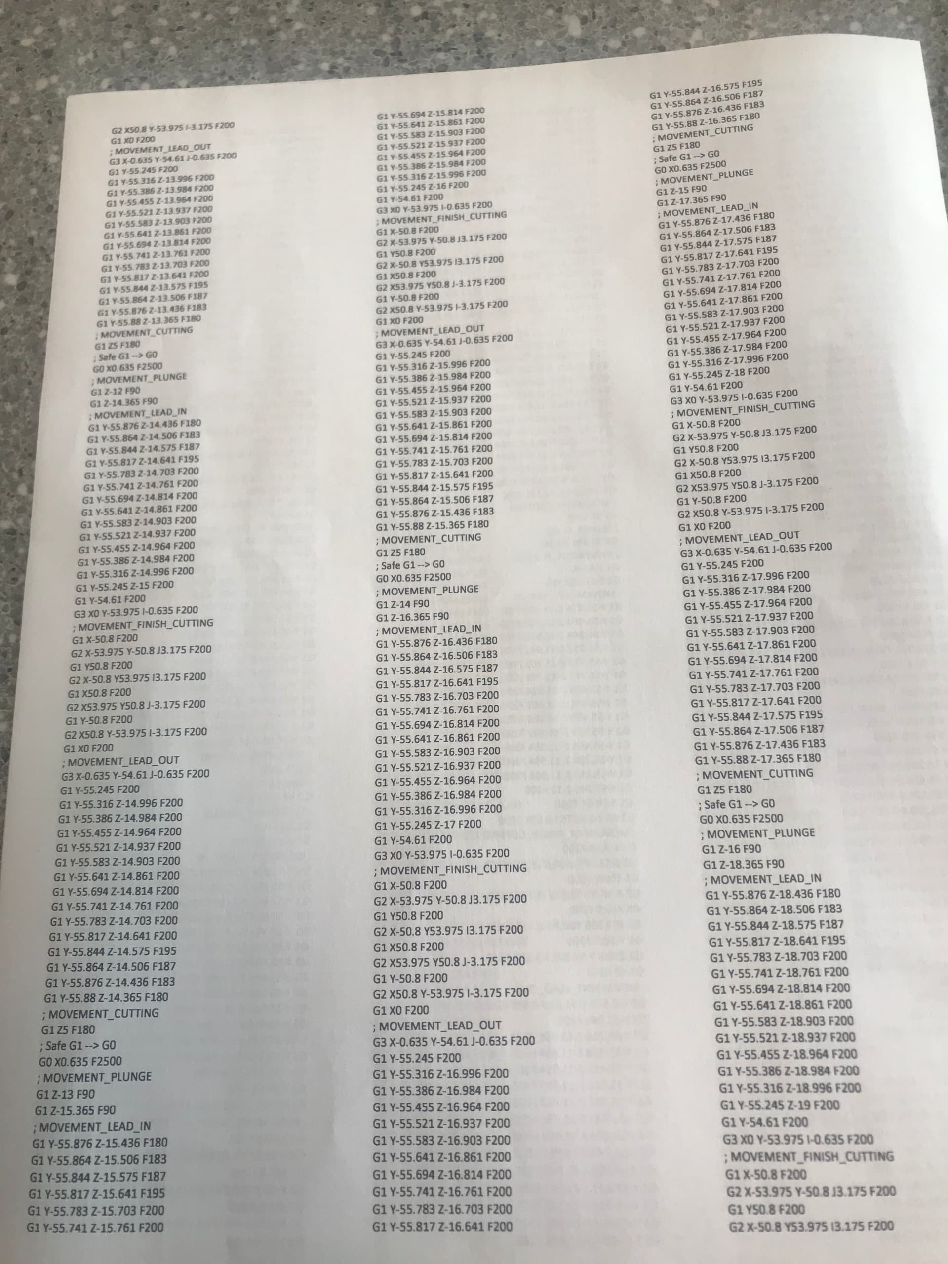

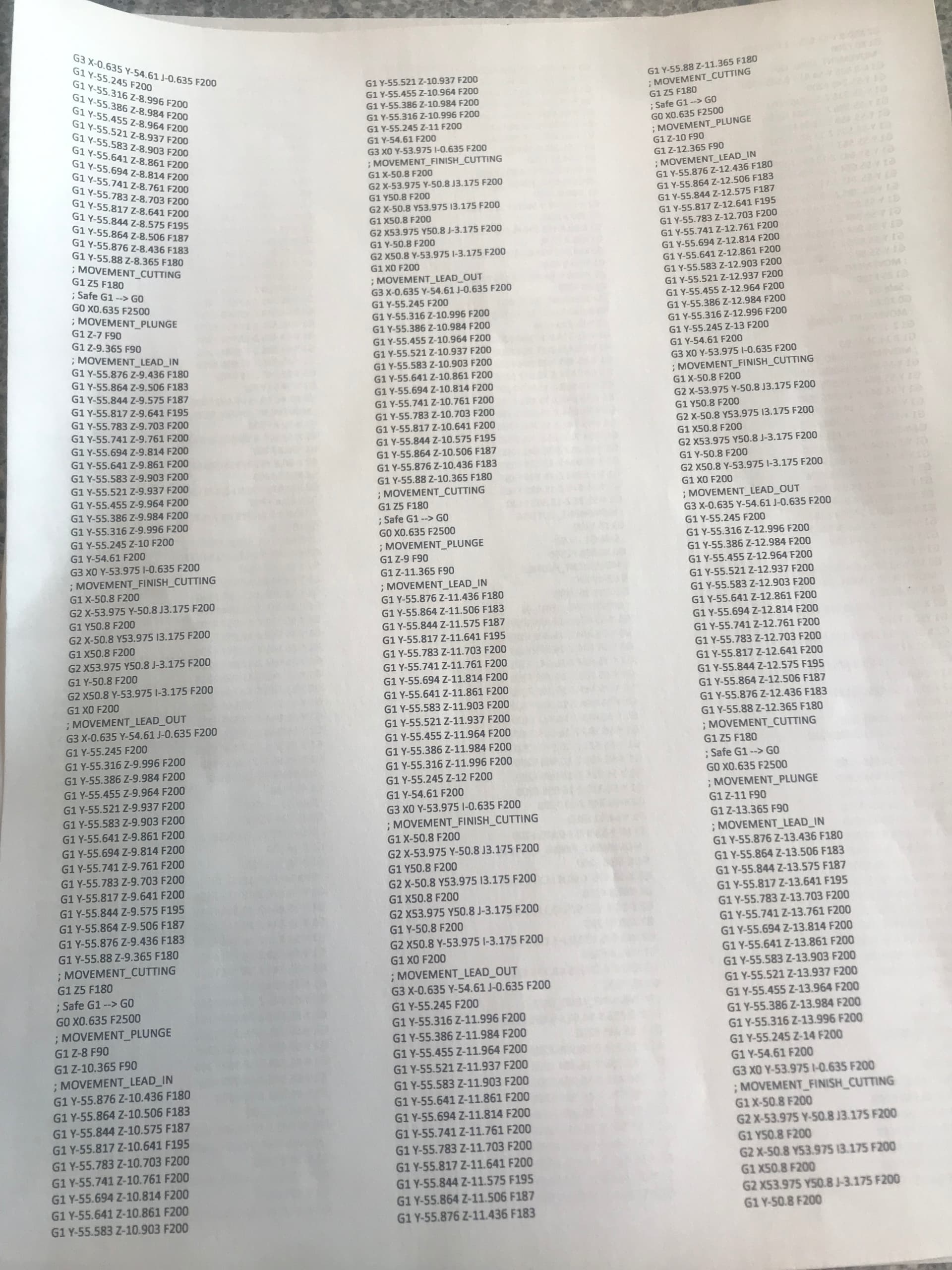

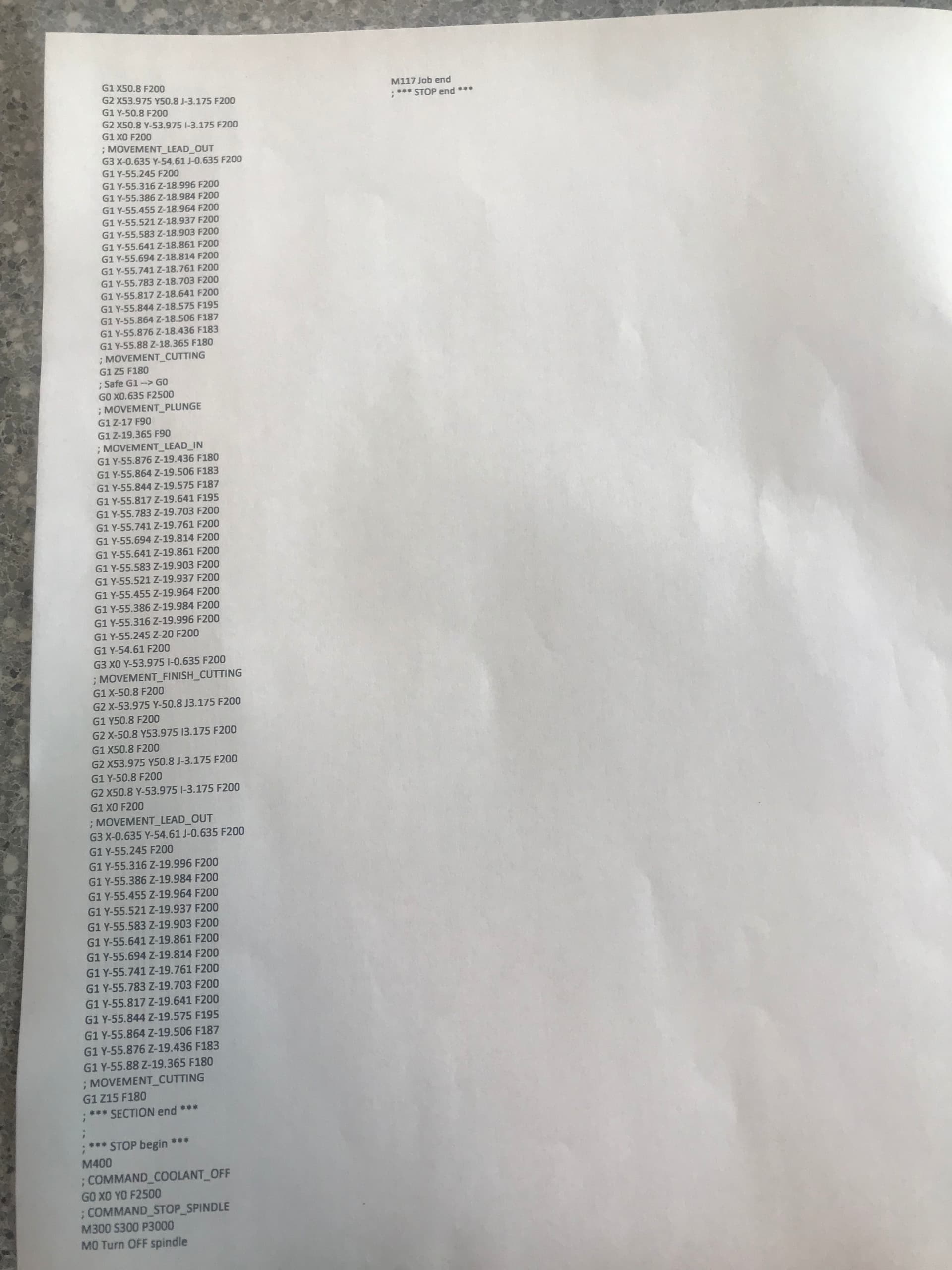

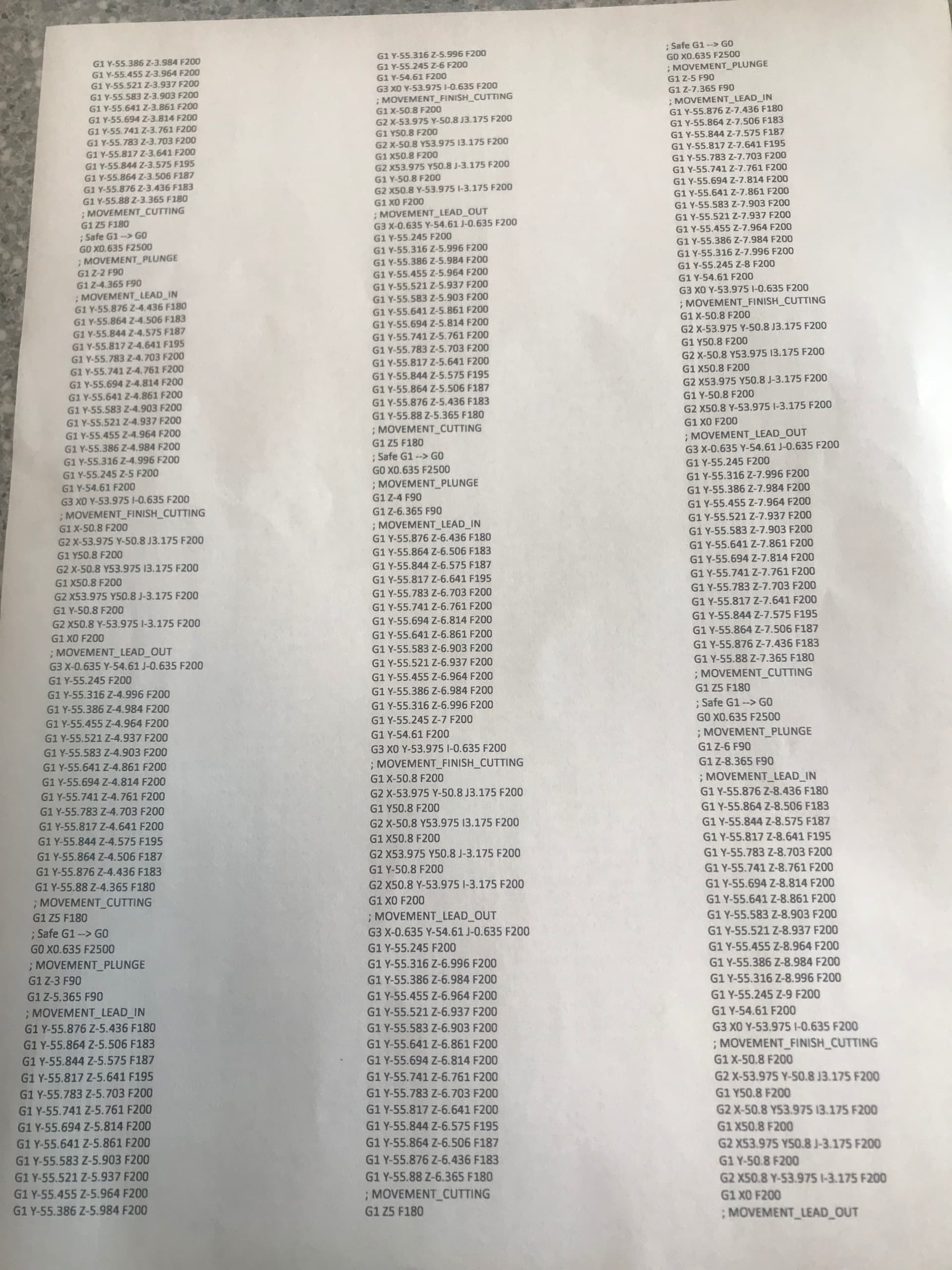

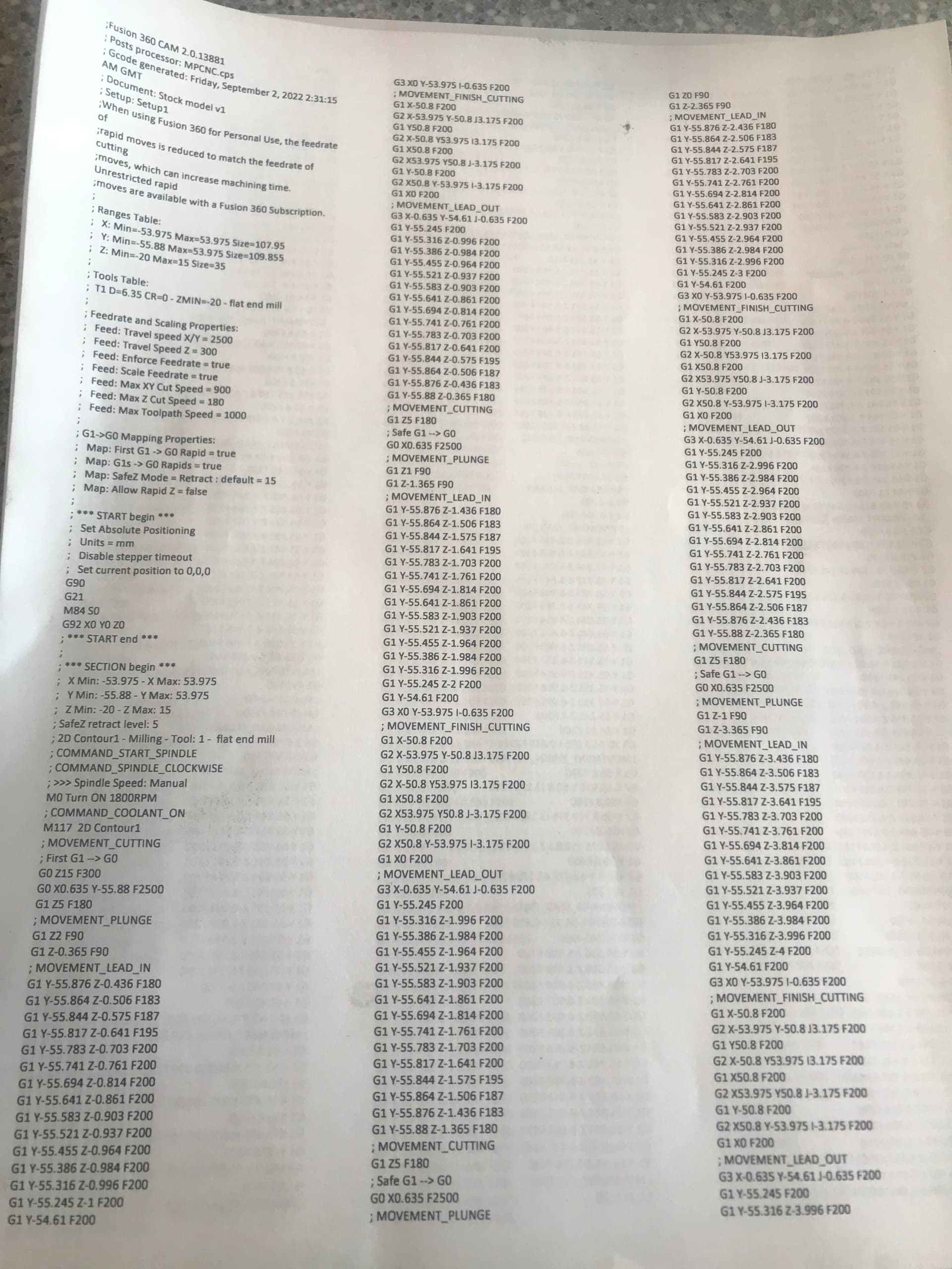

This is gonna get lengthy but, Here is the gcode file i punched out last night at 11 pm before giving up.

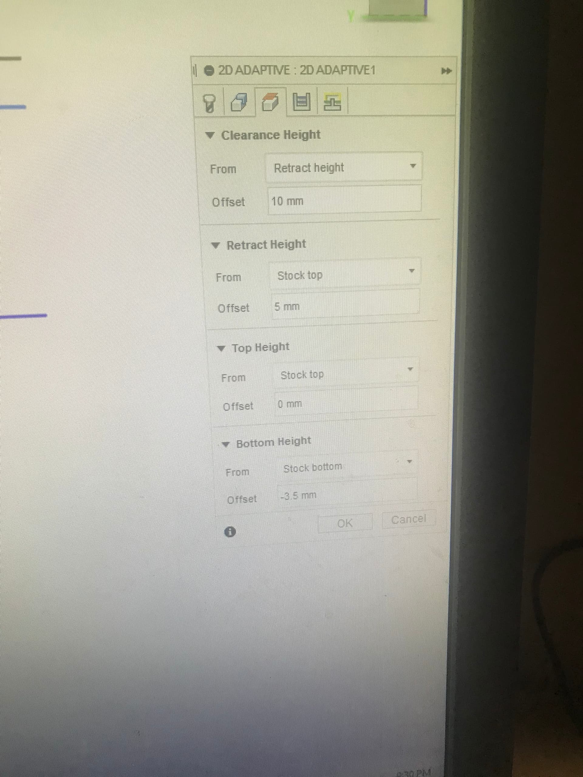

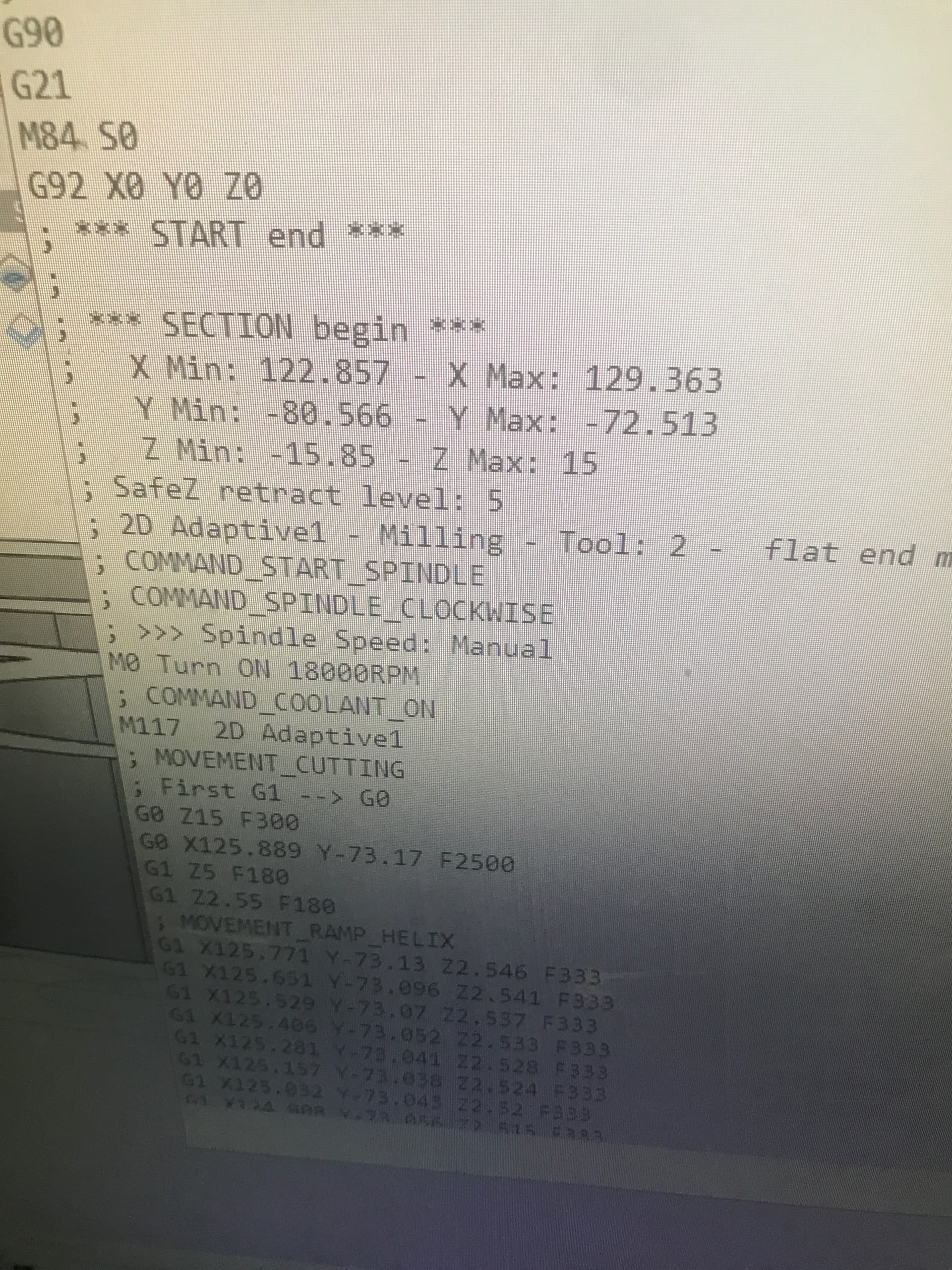

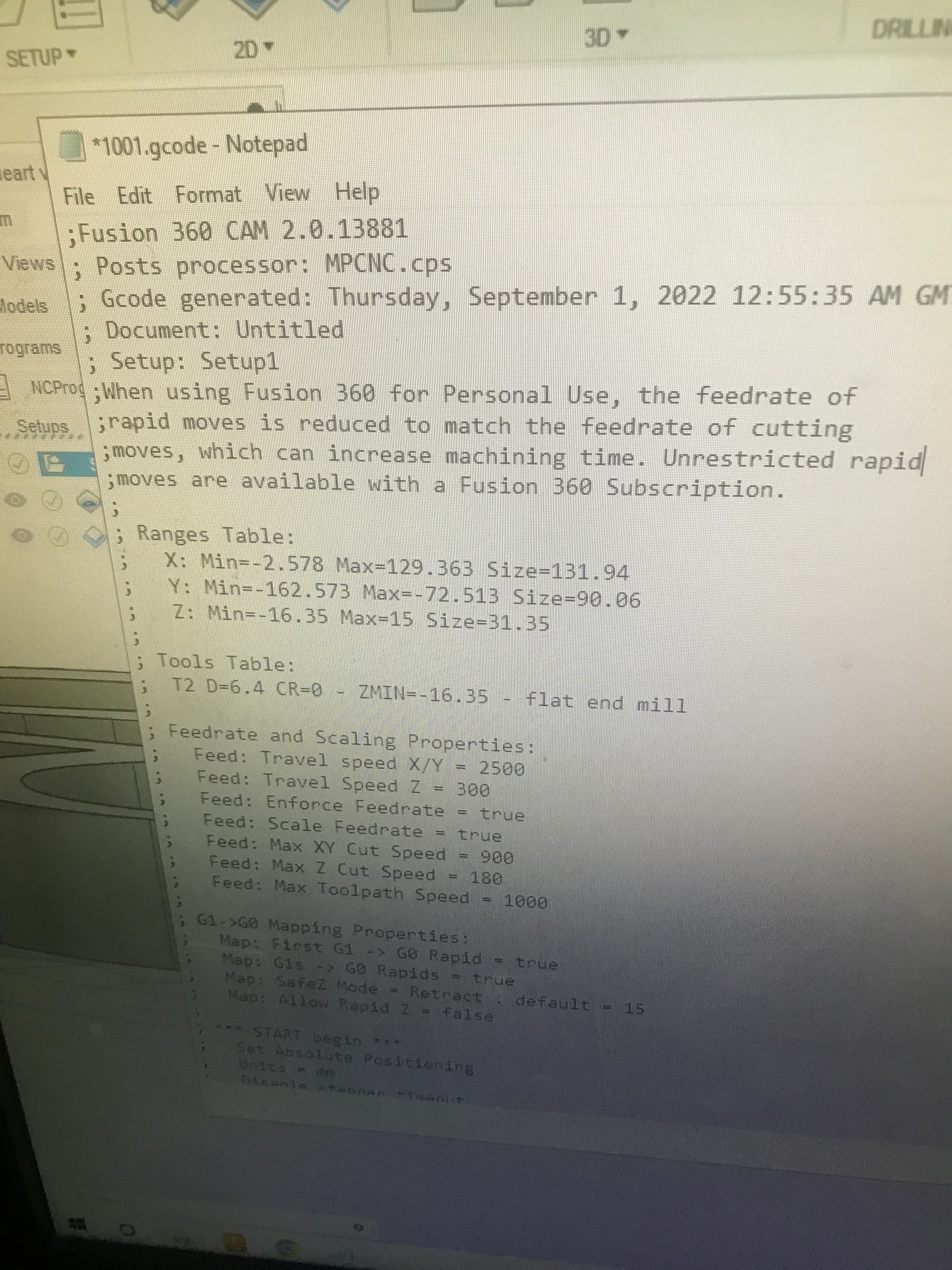

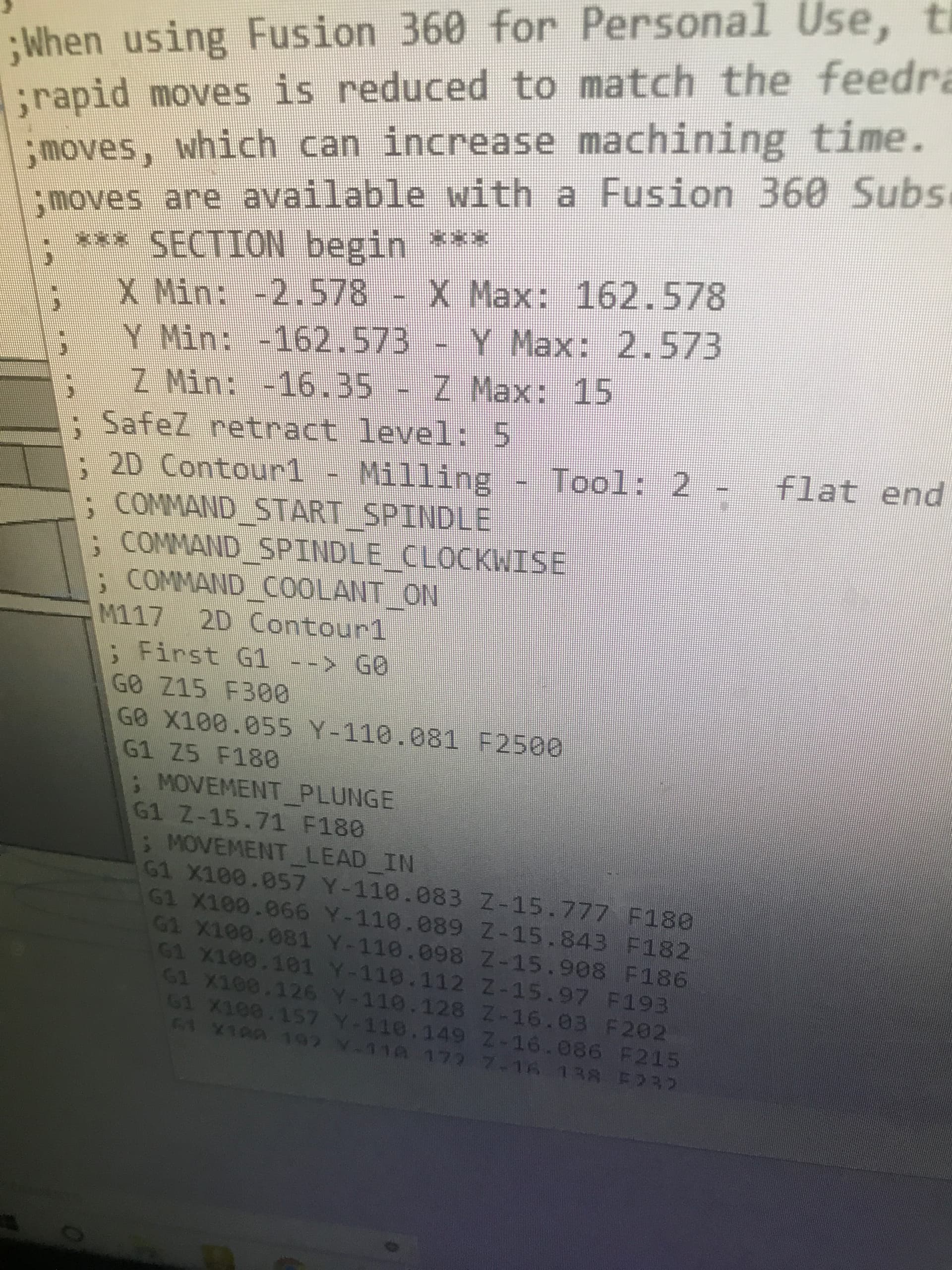

See photo’s regarding the limit z values
For starters I did just see that the z min is set to Z-16.35 which limits it out im guessing? As i was needing More travel in the z. which makes sense why it wouldnt go down anymore than -16.35
Each tool path generated has its own z min setting and at the top of the post it has one listed. Thought about typing z-20. MM MIN but I’d have to adjust all of the code to correspond
What would be the solution for that?

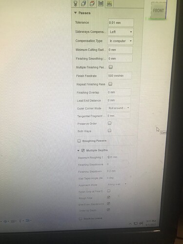

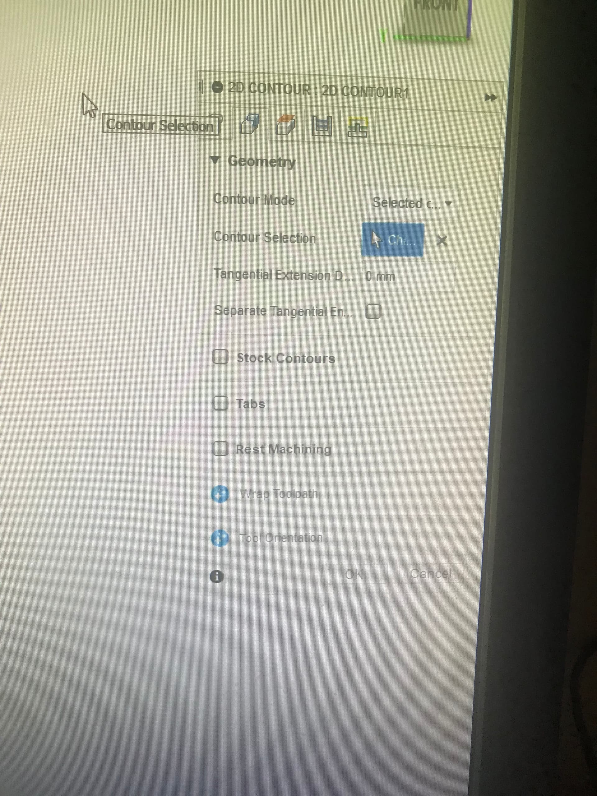

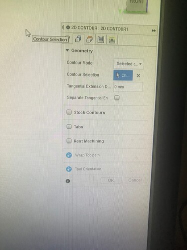

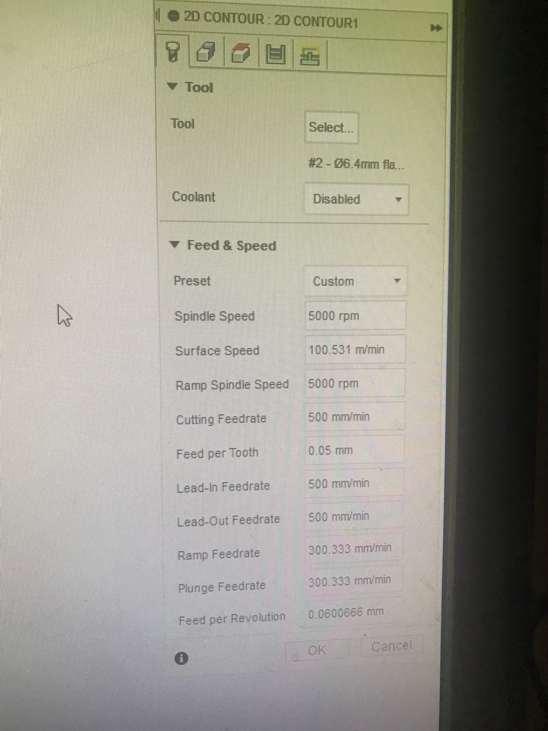

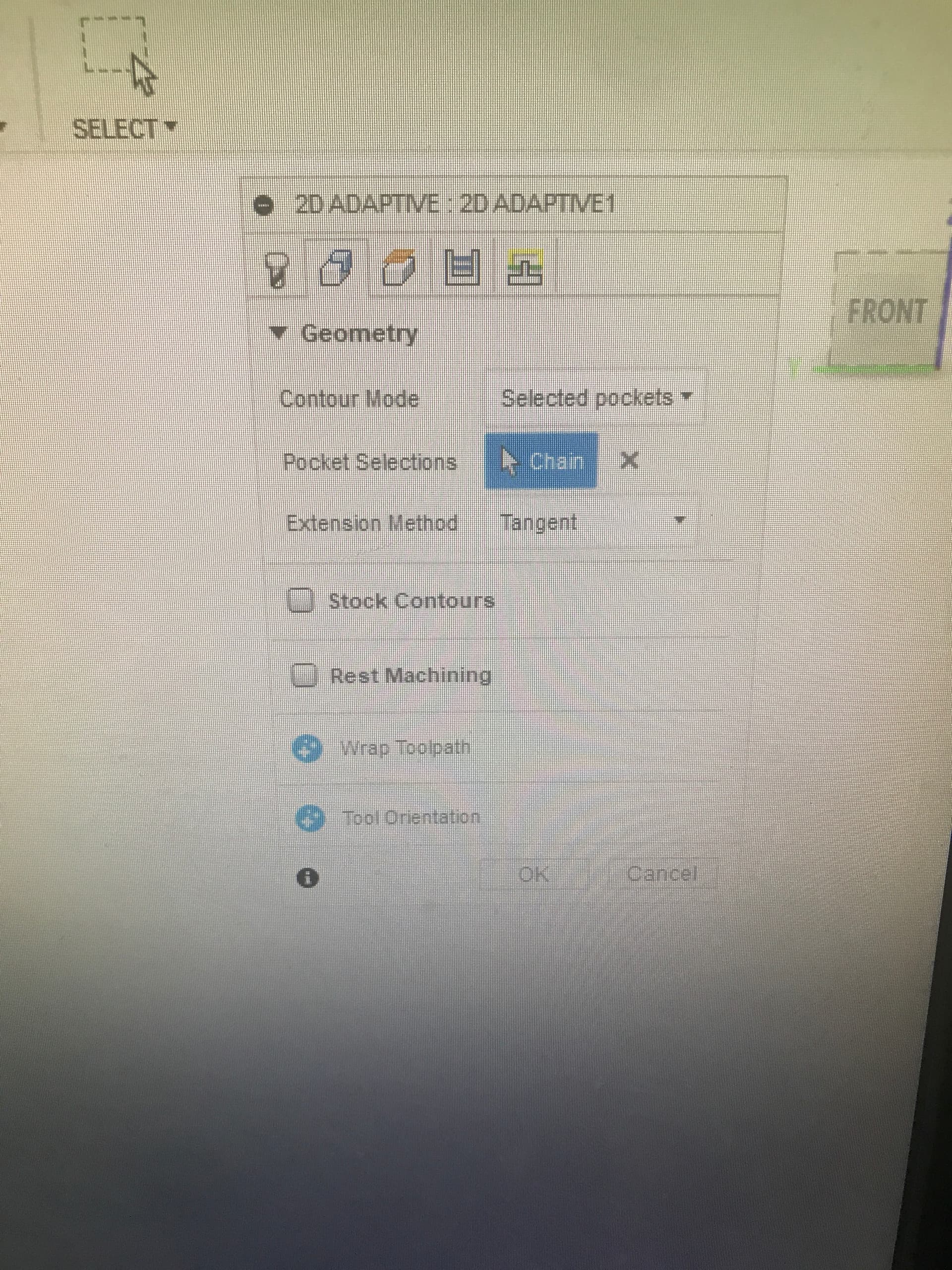

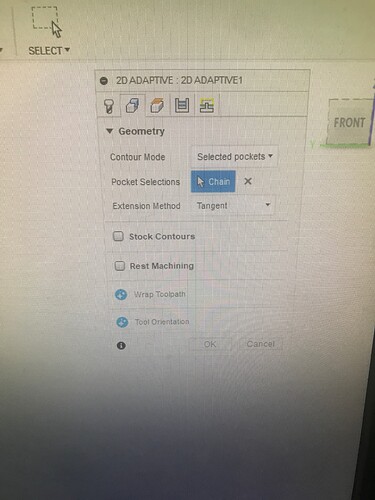

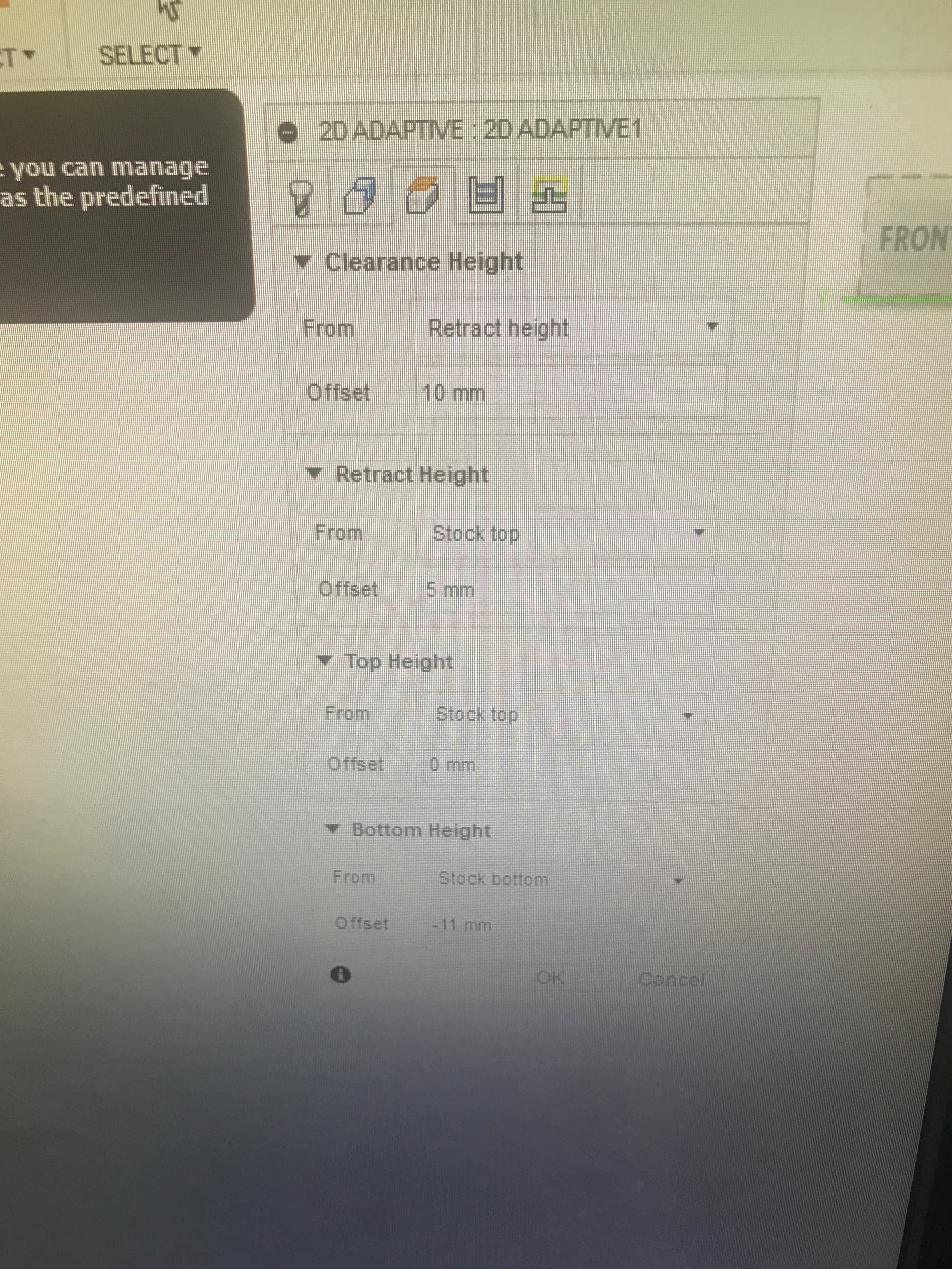

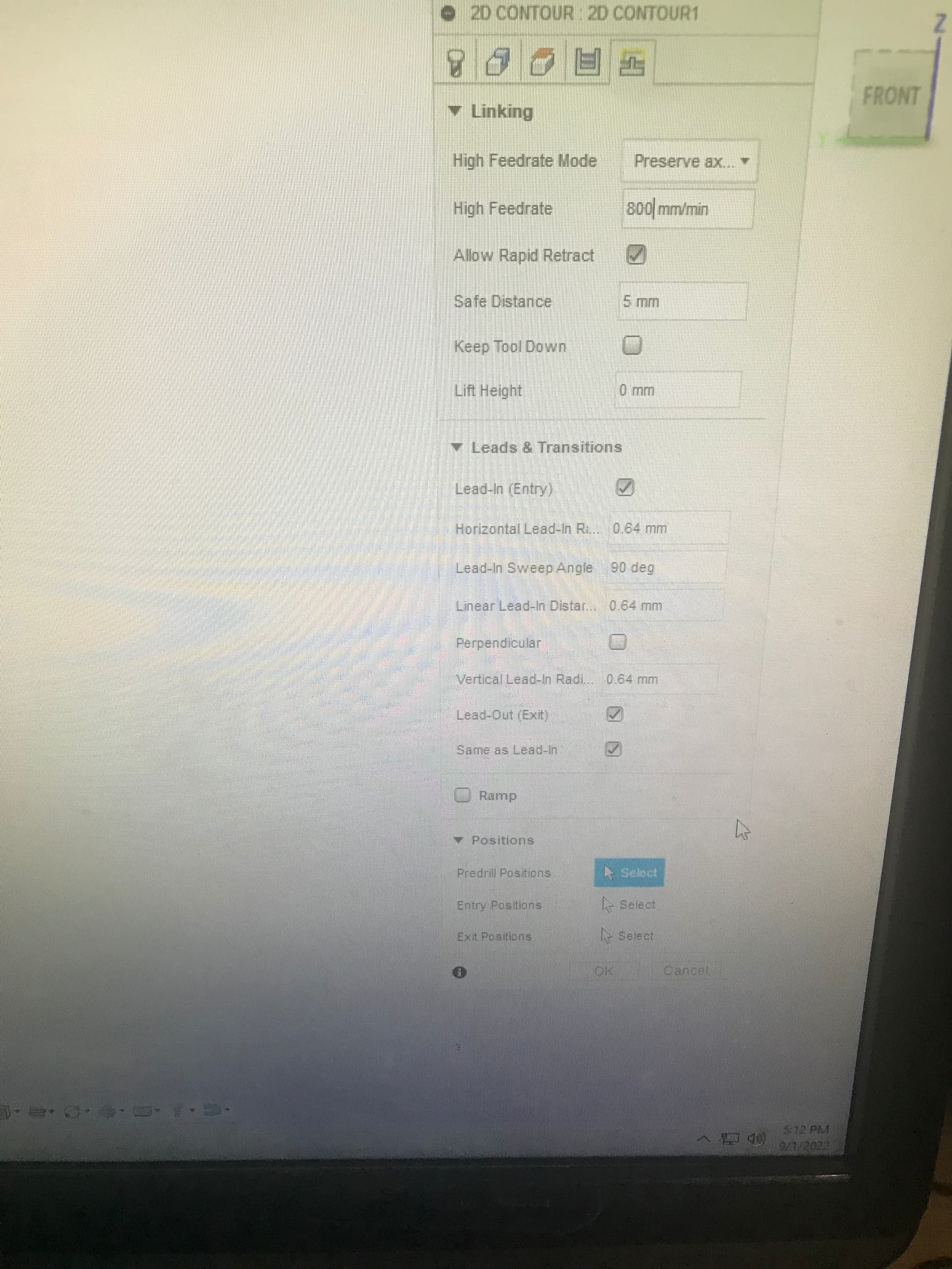

I also will be uploading my fusion 360 tool path screen shots, as that way in case im missing something or from user experience, pushing it to hard which is creating the uneven cuts or bad step overs.
2D adaptive pocket

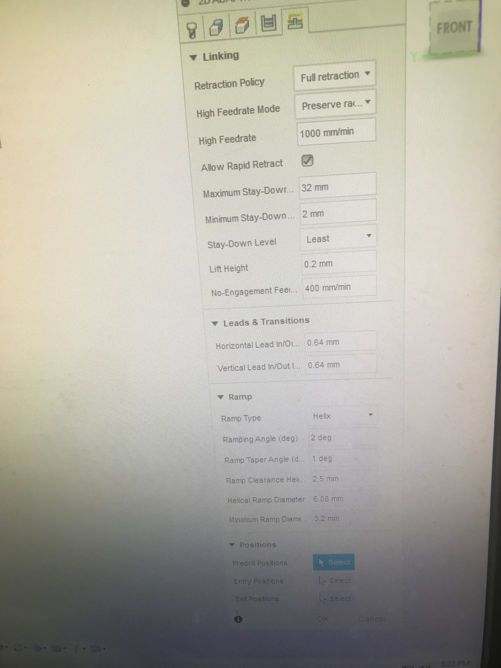

Here is the other tool path for the
2D contour:

Measured the first adaptive milling pocket and it showed about 16.9 mm deep when it finished. Which is a ways off from the modeled thickness of 19.07 mm plus an additional -8.0 mm below model bottom . At this point I’m clueless how to get the scale right for the z from zero to the doc to match.

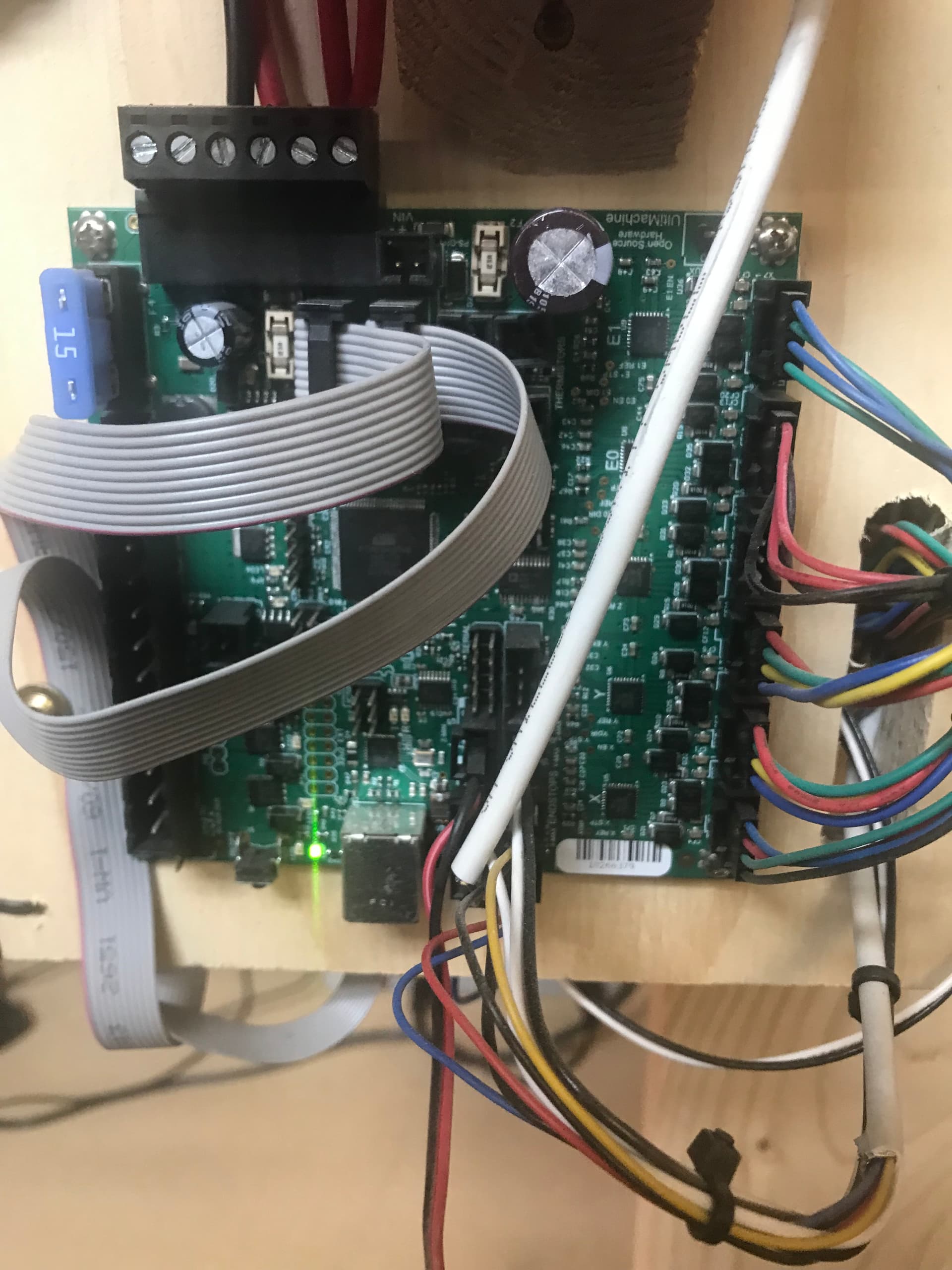

Step 0: Let me know what kind of control board you are using. From the display, it is likely either a Rambo or a Ramps. If it is a Ramps board, let me know what stepper drivers you are using, and what firmware you are using. If you are unsure of your board, post a picture.

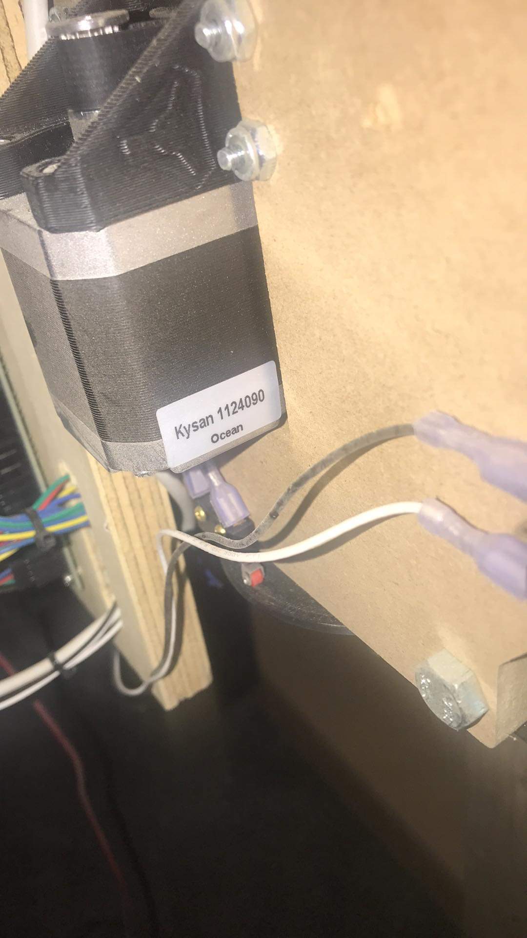

Step 1: Check the grub screws on the connector between the Z stepper and the lead screws. I don’t think you have an issue here, but it is a common source of Z issues, so a quick check is warranted.

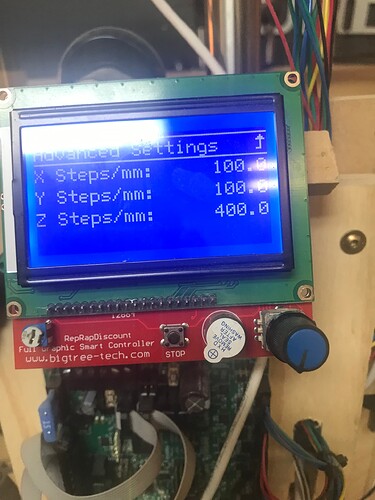

Step 2: Check the steps per mm for the Z axis. Put a piece of paper on your spoil board, lower your router electronically (not running) until it is touching the paper. You should be able to move the piece of paper, but it should drag on the bit. Record the Z height off your display. Next repeat the process using a piece of stock. Subtracting the first number from the second number will give you the amount Marlin thinks it moved up to the top of the stock. It would be close to the thickness of the stock measured by a ruler. If it is significantly different, let me know by how much.

Step 0 - The board The guy I got it from said it was a reprap rambo V1.4 board, added the picture of it and also added the picture of the stepper motor that is on the machine. The firm ware I dont know exactly what it has however, I know he said he built this couple years ago or year and a half. Dont know if that would matter what was available at that time. Im getting another computer this weekend to put in the garage but, as of right now I dont have a lap top to plug in usb and maybe see if i can locate what it has? If thats even possible.
Step 1 - I did check the screws however, didnt have the exact size of wrench, will bring my set home from work tomrrow to double check again. They both had four in each coupler, only thing that looked odd is they werent evenly ran in (screwed into bottom point). I dont know if that matters but, i can send a pic of that tomorrow and add to this post.

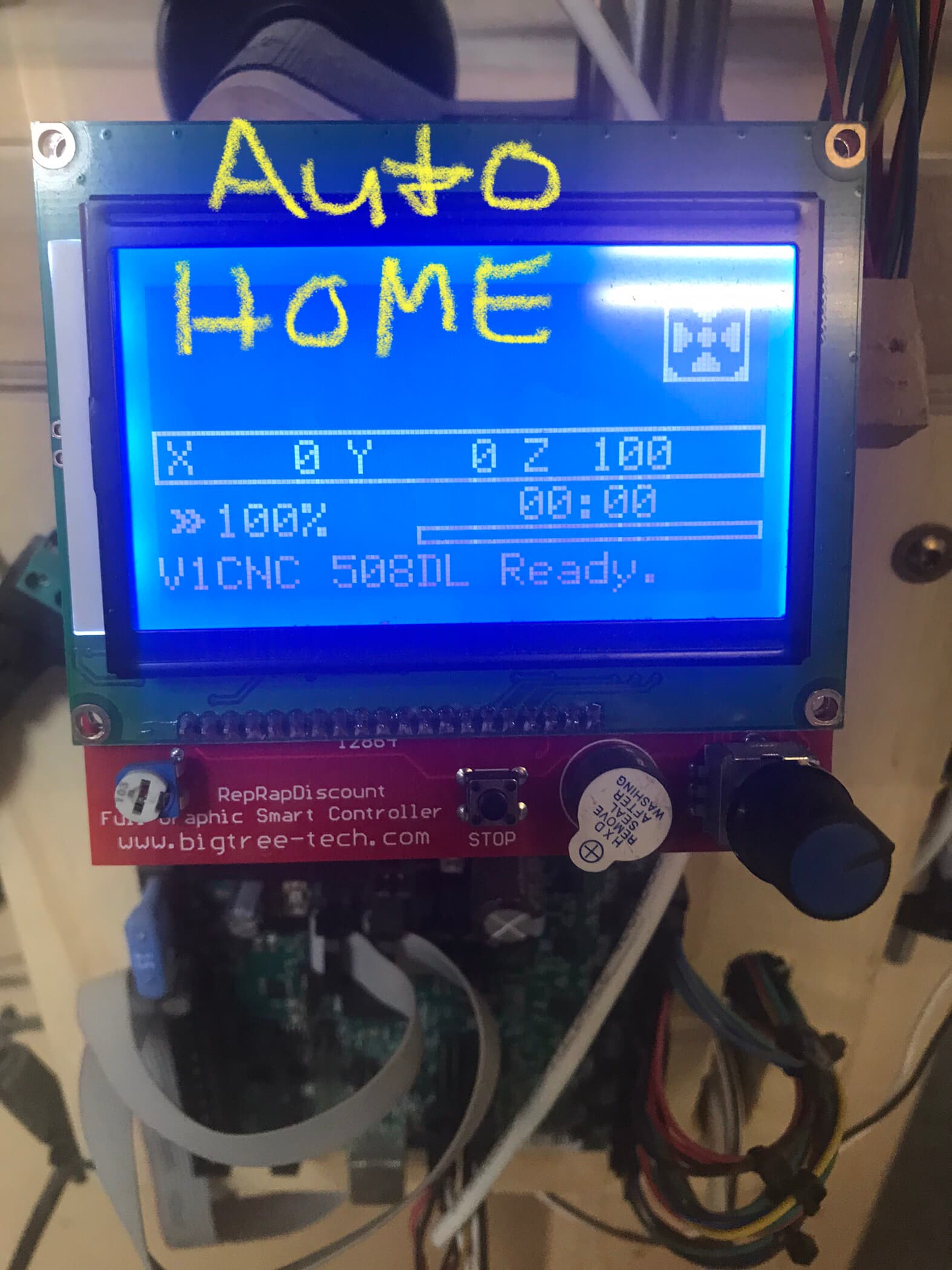

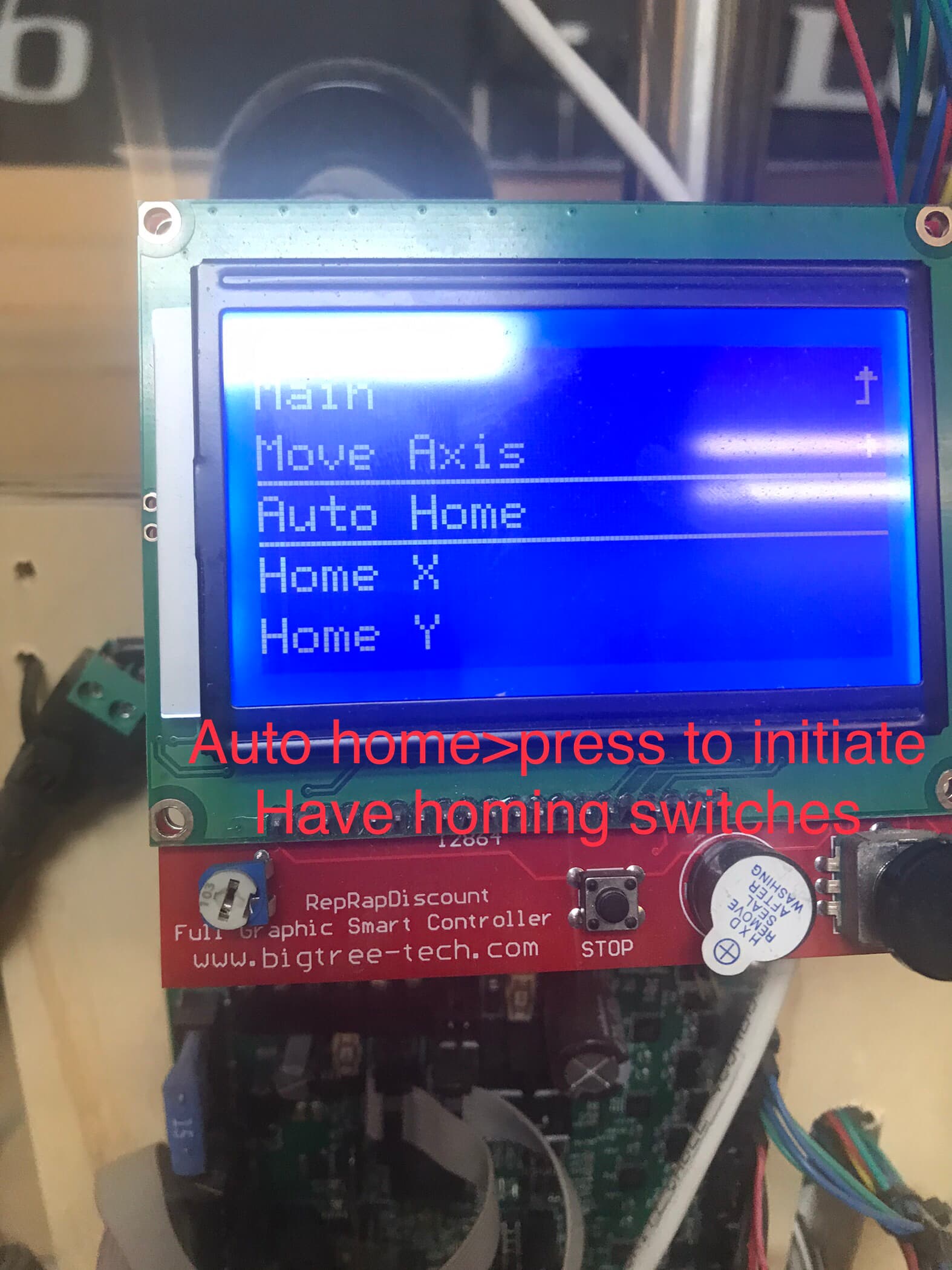

Step 2 - As listed in the photo below. I Use the auto home function when i power up the machine. Once i do that the machine will show zero for X and Y axis’s and Z will show positive +100 at the home position on the display. I jogged it down to the spoiler board, used paper and got that at +.042.5, then i Didnt zero anything i jogged it back up above the stock material. Repeated the process and got that at +.062.1. Which those to subtracted from one another comes out to about 19.6. With the calipers i measured down to the spoiler from top of stock i got 19.57mm and some change.
step 3 - As for homing the z axis with the respect of the stock. If i understand that right, from talking to Jeff and others. I more auto home the machine when i power it up. Handle the endmill or tool over to my starting location (origin) of my model. From there i bring the z down, use paper and touch off. Once ive got it where my start point is. I go to my sd card, run my Setzeros.gcode file that contains G92 X0 Y0. Once thats ran then i go directly to my Gcode i generated and turn on spindle and go. I have not used the touch off plate at all, it is still plugged into the board. Also all the post processor touch of plate thickness in such is still in the post processor.

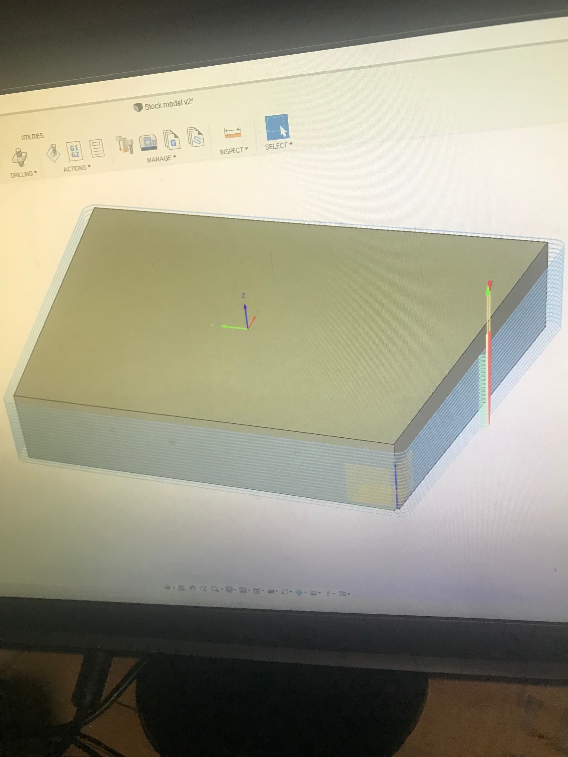

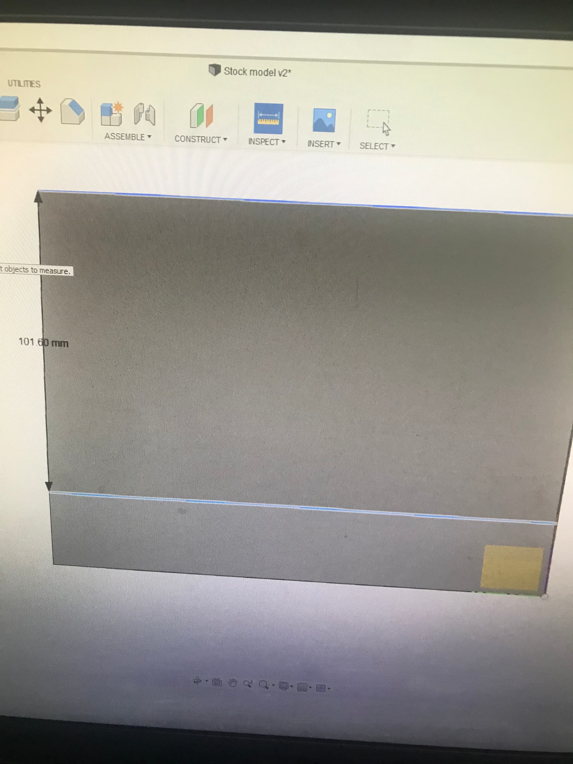

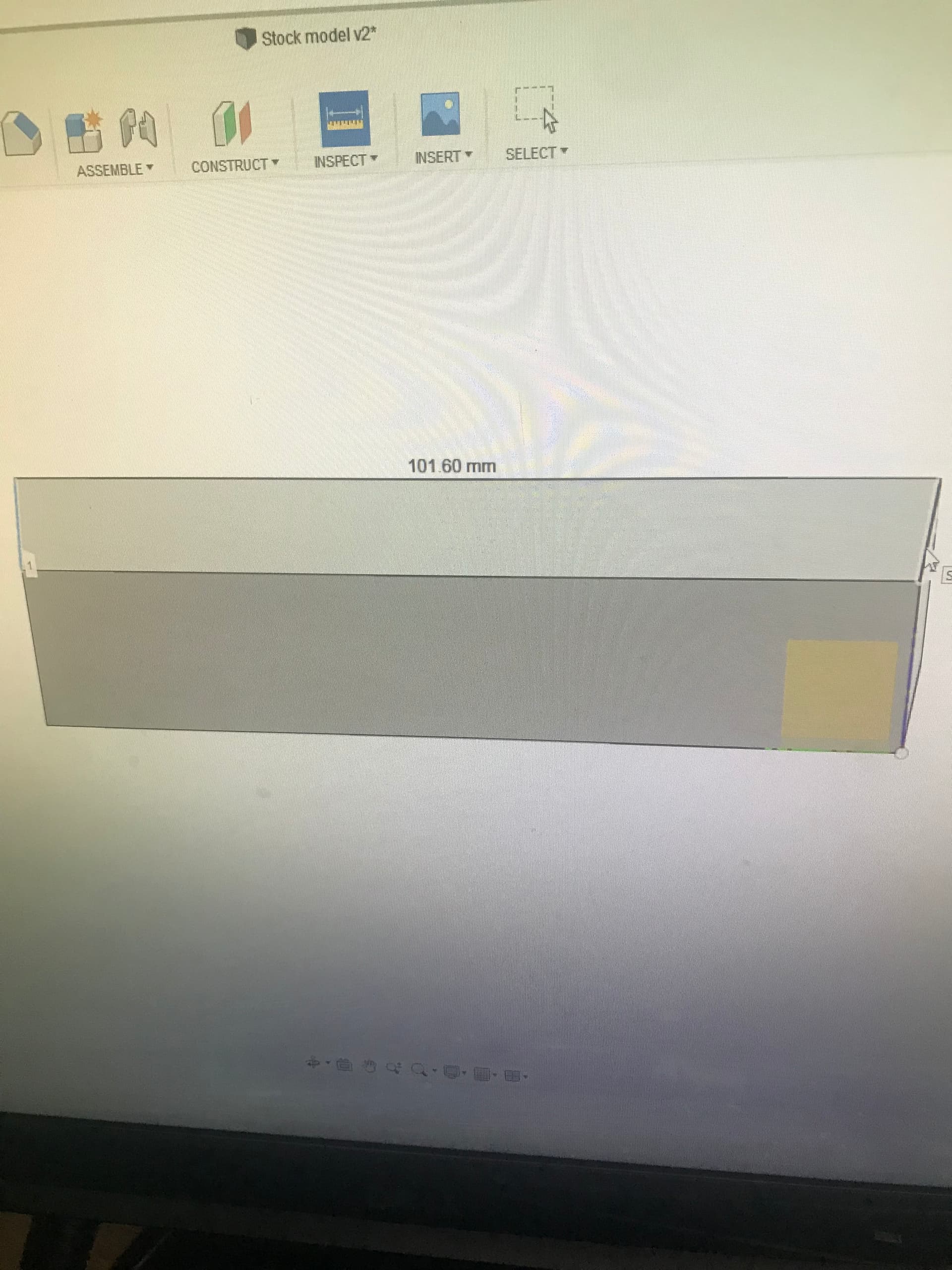

In the model I use Fixed size stock with 2 mm offset on all sides sides. No offsets for top or bottom. I did just notice, the Z height for the model was showing 20 mm??? Not sure why it defauled to that. Maybe thats part of the issue? Modeling it I Use model Top and model bottom (±8. mms) to mill through.

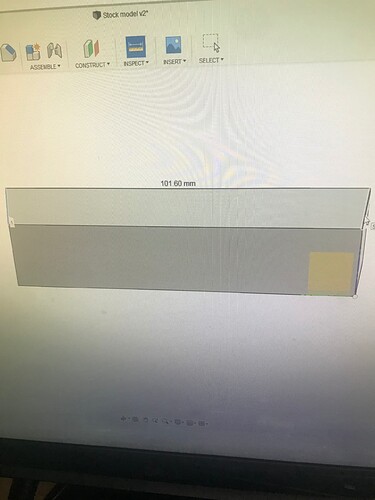

step 4 - The Stock model (square) 20. mm (extruded thickness) 101.6 * 101.6 (w * l)
Job set up - Model Origin/ Center for origin point.

These photos help. First, you have a Rambo board. The stepper drivers are part of the board, and the steps per mm are set in firmware. The values you display are correct for Z assuming you have the standard 4-start lead screw.
I forgot we are dealing with a Lowrider, which homes Z up. When I was referring to “homing” in my previous post, I’m trying to understand how you determine the top of the stock for your cut. On the MPCNC, this is done by homing the Z (or done manually). On the Lowrider, it is done by probing, or it is done manually. Note that the 100 for Z at the end of homing is not an accurate number. If you are not setting your bit to the top of your stock and then setting that as the home position with a G92, then this is likely the root of your issue.
As for the stock thickness test, I assume your stock is about 19.6mm thick, and therefore this test confirms that Z movement in the real world matches the movement on the display.

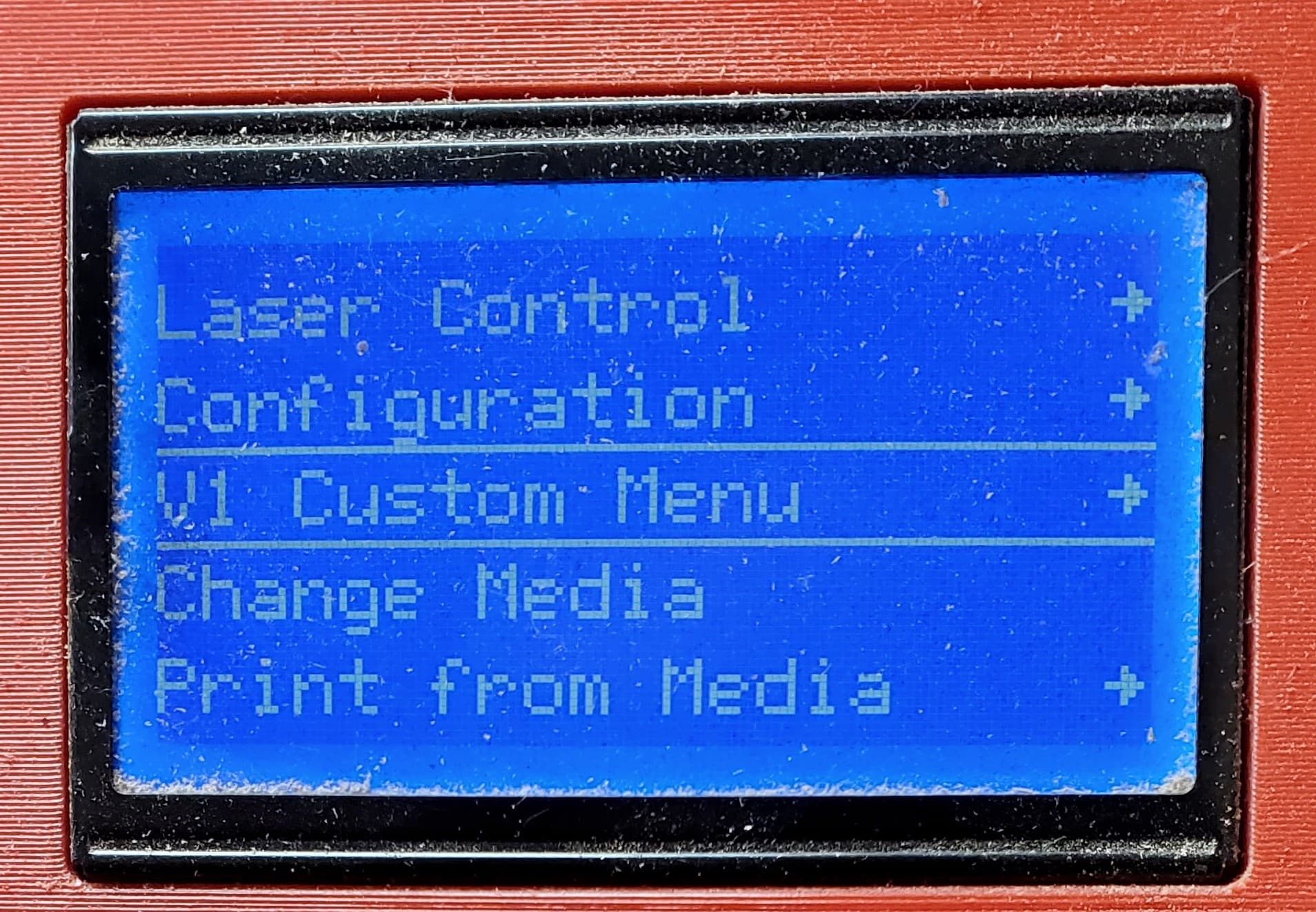

I’m going to jump ahead and give you a recipe for an attempt at a cut.
  1. In Fusion 360, in the Setup for your CAM, make absolutely sure you are picking one of the top stock points as the starting point for your job. Usually, I use the top of the stock and the bottom/left corner of my material, though sometimes I pick the top point in the center of my material. Either will work as long as you are picking your reference using a point that is on the top surface of your stock. This will be in the Setup for your CAM. And set up your job so that the height of the stock in Fusion 360 matches the height of your real stock.
  2. Home your machine.

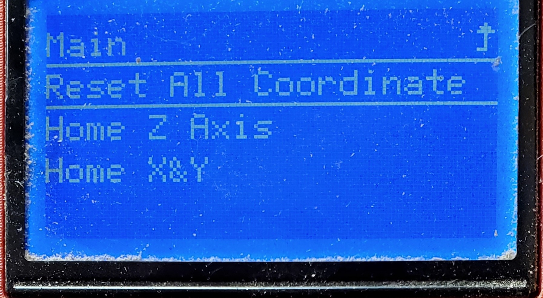

  3. Electronically (using the display) navigate your router until the bit is just touching the reference point you defined in your Fusion 360 CAM.
  4. From the V1 custom menu, select Reset All Coordinates.
Verify that the coordinates are now set to (0,0,0)

The Reset All Coordinates menu item executes the following code:
G92 X0 Y0 Z0
I’m not sure how you were executing your G92, but there was likely a problem if the menu is behaving differently. The g-code commands are case sensitive, so it needs to be an upper case ‘G’. In addition, you must have a newline at the end of each text line in the file. I found this out the hard way when Marlin was ignoring the last line in my files.

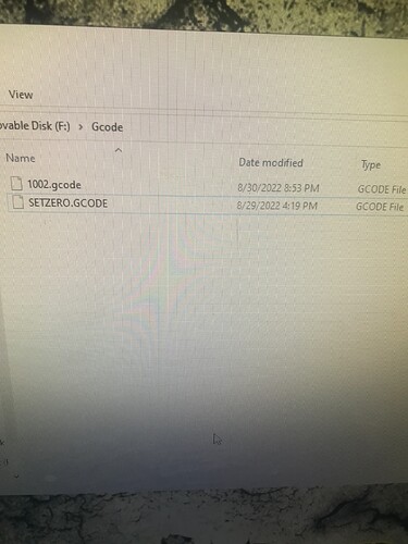

I’m hoping so, I created a file that had one line of code. Jeff told me to make and added that into my sub file. On my as card I’d have the G92 file, then my program. I’d execute as the following.
I’d go media > card> file - SETZEROS.Gcode G92 X0 Y0 Z0. I’d go to that file once I jogged to my spot. Then print from media. It would reset all my coordinates to zero. Then without moving the machine I would go to my as card memory again and click on the 1001.gcode (model g code file) and hot start print.
Here’s the pic of the sd card.
Don’t know if that works the same as the method you suggested or on the same principals. Just hoping the suggested way works for sure.
It should work exactly the same, but since it does not, we can check it out. Show me the contents of that file (open it with any text editor). And as I’ve said, you must have a new line after the last line of code in the file. The last time I checked (because I had a problem), without a new line, the last line in the file is ignored.

The min/max z at the start of your gcode isn’t setting limits, it’s reporting limits from the code, btw. Those are basically set in the heights tabs of the toolpaths (with modification by stock-to-leave).
At work that’s the reason sent the pic. I’ll upload it when home as a txt .file.
Only code in that setzero file is
G92 X0 Y0 Z0
Nothing else in there just that just as I typed it.
