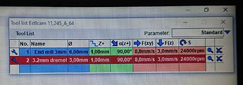

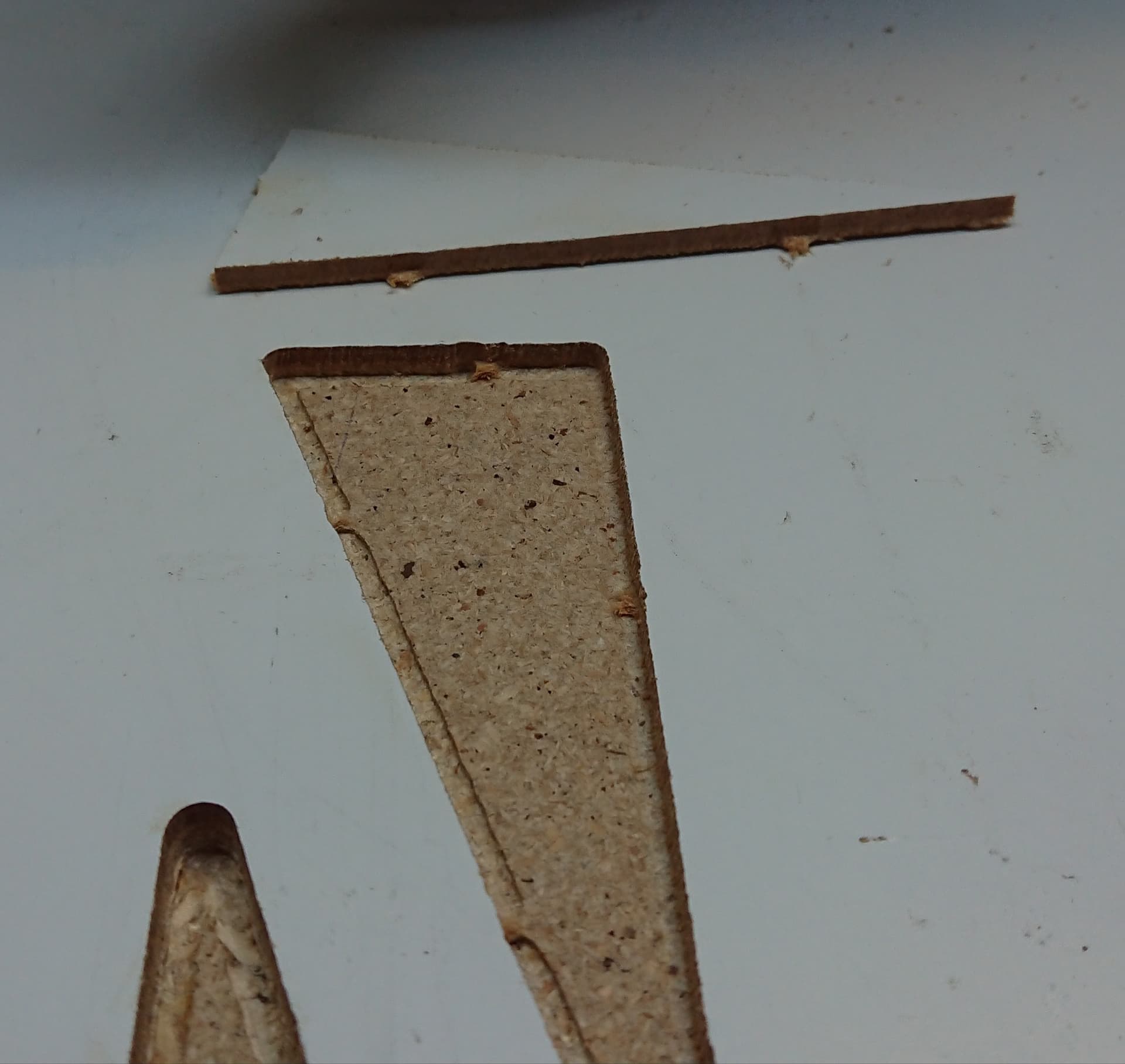

We are in a similar problem. I came here now to start a new post and write about the very same thing that happened to me today, with the same cut distance of approx. 7mm as I was trying to do a test cut, though I haven’t done your thorough investigation yet.

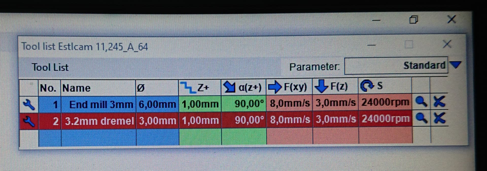

With a hard board of 3.5mm thickness I started with 3.6mm cutting depth for all cuts on the struts (the value you add before saving the gcode file in estlcam) with 1mm “step down” on my tool but once it started the drill just plunged all the way down directly and started working directly instead of taking 1mm passes.
I noticed that the added “holding tab height” was set to full but it didn’t start shaping them until it was almost at the bottom of the hard board.
I changed the cutting depth to 0.01mm for all cuts and once it started the machine just hovered of the material all the way, as expected. I changed it to 1.00mm and it went down, what I could see, around +/- 1mm. I changed it back to 3.6mm (material thickness at 3.5mm) and once again went into the board underneath.

You should make your own thread, this sounds for instance like steps calibrated wrong.

So how do I change my steps? Do I have to go into the Marlin code? But also good to add, when I did my first cut ever with my company’s logo on a board it worked perfectly. It went down by 1mm each pass, not like today’s mishap
If you try to move your router by hand in the mounts up and down, can you? Just to rule out that it didn’t actually move down that much in your mounts?
When I first installed mine, I was worried about over-tightening it, and had actually under-tightened it. I never ran it like that, but I was able to spin it and move it in the mount more than I thought I should and caught it right before I did my first cuts
First check whether that’s really the problem. Tell your CNC to move down 10mm and see whether it moved 10 or 20mm. :slightly_smiling_face:
