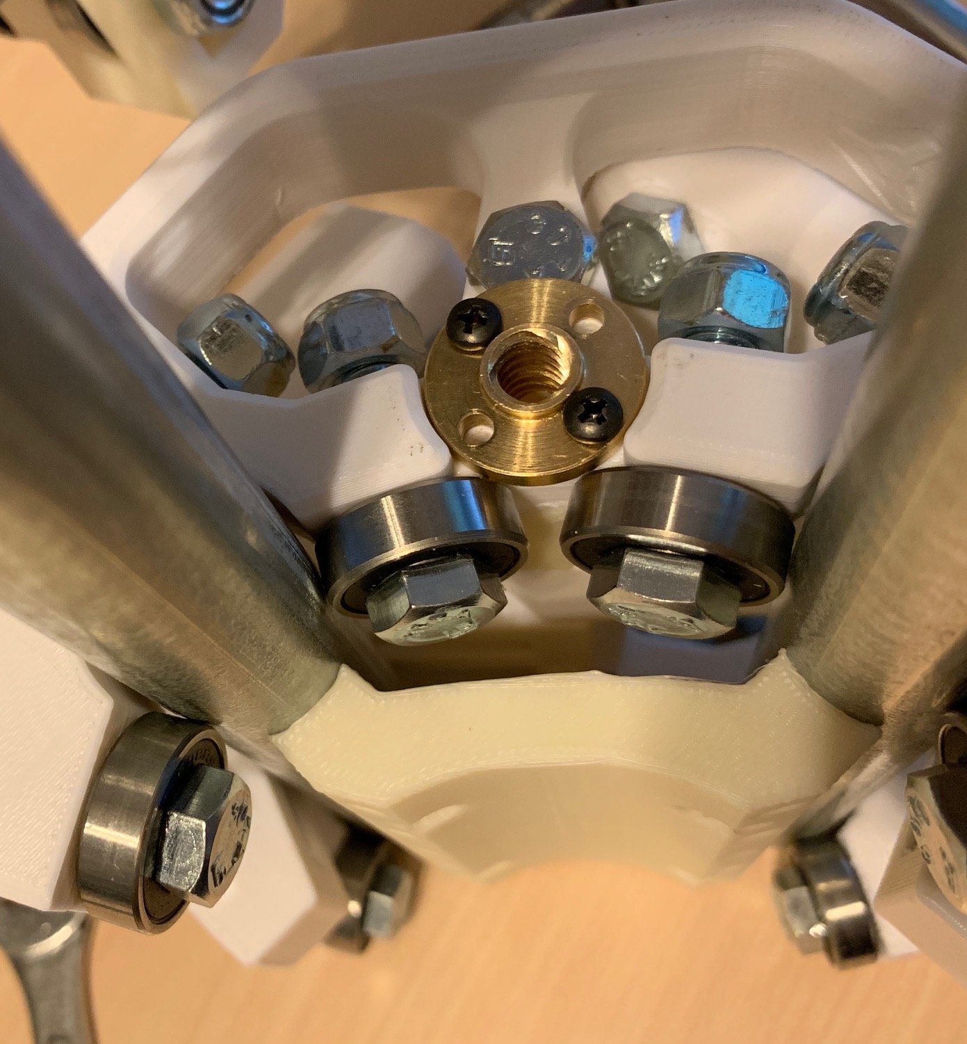

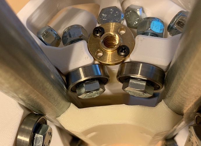

my z axis was super tight trying to install and I think I’ve found why but I’m not sure where I messed up. The gold bit that the lead screw goes in is touching the bearings on either side. The pic below is what it should look like, obviously there’s distance in between the gold piece and the bearings but mind doesn’t have that. I went back through the instructions and I was supposed to snug up those bearings which I did with a torque wrench. The only thing I can think of is did my printed piece come out too small?
Try adding a second M3 in there. You should be able to see the holes.
Yep did that, I meant to put it back before taking the pic. The holes line up perfectly but still get that touching.

Loosen the two 1.25" bolts insert the Z and snug them back up.

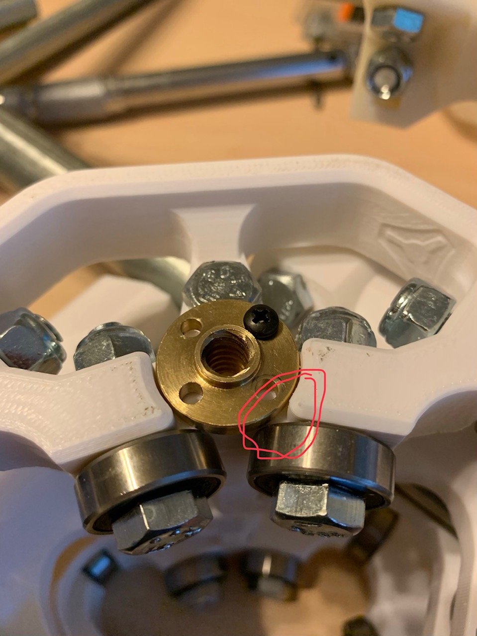

No worries, I know you’re swamped dealing with multiple issues. OK tried that, same result. See pic (loosened back those 1.25 before I took the pic). The bearings are touching the nut and making almost no contact with the z rails but I did loosen my tension bolt C’s (going back through instructions step by step to make sure I didn’t screw anything up) so that is probably why. I really want to know why mine is different but I had three thoughts on a work around.
One, put a washer between the two bearings to get them away from the nut. Works but does that mess anything up later and would I need to do that to all 4 of those bearings?
Two, grind the nut down slightly where the bearings are colliding.
Three, try to elevate the nut a little so it’s not colliding with bearings. Maybe a washer or custom round print that matches all the nut’s holes so I can put it underneath. Again, not sure if that’ll effect anything later on.

I am really not sure why this would happen. A spacer under the brass nut is probably the easiest.
