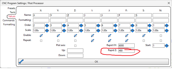

Jason these are all the estlcam v12 settings
I would set it up to use mm instead of inches as shown in the documentation. While technically, we can make that work with an additional change, I’d stick with the recommended settings at least for now. I’m in the US so I’m used to inches for most things, but for 3d printing and CNC, I stick with metric.
Ok so change everything to metric any idea why that gcode would be bad it was right from v1e site I want to cut it in foam I’ve been messing around with this thing I’m getting frustrated with it
Consider temporarily setting Rapid Z lower, try 480 instead 900 until you get good air/real cuts.

Either way, those are DXF files, not gcode files. Those files are fine but you need to do the CAM side to generate gcode. Your problem is not with the DXF files, it’s with the generated gcode.
Time to watch the estlcam videos again I must be doing something wrong thank you very much for your time and help greatly appreciate it
