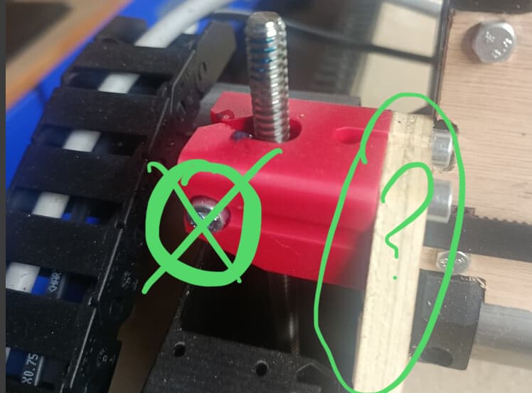

Hello everyone, I’m back again. My LR4 is finished building, but I’m having a problem with my Z-axis. The X and Y axes are fine.
I think my lead screws are faulty. I ordered 2mm T8 lead screws from AliExpress, but when I move the Z-axis by 1mm, it only moves 0.2mm.
So I tried changing the step size from 200 to 1000 steps, but I still can’t get it to work properly. Should I order new lead screws? Thank you for your help.

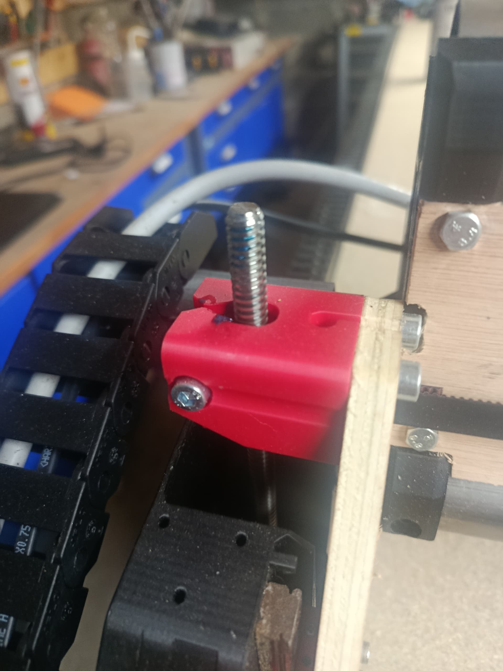

Remove the stub bolt for one thing.
Wooden XZ plates is not ideal either :eyes:

Okay, I’ll remove the screw. And I’ll test it again.

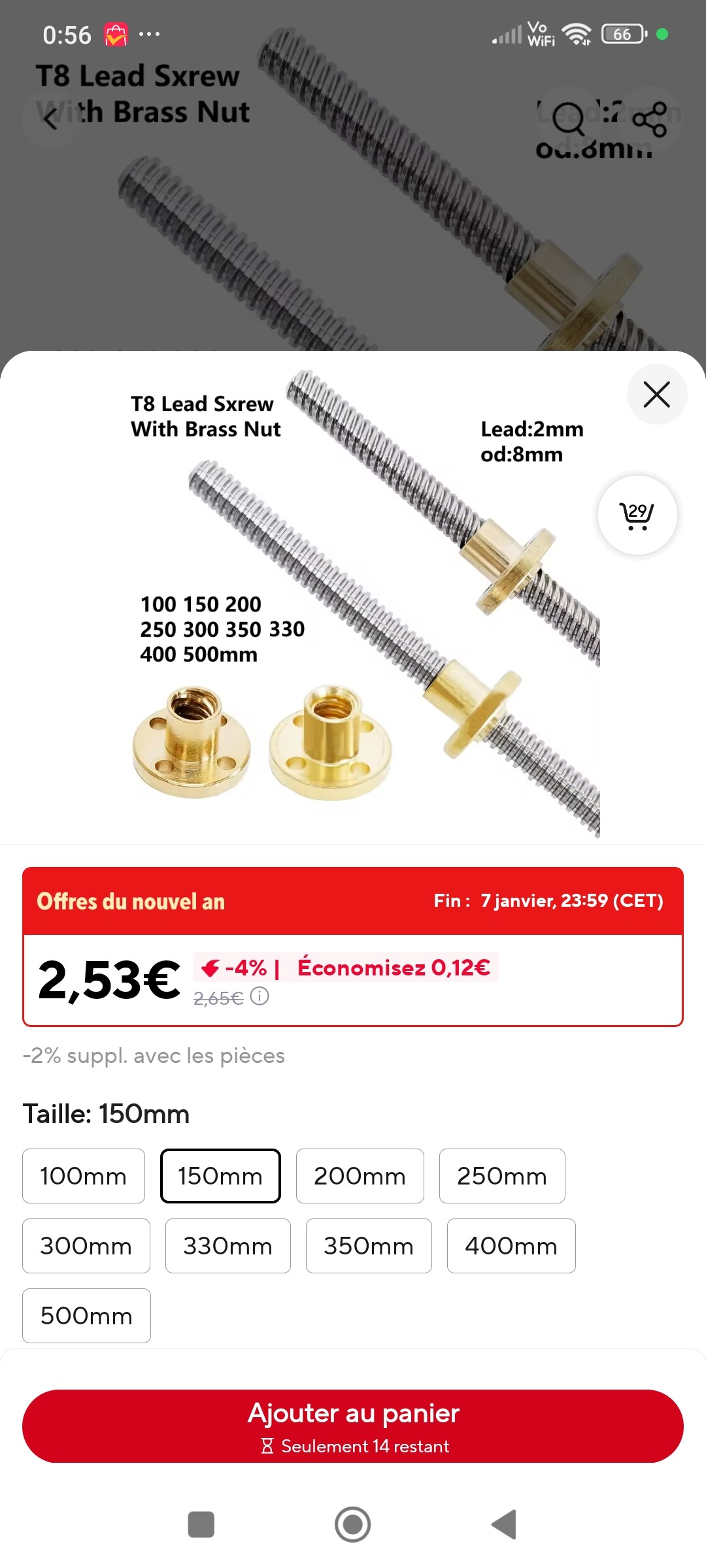

The pitch might be 2mm, but maybe it’s only a 1-start leadscrew, not a 4-start one? Can you check how many “starting points” it has at the top?

Yes its a only 1 start
Can I use this one or should I order a 4-starter?
Thanks you
Order 4 start. The operating speed will be faster. Assembly and maintenance will be easier.
I say this as someone who briefly tried assembling with 2 start, but abandoned that out of frustration and went back to recommended stock 4 start lead screws.

I didn’t know there were multiple versions of the lead screw.
My problem is how to be sure I’ll receive a lead screw with 4 starters. Can someone give me an AliExpress link?

@Dreyfus Should this screw always be removed in any case on both sides?
Kind of, yeah. Or only set very loosely. Gravity will keep the beam down. :slight_smile:
Ok I found
