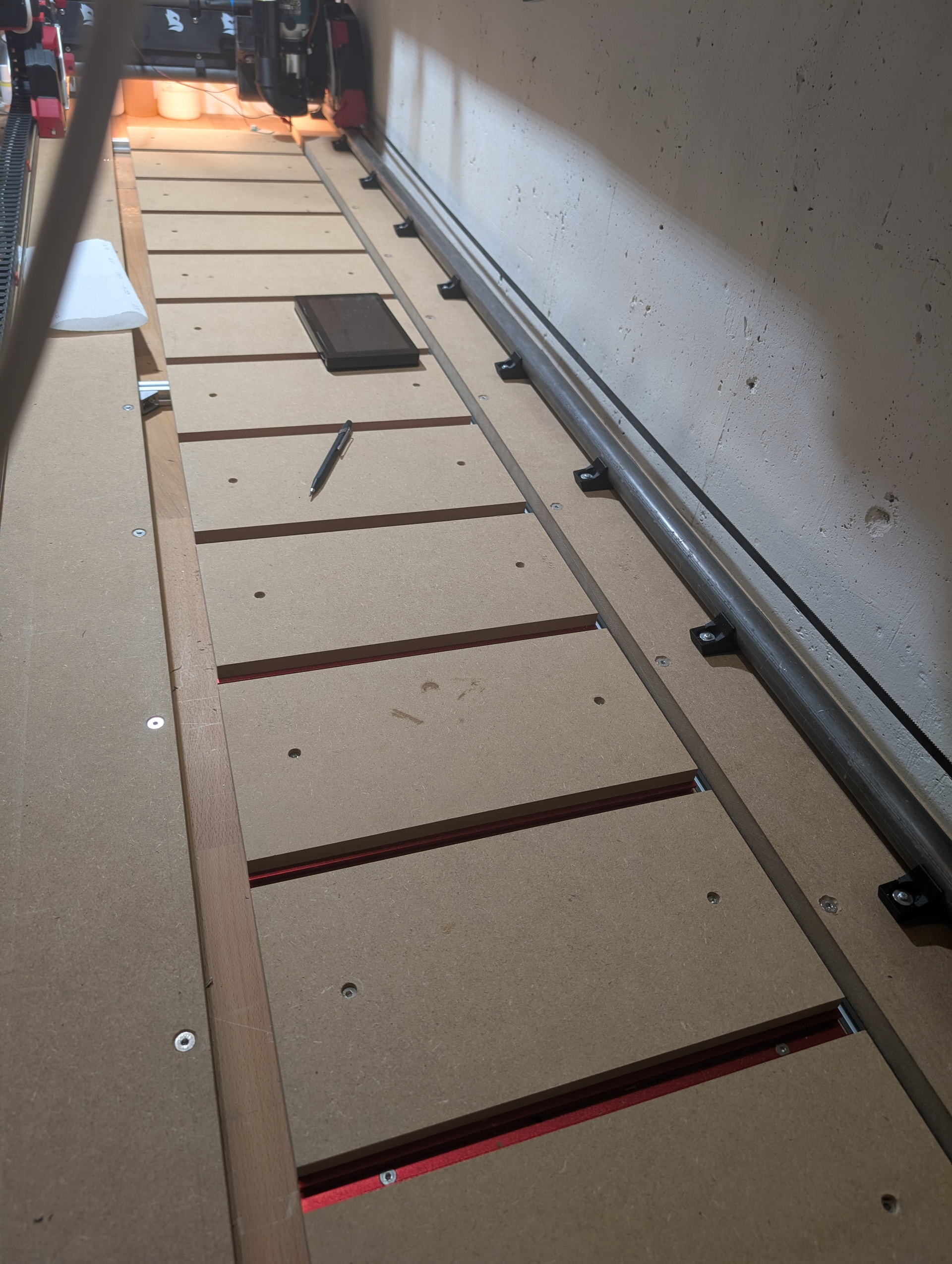

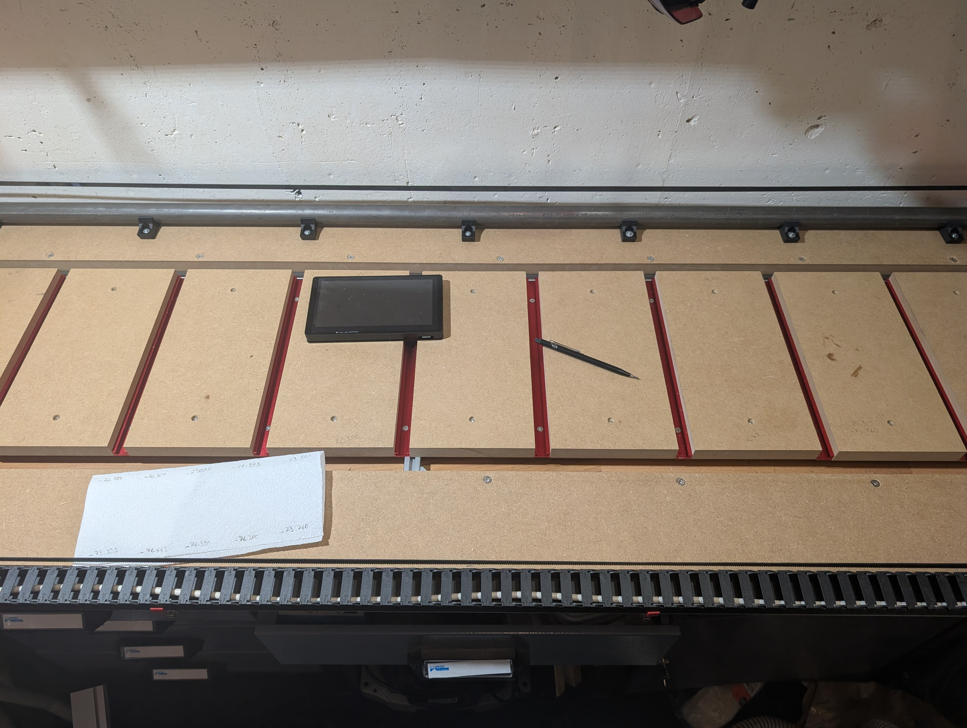

Next week turned in a few months :slight_smile: I fully rebuilt he table as you can see from these pictures:
I probed at a regular distance along the Y axis both on the x min and x max. The highest probing gives -73.740 and is located on 0,0 the lowest probing is located in the middle and on X max resulting in -75.070. I therefore have a difference of 1.33 mm which when cutting the plastic sheet which is 1.2 mm thick is of course an issue. Overall x min side is higher than x max side. On the y axis it starts high, goes down and then back up (on both X min and x mix sides).

So, 0,0 is a high point and middle Y at x max is the low point. But your Z level at Y0 is good.
Maybe you need to shim your table under the low point?
My table is built on 6 2000 mm 2020 profiles. 2 of them under the x min, 2 under the x max and 2 under the cutting area. They are connected between them by smaller 2020 profiles with L brackets. The MDF if attached to the 2020 profile with tee nuts. The whole structure is sitting on a bench.
Maybe the bench is not 100% flat and the 2000 mm 2020 profiles are flexing in the middle. I could try to add 3 2020 profile along the width one in the middle and two towards the extremities.
Well at that point I would probably just surface it and call it a day.
I ended up adding 7 extra 2020 across the x axis along the y axis. It solved the issue. I measured every 300 mm along the y axis on both x min and x max. Now the max difference between two points on the same y is 0.3 mm and 0.5 the absolute difference. I can probably adjust 0.1 or 0.2 via the software and live with the rest.
