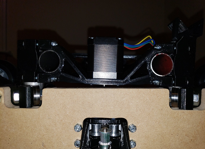

Ok guys, I’m at a loss, again… l0l. Anyway, my Z-axis isn’t behaving properly. I first noticed it in my latest Crown test (after learning more about G Code). The “left” side of the crown was lighter then the “right”.[attachment file=“80448”]

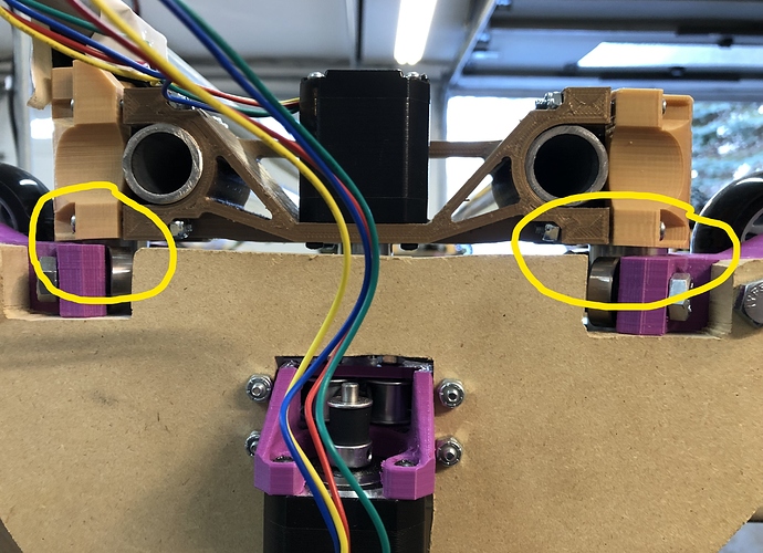

I then did some more testing to see if I could figure out where things were going wrong. For reference, here is a pic of my LR [attachment file=“80449”]
My first test was to lower Z to Zero and see if I could see anything. I noticed that on both side of the machine, the Y Negative side of the gantry is resting on the wheel support but the Y Positive side is up about 2mm. This is a pic of what I am talking about. [attachment file=“80450”]
I then did some measurements to see if what I could find out. I left the Z Axis at Zero, and moved the X Axis all the way to the “near” side (LCD side) and measured the height of the X Plate to my table. It was 21.24mm. I then moved the X Axis all the way across the table and measured again, this time it was 19.25mm. Essentially, 2mm across the width of the table which is 1290mm (4’ usable surface). I know that’s not a lot of error, especially for a 3D printed machine but I’m wondering if that error will start to show up when I’m routing out 3/4" thick plywood. I’m thinking it will show up as a tilt to the routing.
Some additional info. When I raise my Z-axis and then power off the machine, the LCD side of the machine won’t go down on its own, but the far side does. To get the LCD side to go down, I have to “pull” the bottom of the Y Plate out a bit while leaving the top in position (basically rotating it around its onw Y Axis. If I do this, then the gantry will drop. I need to pull it out - 2mm. (that number keeps showing up). This side of the gantry is also easy to raise up without the power on, I can just pull on the XZ Main and the gantry raises up. Strangely, the other side of the gantry goes down just fine when I power it off, but I can’t pull on the XZ Main to get it to go up - that just stretches out the coupler. In order to manually raise this side, I have to turn the leadscrew (which turns easily by hand).

Both of those pieces should be sitting perfectly flat on the pieces below, not just touching at an angle.
1-There is a notch inside the XZ part, make sure your Z rails are below in not on it.
2-Lossen the 4 clamping screws on each part. If you tighten them incorrectly you can angle the Z rails incorrectly. Are the tops and bottoms of your Z rails equal distances apart?
3-Your coupler looks like it might not be long in this world. Make sure your leadscrew and stepper shafts are touching.
The long pipes might also be tightened in place, but with tension and not flat. I’m not the expert in this, but I think Ryan has said those pipes should rotate by hand with a moderate grip. If they are tighter than that, one kight be tightened down, and twisted, which is lifting the other end of the part.

Well, I figured out the 2mm difference across the width of my table, my Unistrut rail on the far side of the table is 2mm lower then the one on the near side. I put a 2mm spacer under the wheels to temporarily block it up and not my measurement across the width of the table is accurate to 1/100th of a mm! I’d say that’s pretty damn good!
Edit: after running it up and down a bit and testing at different Z heights (Zero, +30 and +50) it looks like I’m off about 0.6mm across the width of the table now. Good enough I think until I build my own MP3DP and reprint the parts myself.
Now I just have to get a 2mm spacer to put between the XZ Main and the Y Plate on the far side so at least my Z zero will be closer.

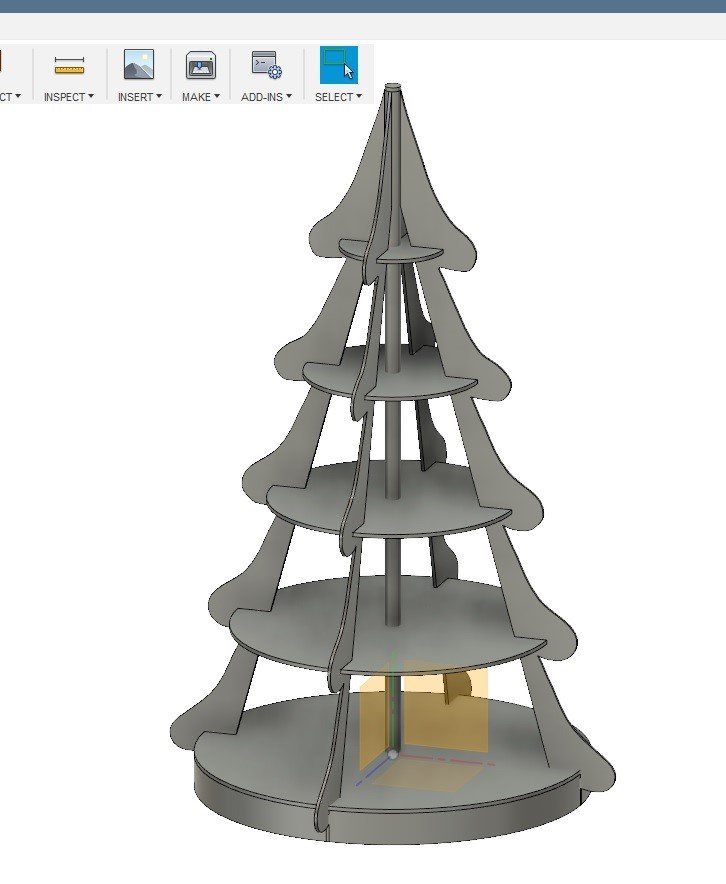

Jeff, I think I’ve got it close enough now. I’m making her a “Christmas Tree” display stand to hold her Department 56 Dickens Village. She has over 50 houses for it and really no good place to display them in her new house (she just moved in). The tree I am making is about 7’ tall and 48" wide at the base. I’m routing out the “limbs” and the circular platforms. Here is what I have done in Fusion 360.[attachment file=“Tree (2).jpg”]
Wow. That is a nice big project. Luckily, it’s all through cuts so the Z shouldn’t be a problem. I know you’re short on time, but take it slow. I would definitely cut out a test piece and check the dimensions on it. I would also try to mimic the joints in a small test piece with the same material, to make sure you’re dialed in. Then cut it one piece at a time, making sure to test and measure everything along the way. Remember that sand paper and glue and paint can forgive a lot of problems and don’t point out your mistakes, you’re the only one that will notice them. And please take a lot of photos :).

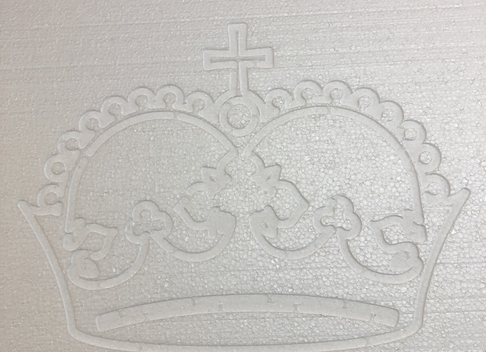

This makes me ?. First test in styrofoam. I did the Crown test but forgot to tell it how thick my material was. Anyway, it seemed to work like a champ! I even had it doing tabs and I used G92 to set X0 Y0 Z0 to my manually centered starting point. I think I’m actually figuring this all out now!! (Thanks to the help on this forum)
Yes, it looks pretty good. Makes me smile as much as it does you I am sure about that!
