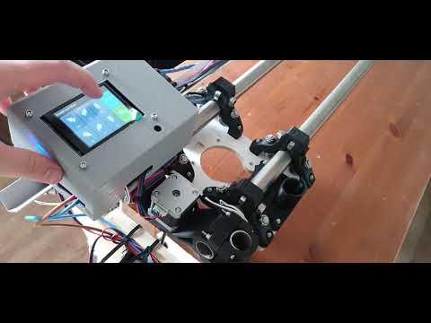

WHen i move the z axis up 10mm is wizzes moves a little and stops. it works fine at 1mm movements.
i have included a youtube link for a video of it in action.
im using skr 1.3 2209 drivers.

Try lowering your feed rate
how do i do that? does it have to be done in the firmware?
My guess is that your Z Max Speed is too high. It doesn’t get to full speed on short moves, but starts to miss steps on longer moves. Acceleration may also benefit from tuning.
Before changing firmware or configuration, I’d do a series of gcode G01 command tests moving Z up and down the max distance you ever expect them to move (50+ mm?) to ensure you get to full speed depending on your acceleration setting. Then run the test at various speeds to see where you are not in danger of missing steps. e.g.:
G01 Z0 F60
G01 Z50 F60
The number after Z is the desired Z end position (assuming you’re using absolute coordinates), the number after the F (feedrate) is the desired speed in mm/minute. Be sure to use a G01 (or G1) for this test. G00 (or G0) is for “rapid” moves and doesn’t officially support the F parameter.
Repeat the test, adjusting the feedrate to where you go as fast as possible without losing steps, then reduce by 5-10% for your permanent setting.
You can set the max speed in the firmware, or store it in the eeprom.
thanks for that, when looking at the eeprom setting in repetier i noticed the steps being well out so after setting them up the z moves lovely now
