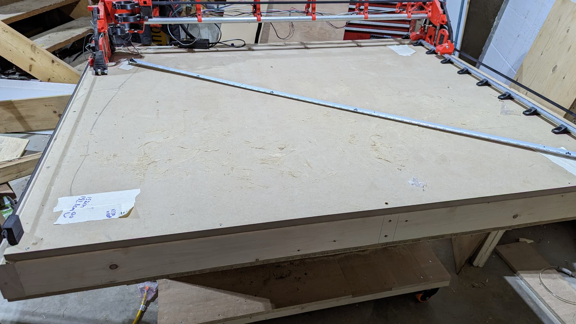

I am proud to announce that I did a manual squaring test and I am out approximately 0.1cm across a 48"x39" table. Thank you SO much for all the help! I am hopefully getting the new lead screws tomorrow and I will be installing them as soon as I get them.
