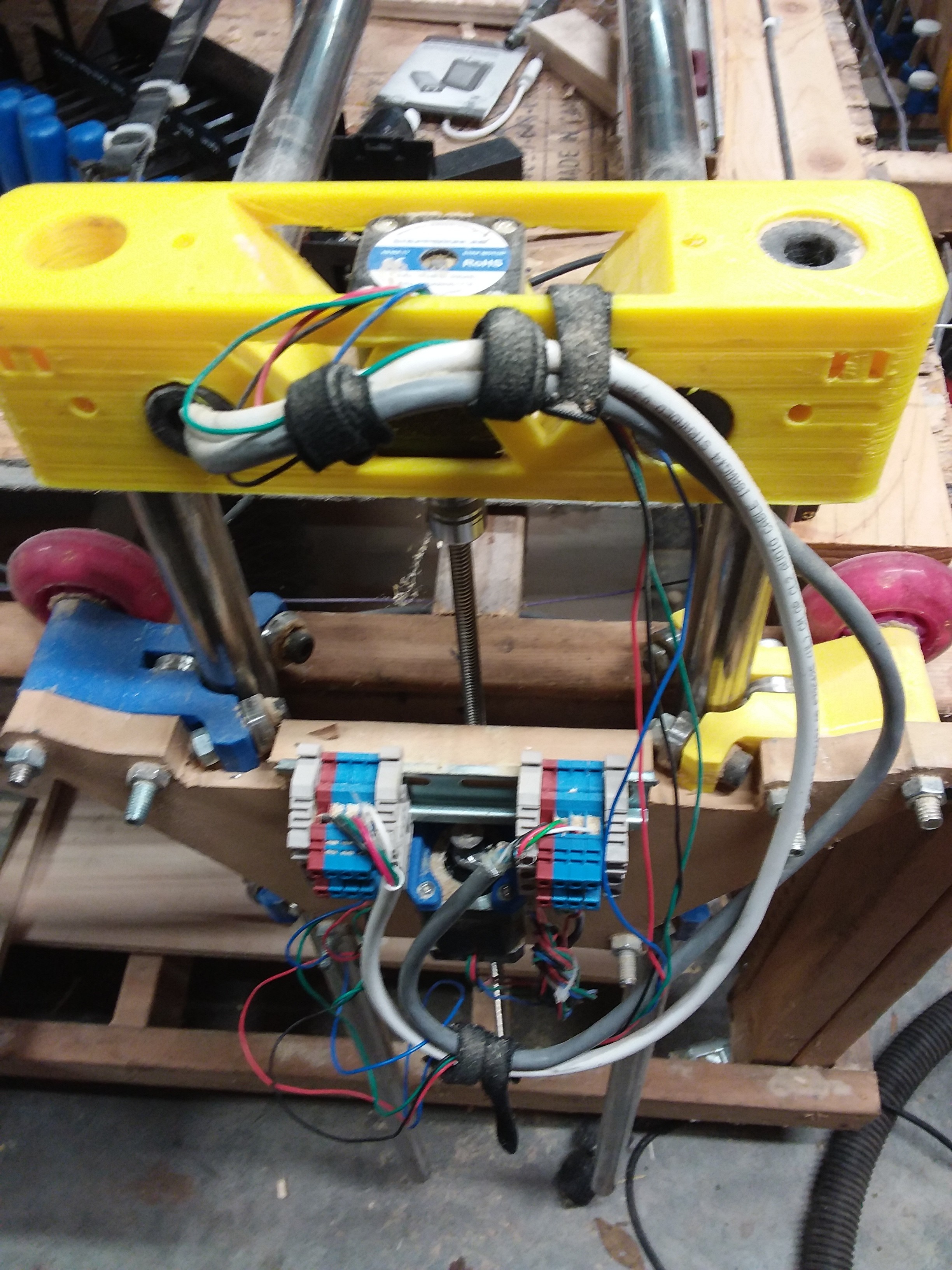

I’ve been holding off on posting this until I had a chance to clean up my shop. It was pretty bad. I am pleased to share that my LR2 is 90% complete, and fully functional. I call it the mostly-free CNC because I’ve been pretty good at scrounging parts from all over the place.
The reason I built this is that when I said I wanted a farm sign my wife got quotes in the $700-2000 range, and I figured I could design and build a CNC for $500. Then I found the LR2, and I skipped the design part.

- Workpiece size: 4 ft x 8 ft x 50cm
- Table: 2x4 softwood ladder construction
- Top/spoilboard: None, I’ve just been screwing into the frame
- XZ plates: Crudely sawn 12mm MDF
- Router plate: Crudely sawn 6mm plexiglas; design modified to accommodate my router and vacuum
- End-stops: One at each end of x-axis at the moment.
- Controller: Arduino+RAMPS with DRV8825 (?) drivers
- Wiring: X and Z are in series. All connections are broken out to terminal blocks for ease of assembly and upkeep.
- Display: None at the moment. I have one of the common ones but need the PCB to convert the two 2x5 connectors to the RAMPS board.
- Interface: OctoPrint running on FreeBSD on a nano-size x64 PC
- CAD tool of choice: Fusion 360 for personal; Solidworks for work
- CAM tool of choice: Fusion 360 for most stuff. Easel is OK for quick and dirty jobs.

- I tried mounting the controls to the gantry like most people, but I just found it awkward.
Things that enrage me
- When the power is cut, one side of my z-axis falls, making it a pain in the ass to reset. Thankfully my tubes haven’t bent yet. I think I need to add some friction to the one side to avoid this (in addition to having already disabled the
M84timeout. - Until you clean up your cabling, it is really easy to CNC cut your y-axis stepper cable.
