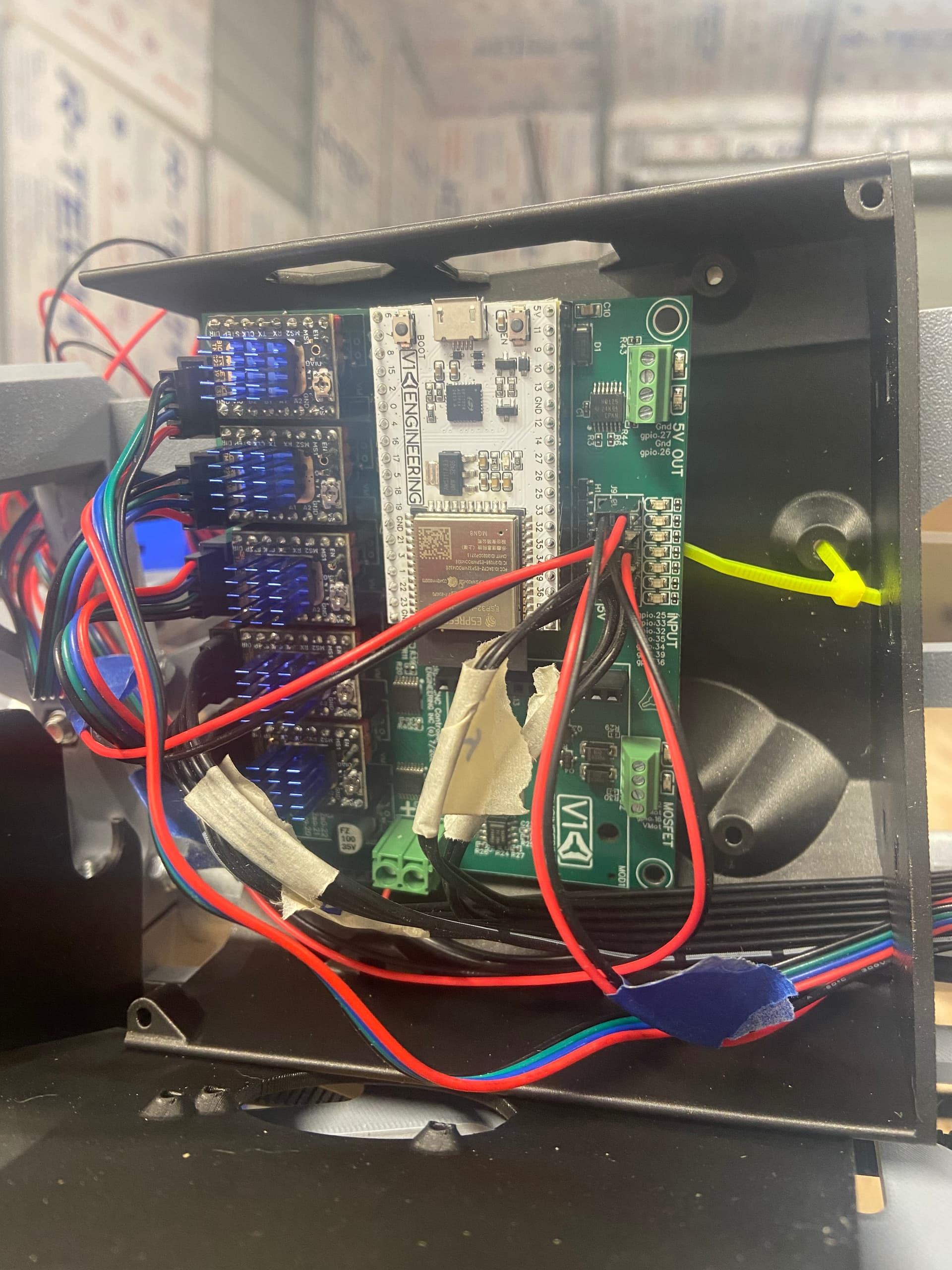

What board are you using and exactly what ports are things plugged into? Posting a picture of the board (and connections) may be helpful for those in the know.
edit: Ah, subject line. Jackpot.
Jackpot V 1.2.1

Did you download this config and upload it to the Jackpot?
Okay, I uploaded the config file you linked and still have the same issue. When everything is plugged in, the YMax motor will jog, but the YMin does not. Switching the plug for YMin to the X plug on the board and rebooting allows me to jog the YMin motor.

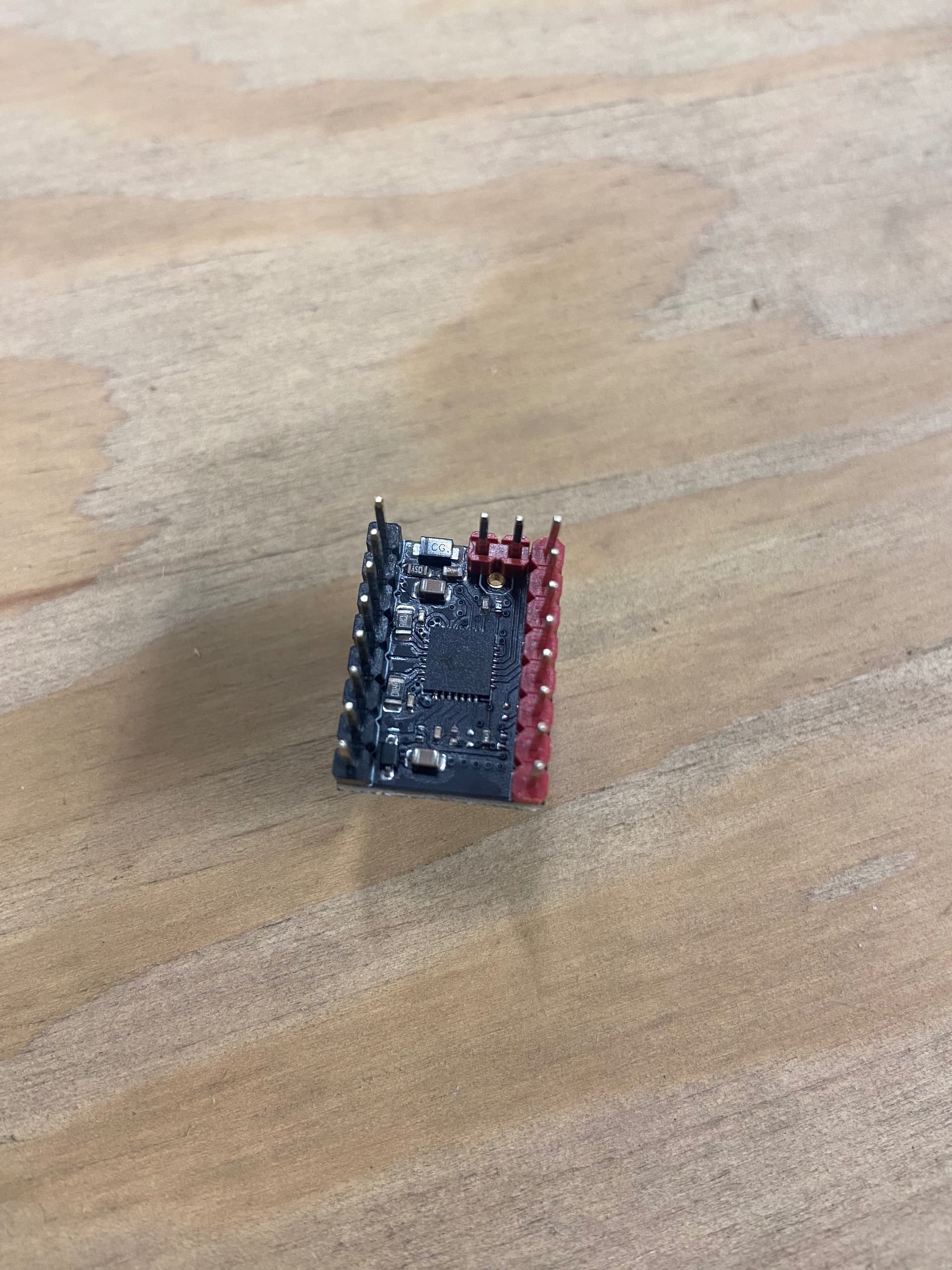

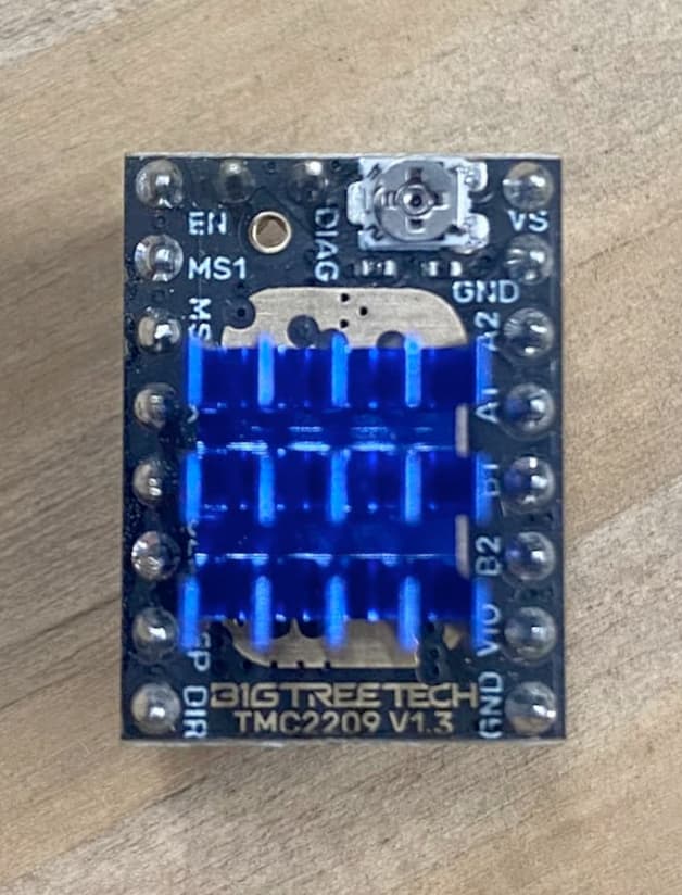

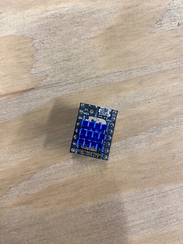

You could post high-resolution front and back side images of the driver that appears to be misbehaving.
I’d replace the driver, pending anything we might see wrong with those photos.
I’d also check the Ymin wiring for intermittent faults (opens or shorts) to ensure that you don’t blow another driver.
It’s hard to see the solder in that top side image, but as far as what can be seen there’s nothing obviously wrong with the driver visually.
I would double check for intermittent wiring as @dos mentioned above- but would get a replacement driver to test with.
