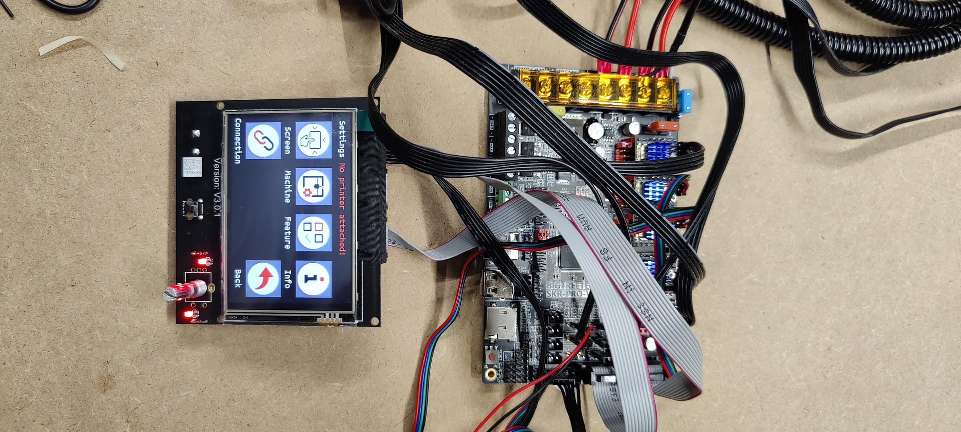

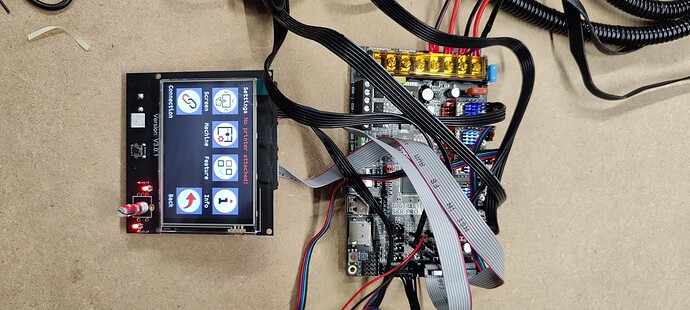

Hey There,
Well I finally finished putting together my Low Rider 3, but powering it on only gives me a “no printer attached” on the top of the TFT screen. I could select various items on the TFT but my steppers weren’t motivated. Marlin won’t load…just a black screen. I double checked my wiring, as well as the baud rate…all look 5x5.
However I did notice that on the SKR Pro1.2 when power is applied with the provided power supply the 3.3V isn’t lit but the other two (5V and 12V) are.
Is my board toast? What are the chances of getting a replacement board? The only other thing I can think of is that the firmware is incorrect. I’m pretty sure I chose to have the lowrider firmware preinstalled when I originally ordered the kit but I don’t see what was flashed to the board…only that it was flashed. I attempted to reflash it but it never took…back to my power issue. What are my options?
thanks for the space,
Jeff

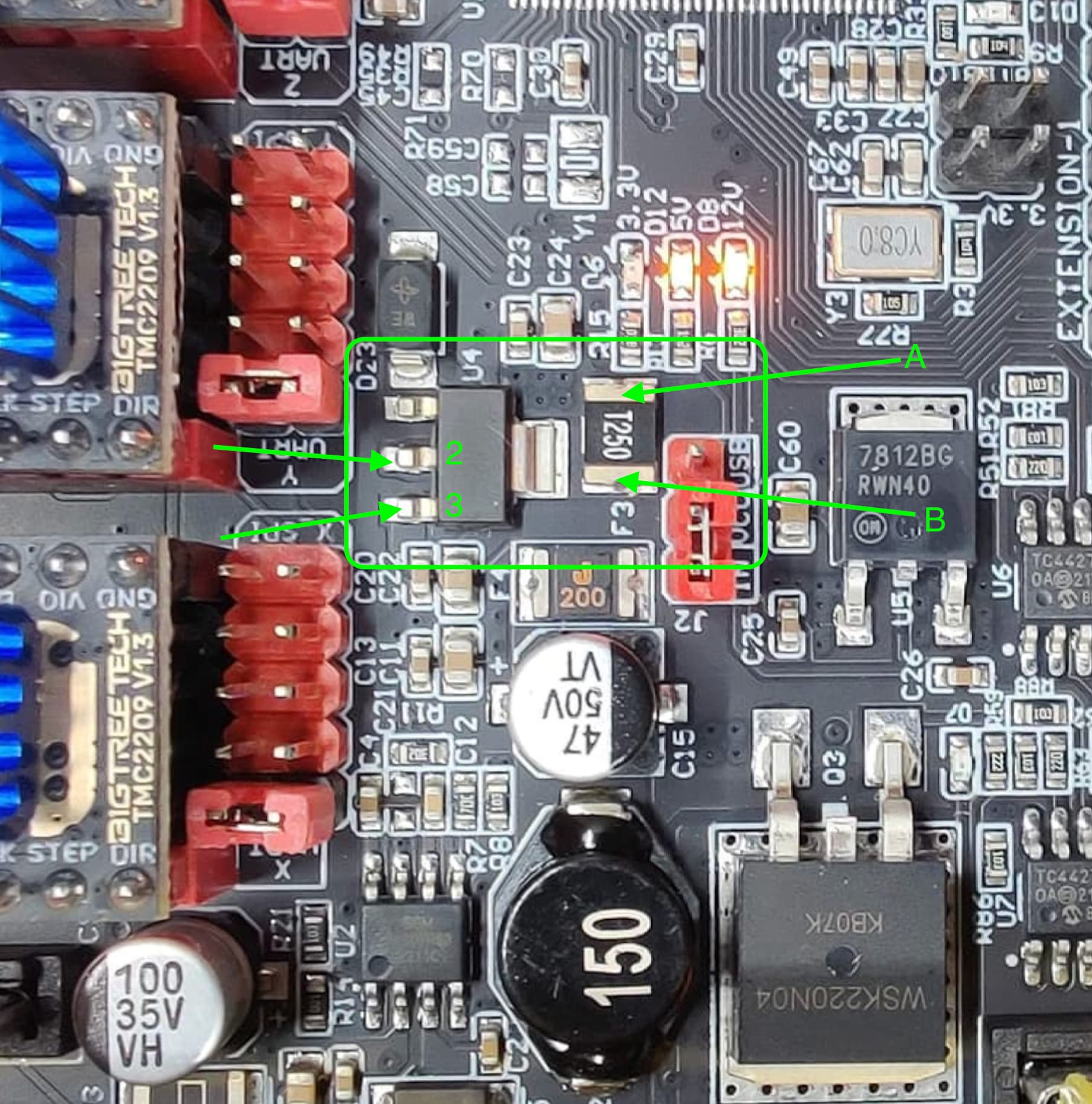

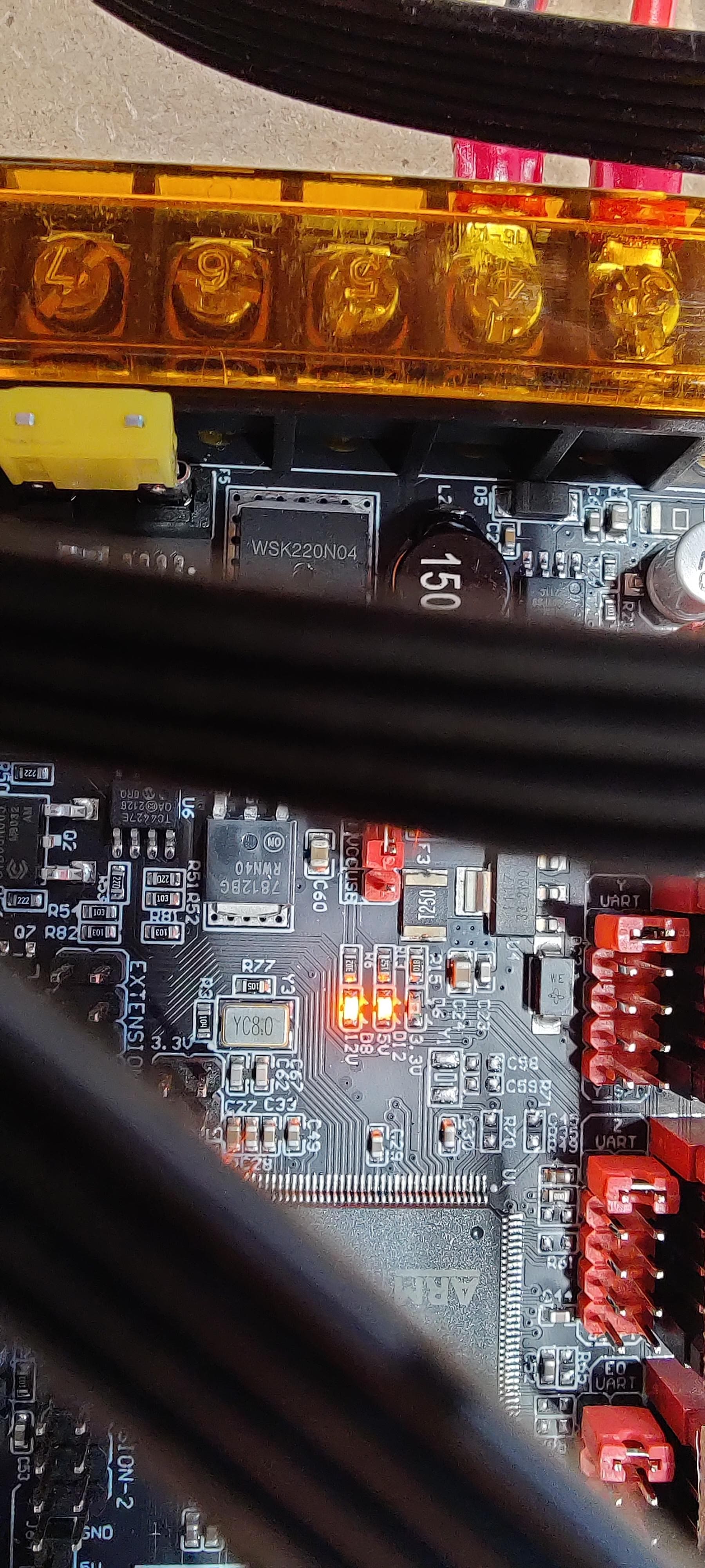

Thanks for taking pictures. That helps troubleshoot.

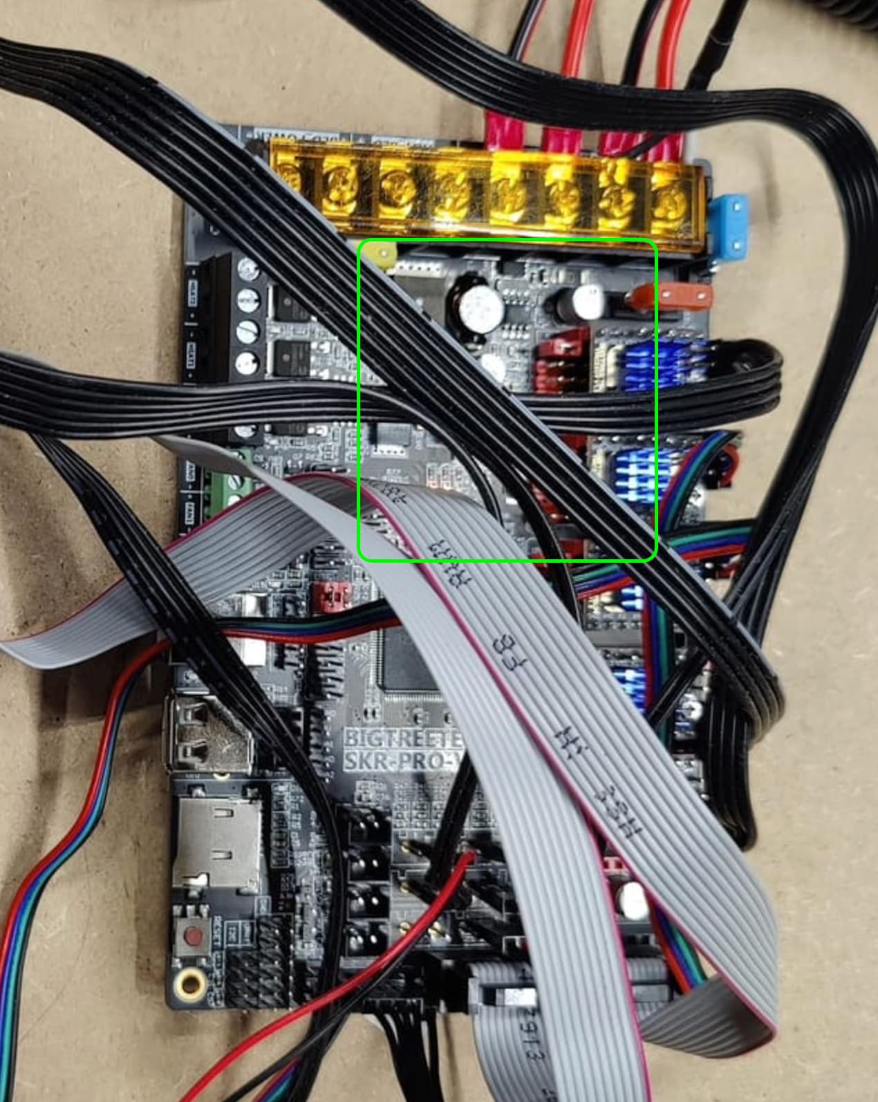

Since you’ve checked the fuses, time to get a good look at the regulators.
Move wires around and get a well-lit, high resolution picture of the area I have highlighted below.

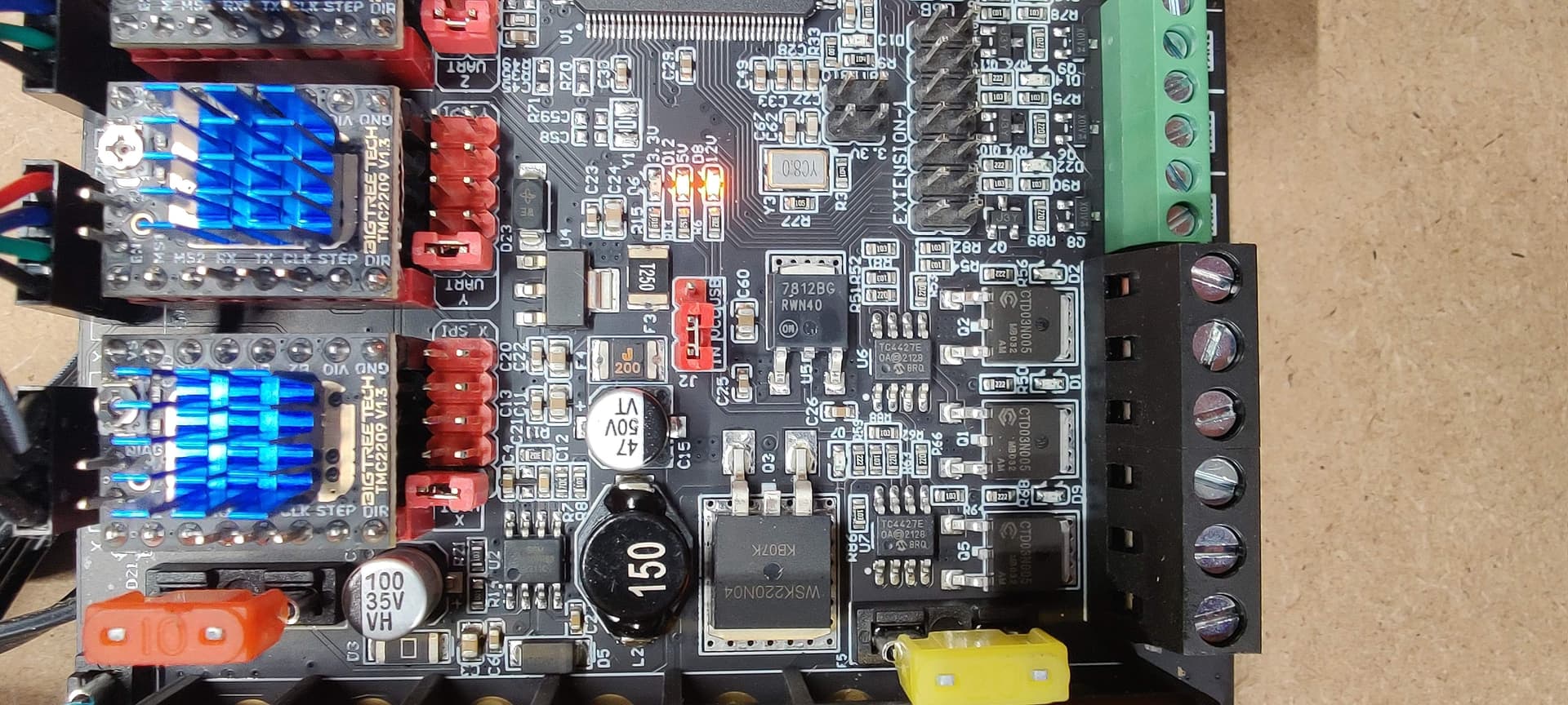

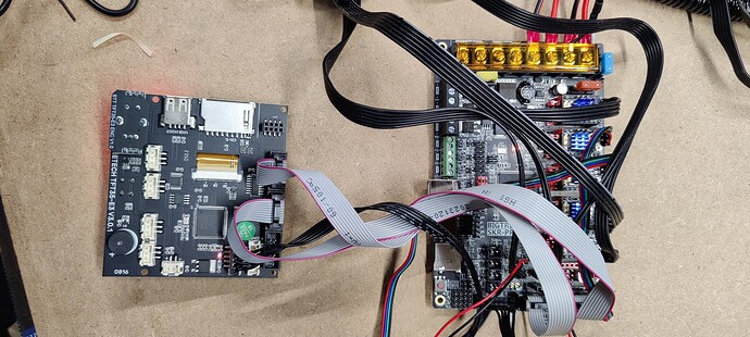

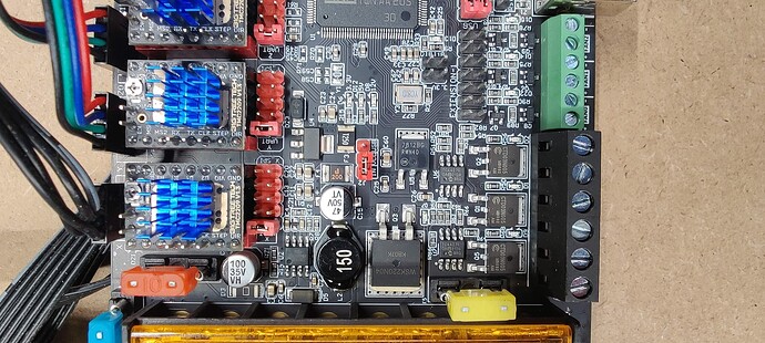

MakerJim, here’s a few shots of the indicated area,
thanks for any/all input
Jeff
You’re welcome.
Good news is that I don’t see anything obviously smoked at first glance.

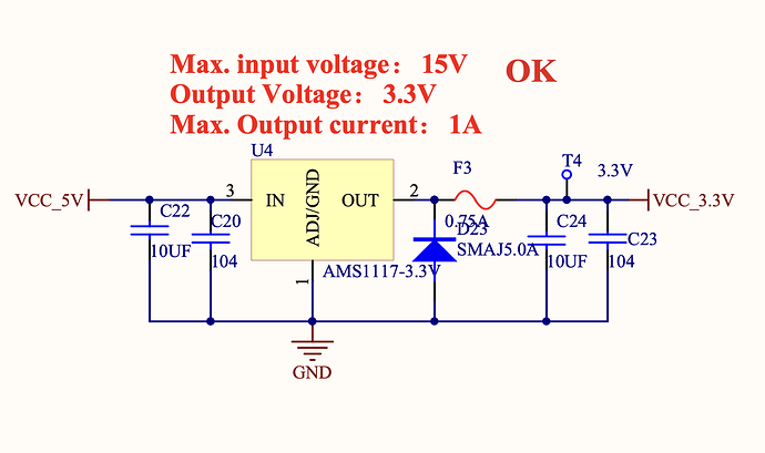

The SKR pro v1.2 schematic of the 3.3V power supply rail looks like this:
So, U4 is the regulator part, and output power goes through F3 out to the rest of the electronics.
What we want to do is to use a DMM and measure the input and output voltage of U4, as well as the voltage at both sides of F3. This will tell us if U4 is alive, and if F3 is blown.
The U4 part is an SOT-223 package, and the pinout looks like this:
So, on your board, we’d want to connect a DMM to your board power return (black wire), then use the + lead of the DMM and probe the voltages as shown below (Assumes board is on.)
Measure the points I’ve marked with arrows and labeled 2, 3, A, and B. Report what you get.
