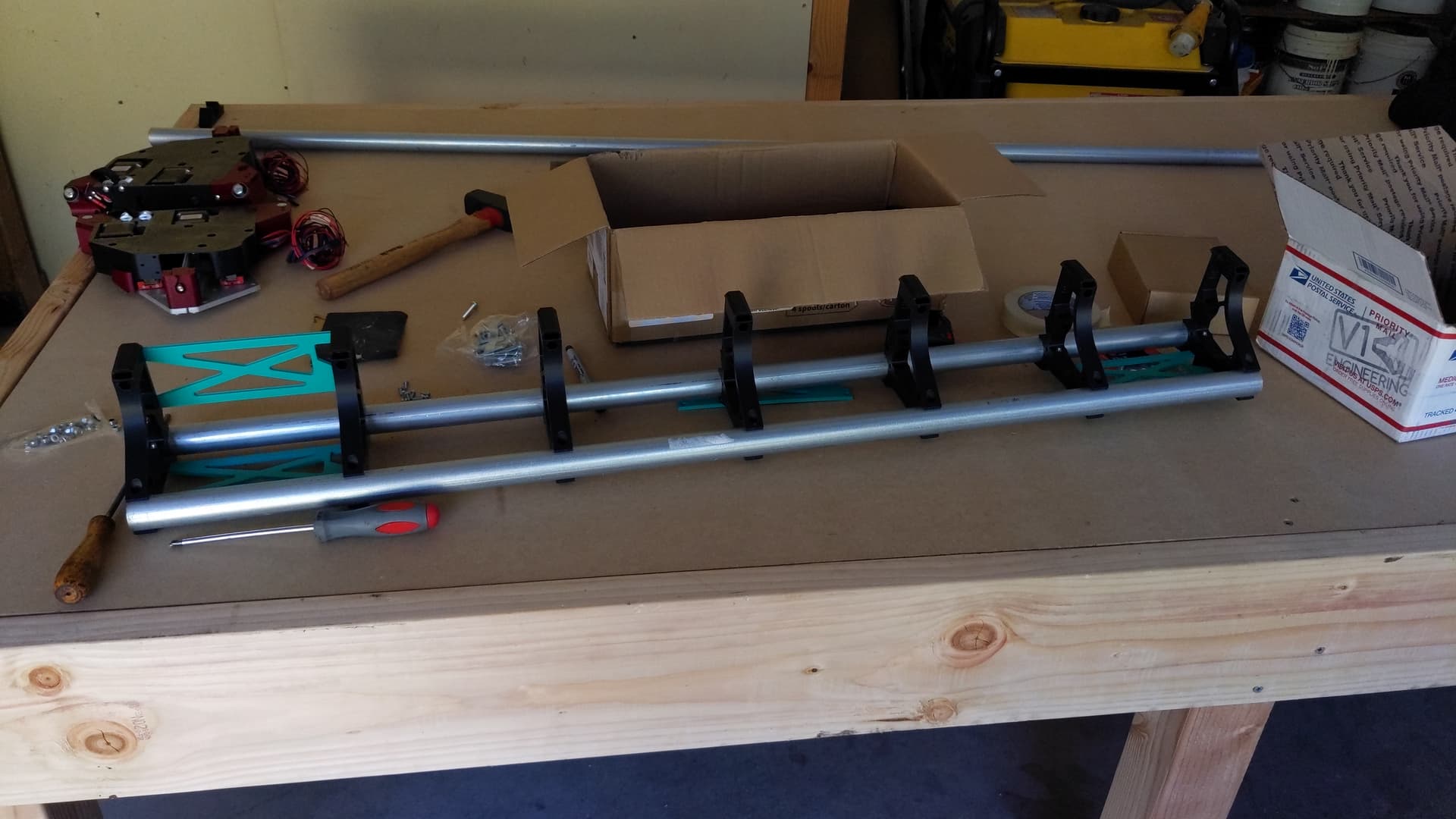

Hello everyone! I’m another guy working my way through building an LR4. This is probably the largest engineering project I’ve ever taken on, but I think I’ve made some decent progress so far:
Next step is finishing up the table and building the beam. I’m looking at what I have so far with the table and thinking of redoing a few things, so will update with a picture of that when it’s done!

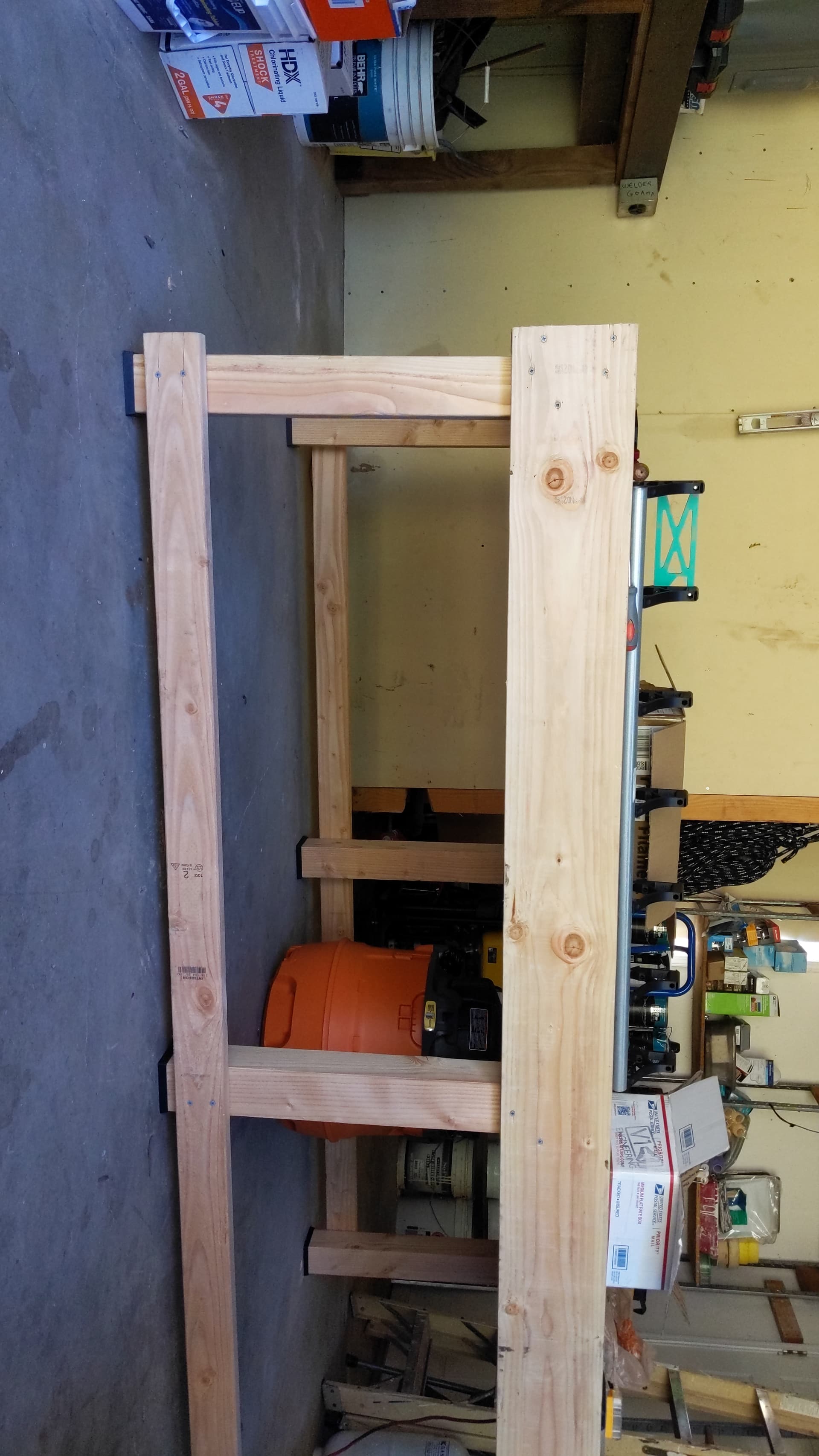

Pictures for the start of the table. Still want to cut some angled supports and add some feet. Thinking right now to print some tpu feet so everything levels out and acts as (from what I understand is unnecessary) shock absorbers too.
Ok, finally getting back to this. Printer was not liking the TPU even with a new roll (think I need to do some maintenance on the extruder). Ended up printing caps in PLA, then lining with some of the TPU. Things are pretty solid now.

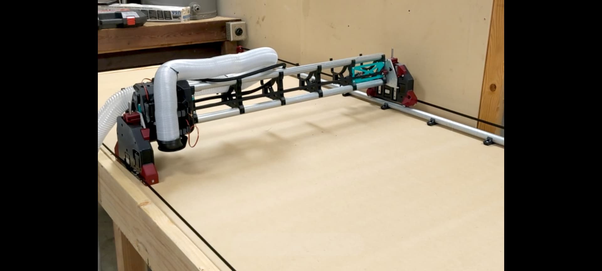

Ok, had to adjust things a bit, but everything is looking good now. Was able to square the device pretty easily but homing with the touch plate is a bit weird for me.
In the web UI dashboard tab, when adjusting Z pulloff, am I reading the value listed as Zw, Zm, or the actual probe values in the console window? Then adjust pulloff for the associated motor in the FluidNC tab, save macro in the Dashboard, then reprobe and adjust again until the two probe numbers are the same right?
Zm is Machine coordinates so that’s the one you should use. After you get your beam level you can get the start, tool change and end gcode from the milling basics page and put that in Estlcam, then you will probe at the start of the job and not have to remember to manually do it each time. Makes it much simpler.

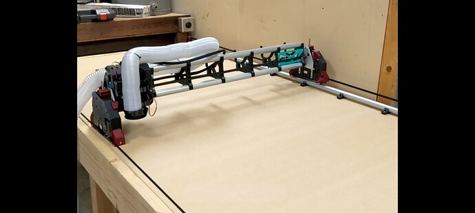

Just an update to say I’ve (finally) got this guy up and working! Been a crazy year but finally able to get started cutting
Woo hoo!
What projects are next up for you?
I’m pretty new to the whole CNC thing, so the plan is to keep it simple: cutting signs out of scrap wood (scrap pine and some redwood) and the like until I’ve got a feel for how things work. Then some new cutting boards before I attempt something bigger that can actually make use of the size (thinking maybe a chair for the pool or something). Dreams are to put together some custom furniture pieces and the like, hopefully tie this into other stuff I want to do more of (blacksmithing and some hobby electronic stuff), but right now I’m just happy the thing moves when I tell it to!
