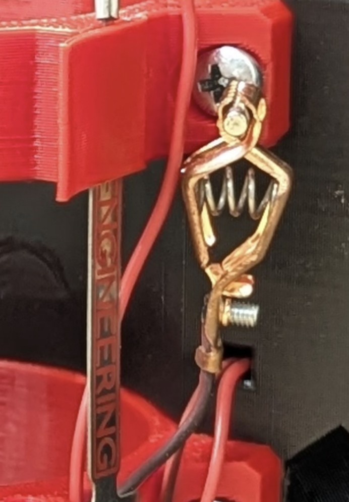

Any advice on the touch plate? I was able to crimp the connection on the plate but I am confused on the clamp. What’s the little rod in the clamp doing? Almost looks like its on the screw somehow? How is the clamp hanging in this picture I got from the website?
It’s a magnet. Just stick it to the collet nut when you probe.
I just figured that out. Lol. :grin: Thank you Dan!

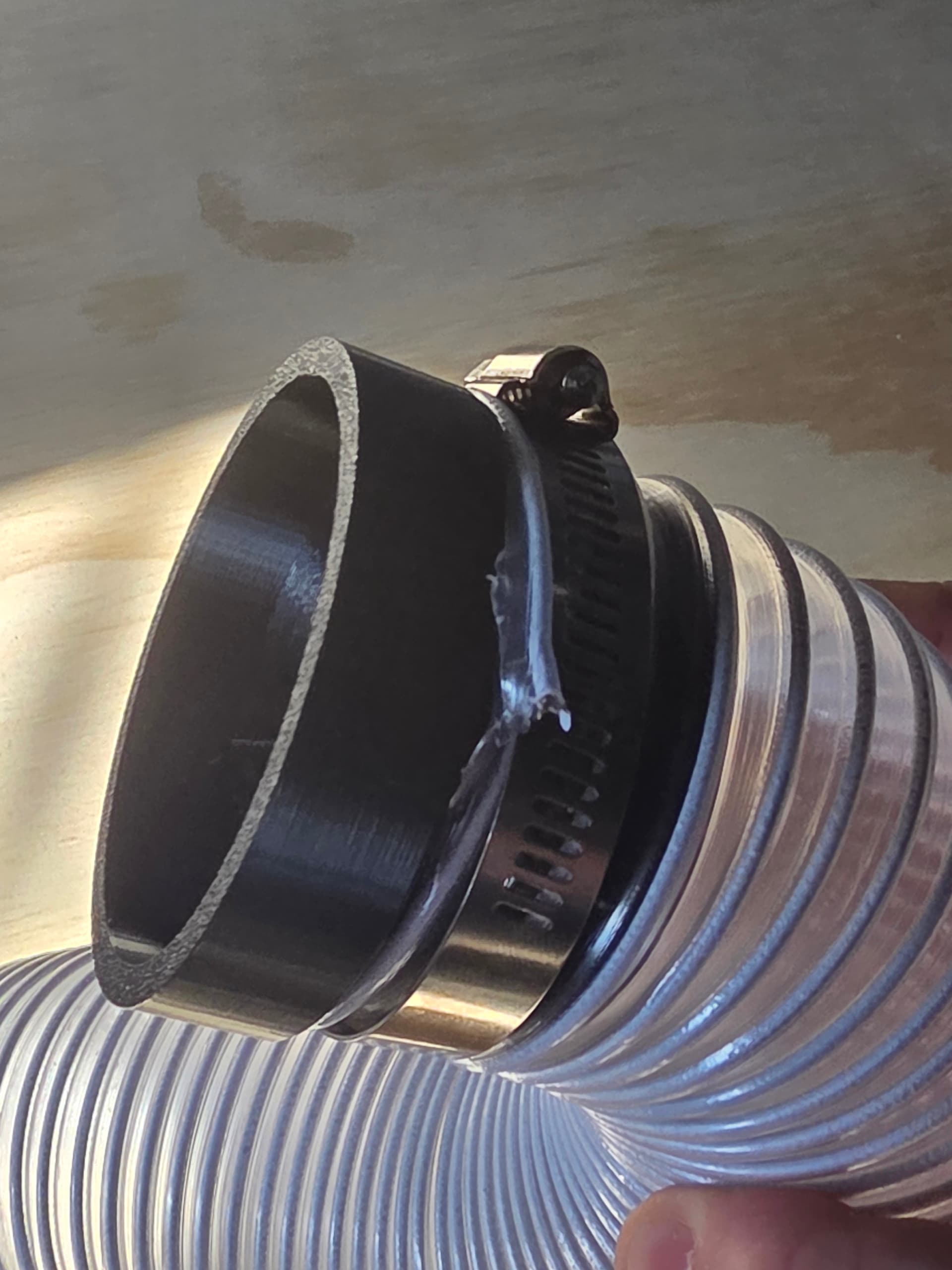

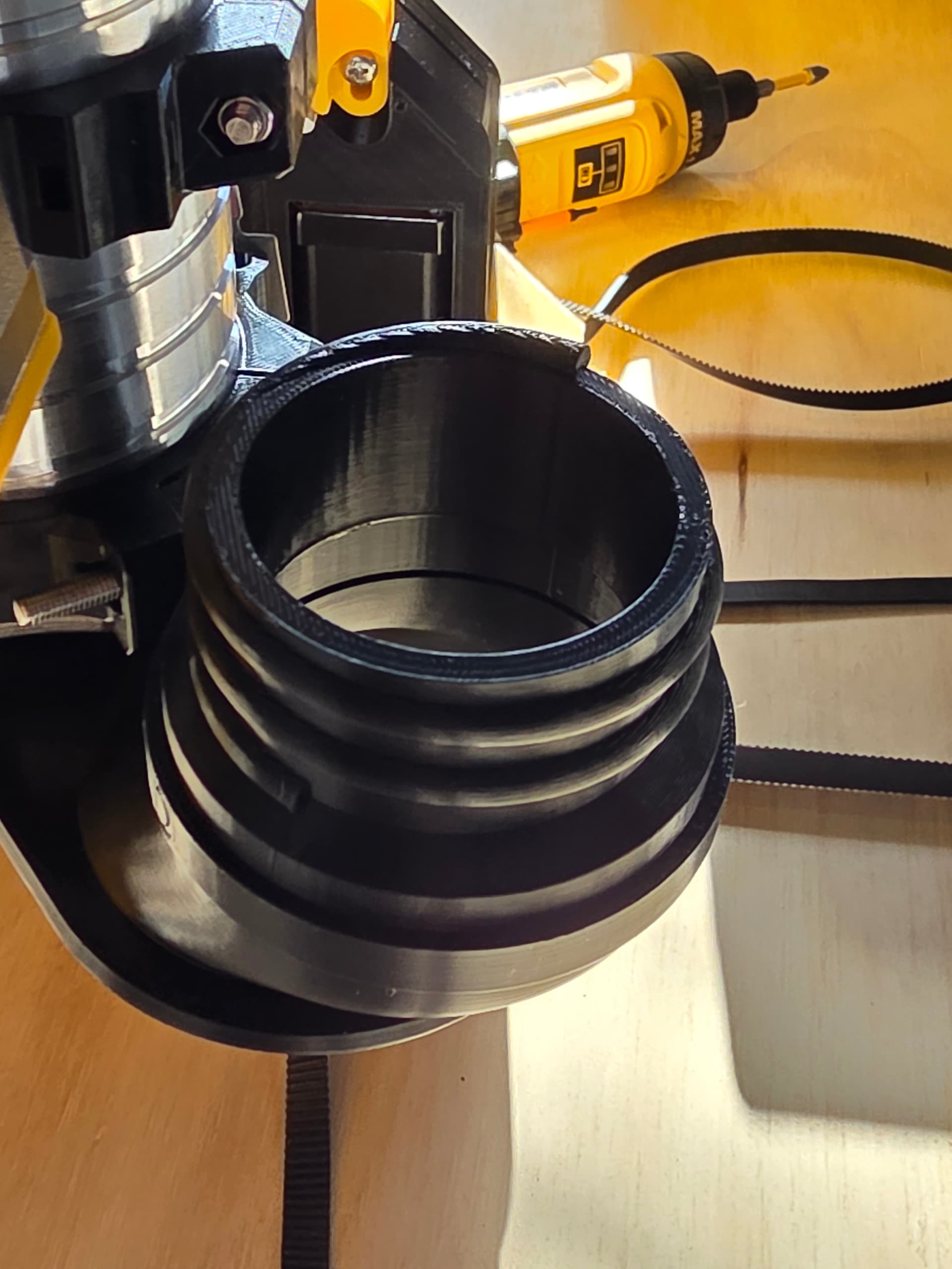

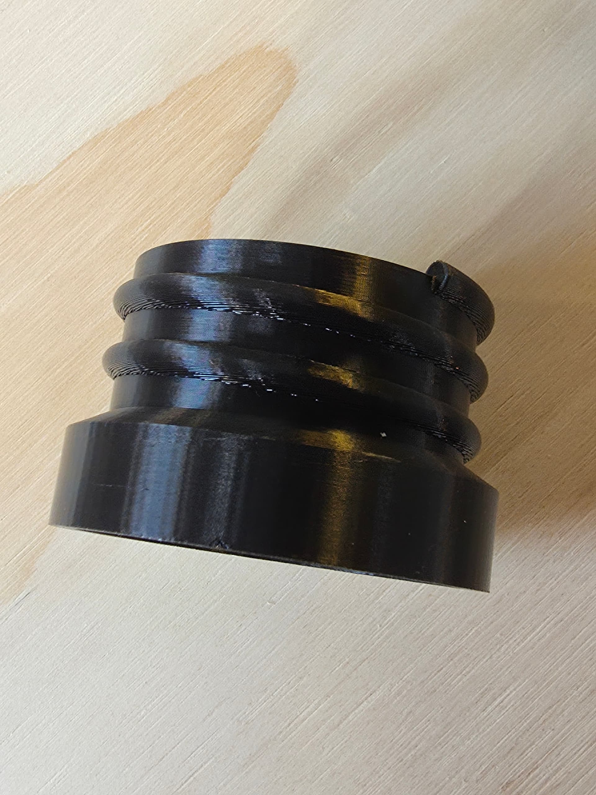

I made up a custom insert so it screws into my 2.5” hose and press fits onto the dust shoe. Also remade the skirt so it doesnt fall off the bottom.
I haven’t had a single failure of the stock skirt coming off the bottom on my personal machine. And no reports of it on any of my customer machines either.
Can you post a link to where you got the files on makerworld?
Please don’t take it as a complaint because I am very very thankful for everyone’s designs and help! I am blow away that I get to make this machine for next to nothing and everyone is so helpful!

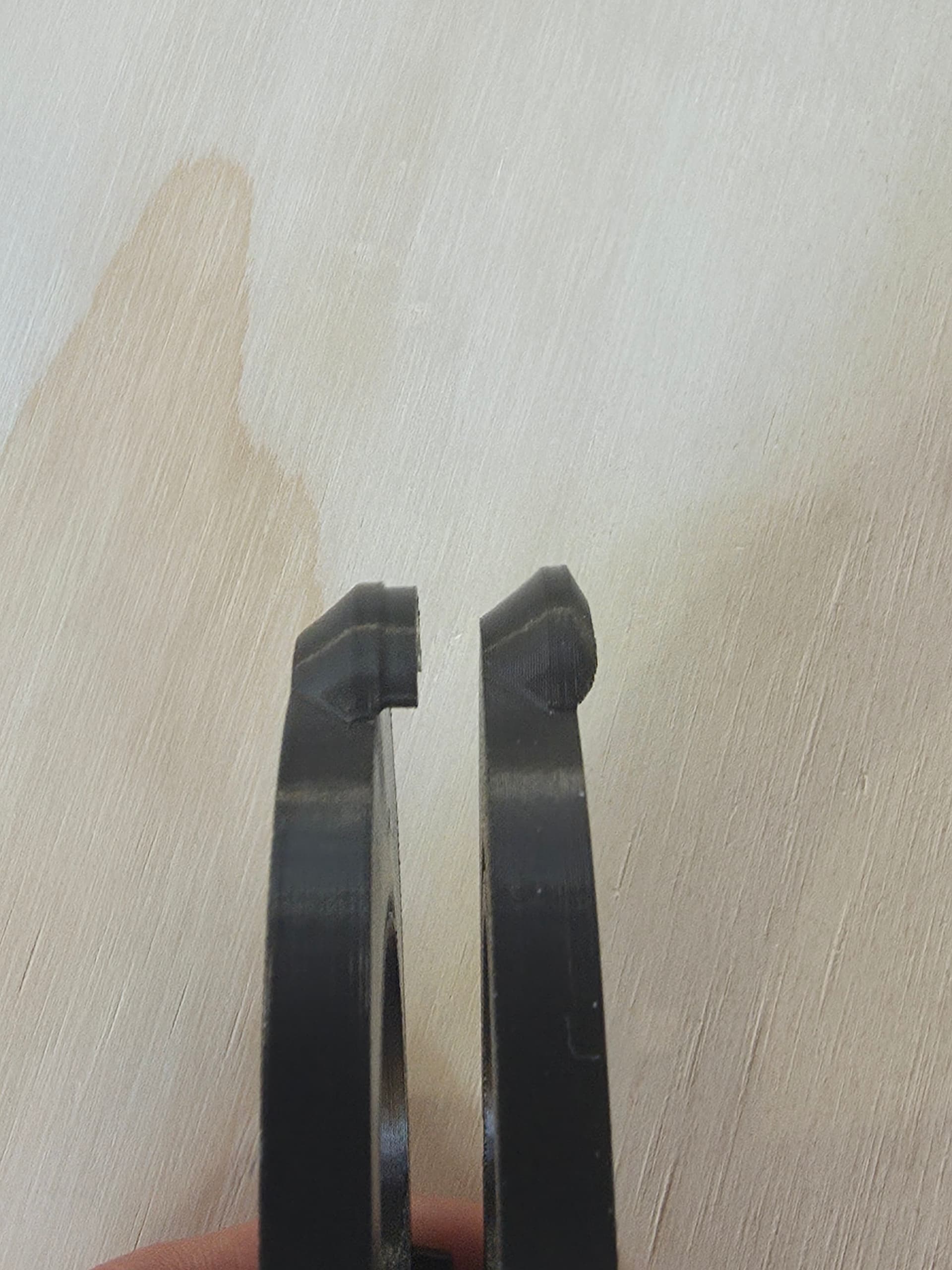

On mine, if I barely touch it, it pops off. I have not ran my machine yet but I added a millimeter to the little lip and it helped a lot. I can share the file if you want to see. I don’t remember what site I got it from.
it doesnt look like much but it helped alot on mine
Also had to make this adapter so I can get the 2.5" hose to fit the 2.7” dust shoe
No complaints taken at all! I only asked for where you got the files from because you are having issues we don’t usually see. I know farther up you said you got them from Bambu, so I assume MakerWorld. If someone put out some files that they adjusted to fit their particular needs it would be good to know so we can warn others so they don’t have these issues.
The dust shoe when handling it off of the core can seem like the skirt is very easy to knock off. But in actual use it is quite secure. Nothing at all wrong with what you adjusted and I hope it works well for you! I was not at all trying to come off like you are making changes you shouldn’t. You are free to make any changes you see fit.

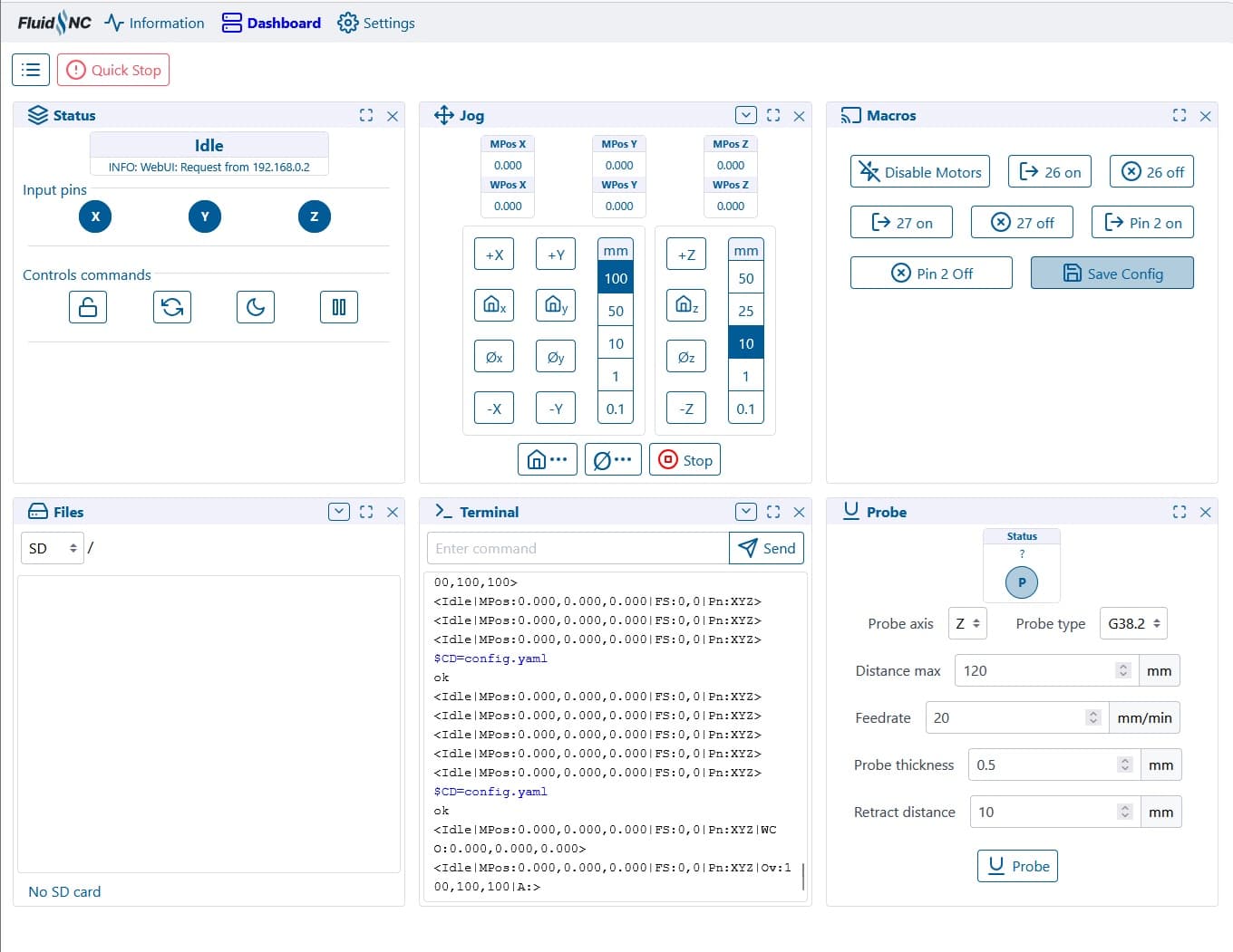

Did you run the save config macro or just hit the save button where you made the change? If you didn’t run the save config that would explain why your settings changed but not why you cant home any axis. Is the controller in idle state or is there an alarm?
I think I just hit save. I dont even see q save config button.
There is a hold right now. When I go to unlock it I get an alarm
Are you using V2 or V3 Webui?
If its V3 you should see this screen. Save macro is highlighted off to the right side of the pic
the hold is why you cant home or anything. in the terminal type $X and it should clear the alarm
